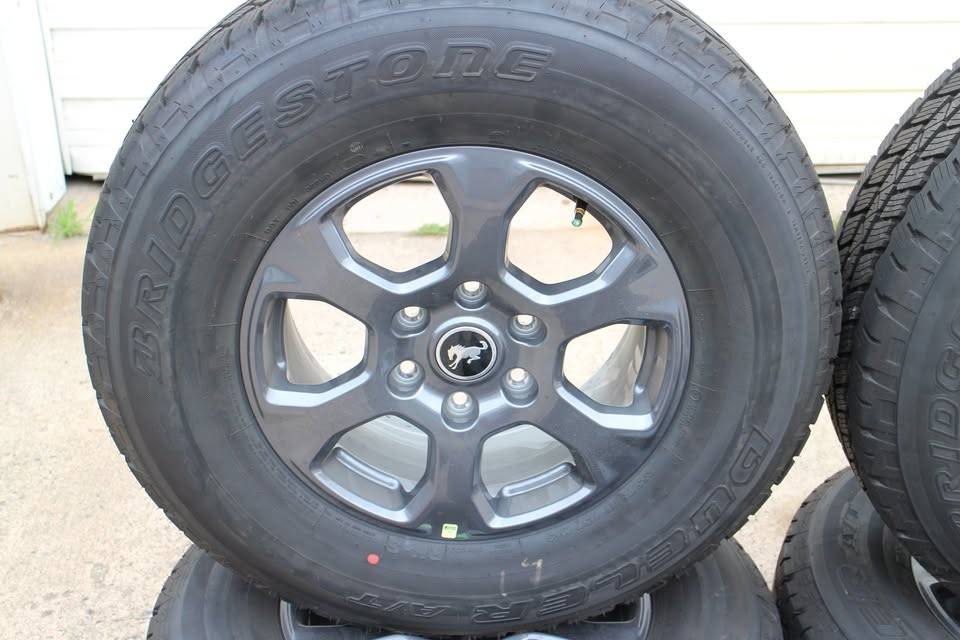

Wheels like this:
Ford Bronco 315/70's on factory wheels? 393401967_7213077798722885_7060170000382931825_n

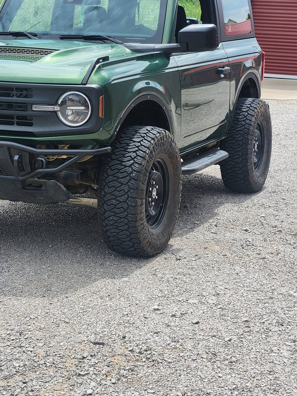

Ford Bronco 315/70's on factory wheels? 1000000768

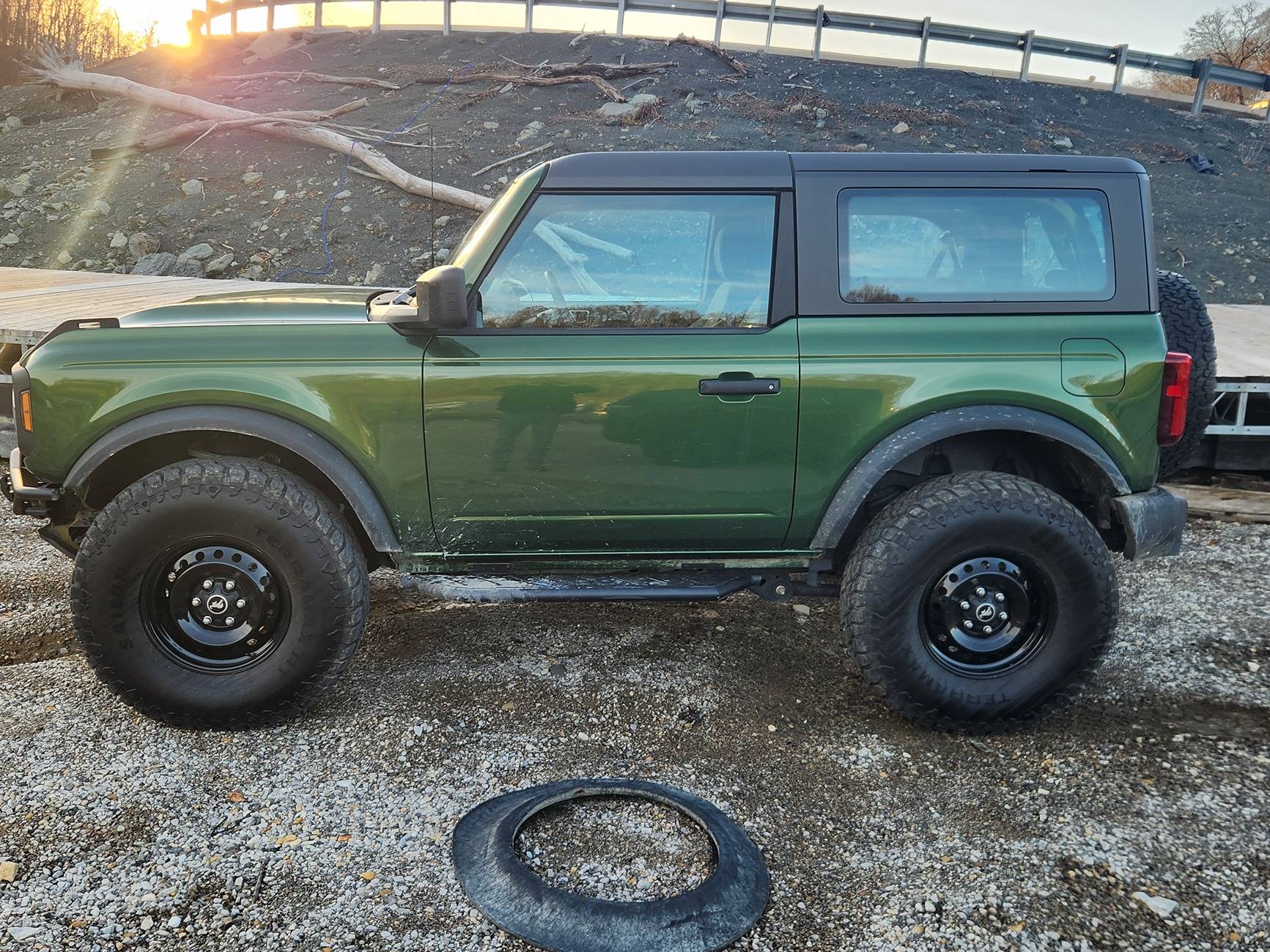

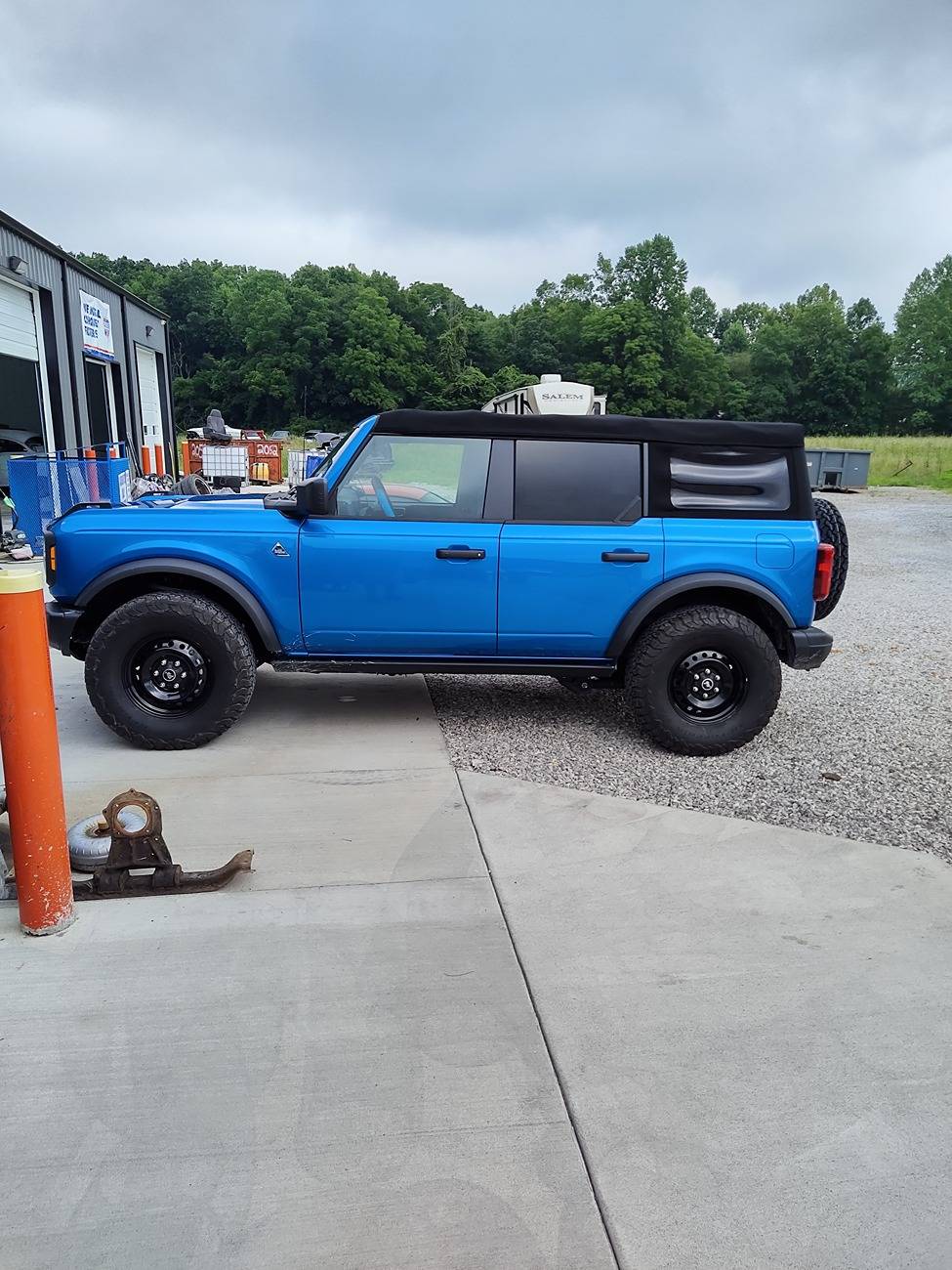

this was on my wife bronco for 2 year 315 70 17. now 37s with a 2in lift . you can do a 35 11.50 .or a 35 .1050 so you dont rub at full lock or add a wheel spacer 1.5
Ford Bronco 315/70's on factory wheels? 305
Ford Bronco 315/70's on factory wheels? 1000000873
