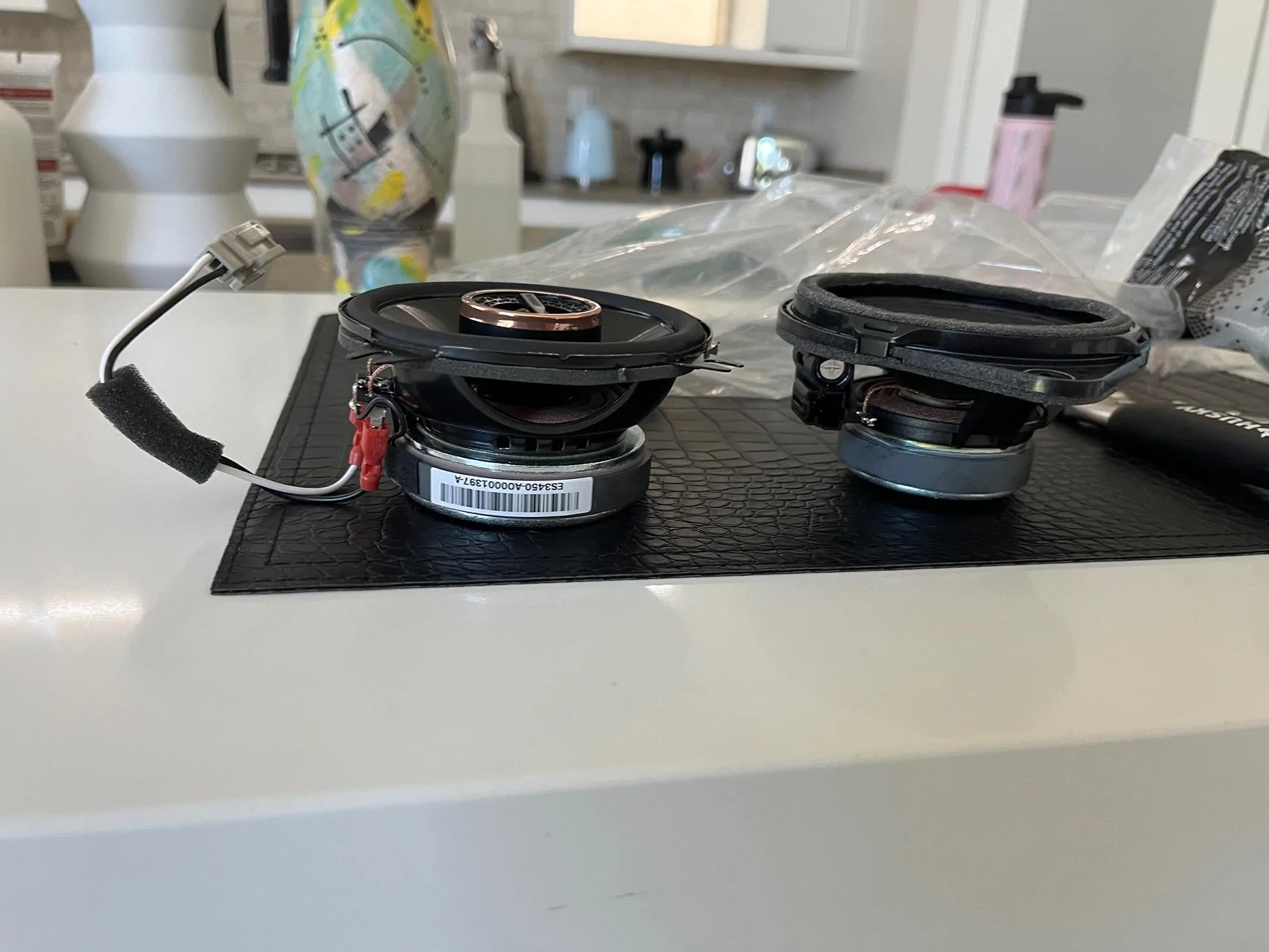

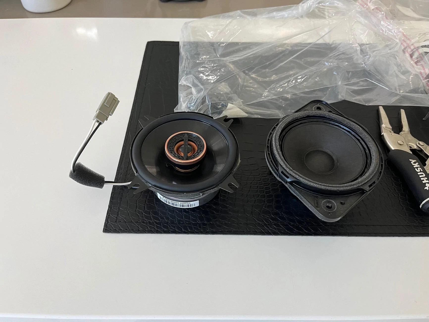

So ordered 2 sets of these off Crutchfield. Infinity Reference REF407F Reference Series 4" 2-way car speakers at Crutchfield I did my research and for a few dollars more they are worth the extra money as an upgrade from say Kicker. They come with the Ford plugs in connectors from Crutchfield at no charge and they are idiot proof. Different size connectors from the speaker to the factory plug. Just slide them over and install. Use the foam provided to cushion the back side on the dash. You will need to bend over or break off two of the speaker attachment points on each speaker so they fit properly. Grills come off easy if you take your time and watch the videos. Make sure on the rear pods you have the extra attachment point is out of the way or the cover will not lock on right. Took about 30 to 45 minutes to do all four. I did not use any bass blockers on these. Magnet is twice the size plus you get a get a tweeter and get rid of the cheap paper speakers.

Speaker pictures
Ford Bronco 2DR Infinity 4" front and rear speaker upgrade IMG_0410
Ford Bronco 2DR Infinity 4" front and rear speaker upgrade IMG_0411
