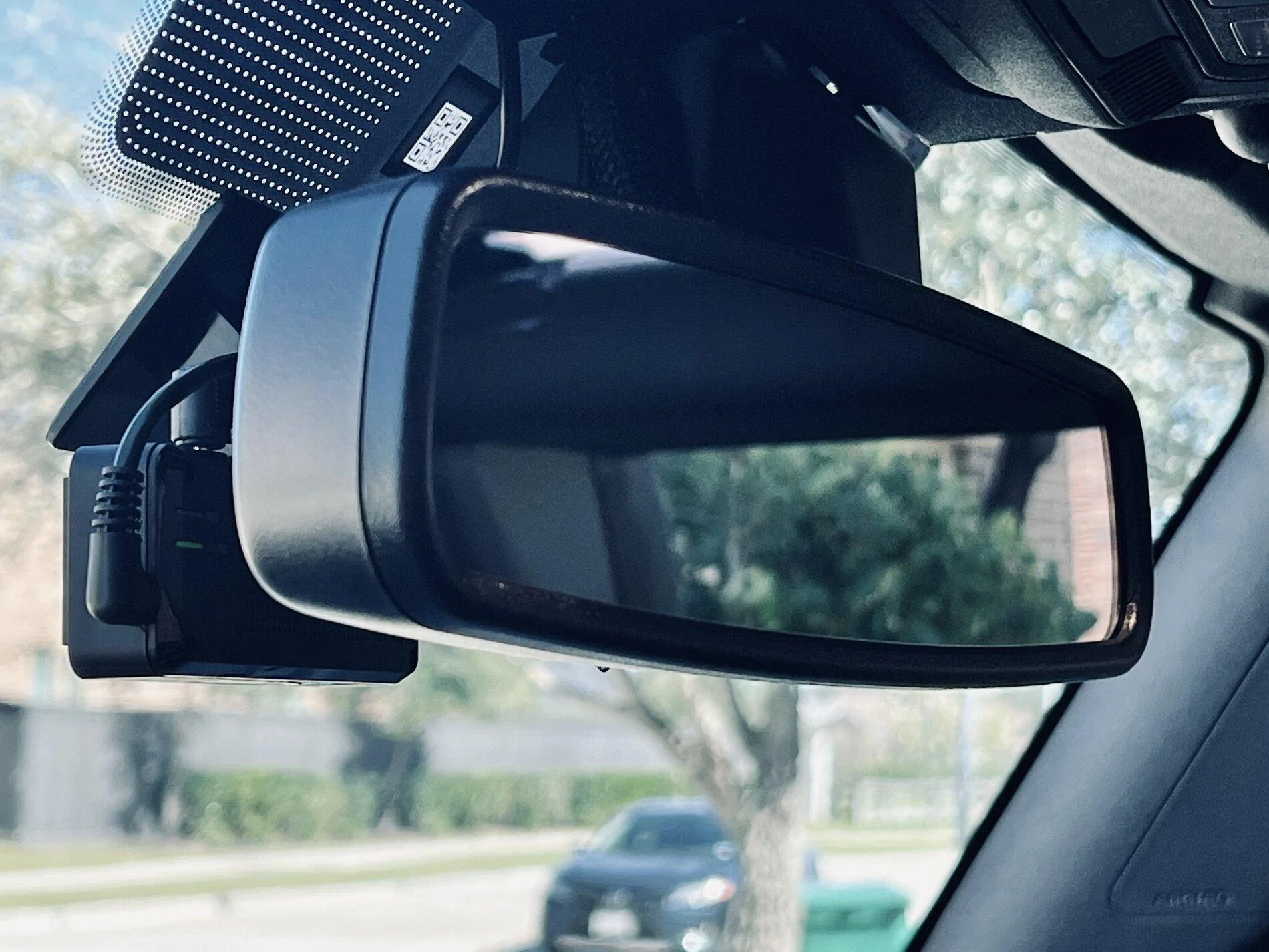

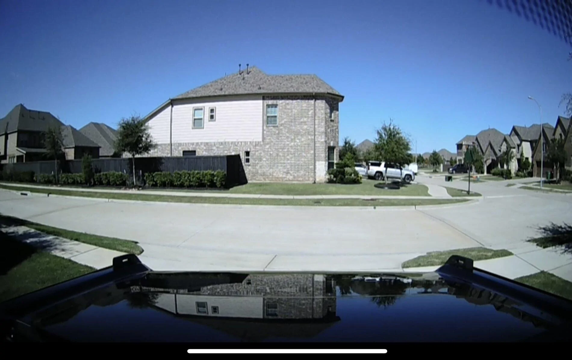

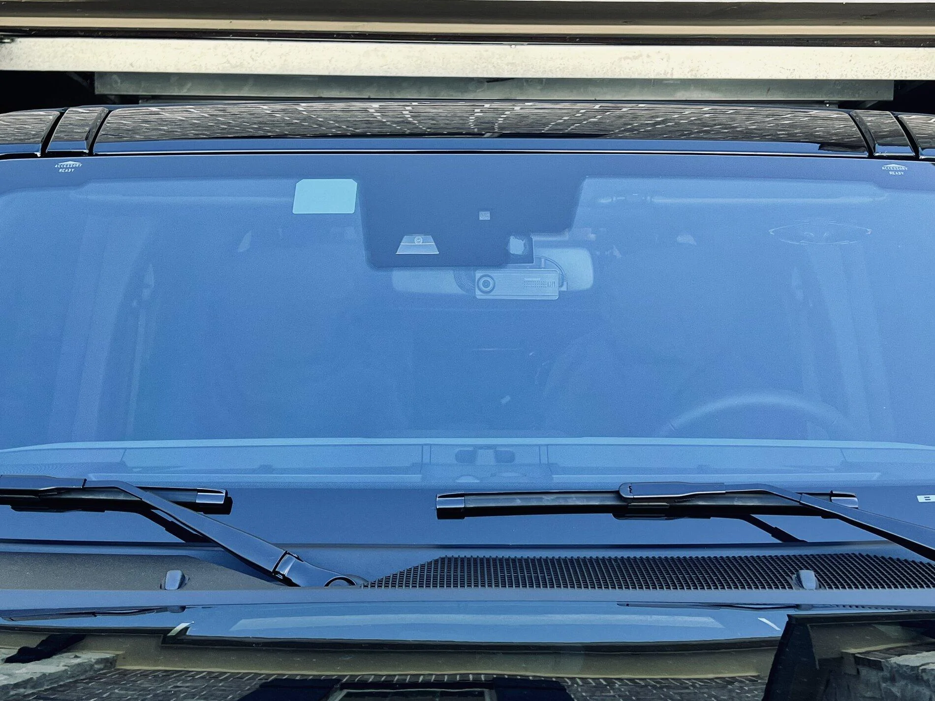

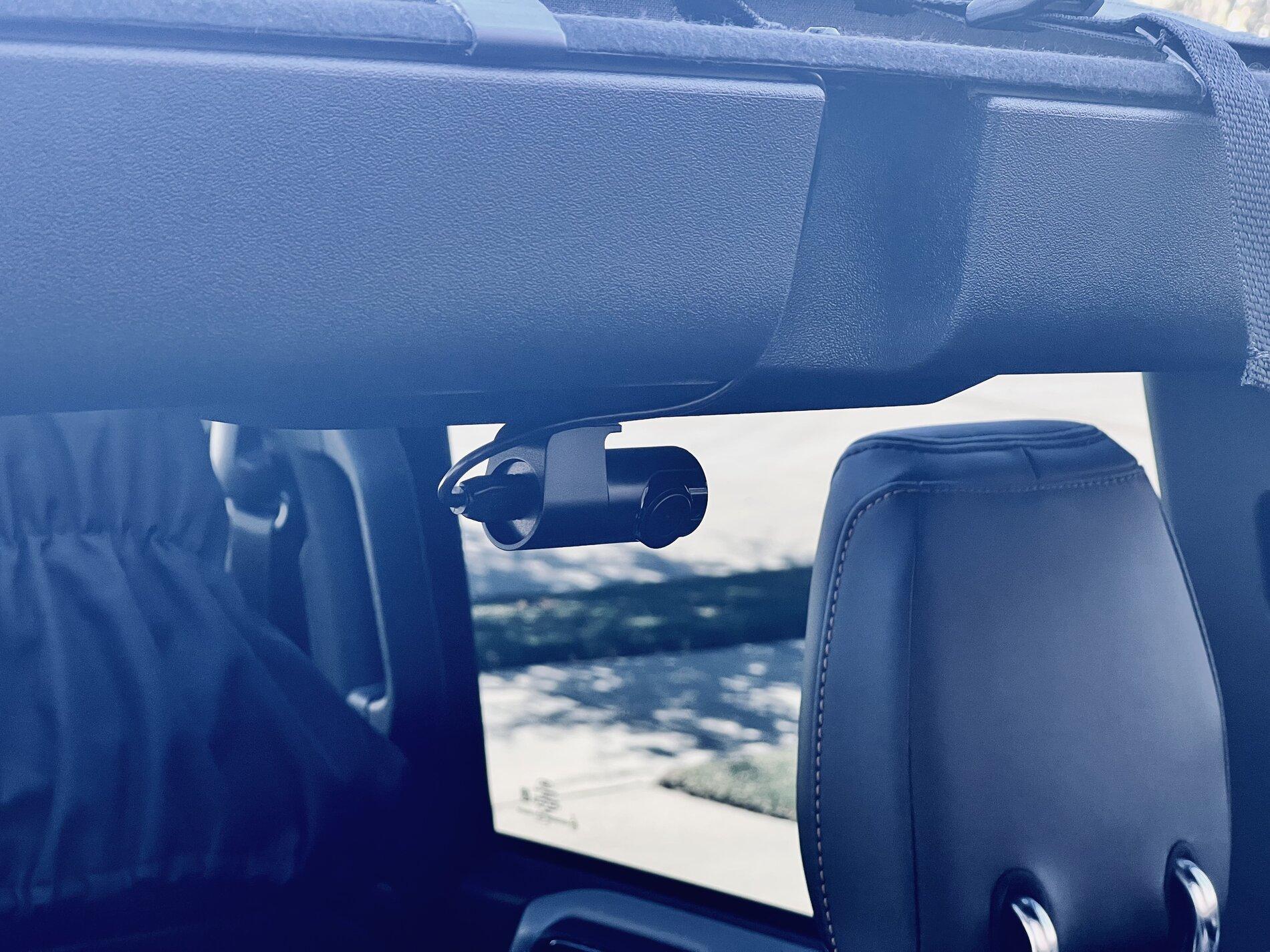

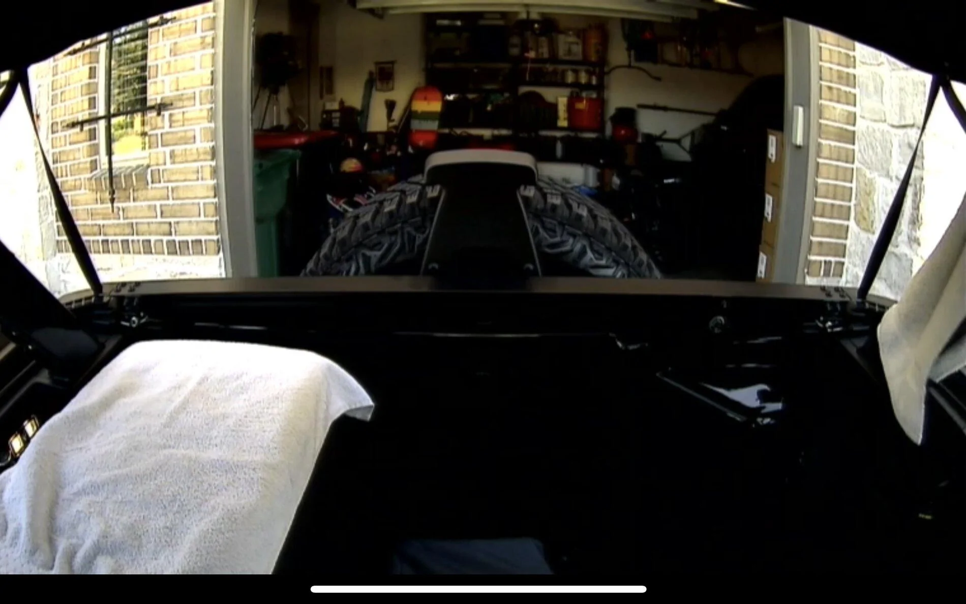

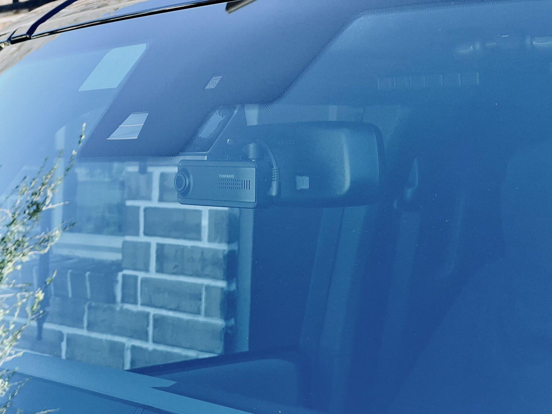

Installed a front and rear dash cam last night. Went with the Thinkware F200 Pro. Also got the OBD cable for constant power to enable the parking surveillance mode and for ease of install. Got a CPL filter for the camera too, but found out you can’t use it in combination with windshield tint or else you’ll get a rainbow effect in your videos. Overall it was a pretty easy install. Hardest part was just concealing the wires. For the rear camera, I totally forgot I pretty much don’t have a rear window to install it on because every time I decide to fold the soft top down I have to remove the rear window! Installing it on the underside of the crossbar was the only place that made sense for me while still keeping the camera centered. The spare and the third brake light take up most of the view, but at least the cargo area is in view 🤣 I haven’t tested out the video quality through the plastic rear window yet, but I should be able to soon. I’ll post pics of that as well.
Hidden behind the rear view mirror. Can hardly see it from the driving position.
Angled view from outside.
View from the front.
Rear camera from inside.

Sample shot from the front camera.
Sample shot from the rear camera.

thanks for sharing! I'm undecided yet on what to get, not sure I really want to bother with rear view, afraid my dog will just knock that little camera off or constantly change where it's focused. Definitely want one in the front. Didn't consider that phone connect to either cam or Bronco thing either, have to see if I want to go that way or get an other dash cam with it's own screen. Too many options!
View out the back looks good enough I'd say.
