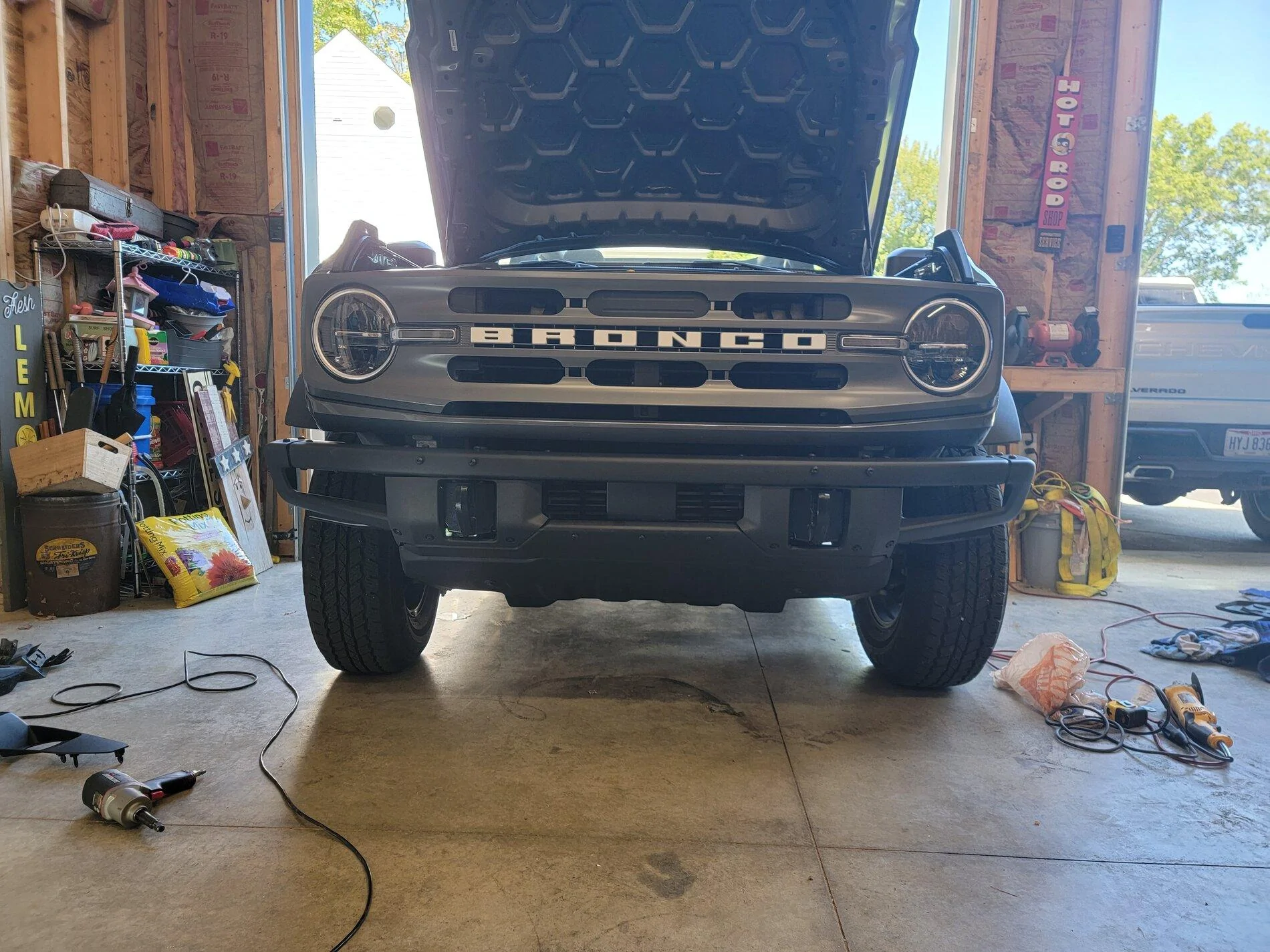

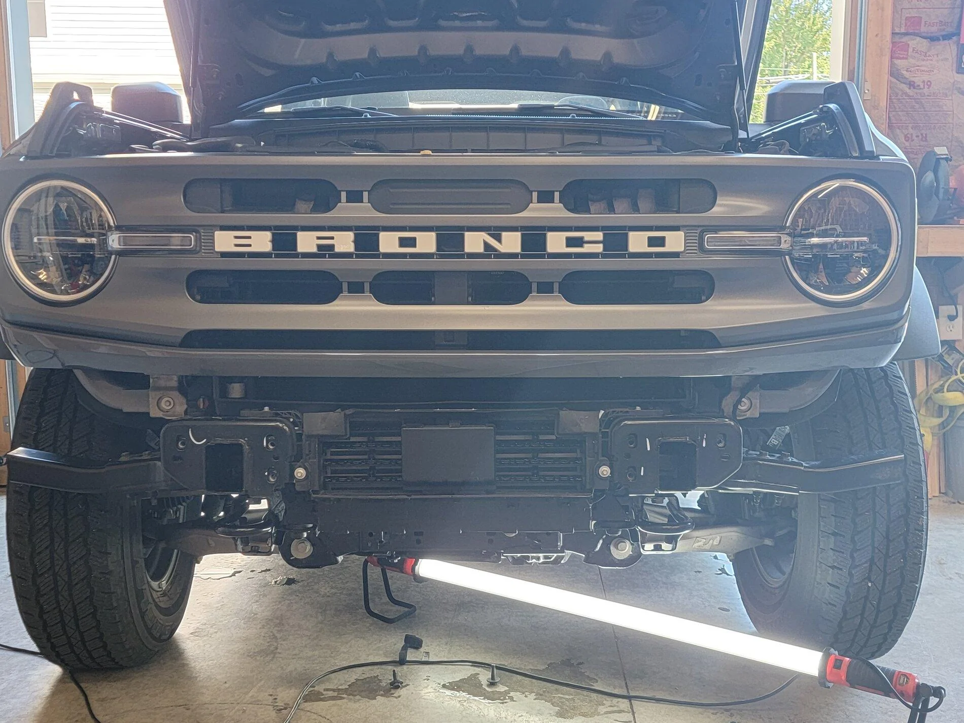

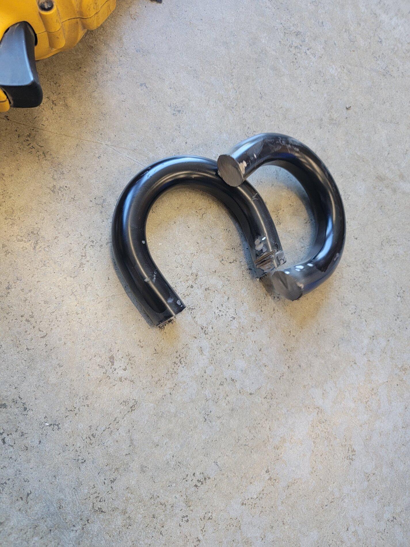

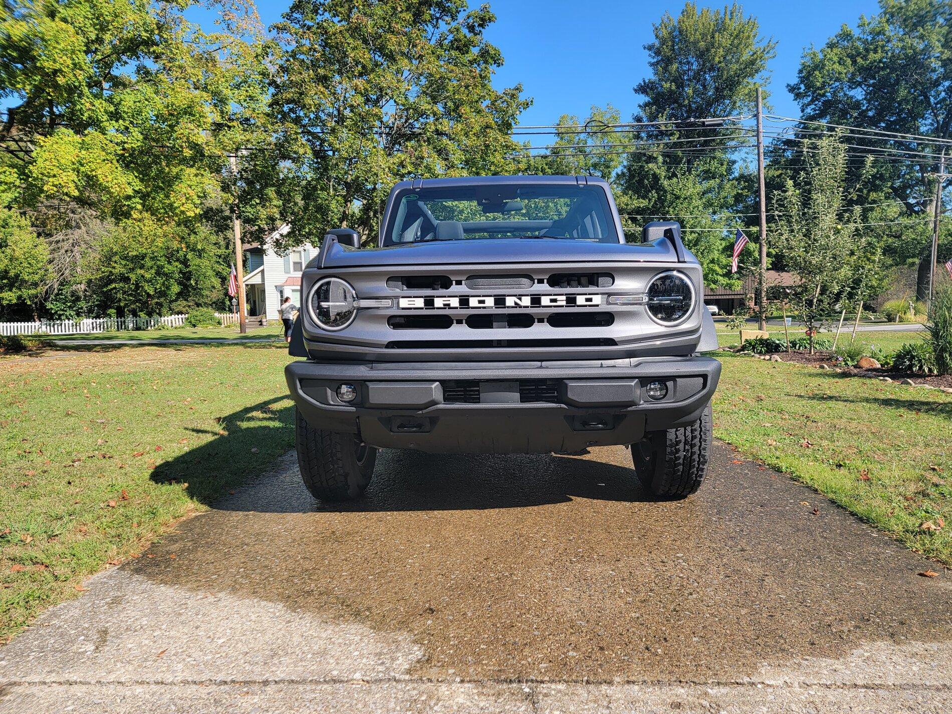

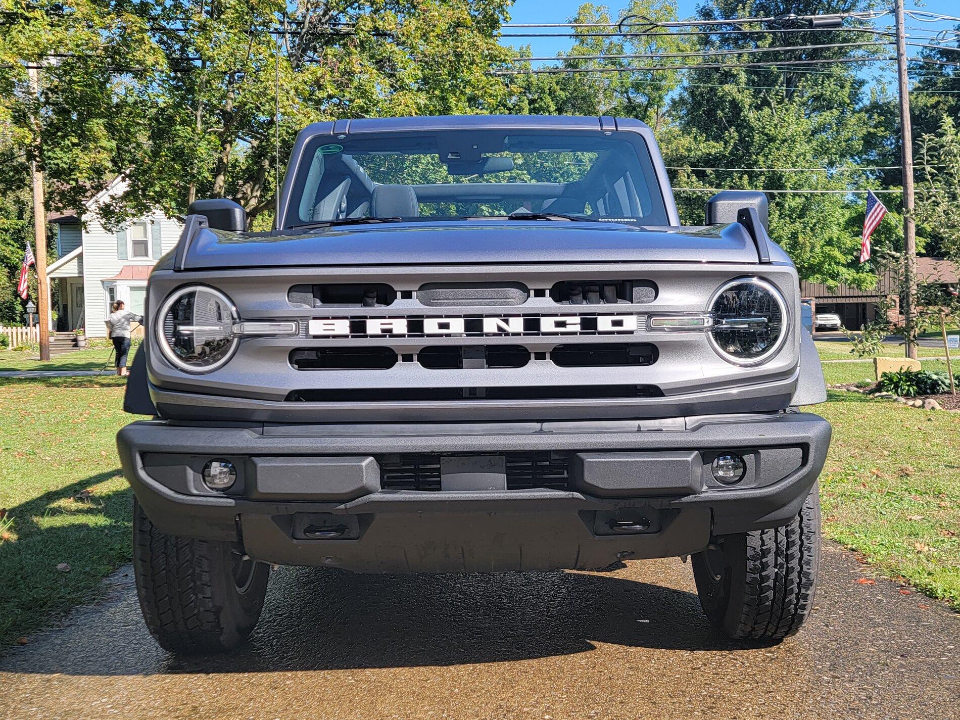

Changed out standard for Ford Performance Heavy-Duty Modular. Had to modify a little to get it to fit. Cut off standard tow hooks to get steel plate to fit.
Ford Bronco Changed out standard bumper for Heavy-Duty Modular Bumper. 20210919_104246
Ford Bronco Changed out standard bumper for Heavy-Duty Modular Bumper. 20210919_104249
Ford Bronco Changed out standard bumper for Heavy-Duty Modular Bumper. 20210919_111602
Ford Bronco Changed out standard bumper for Heavy-Duty Modular Bumper. 20210919_121602
Ford Bronco Changed out standard bumper for Heavy-Duty Modular Bumper. 20210919_123820

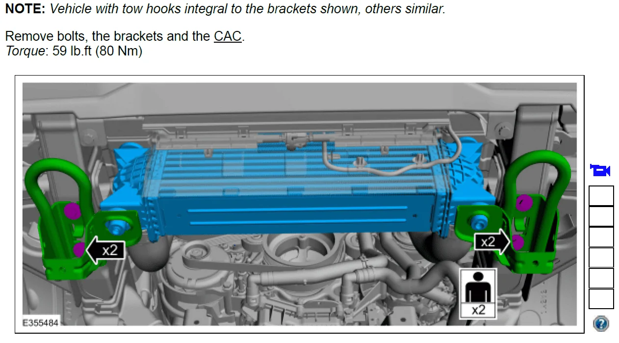

Standard tow hooks weren't bolted on?
This isn't discussed much, and I think people presume they're easily removed, but Ford's service information intonates they're welded/ integral to the brackets used to hold the intercooler in place.
New brackets without the hooks should be available? I would want to keep the hooks in tact in case I put the original bumper back on for whatever reason. Maybe to sell or the mod bumper got damaged.
I would presume so, since (a. vehicles built with Mod bumper @ factory don't have those hooks, and (b. the section notes "others similar."
I imagine you could get the VIN of a vehicle with stock mod bumper and spend some time in a parts catalog and find them.

@flip would you please be so kind and see what the modular bumper comes with instead of that(the green piece in the picture)? Thank you!!
