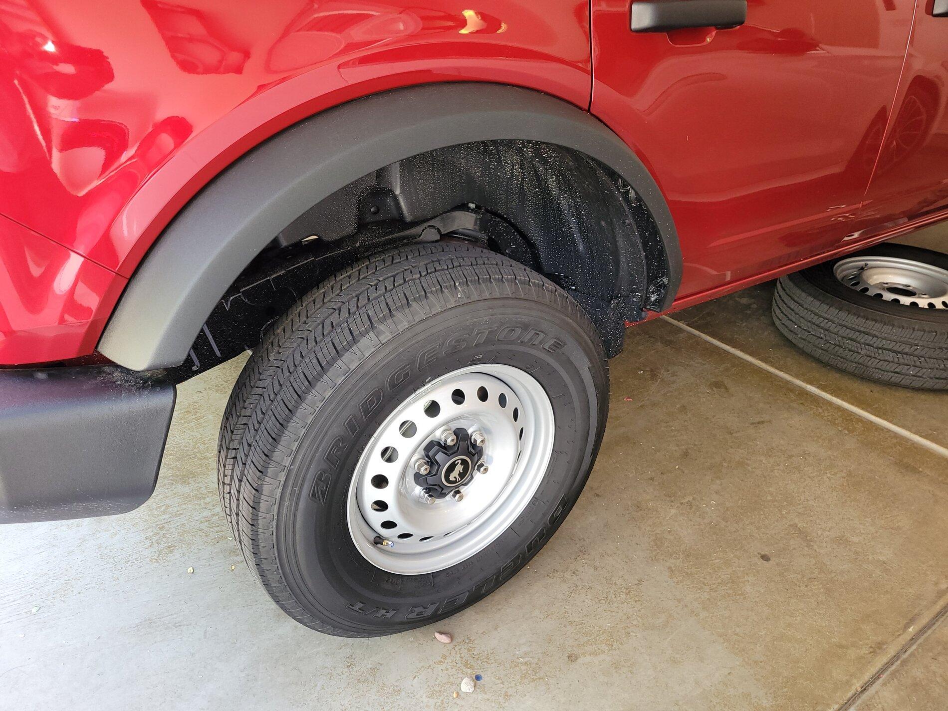

This was what it came with spare tire looking doughnuts.. love these ranger wheels and prefer more of a factory look...but being a base buyer its more about economics ...under 40k for this setup not bad in my opinion....and yes any gouges no prob mount another for 20 bucks or so
