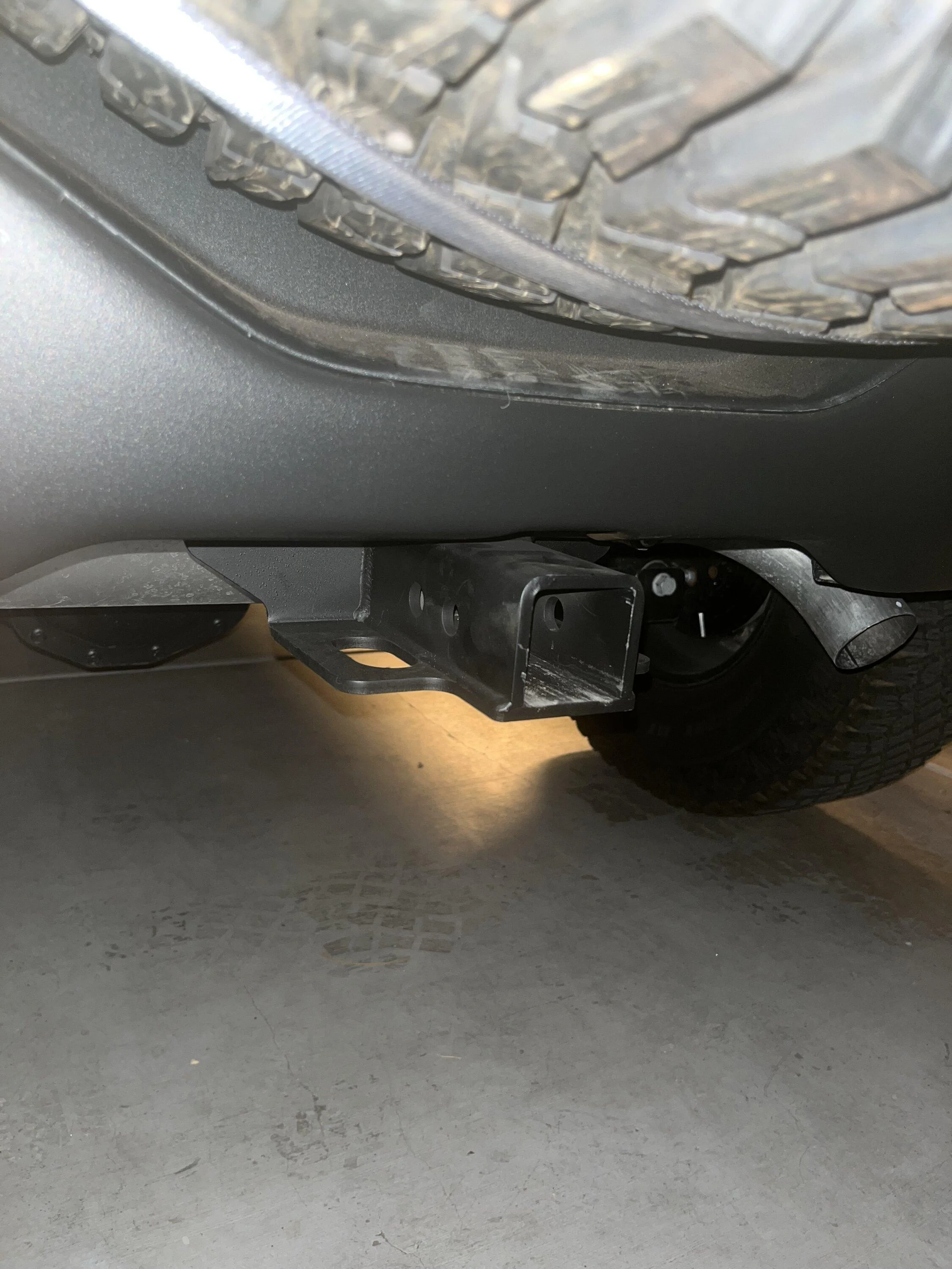

Takes about 10 minutes to install.
13493 Curt Class 3 Hitch Receiver - Fits 2021-2023 Ford Bronco (napaonline.com)
The harness you select will depend on if you have LED tail-lights or not, and took me (curt harness) maybe 3 hours to install.
FYI, if you buy the factory hitch (no better than the Curt), don't follow it's instructions and remove the bumper to install, it's completely unnecessary to do that.
Non-LED harness:
Amazon.com: CURT 56471 Vehicle-Side Custom 4-Pin Trailer Wiring Harness, Fits Select Ford Bronco, Black : Automotive
Your ball hitch will require about a 4 1/2" drop to clear the spare tire.

I got the Curt one for my Basesquatch. Installed it in 15 minutes. I use it for a bike rack only so I do not have the wiring plug harness yet. It works perfectly for the bike rack.
