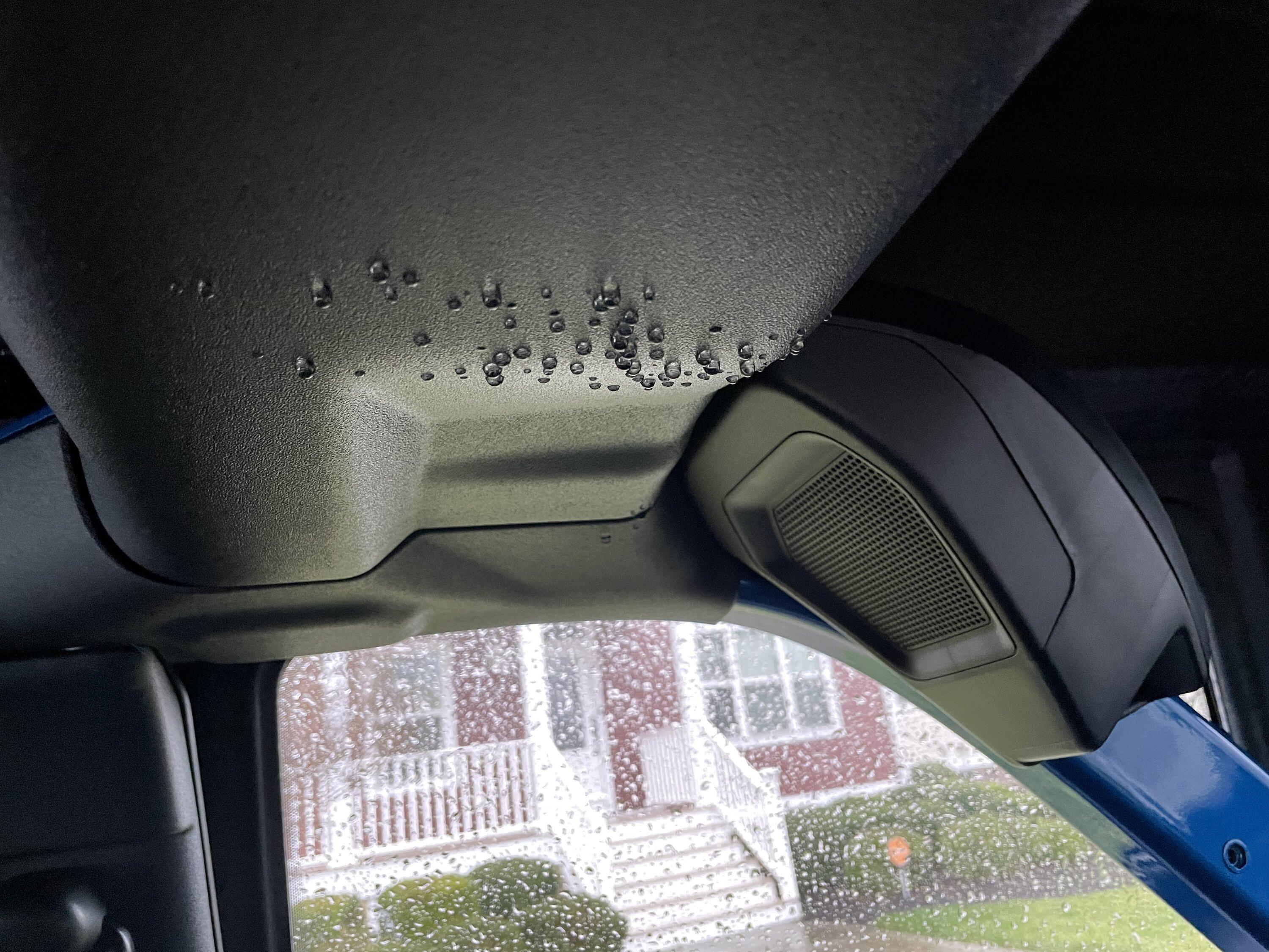

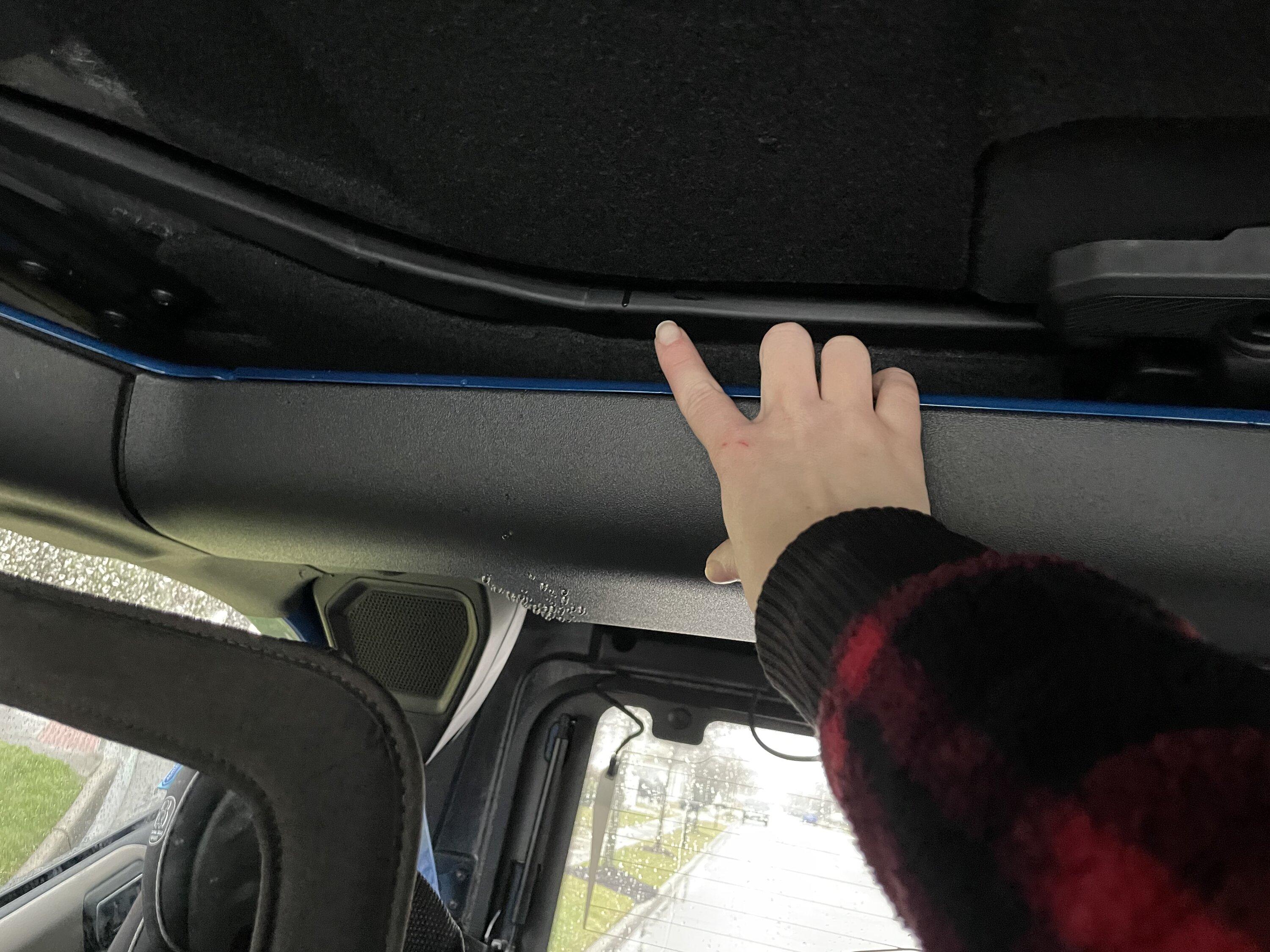

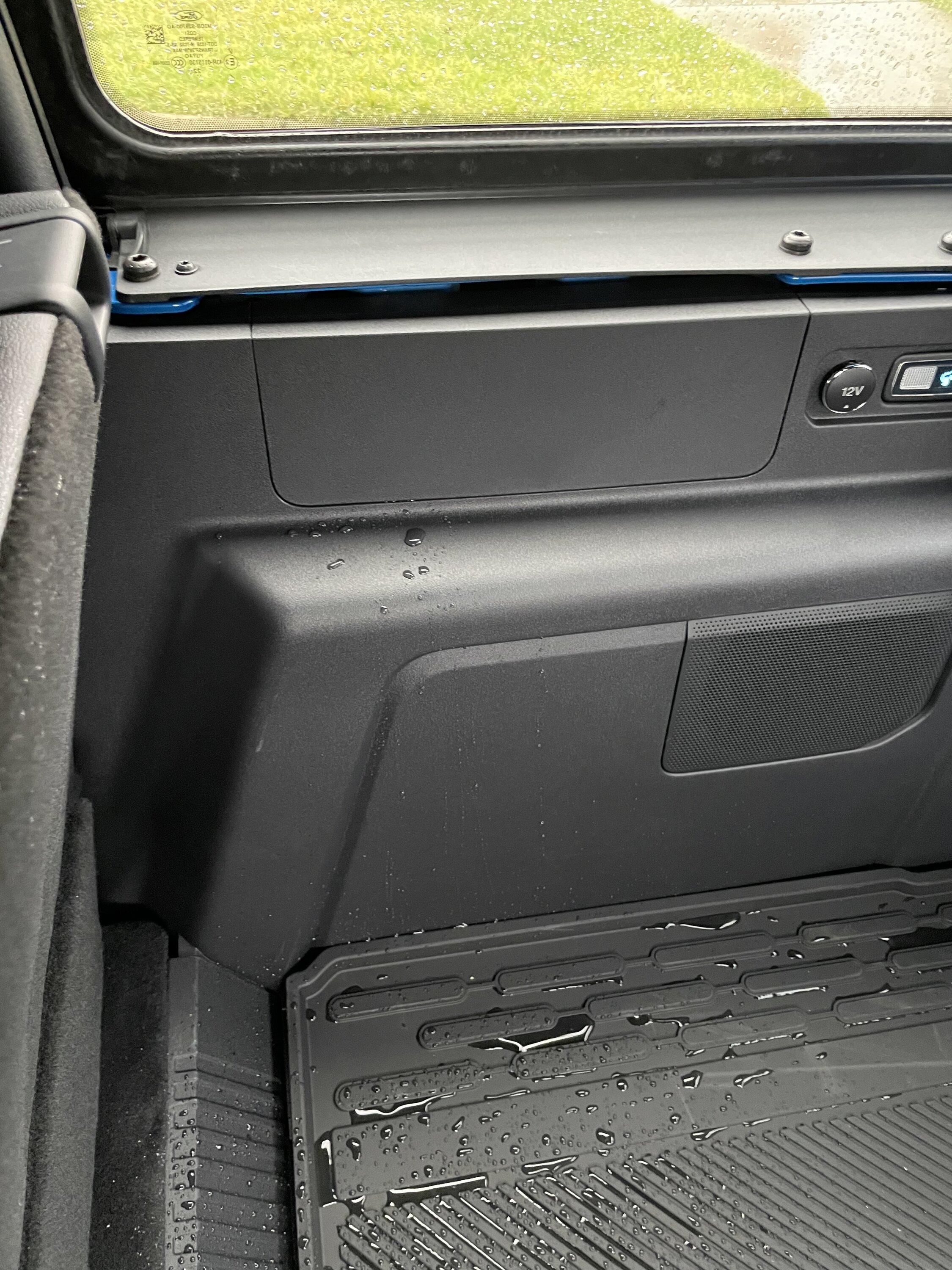

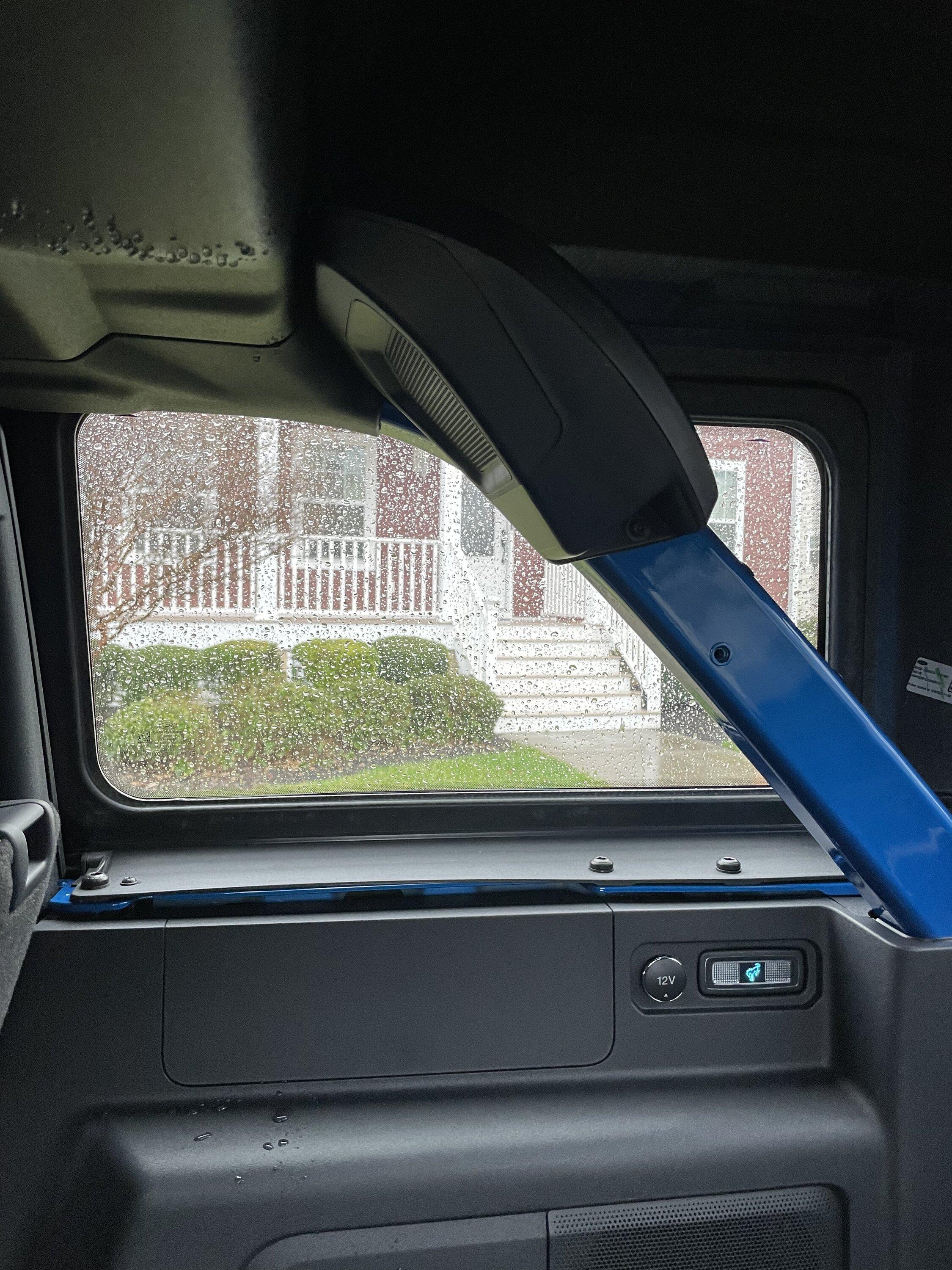

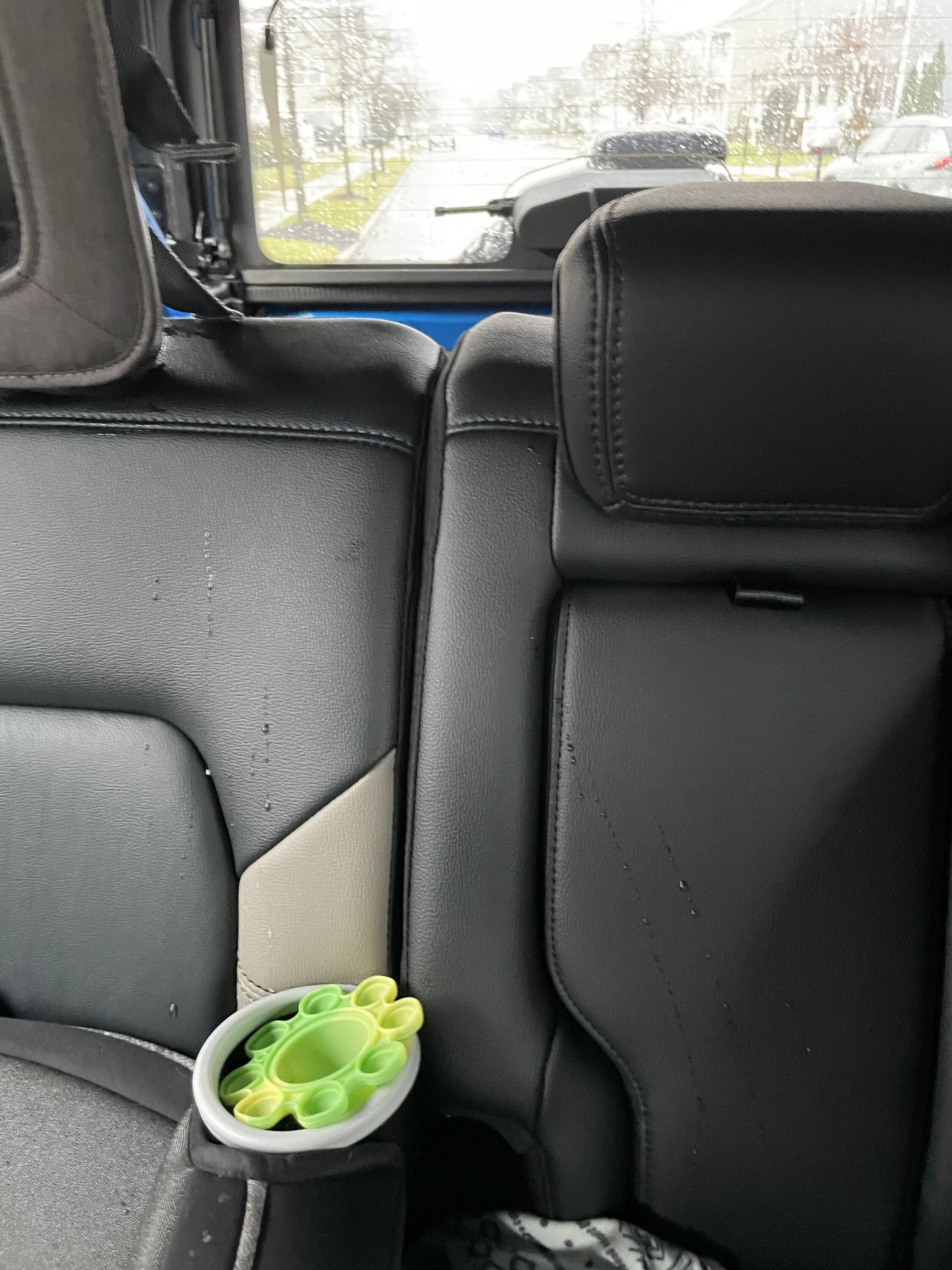

Anyone else having issues with their 2023 MIC Roof leaking? It’s rained pretty heavily today. Can’t quite make out where the leak is coming from. Possible mid roof panel where it meets rear/trunk roof panel? Haven’t had either section off yet.
I was parked on an incline in my driveway. I only realized I had it when I turned a corner and my kid complained the car was leaking on him. 😅

Thanks for your reply! I looked up your post and it was helpful too. I dried everything up …roof liner didn’t seem wet. Do you have one? Did you notice if it was wet or have any issues with it after the leaking issue?
My Bronco is getting seen for another issue on Mar 3rd (earliest the dealer can get it in) guess I’ll add this to their to do list lol.

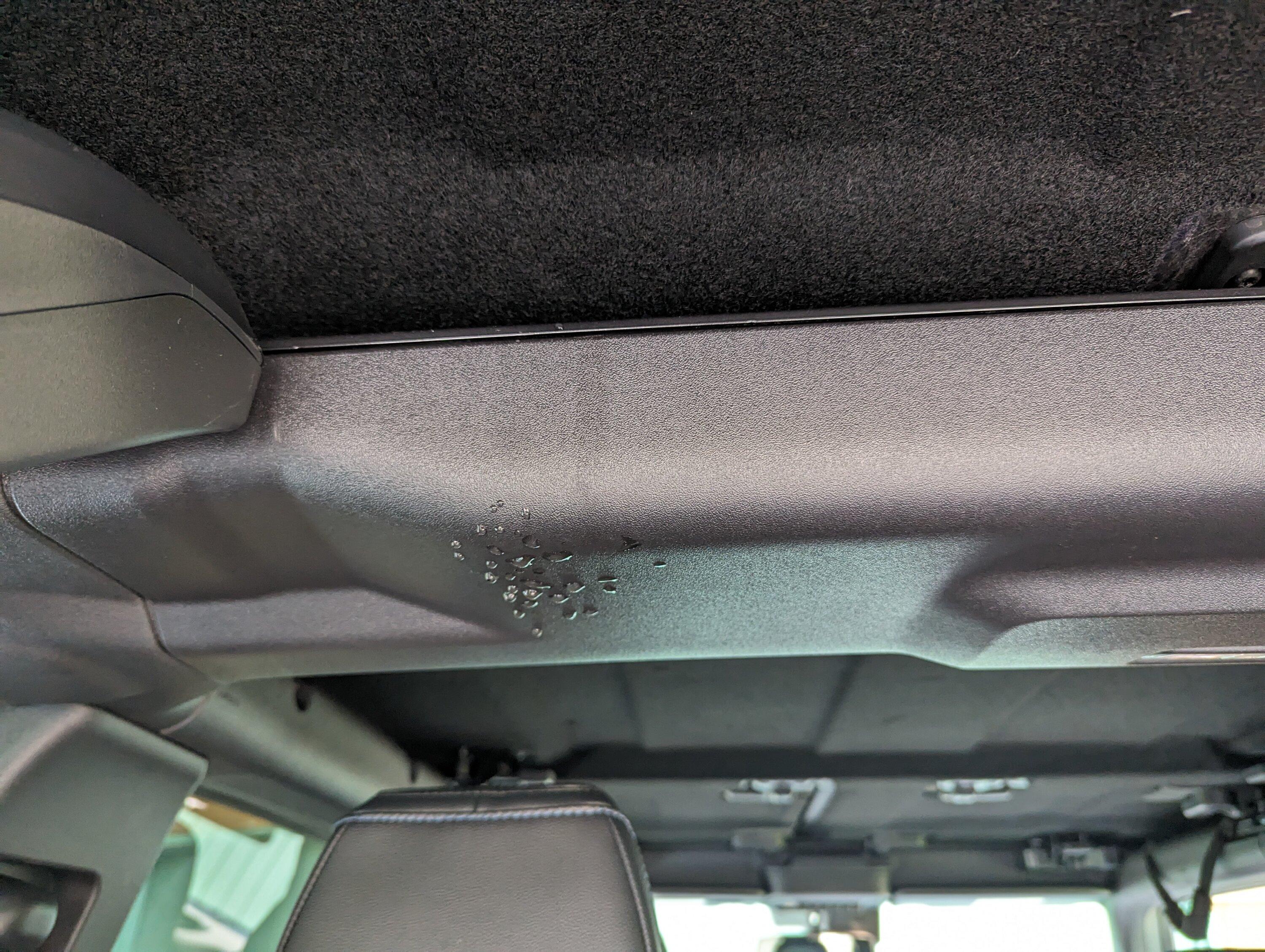

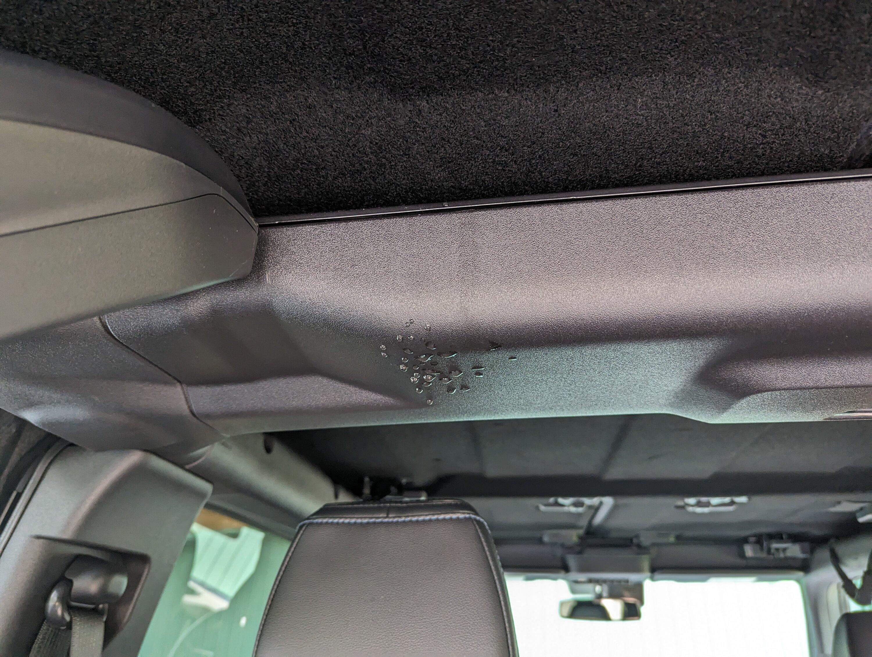

+1 for driver side A pillar leak on 2022 Wildtrak MIC top, just made an appointment with dealer to investigate.
Ford Bronco 2023 Bronco MIC Top Leak PXL_20230619_233540073
