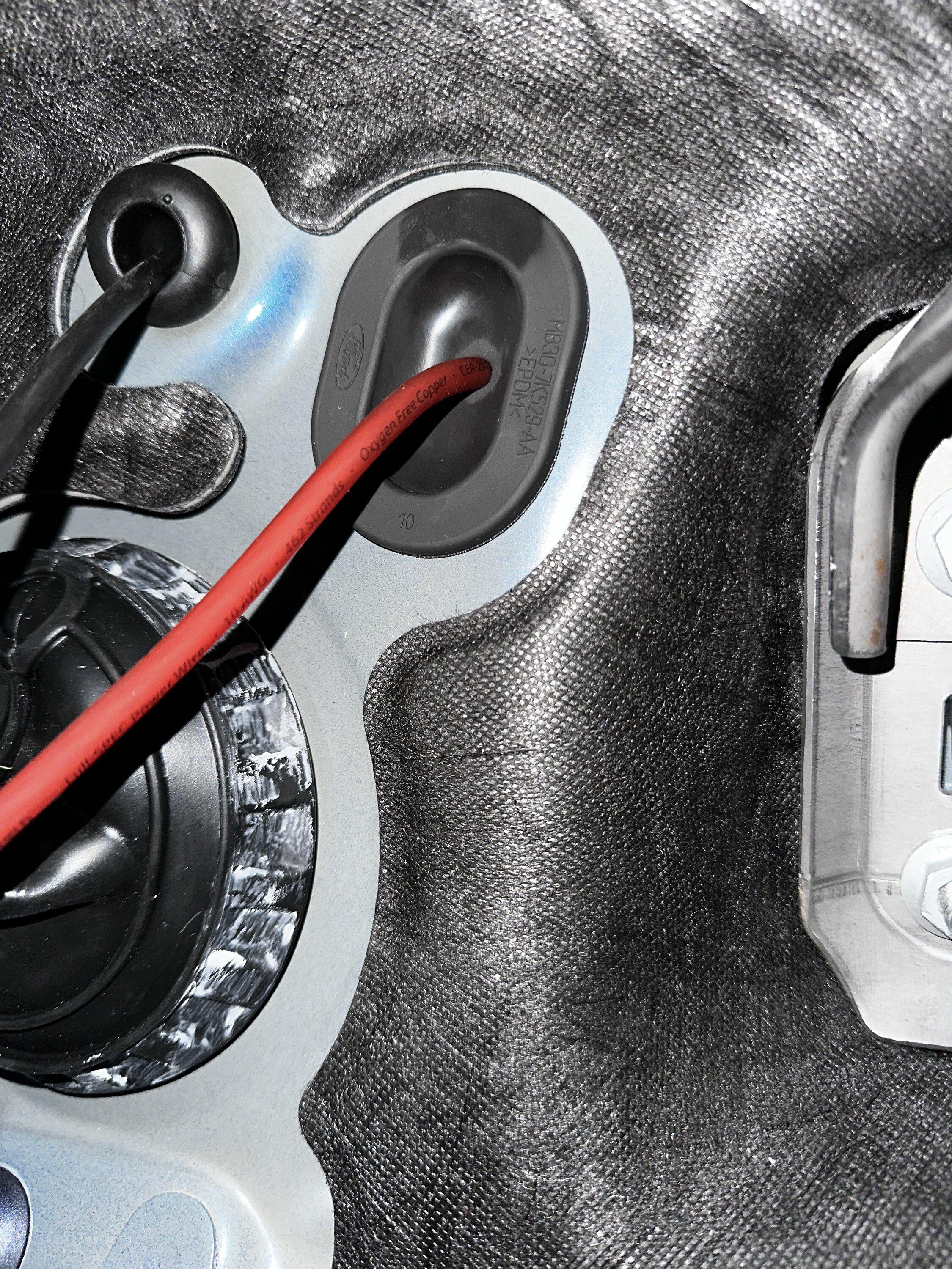

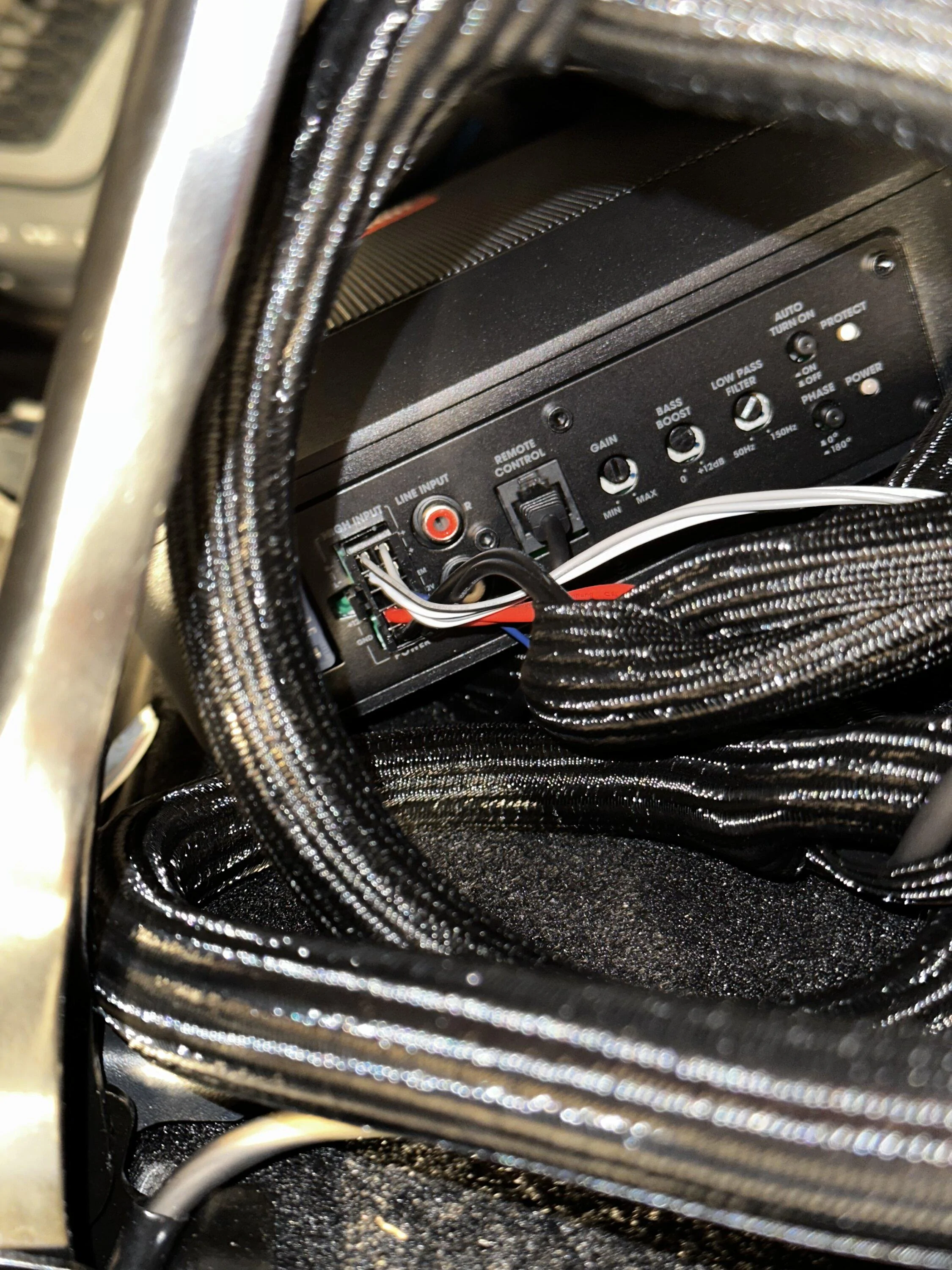

Coll man thanks! :) If you also have "settings" for the sub that would be great.....gain, etc....(no idea what is on it). Velcro huh? Sounds easy enough and good so I can remove it easy if going on camping trip. I like that you pointed out that I DO NOT need the rear 6 inch pods......I never usually have passengers. Sub and DONE. Love it. also, that " firewall grommet, behind the left kick panel speaker panel," - where exactly is it? and I don't need to remove the 6 inch speaker again do I?
thanks for the guidance man!
Attached is a pic of my sub settings. The firewall grommet is right on the firewall up to the left behind the pedals (attaching a pic of this too….you can see my red power cable going through the grommet for the powered sub). You won’t need to remove the 6” kick panel speaker again, but you will need to remove the plastic trim again surrounding it so you can hide all your cabling behind that kick panel trim.
