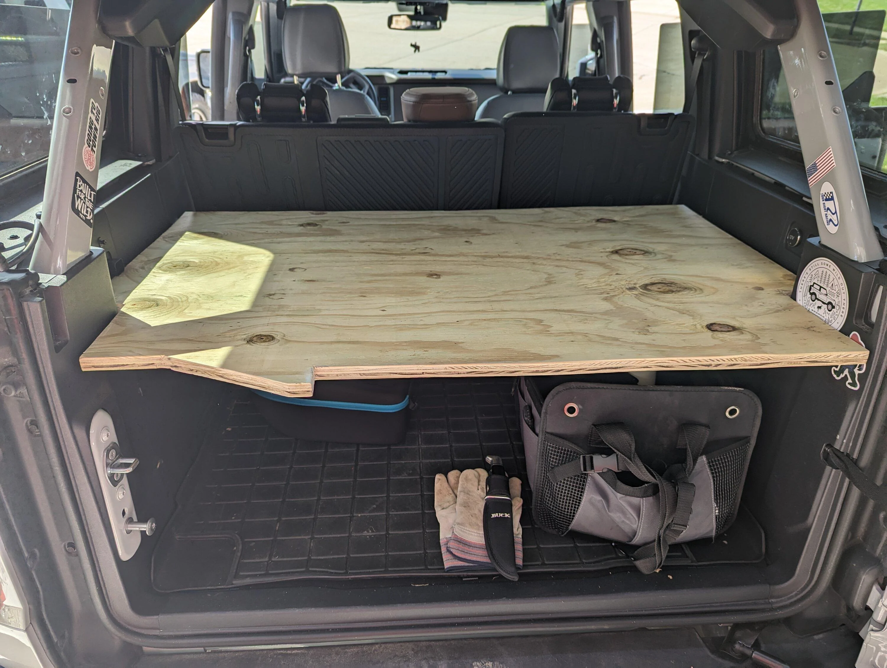

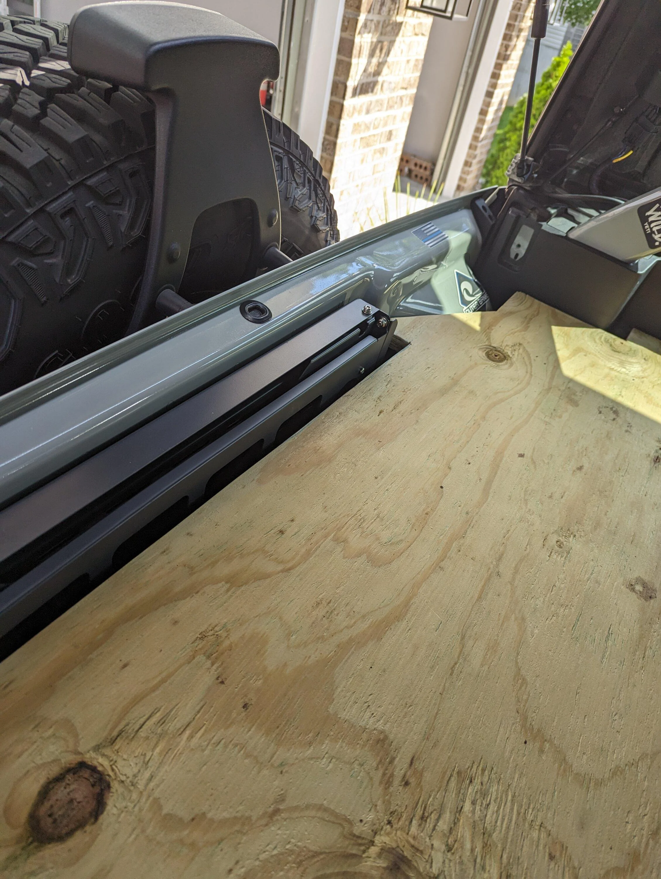

Another project started,(not yet finished) but I have been wanting to do this for a while. Needed a shelf for additional storage, and it also functions as privacy/cover so I can leave things in the truck when I have the roof off.
3/4" plywood. I used a cardboard box first to make a template so the wood fit nicely around the contours of the cargo area, hump in the tailgate, and my table.
Next steps will be wrapping it in carpet and possibly adding some framing underneath for added strength when stacking things on top.

Cool project, I considered that extra coverage but like the space for taller items along tailgate when packing for a trip, and the shelf doubles as a cargo leveler with some screw in legs when I sleep in there.
If you haven't purchased yet, this carpet matches back of seats well.
https://www.amazon.com/dp/B071SG24KY?ref=ppx_yo2ov_dt_b_product_details&th=1
Regarding extra support, I use a 3/4" sheet 2ft x 4ft across the same span, loaded up good with Frontrunner boxes, air compressor, and some tools... No additional support needed with 3/4" ply.

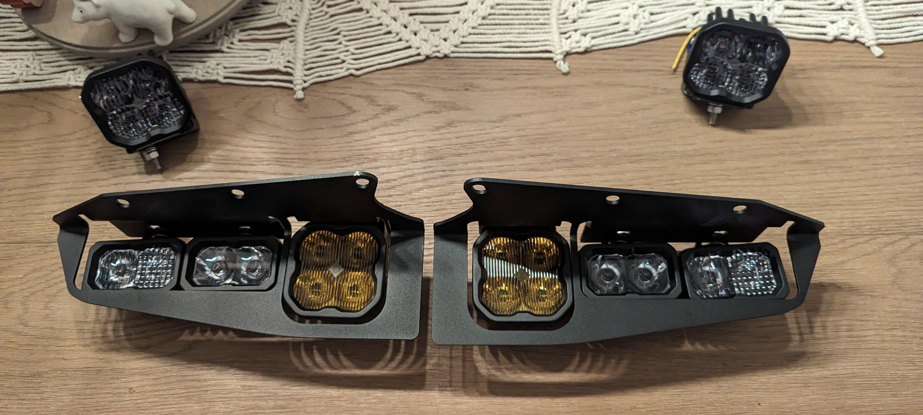

Had my eye on this exact lighting setup from @Diode Dynamics since before my Bronco was even built or delivered, and was patiently waiting for the Black Friday deals to snag them up.
With Diode's "base" level output, these lights are still putting out a collective 9,200 lumens, which will be plenty for my occasional off roading, camping, and dark country backroad drives. I spec'd a combo of SAE 3000K yellow fogs, spot beams, combo beams, and a set of ditch lights for a good all around option for any weather/road condition.
The kit from @4x4TruckLEDs.com with their KR flush mount bracket and wiring harnesses for the upfitter switches makes for an insanely easy install.
Had to order the stupid TP40 bit for the bolts on the modular front bumper, so they'll be installed as soon as the bit arrives!
Here are some pics of the lights assembled and ready to go on the truck in the meantime.

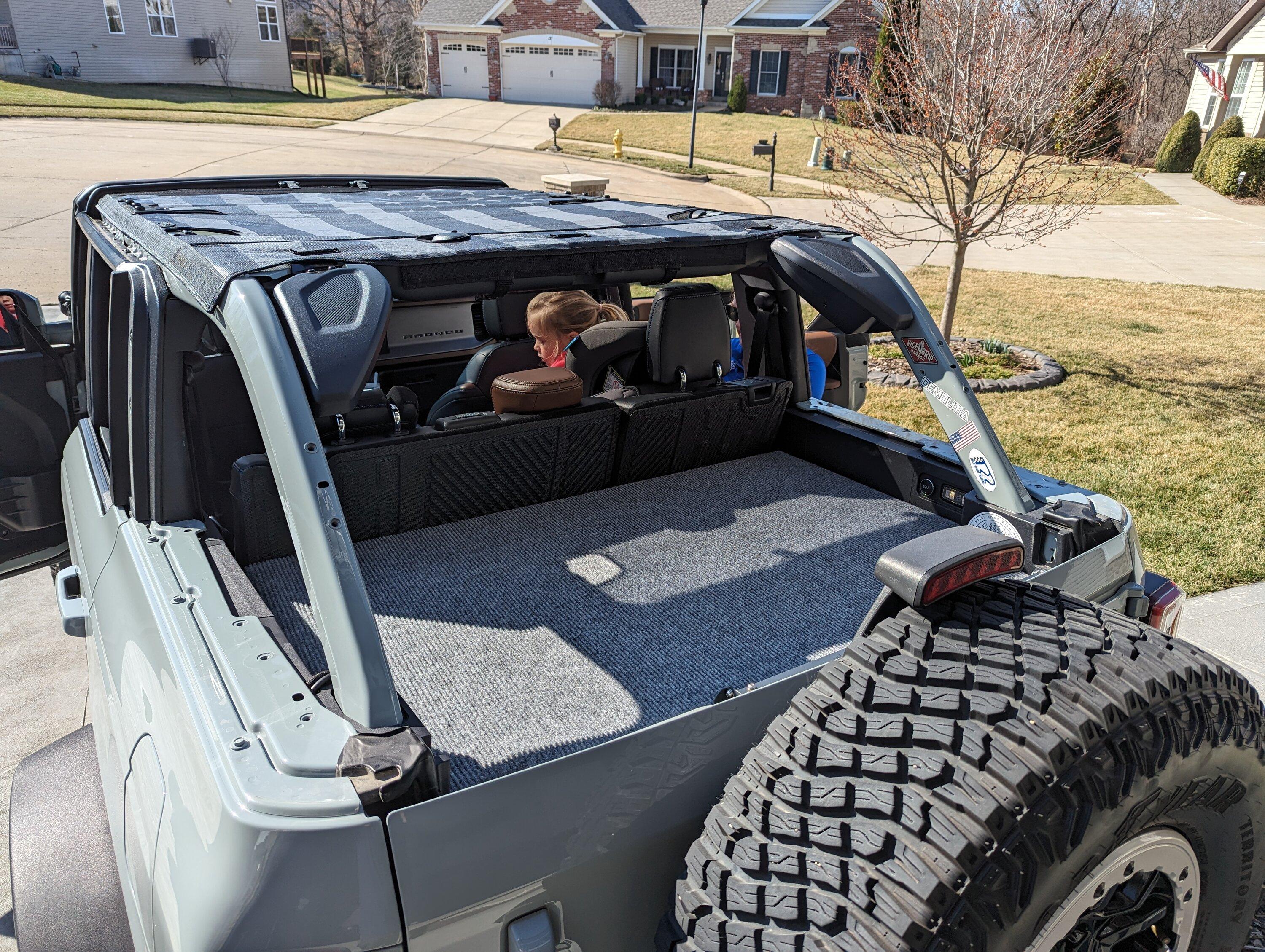

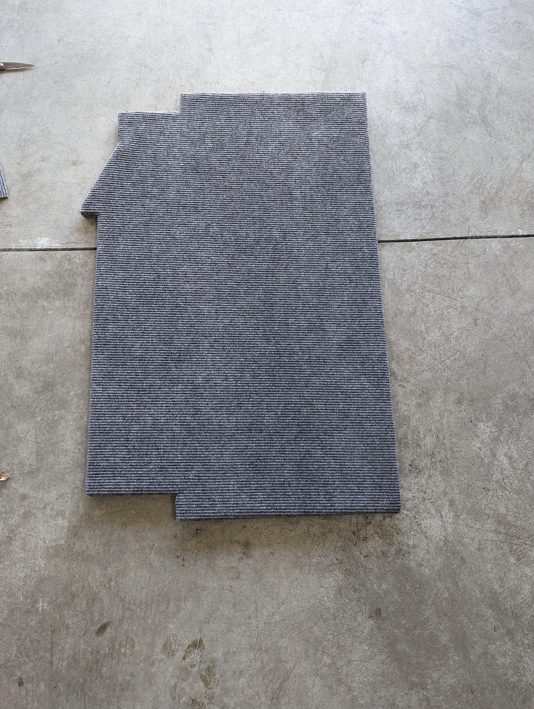

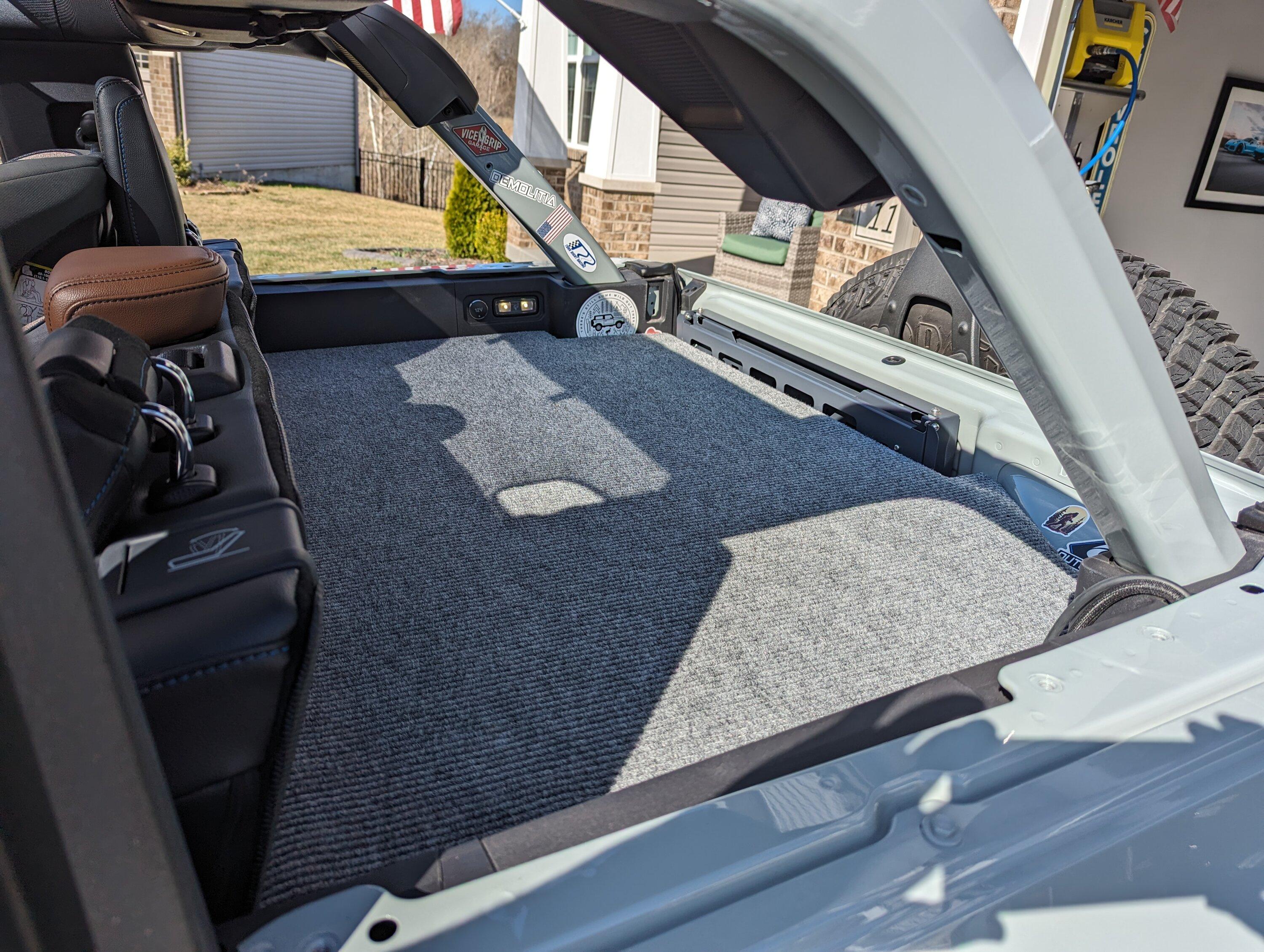

Finally got around to wrapping the DIY Cargo Cover in carpet, now that topless season is approaching here in the Midwest. Turned out great!
