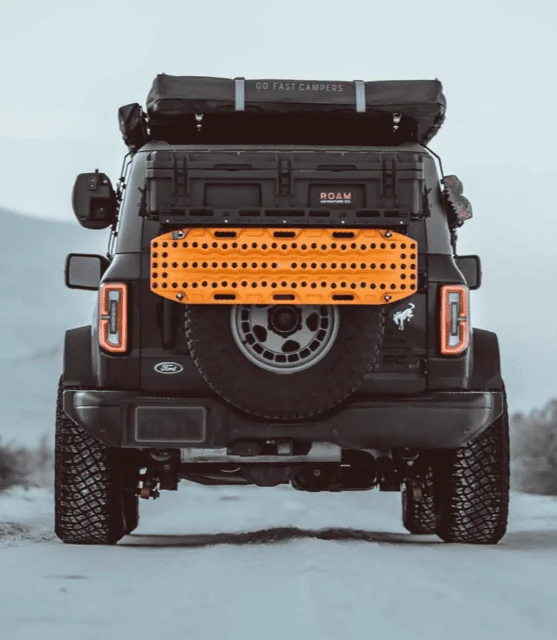

SAS tire/wheel weighs 90lbs. Add this thing and you're at 144lbs. @DV8offroad advertises "up to 37s". Ford says 140lb max? Those are engineers playing it safe. I see 37s with Rotopax and recovery boards on reinforced tailgates...no issues. Just look at the weight Justin McBride has on his tailgate. Well over the "Ford limit".
