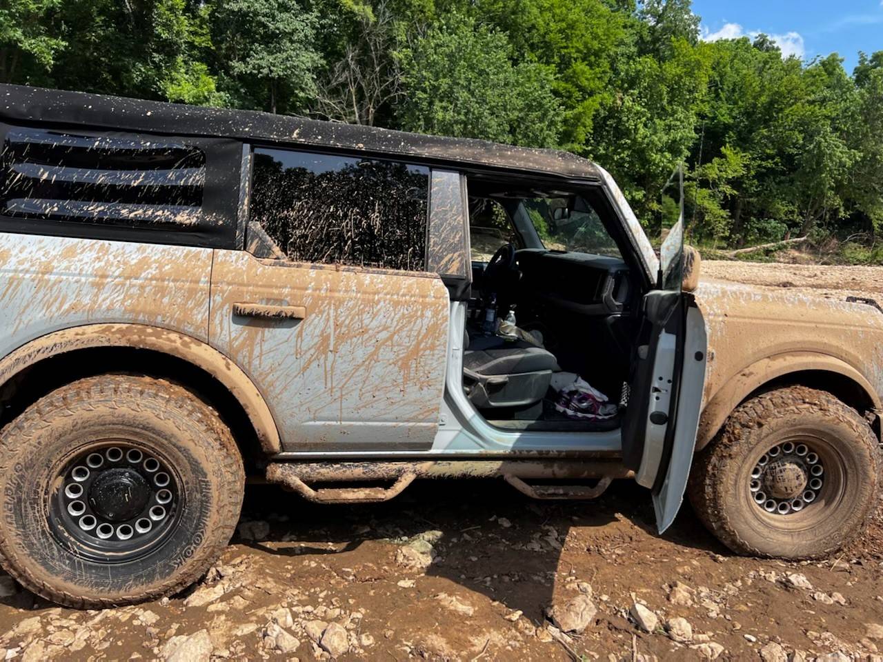

I put 315's (34.5") on the wife's Big Bend non-Sas with no lift at all. Just for street use too :cwl:

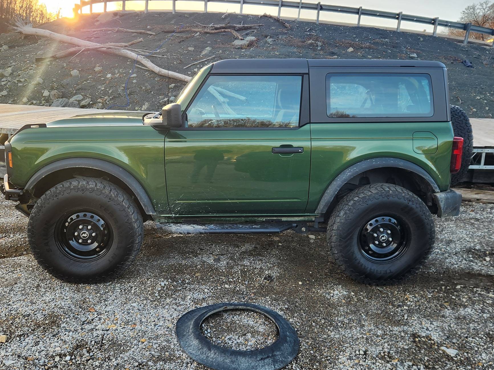

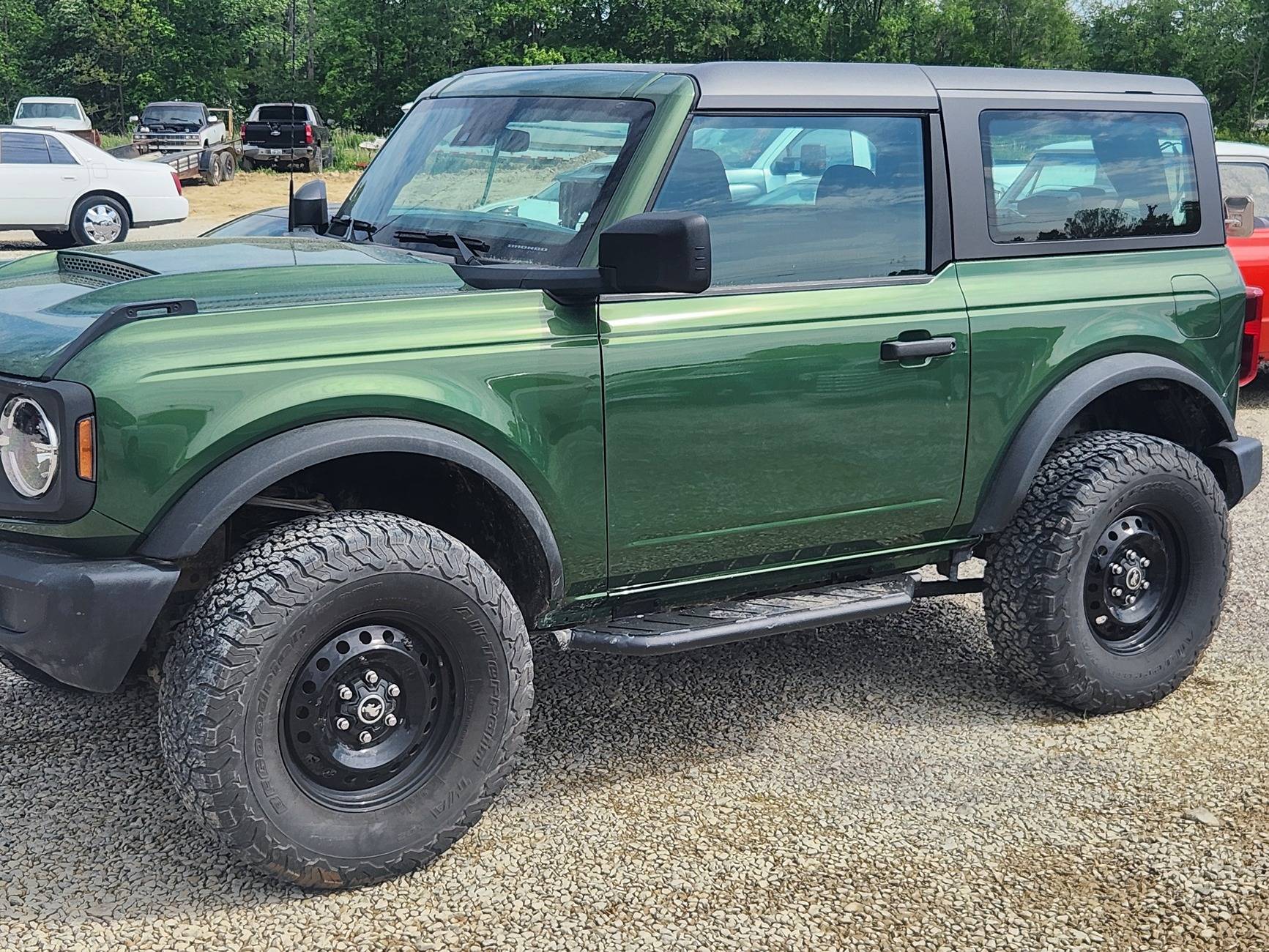

35 11.50 17 or a 35 10.50 you will be fine on stock wheel just remove crash . this has a 2 in lift on 35 a 2 in lift 1.5 wheel spacer and 37s no rub 37 12.50 this tire run skinny
