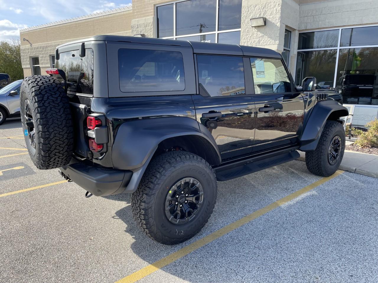

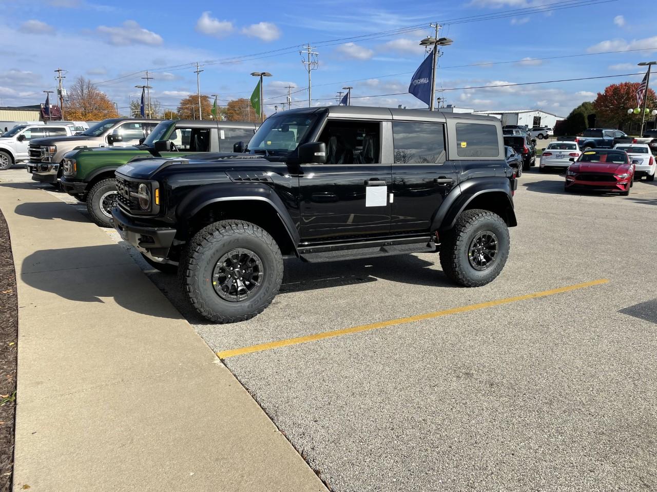

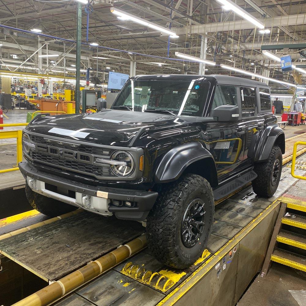

Before diving into Part 1, just wanted to share the blank canvas I started with. 2022 Bronco Raptor purchased new to my spec.
The Original Spec...
Colors: Shadow Black / Onyx MGV
Options:
-Raptor Series
-Lux Package
-Adaptive Cruise Control
-AM/FM 10 Speakers
-Heated Steering Wheel
-Wireless Charing Pad
-17" BLK FRGD Beadlock CPBL WHLS
-Code Orange Seatbelt
-Interior Carbon Fiber Pack

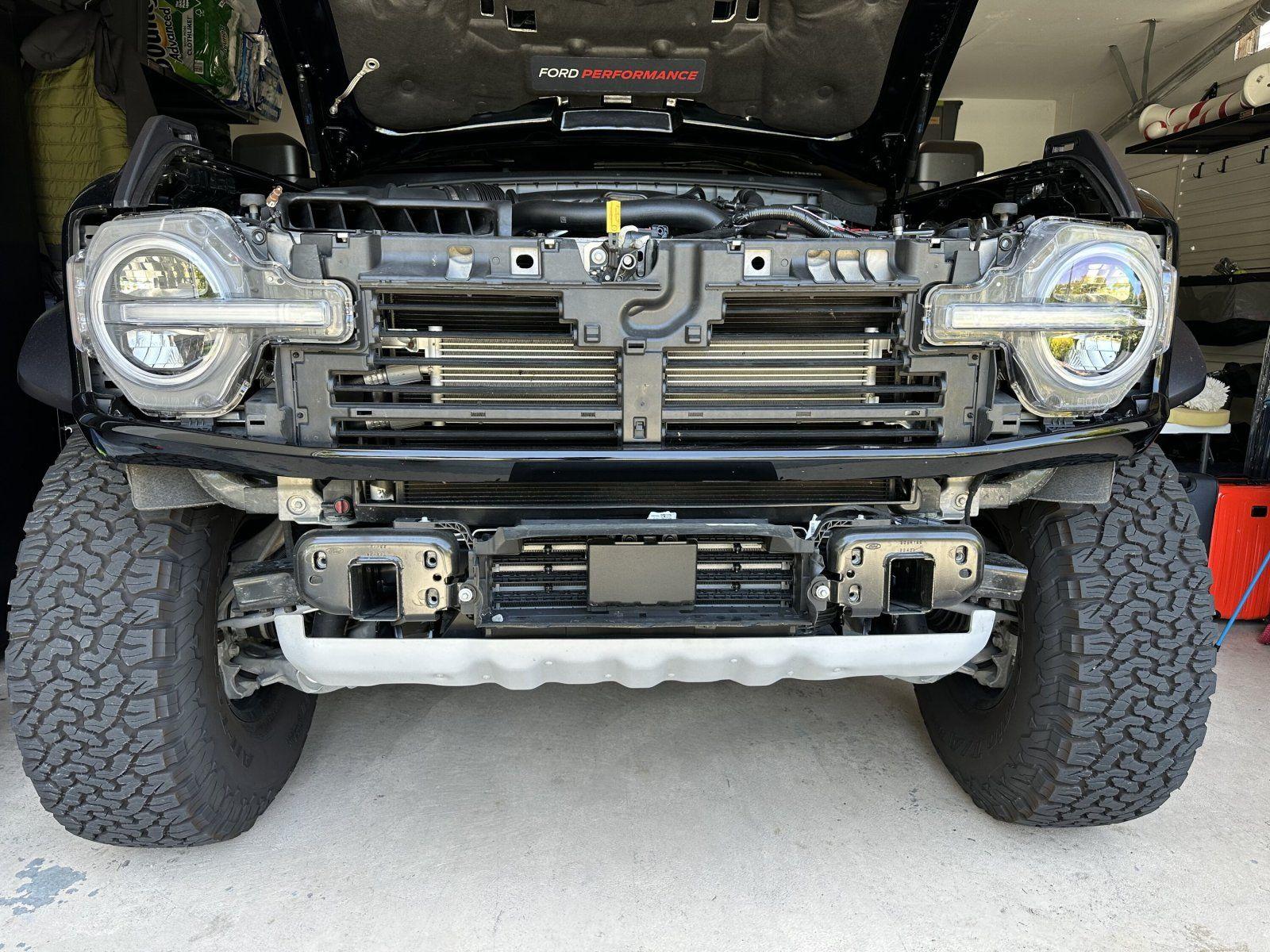

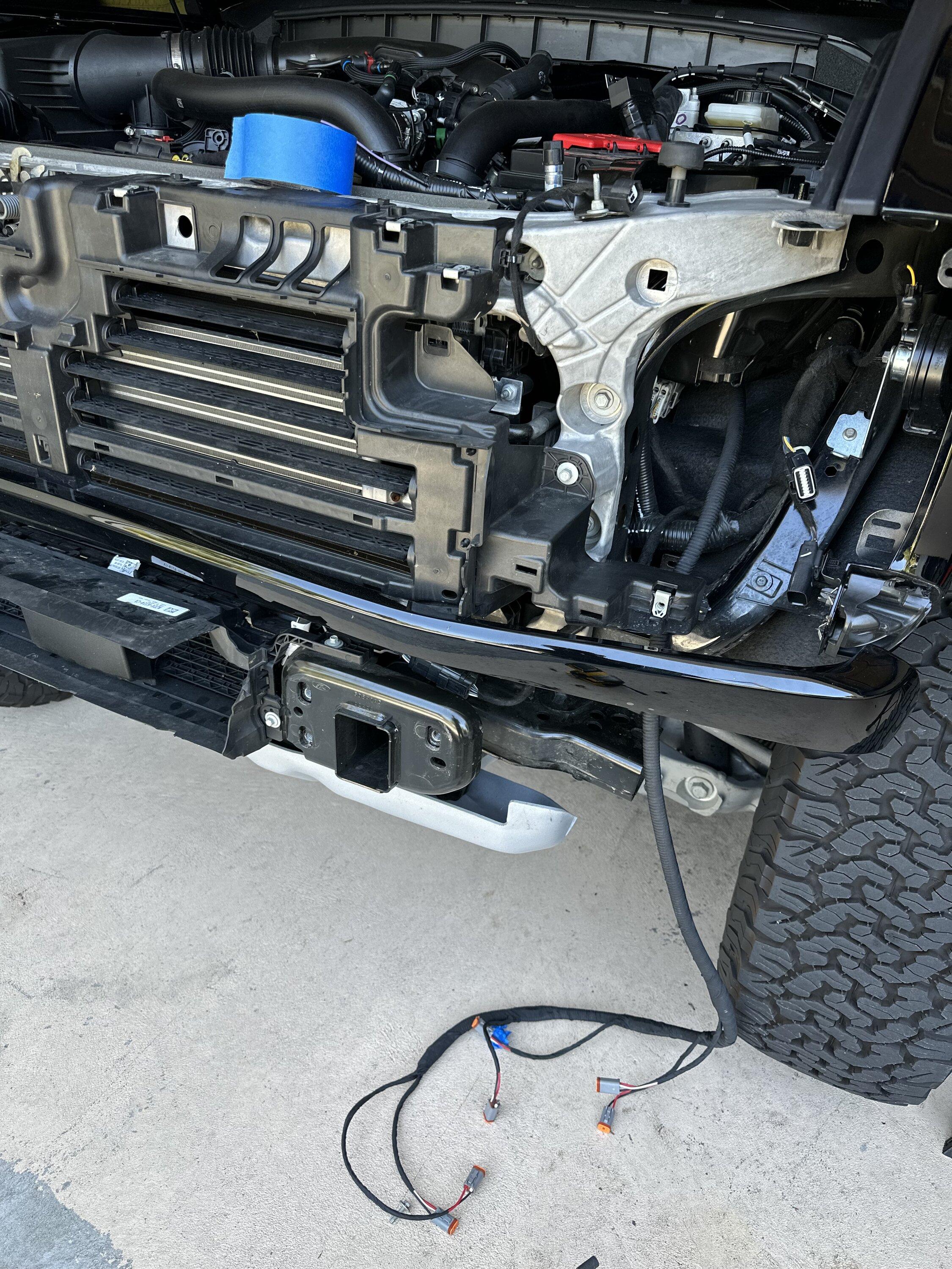

Prep Work...
The first step was to start to dismantle the vehicle.

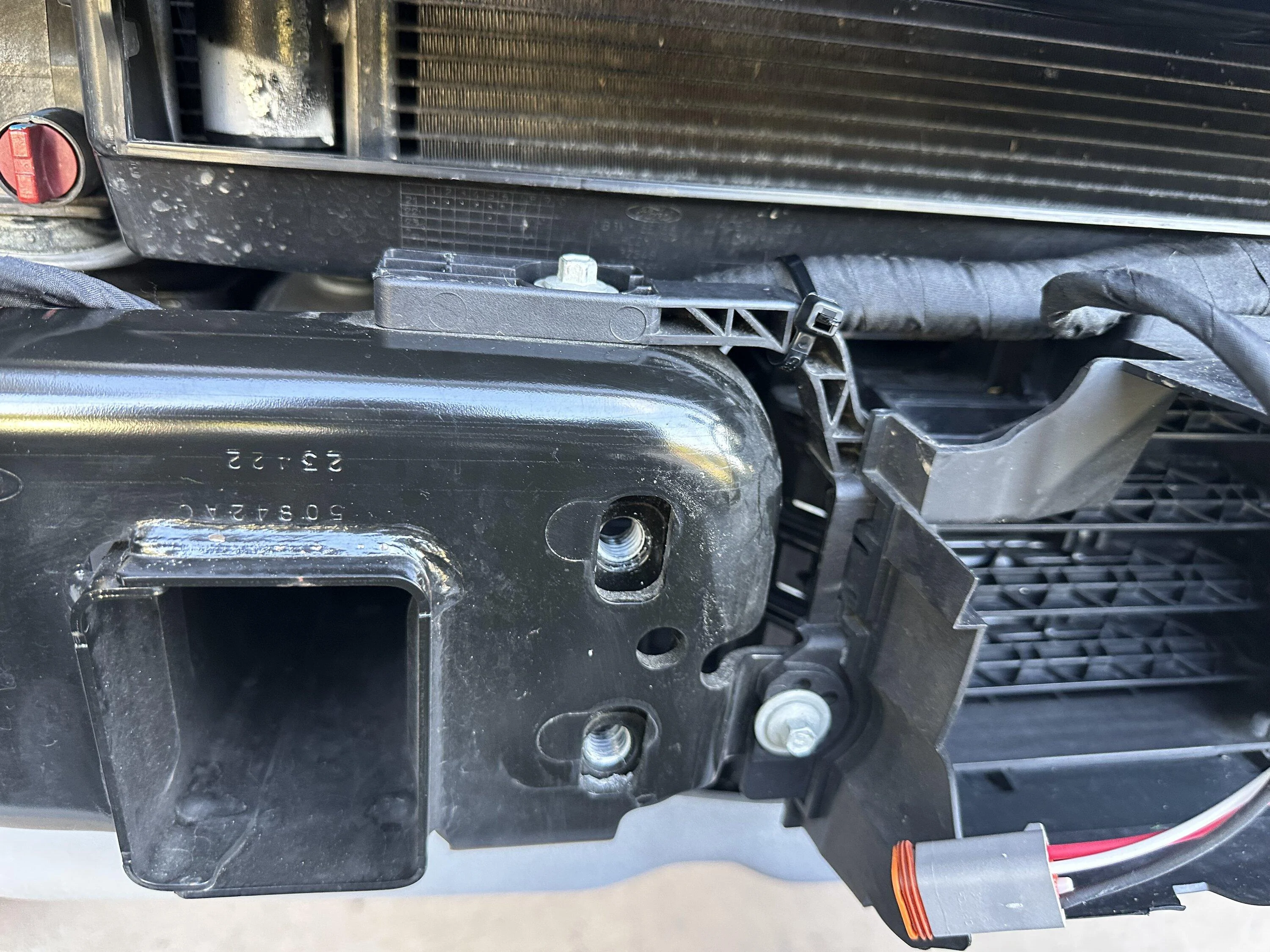

Ford Bronco 2 Thousand 22 | Bronco Raptor Build | Tye IMG_7830-2
[placeholder more pics coming]

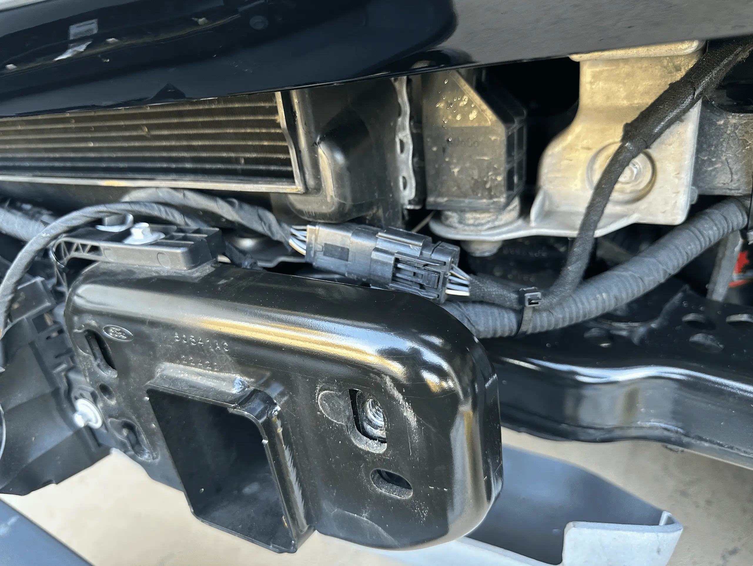

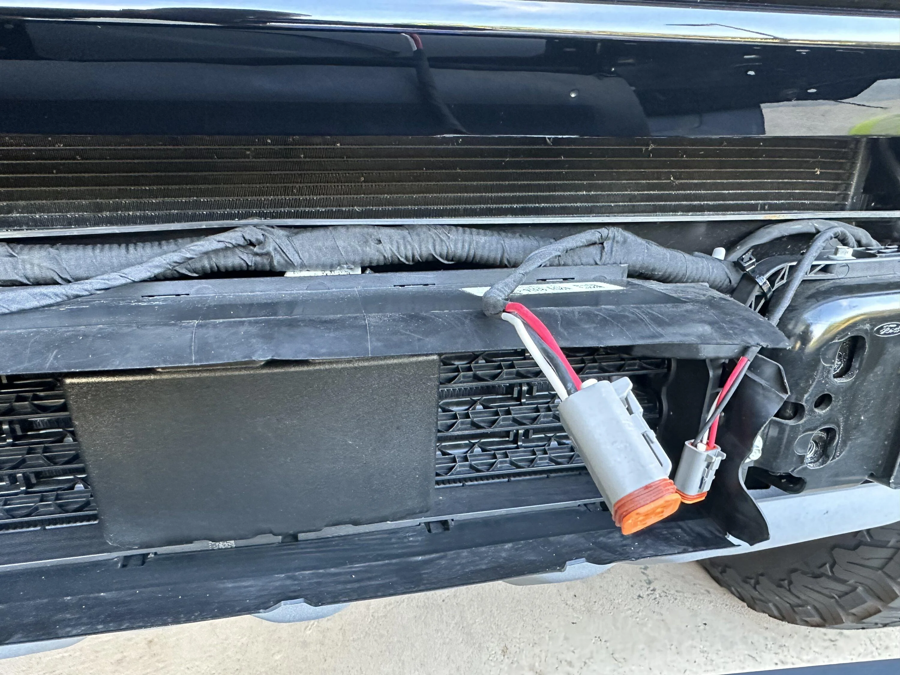

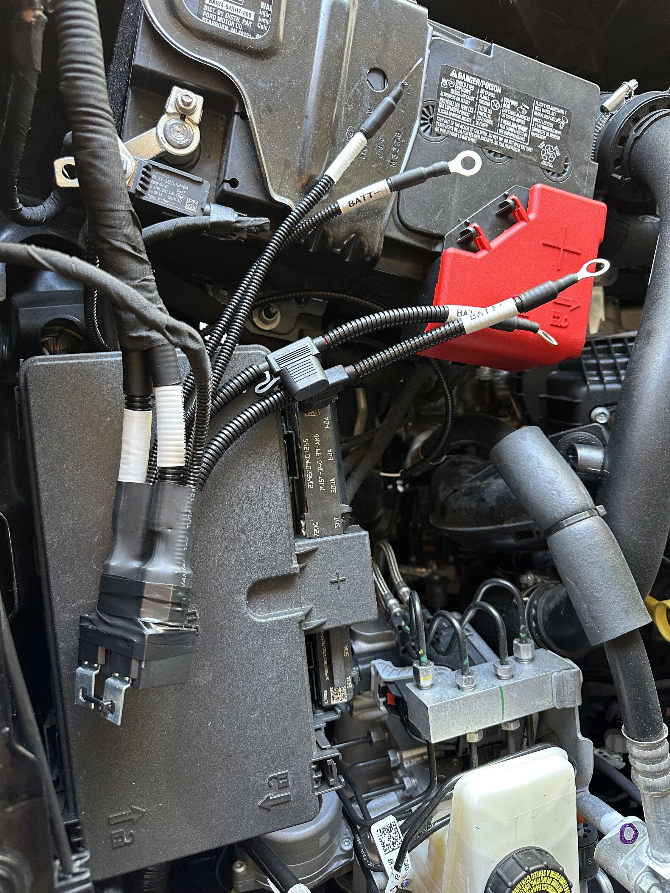

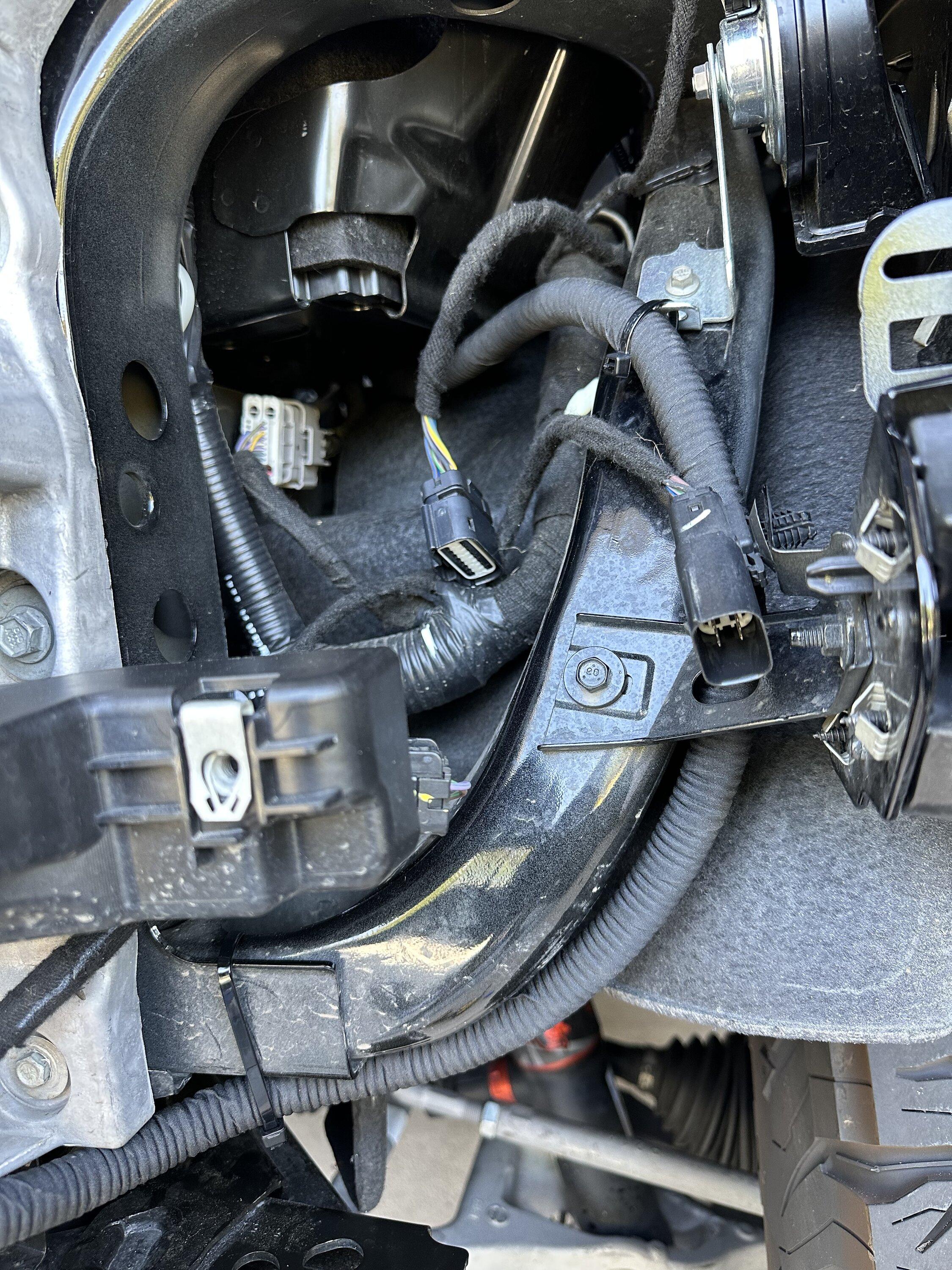

Wiring
Given the loads the Baja Designs lights pull, I wanted wiring that aired on the side of overkill. John at SPV was excellent to work with. For the 6 LP4 that are going on the front bumper, the harness for it is dual 10 gauge wires feeding 3 LP4’s each parallel to each other. 10 gauge is good for up to 30 amps. So there is plenty of cushion on that main line. The individual lines to each light are 14 gauge. While it may be overkill, I also wanted to secure the wiring along the whole length and keep it neatly tucked out of the way.
Ford Bronco 2 Thousand 22 | Bronco Raptor Build | Tye 70872797857__2A885792-85D0-4849-82EE-CD93A38FE123
Ford Bronco 2 Thousand 22 | Bronco Raptor Build | Tye IMG_7837
Ford Bronco 2 Thousand 22 | Bronco Raptor Build | Tye Screenshot 2023-06-27 at 4.27.40 PM
Ford Bronco 2 Thousand 22 | Bronco Raptor Build | Tye IMG_7845
Ford Bronco 2 Thousand 22 | Bronco Raptor Build | Tye IMG_7846
Ford Bronco 2 Thousand 22 | Bronco Raptor Build | Tye IMG_7831
