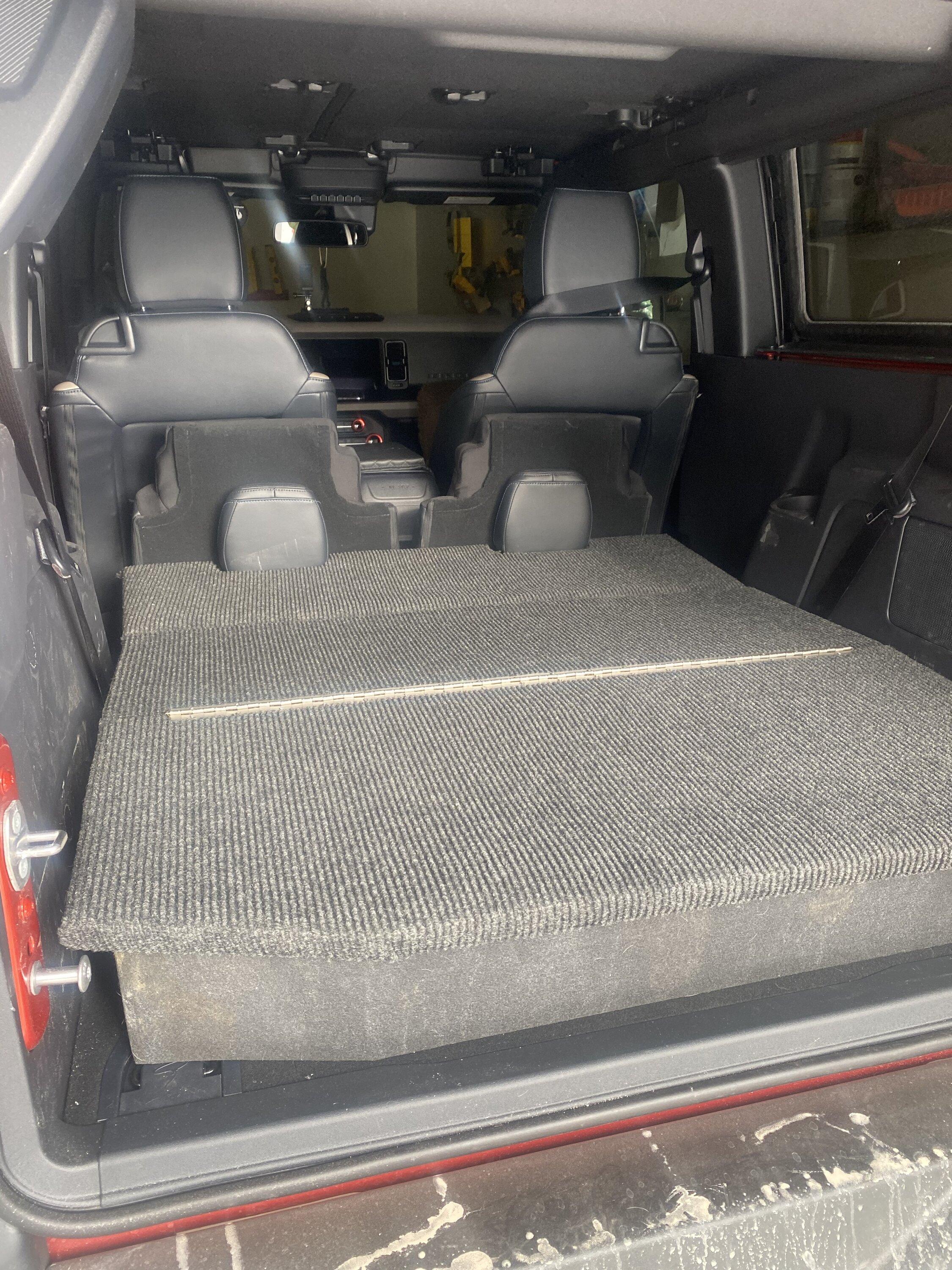

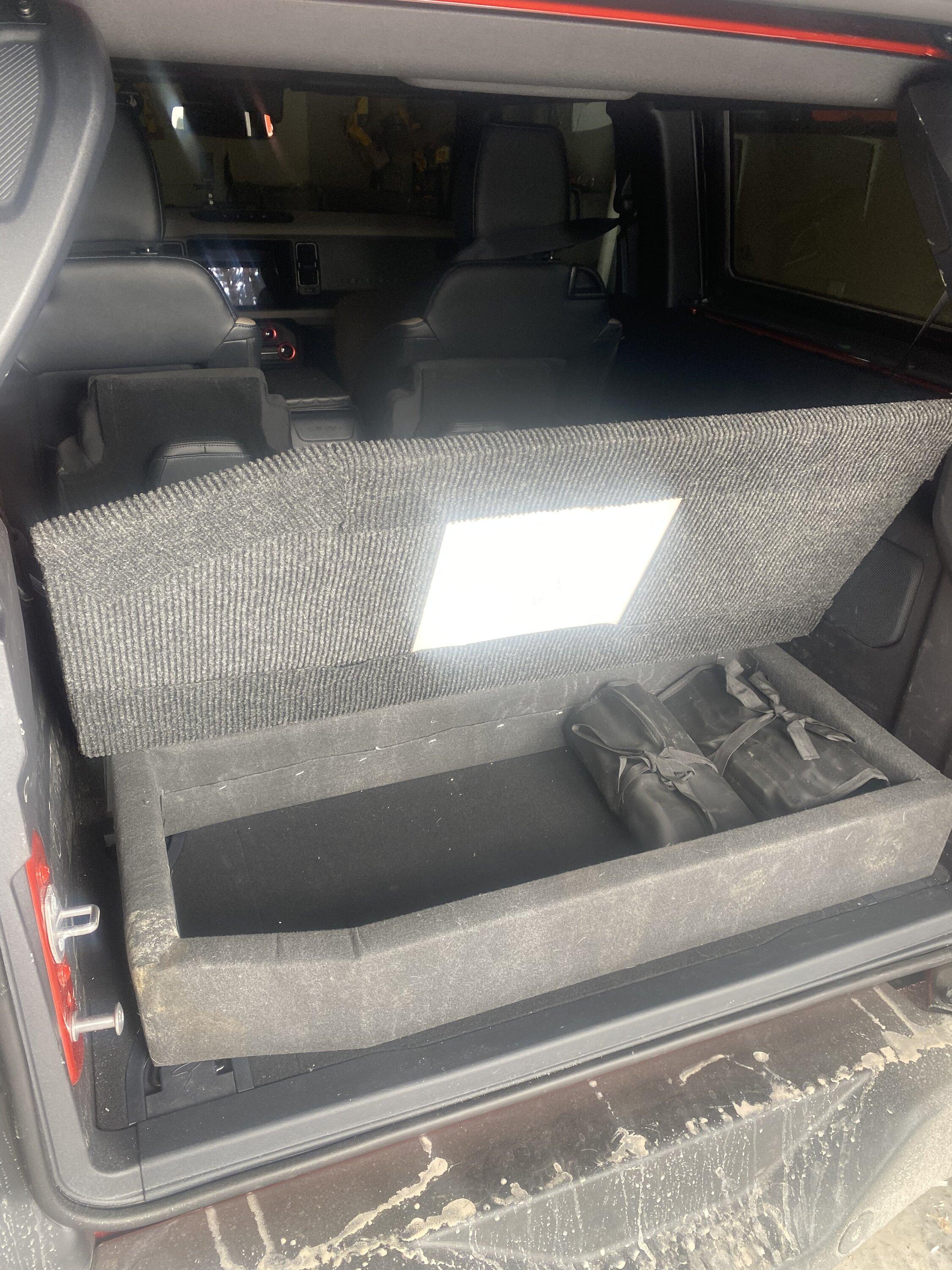

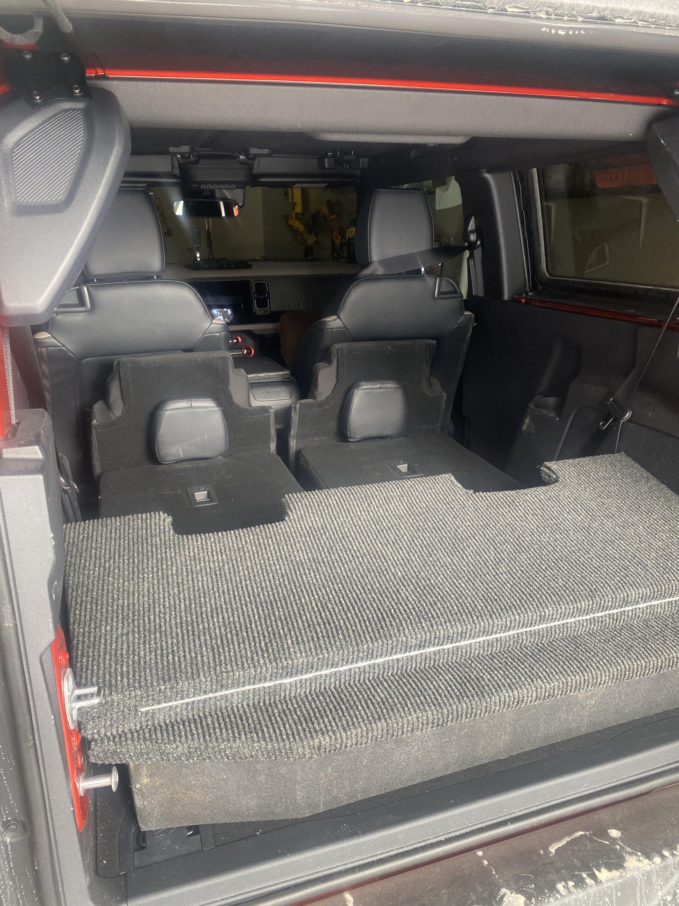

Just implemented this design. Easy project with just basic hand tools. I used scrap material I had laying around so cost was well under $100 (for the carpet and hinges).
Material used was 2x6 for the ”box” at the tailgate and 3/4” MDF for the actual platform (stuff I had laying around). Went to Lowes and bought a 6’ x 5’ piece of carpet. Make sure it doesn’t have a backing on it because you want to fold it around the edges of your platform. And a 6’ stick of piano hinge (aka “continuous hinge”). $25 for the carpet. $35 for the hinge.
My implementation deleted the arms going forward alongside the rear seats and between them. I just let the platform rest on the seat backs. Sturdy enough to easily support my weight back there. I have no intention of hauling a freezer, gun safe or anything ridiculously heavy back there.
You can see that there is a slight incline at the very front because the seats are just a little bit higher than the 2x6 box at the tailgate. I used 2x6’s because that’s what I had, I would imagine a 2x8 would give you a more level look of that’s important to you.
Another thing I considered - if you want the platform even higher - instead of arms going alongside the seats consider folding table legs to support the front edge of the platform. At that point you could use 2x12s giving you a deeper box in the rear and a higher platform. I opted against this based on the fact that I built this for the dogs and didn’t want them riding too high (and the fact that I already had 2x6’s laying around)
Would recommend this as a weekend project for any 2 door owner looking for an inexpensive and functional rear platform design.
SAFETY WARNING: Nothing is bolted down so in case of accident or rollover there is a serious risk of this thing becoming a real threat to life and limb inside the cab. You can bolt the box down to the Bronco tie-down points to help there. But the platform itself is designed to be free floating. So be aware of this.
