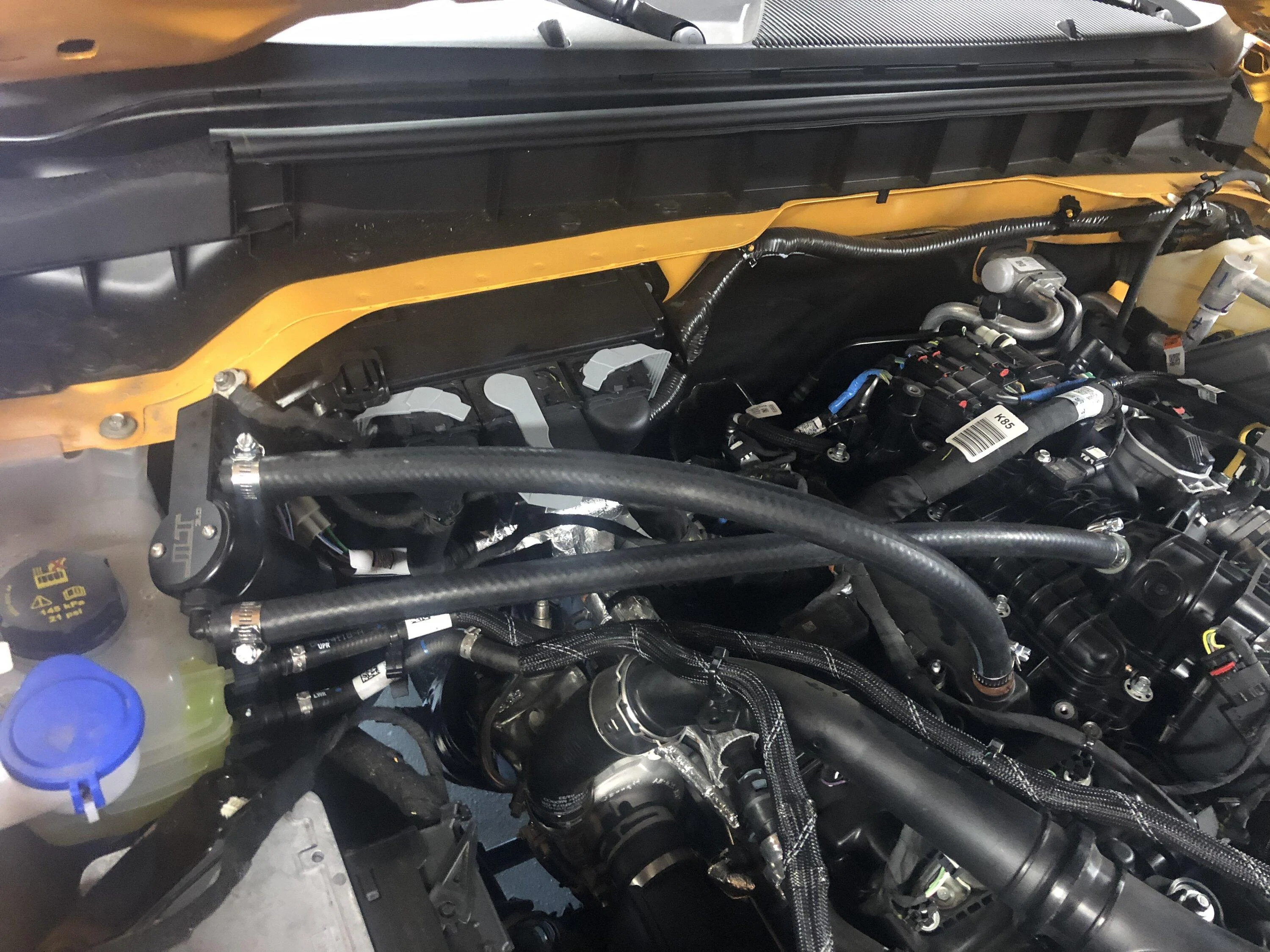

Hey,
just installed my JLT catch can from my old Silverado. Just got some new hose and was able to repurpose the factory fittings.
catch can installed at 2500 miles.

Nice! How long to install you think?

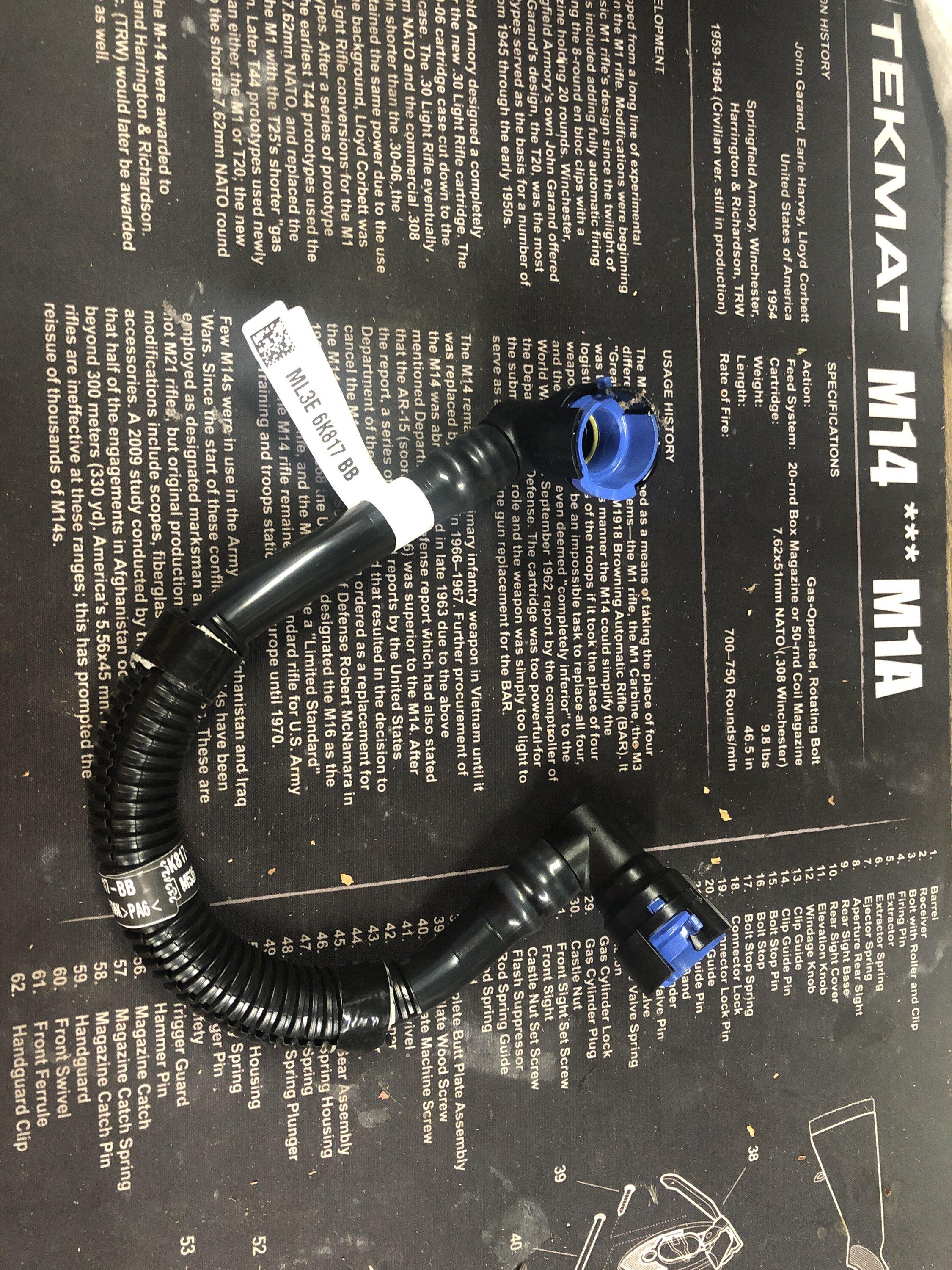

about 15min. Longest part was finding a video on which hose goes to the intake. Then going to auto parts store for hose/clamps. Pretty basic. If I had some metal stock I would have routed the can to a different spot. But it works, and out of the way. When I go in for service, I’ll just disconnect the hoses and plug the factory back in.

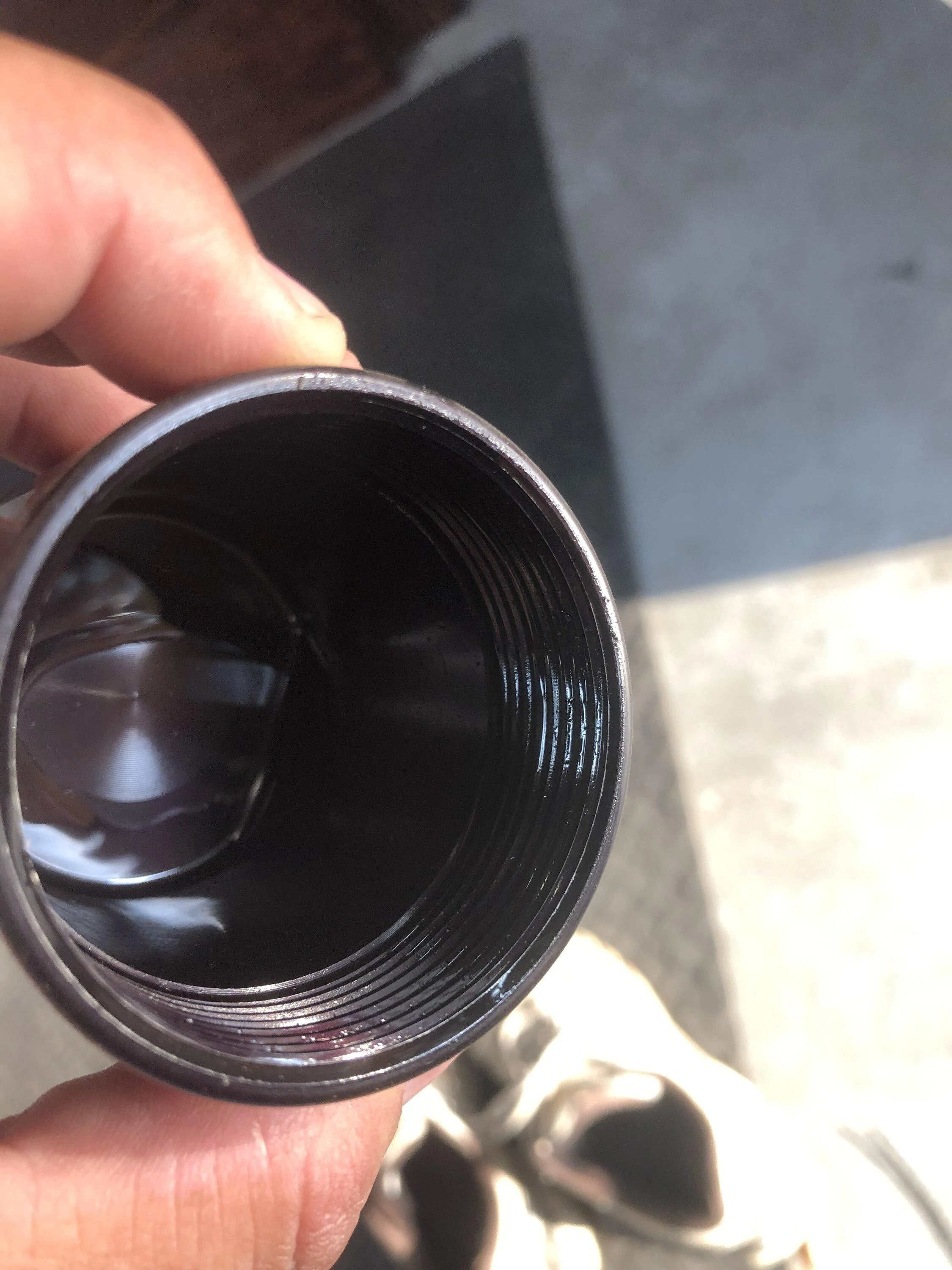

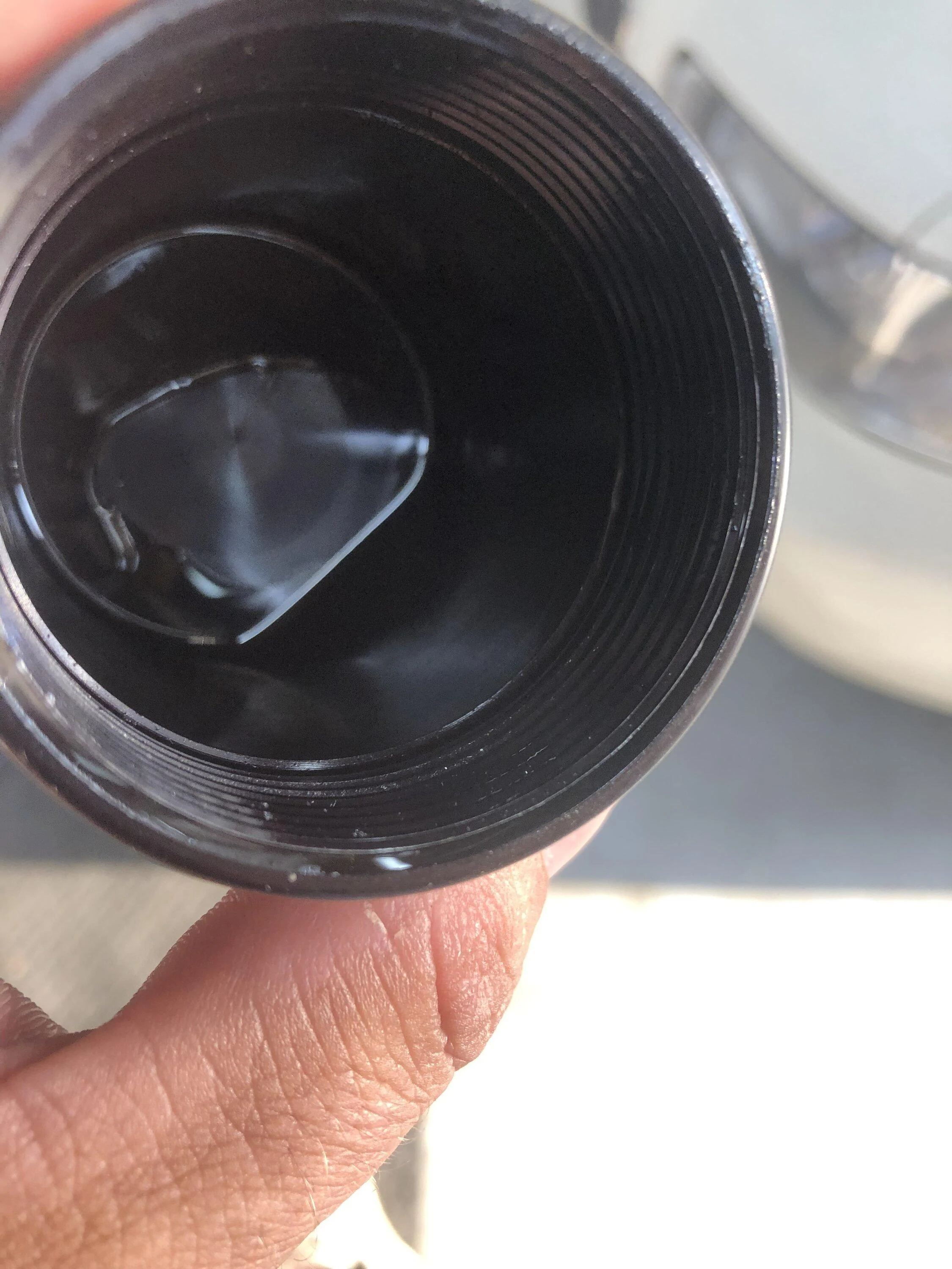

600 miles, not much of much.
