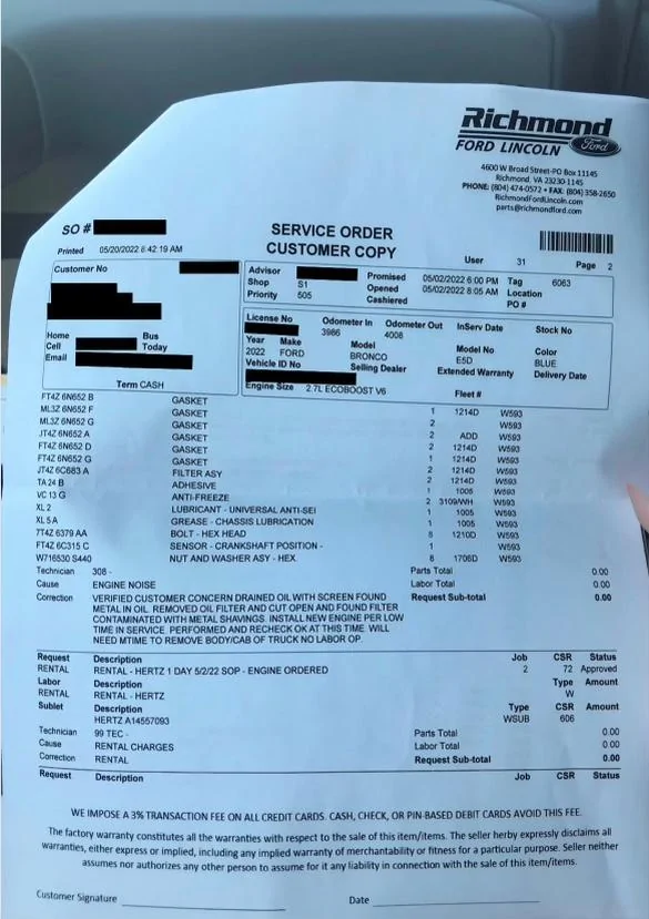

Yes, I passed this along last week when they put the new one in. The engine didn’t fail but was on the road there. I took it in with “valve ticking” noise. Diagnosis was inconclusive and they replaced the engine. As you can see from the service report, metal shavings were found in my oil filter so it was just a matter of time before it failed.

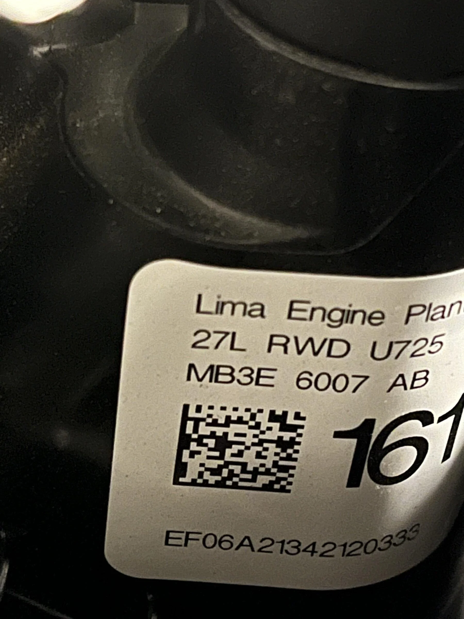

BLOWN ENGINE INFO (blew 3/13/22):
Lima Engine Plant
27L RWD U725
MB3E 6007 AA
[QR CODE] 121
EF06A21131120036
NEW ENGINE INFO (installed ~4/18/22):
161 [QR CODE]
27L RWD U725
Lima Engine Plant
MB3E 6007 AB
EF06A22032120713

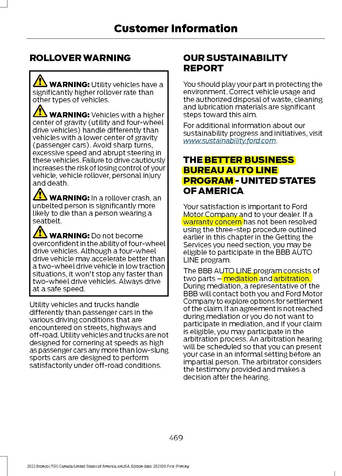

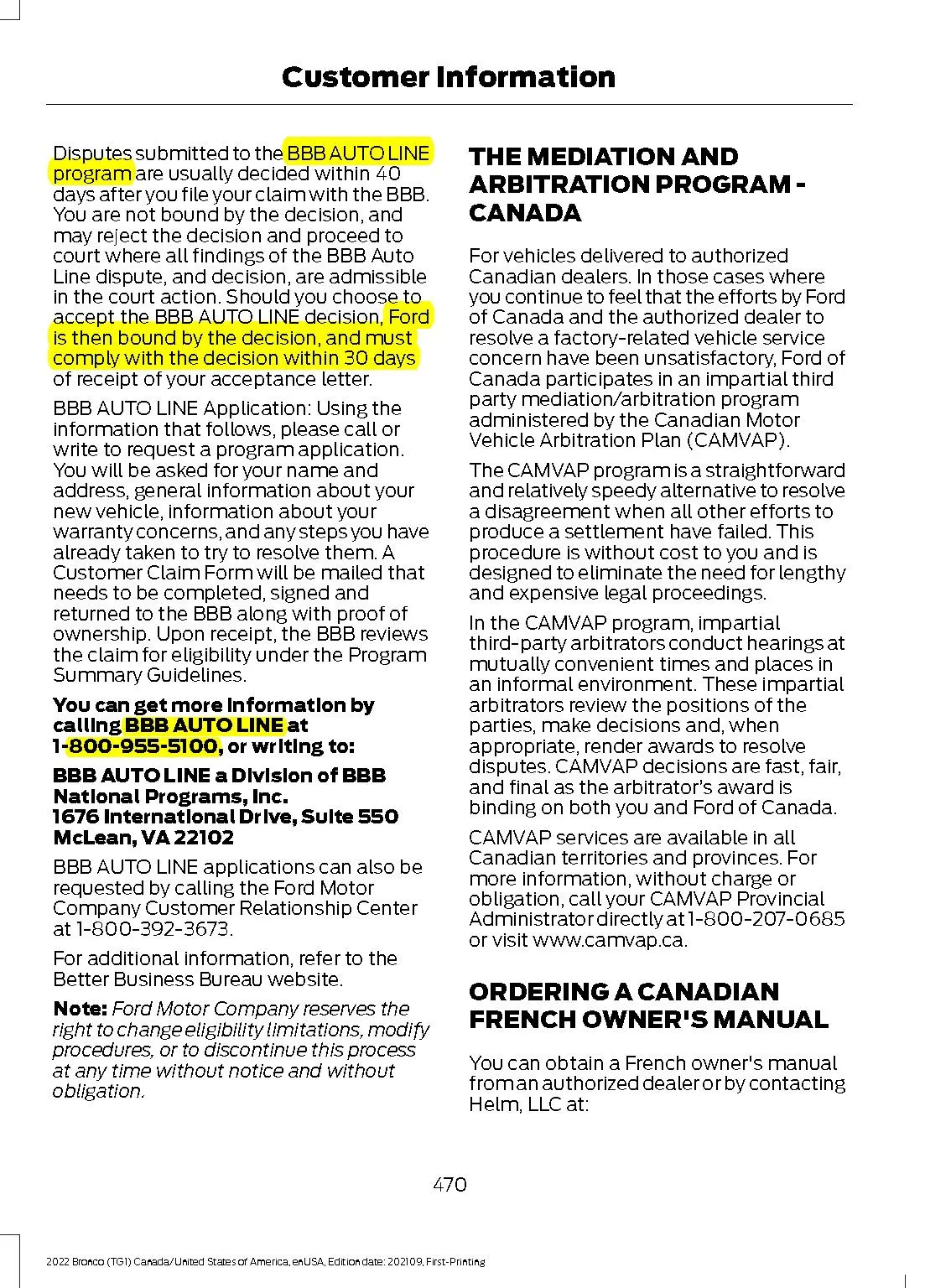

if Ford is not cooperating to provide you w consistent professional repairs & compensation package, there's another avenue - you can contact BBB
for example, @G-Red had a 2.3L bad turbo replaced , and he got repairs & compensation package better than most 2.7L blown engines !
he did this by filing a Case w BBB , who arbitrated with Ford Motor Co on his behalf
this BBB mediation/arbitration procedure is described in the Owner's Manual - and Canada has similar program called CAMVAP
Ford Bronco 2.7 Blown Engine Owner's Experiences Owners Manual p469
Ford Bronco 2.7 Blown Engine Owner's Experiences Owners Manual p470
