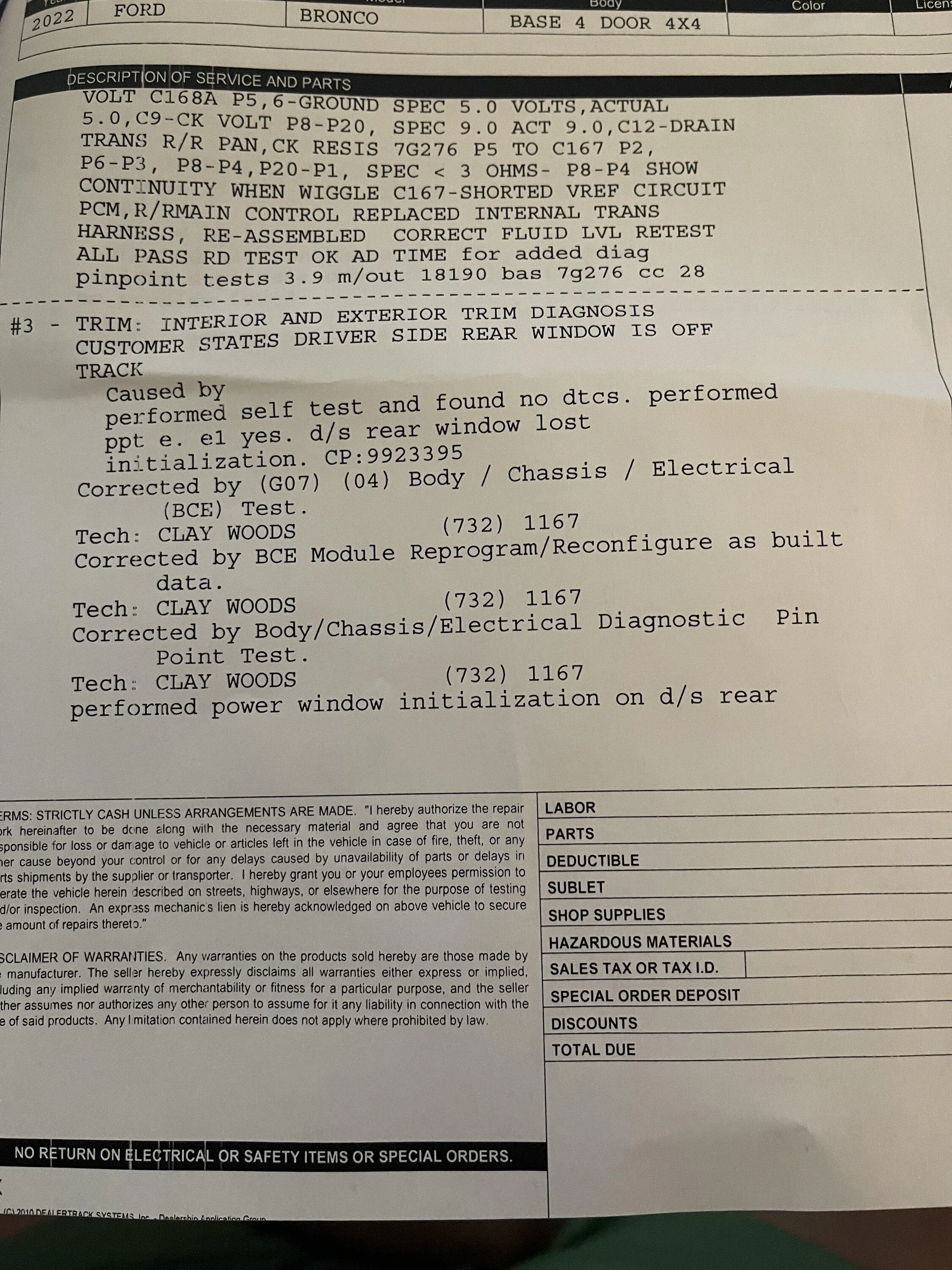

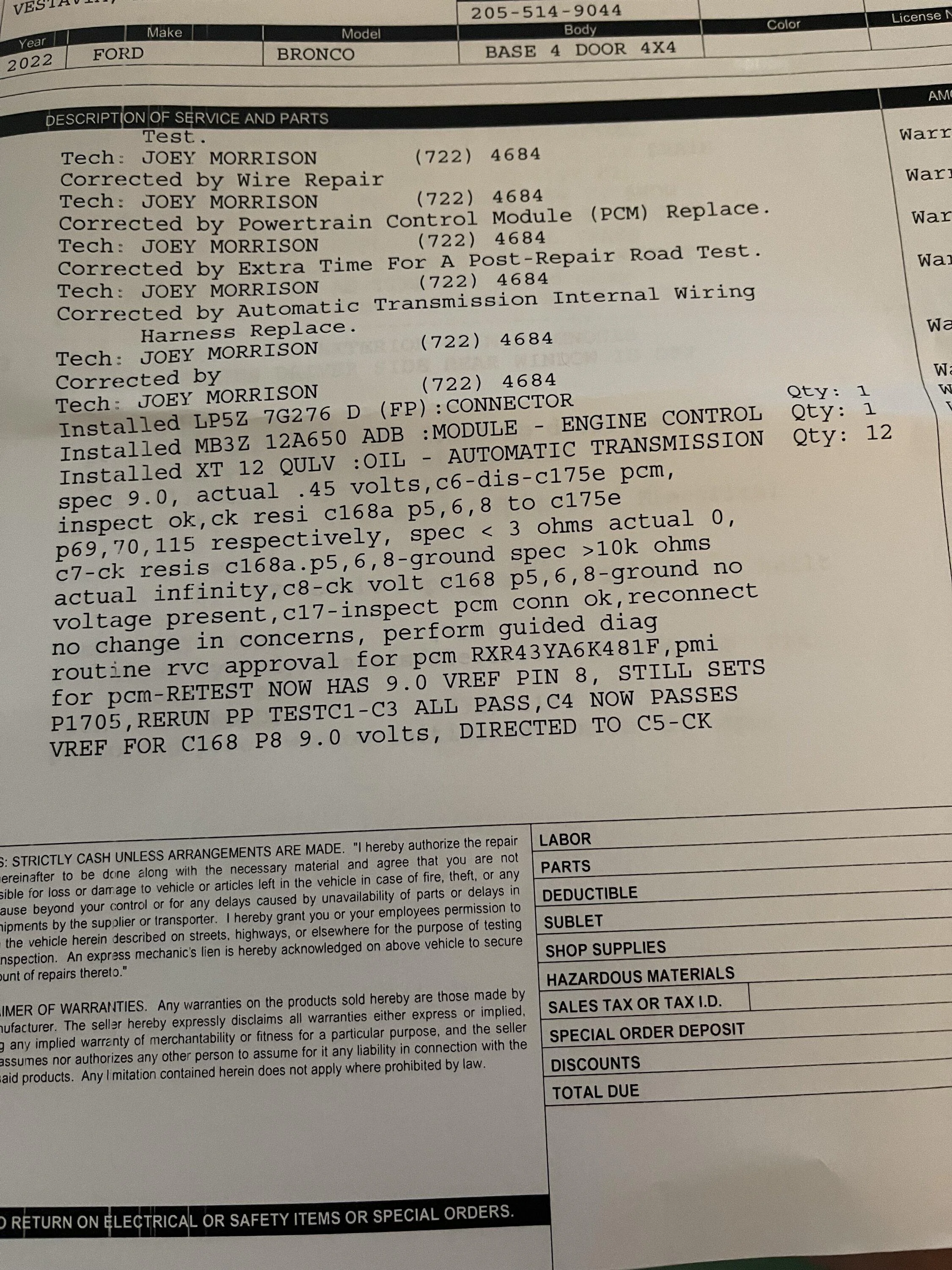

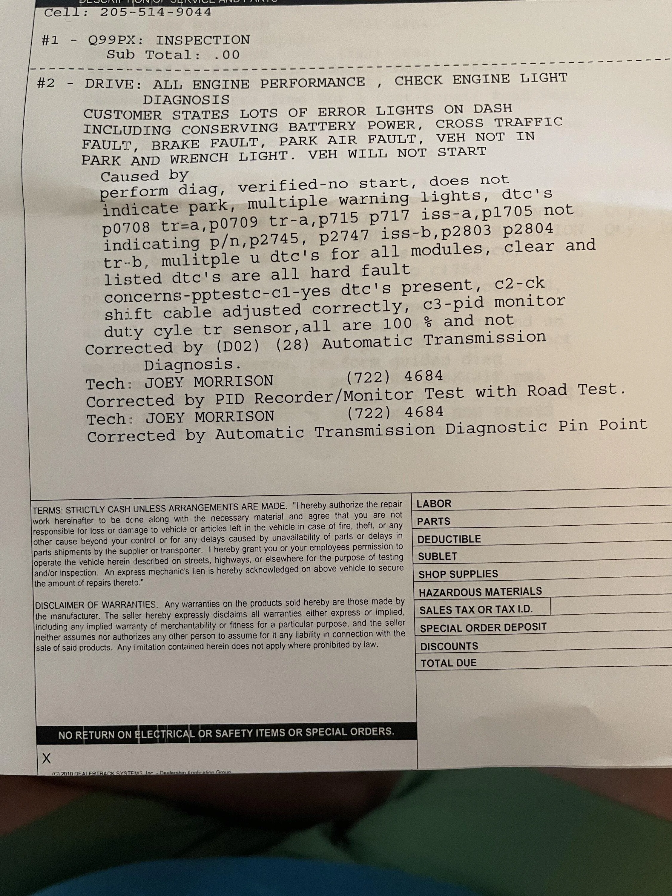

Hey everyone. I wanted to give you a final update on the outcome of the issues. First I want to thank all of you for your help and information especially the assistance from @flip and Ford.
Due to the length and extent of the tests and sensors replaced I am attaching the supplied report docs from the dealer service department.
Basically at first they thought it was a PCM, after replacement they found it to be the Engine Control Module as well.
I have noticed some burning smell after driving. I am thinking maybe they spilled some Trans Fluid after the replacement of that sensor? I had oil change and tire rotation at my normal mechanic shop this week and they found no signs to be concerned with.
While frustrating, mostly due to the communication from the dealership, I must say Ford has gone above and beyond to stay in contact with me and do everything in their power to make this right.
Technology is great, but it is easy to have issues, I still love this vehicle more than any other vehicle I have ever had!
Thanks again!
Chad

We don't see a lot of 12A650 (PCM/ECM) go bad and it looks like tech diagnosed correctly following FDRS and pin point tests. Looked like a bugger to diagnose.
