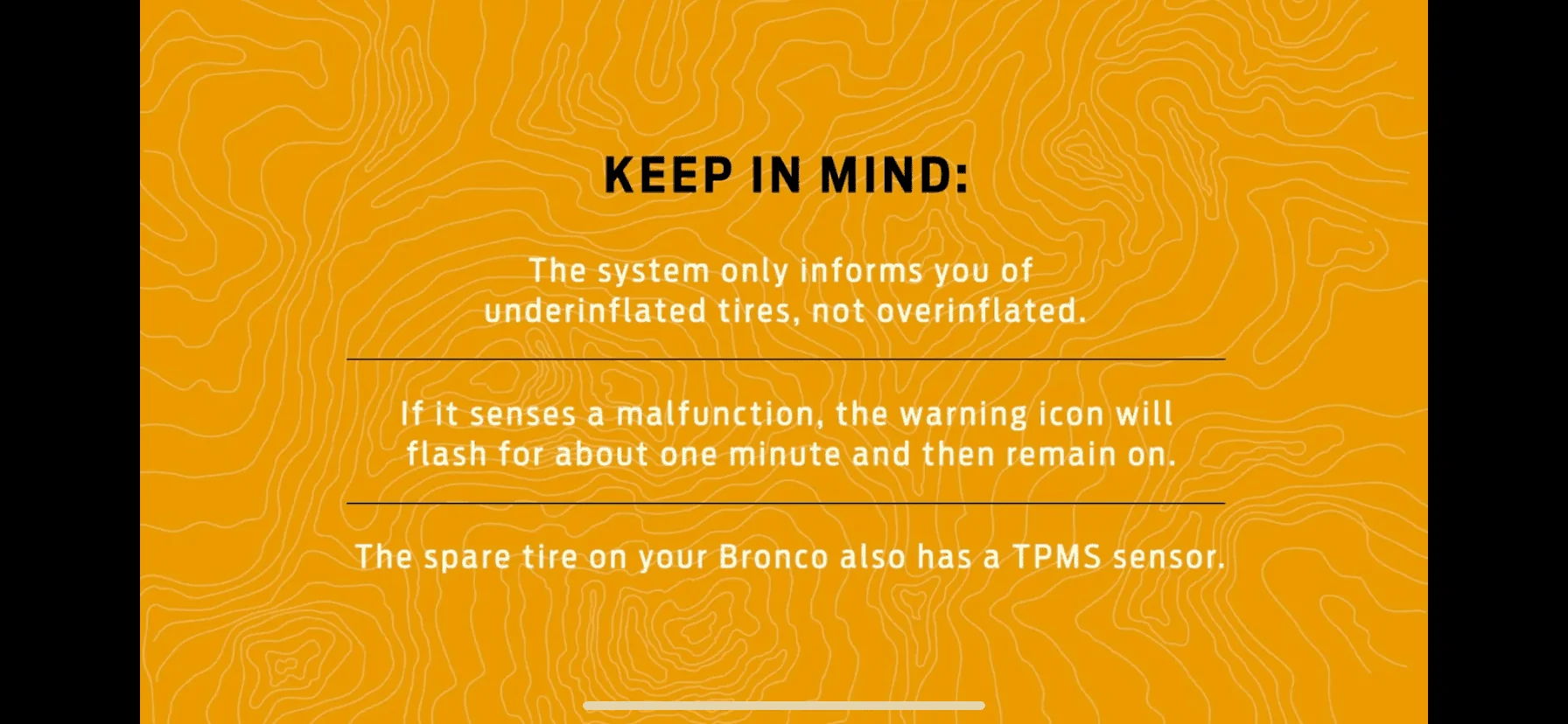

Not super helpful, but I did find it interesting that they call out the spare tire does have a TPMS sensor in it; I know there was some posts on here stating it didn’t (or “unknown”). Thought I’d share simply for that tidbit of info.

Doesn't look like the TPMS in the spare reports information to the computer. It didn't show on the tire pressure management screen. Might only work when a few feet away from the wheel hub.
In the workshop manual you have to program the location of the four wheels when you do a rotation. So the spare doesn't read. But it's there for 5 tire rotations. It just goes out of the equation when that tire goes in the spare location(doesn't get programed).

At the end for those who don’t want to watch
Ford Bronco Official Ford How-To Video: TPMS System (Sensor in Spare Tire Confirmed) 686DDBE0-E96B-41E5-8F3D-4CEB2161D7B1
