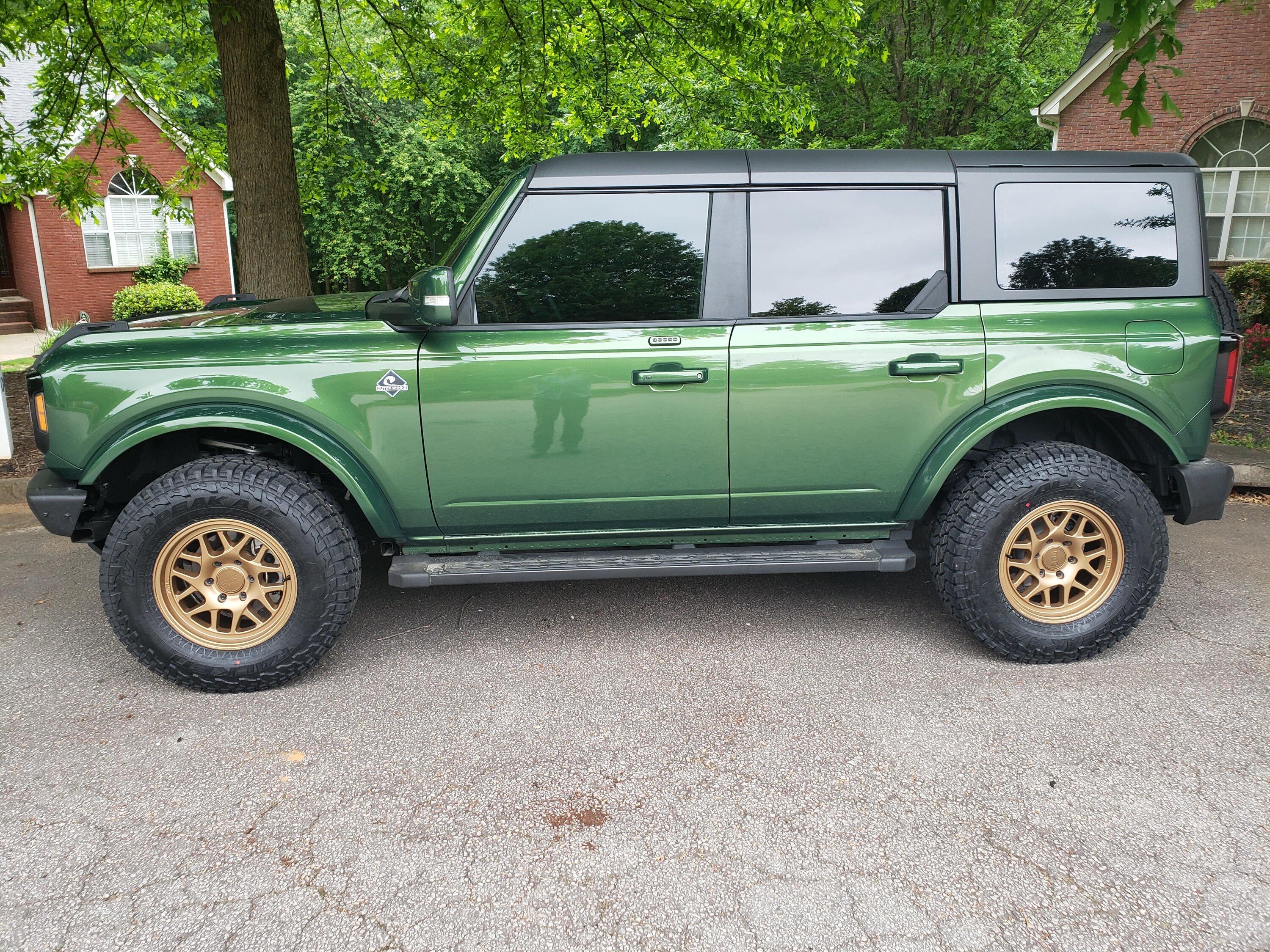

KMC 17x8" with Falken 285/70 (33") +33 offset.
Just to give you an idea of the look.

Cool thanks, Do you have much mud/rocks being tossed into your rockers?

No, but have only had them for a month and have been on paved roads 90% of the time.
