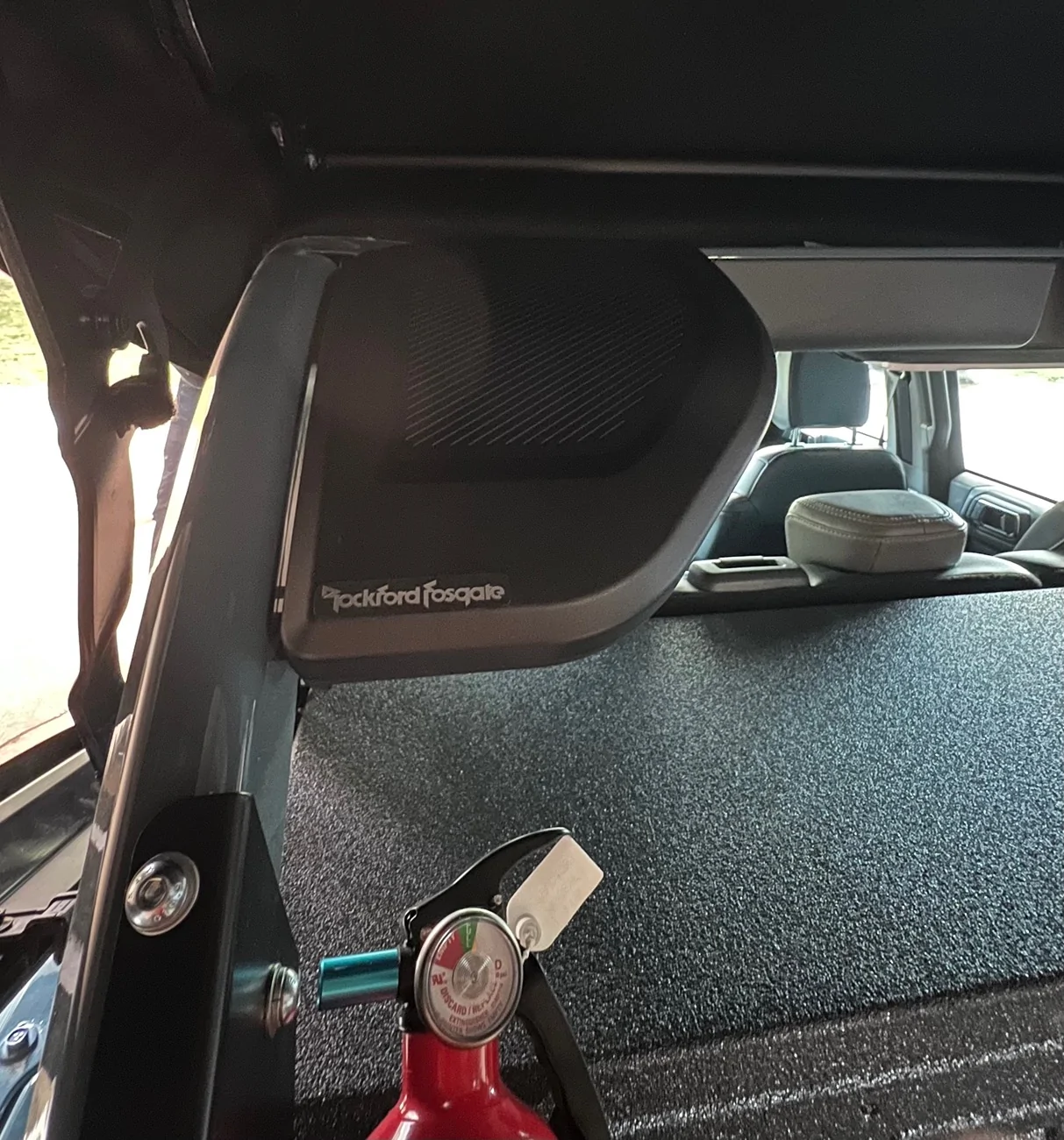

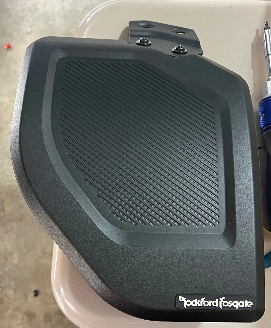

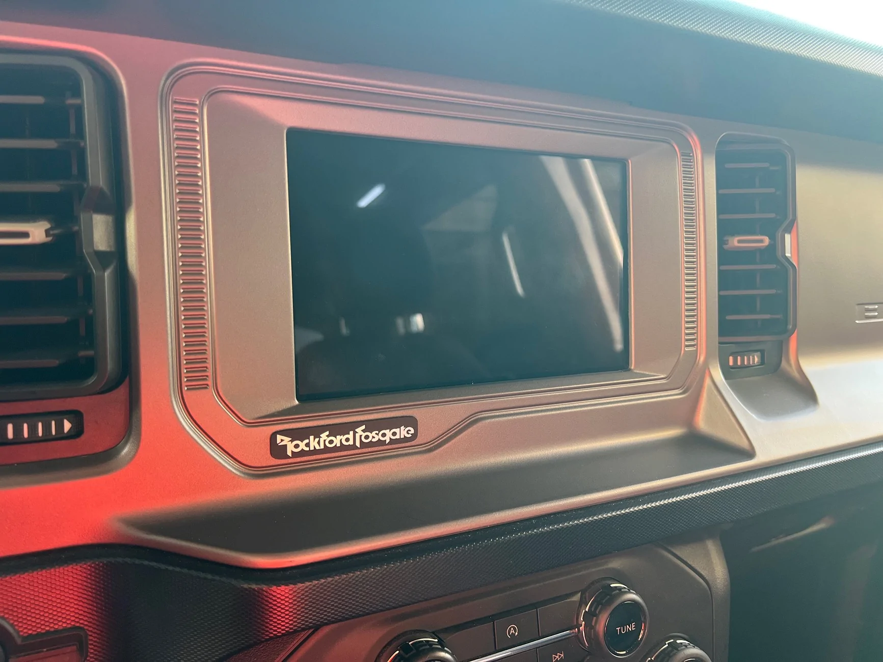

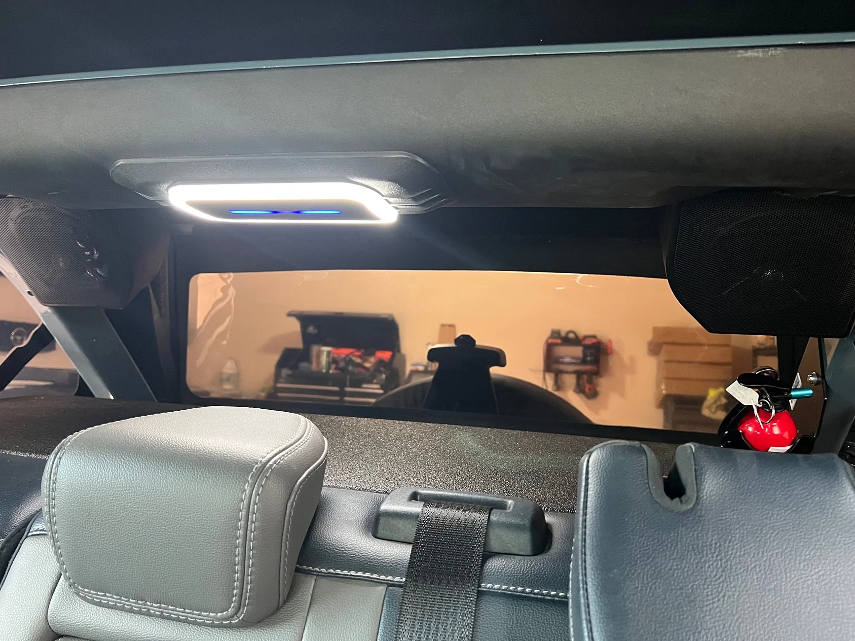

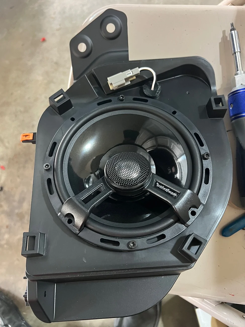

First was subs and amp and finally rounded out the system with all new speakers. The devils in the details. Things kicked off with a Fox Box ported dual 10in enclosure stuffed with A pair of Rockford P3D4 10in subs. And a Rockford R2.1200x1 amp. To control it all an AudioControl D-4.800 DSP amp. Stage 2 was a set of Rockford T1650 6.5 in coax nestled in Metra rear pods a bit of massaging of the grills to make the fit. For the front sound stage a pair of Rockford R165s components for the front kick panels and a set of R14x2 4in dash speakers.
Ford Bronco And Done! Full Rockford Fosgate speakers, sub, amp install! IMG_7294
Ford Bronco And Done! Full Rockford Fosgate speakers, sub, amp install! IMG_7295
Ford Bronco And Done! Full Rockford Fosgate speakers, sub, amp install! IMG_7299
Ford Bronco And Done! Full Rockford Fosgate speakers, sub, amp install! IMG_7296
Ford Bronco And Done! Full Rockford Fosgate speakers, sub, amp install! IMG_7297
Ford Bronco And Done! Full Rockford Fosgate speakers, sub, amp install! IMG_7298

The factory pods house 4in speakers. The new pods hold a much healthier 6.5-6.75 in mid bass speaker. The DSP flattens the stock EQ and converts its signal to a full range instead of highs only. So now there is some proper mid bass to compliment the subs.

Amazon has Mabett, and this is the first I read about Metra pods.
I bought the Mabett ones a while back, and strongly recommend going in a different direction.
They had some foam on the front panel to help keep them from rattling, but it will almost certainly interfere with your woofer suspension. It physically damaged one speaker, and I chased poor sound for a long time before I realized what was going on.
I don't know if the Metra ones have the same thing or not, they look ~very~ similar, but looking at the way the front panel is constructed (nearly all open grill mesh) I think it may avoid the problem. I am about to trash my Mabett ones and use some SSV ones to replace them - the SSVs don't have a front cover at all - you have to provide your own speaker grills, so that problem is eliminated.
