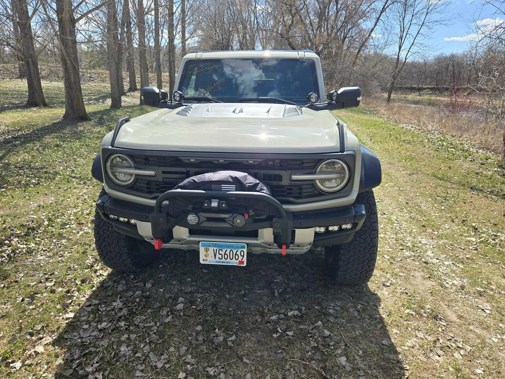

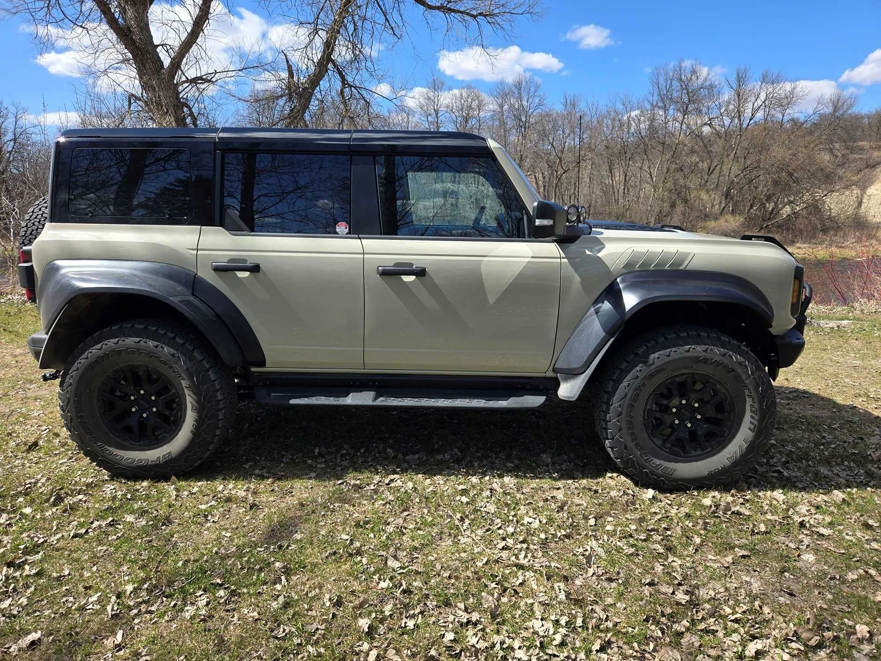

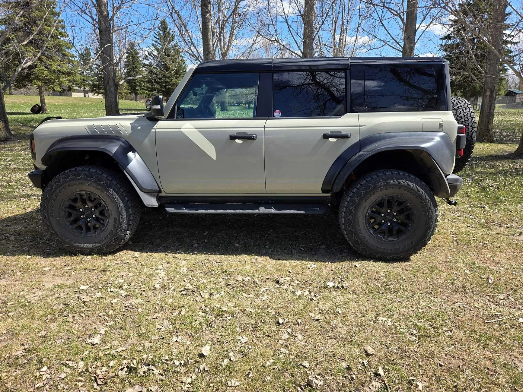

It is a Late Model built around Halloween 2025. Desert Sand. Black hard top and fender flares. Black onyx interior with leather trim seats. Lux package with SYNC 4. It has a S&B cold air intake, UPR oil catch can, Ford Performance Tune, AutoStop Eliminator, and Wolfbox X5 Dashcam.

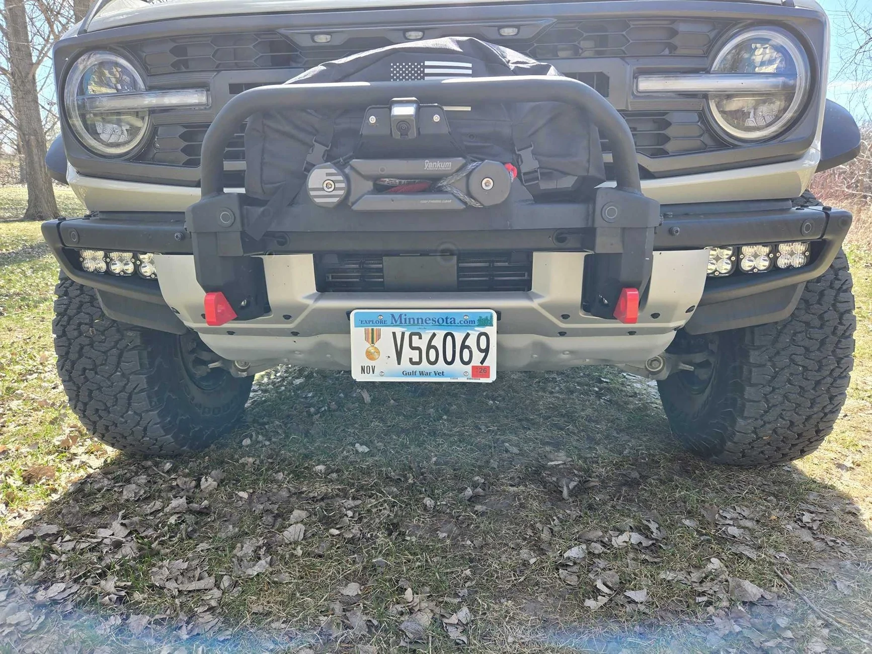

BUOR Winch mount. Relocates front camera and parking sensors. Doesn’t block intercooler or adaptive cruise control. Badlands Apex 12000lb winch. Yankum Rope groove fairlead. BUOR license plate relocation kit.

Baja Designs pro series triple fog light kit. Center lights are Spots, middle lights are Drive and outer lights are Cornering. Custom built wiring harness that plugs into factory fog light harness to keep switch functions normal. Bronco Raptors use Fog light switch to turn on one set of fog lights and Aux 1 to turn on other set. I set mine up so Drive lights come on with fog light switch on headlight controls. Aux 1 switch triggers 20-amp relay that is fused from battery to power all six fog lights since Bronco Raptor Aux 1 switch is 10-amp fused.

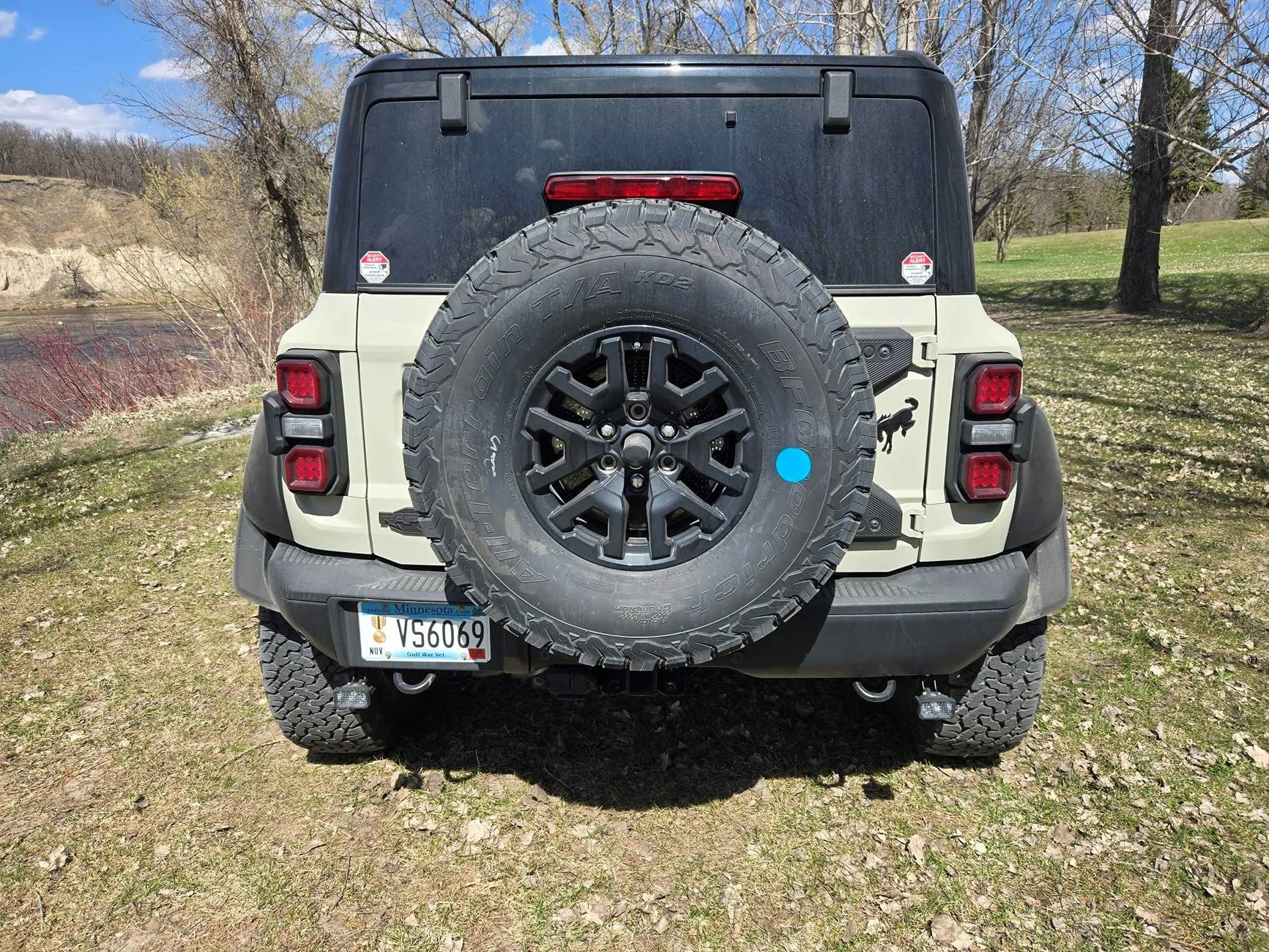

Diode Dynamics SS2 Pro reverse light kit. XKGlow 5th wheel light. Both on a custom wire harness that is plug and play with tail light connectors. Reverse lights set up for backlight to come on with running lights. Back up light comes on with either reverse light or Aux 5 switch. XKGlow comes on with tail light, running, brake, turn, and reverse lights.

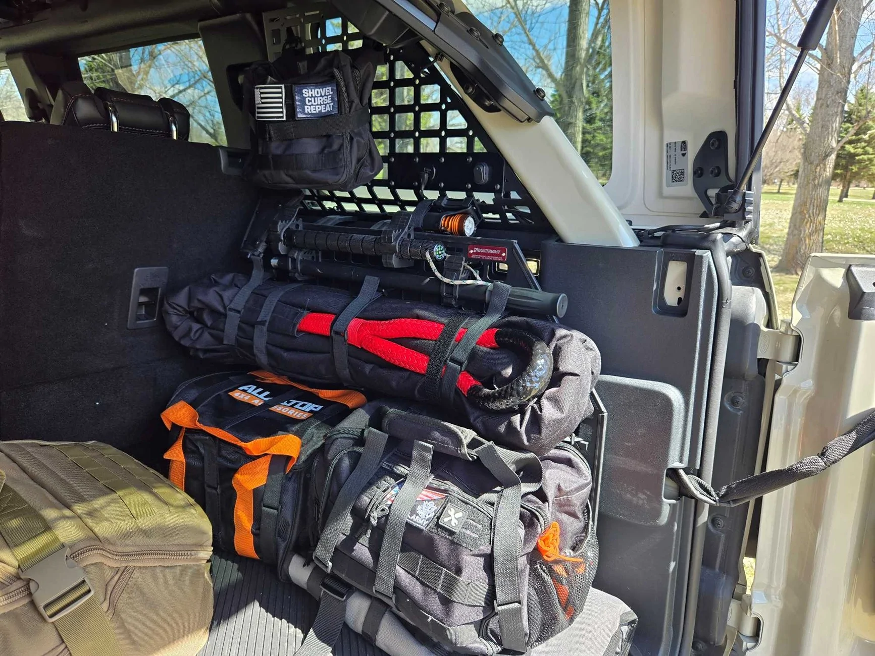

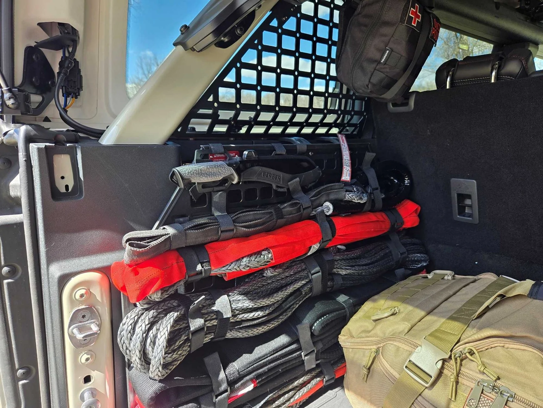

Cargo area has the Built Right molle compatible cargo panel system and DV8 Offroad pocketed rear window molle panels. Makes for easy storage for tools and recovery gear.

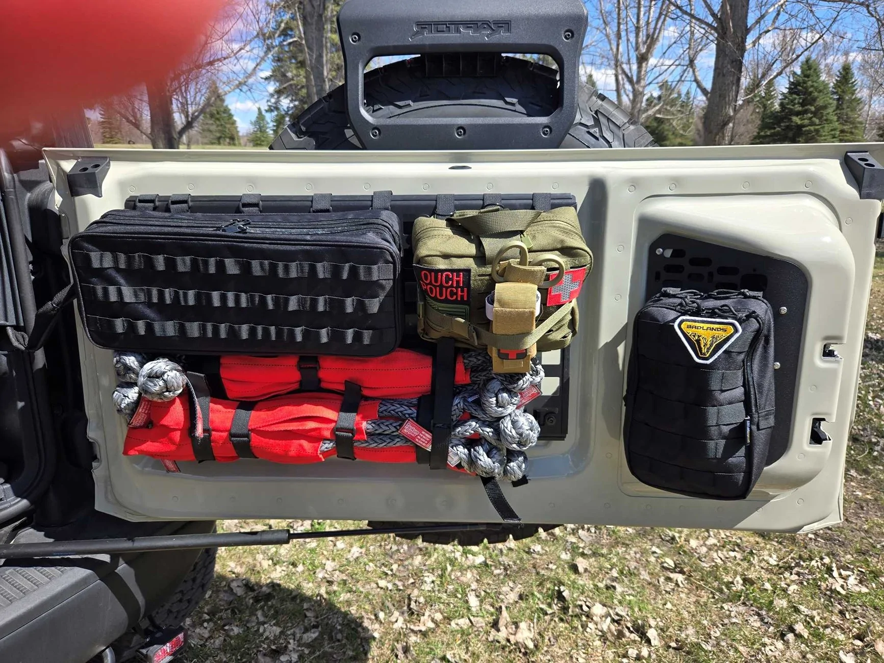

Tailgate has Putco tailgate molle panel and exhaust vent molle panel that allows for easy storage of gear, bags, and first aid kits.

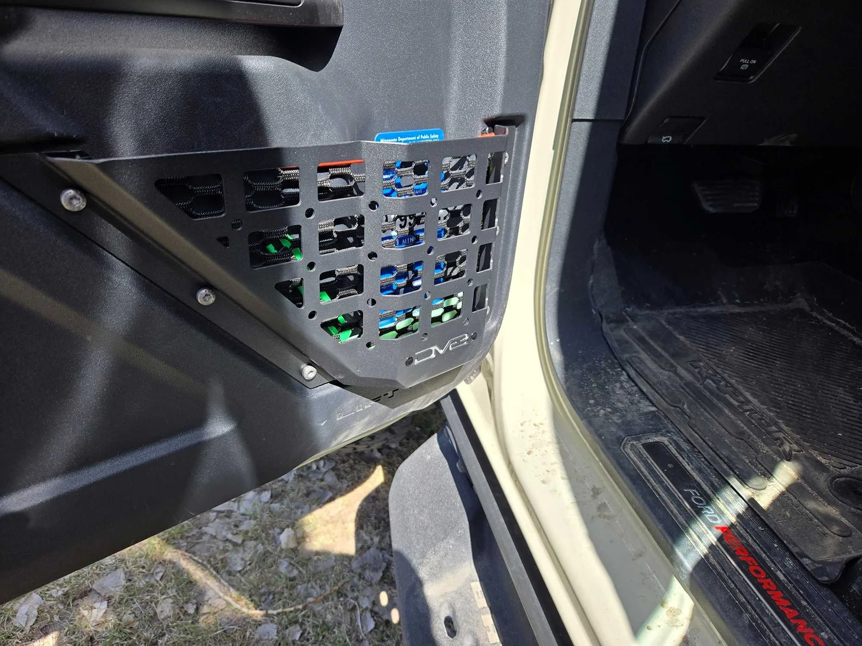

DV8 Offroad front and rear door pocket molle panels.

Ford Bronco 2025 Bronco Raptor desert sand build 2025 Bronco Raptor LH
Ford Bronco 2025 Bronco Raptor desert sand build 2025 Bronco Raptor Rear

Ford Bronco 2025 Bronco Raptor desert sand build 2025 Bronco Raptor Cargo LH
Ford Bronco 2025 Bronco Raptor desert sand build 2025 Bronco Raptor Cargo RH

BUOR is Buckle Up Off Road. They are a Florida company that concentrates on Broncos.
Looks like they get that winch mount from the same Chinese factory as IAG gets theirs from. Just spec'ing red tow points instead of the IAG black ones
To save anyone the trouble, I ordered the Red Rock version from ExtremeTerrain that looks similar. It was immediately returned. Shitty packaging aside, the Red Rock version had been cheapened out so much from the BUOF and IAG versions that it wasn't even useful for a mall crawler to use to mount a decorative winch.

I knew the winch mount was probably the same as IAG. There isn't very many choices to keep from blocking the intercooler in mounts or bumpers.
I just wanted to keep it clear and something that mounts to frame. I would've gone bumper if I could've found one that didn't block the intercooler.
