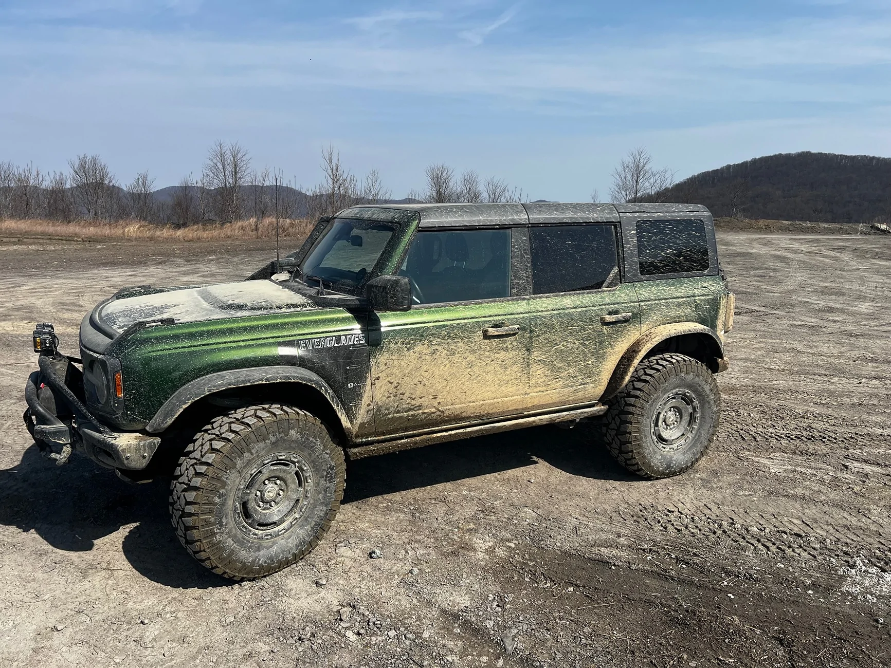

My Bronco is an Everglades with hoss3.0 Fox, a Zone 2.5 lift, 37” Kelly MT. Max clearance kit and 1.5” wheel spaces up front.
The Zone 2.5 adventure lift for hoss3.0 worked great, with the max clearance kit and 1.2” wheel spacer on the front I had no rubbing and a great ride on and off highway.
The Fox 3.0 preformed excellent with the lift, they absorbed everything the trails had to offer, smoothed out the bumps and controlled over the big stuff. I have run them hard and faster before the Zone lift, this confirmed the Zone lift did not diminish their offroad performance in my opinion. They made the trails very comfortable in every condition.
The Kelly Safari MT in 37/12.5/17. The trip required 1200 miles interstate driving, I ran 40 psi (warm temp) they drive great, in no way did they diminish the Broncos highway handling up to or above my cruising speed of 70 mph, this was getting me 17 mpg any faster it started dropping. (premium octane fuel) How loud are they? Very quiet for an aggressive mud tire. They were no louder than the Territory MT at 24k in my opinion, I could not hear the tires over the wind noise. After 15k or 20k maybe different but as of now they are quite in my opinion. On the trail tire psi was set to 23 & 18. We had dry dusty roads, gravel, water holes, muddy hill climbs, wet and dry rocks, ledges, you name it. The traction was flawless; tires appear to have no damage to the trends. I was apprehensive going in with no reviews on these tires, I would buy them again without question.

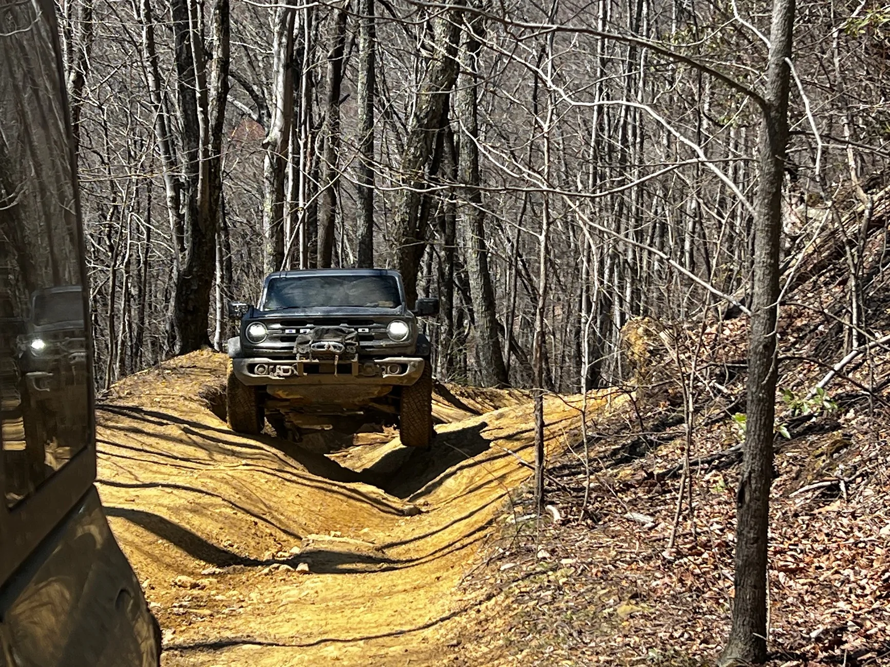

@CitrusBronco that looked like a real good time! That pic of the big rut with the narrow bypass would have had me stuck thinking for a bit. 🤣

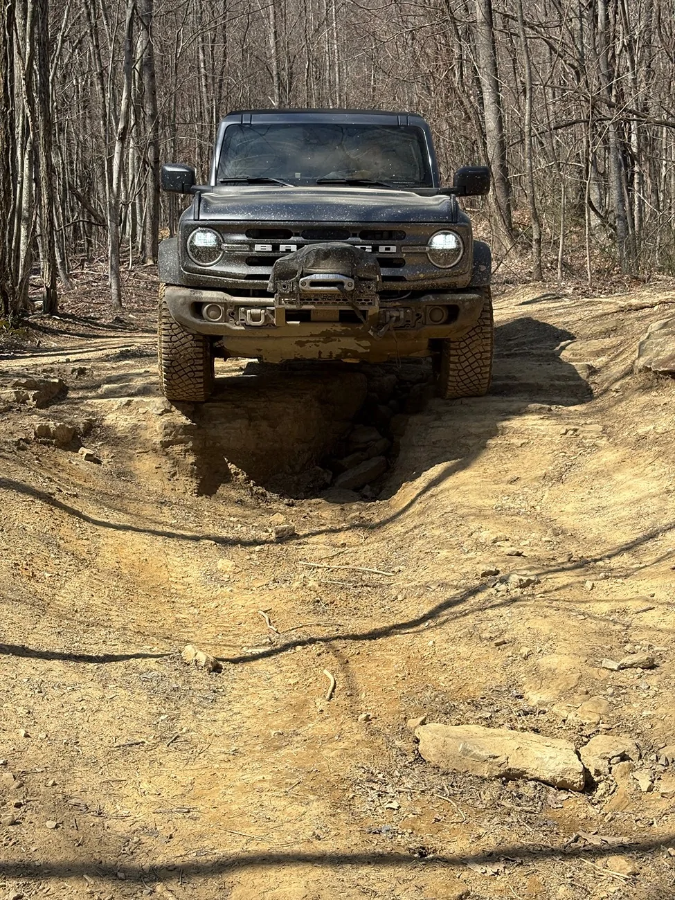

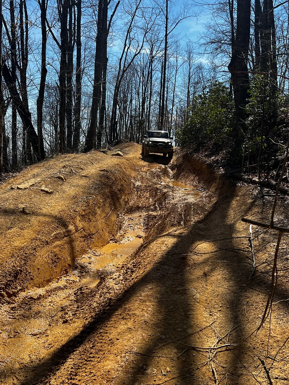

That's good wheelin!
That narrow bypass started wide and went down to what seemed just under the track width of the Bronco at the bottom, with a tree on one side and a drop off into the rut on the other. The rut had less likelihood of failure so we took the rut.
Pics as usual don’t present the scale or steepness of the obstacles.
MadMan4BamaNATL
Ray
Jul 10, 2020
3,477
10,302
Atlanta

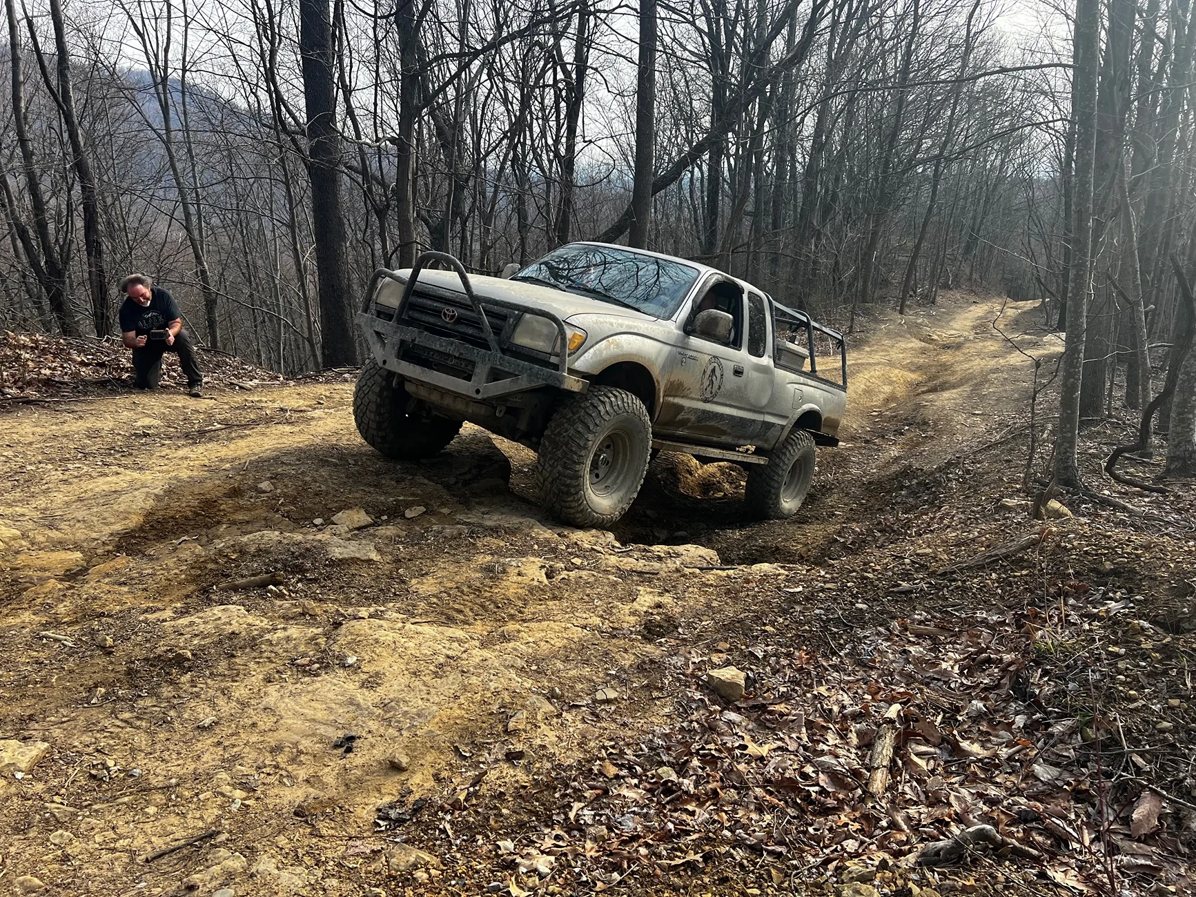

Ohh it looks plenty steep.
At one point, guess in the bottom, looks very off camber. Last fall a buddy and I had to take on a similar obstacle over in Alabama in Talladega national forest, called Lower Skyway Motorway. Rains had dug a good v notch rut with high walls just like that.
Not sure how we didn't rub the doors, but my frame mounted rock rails helped a bit.
