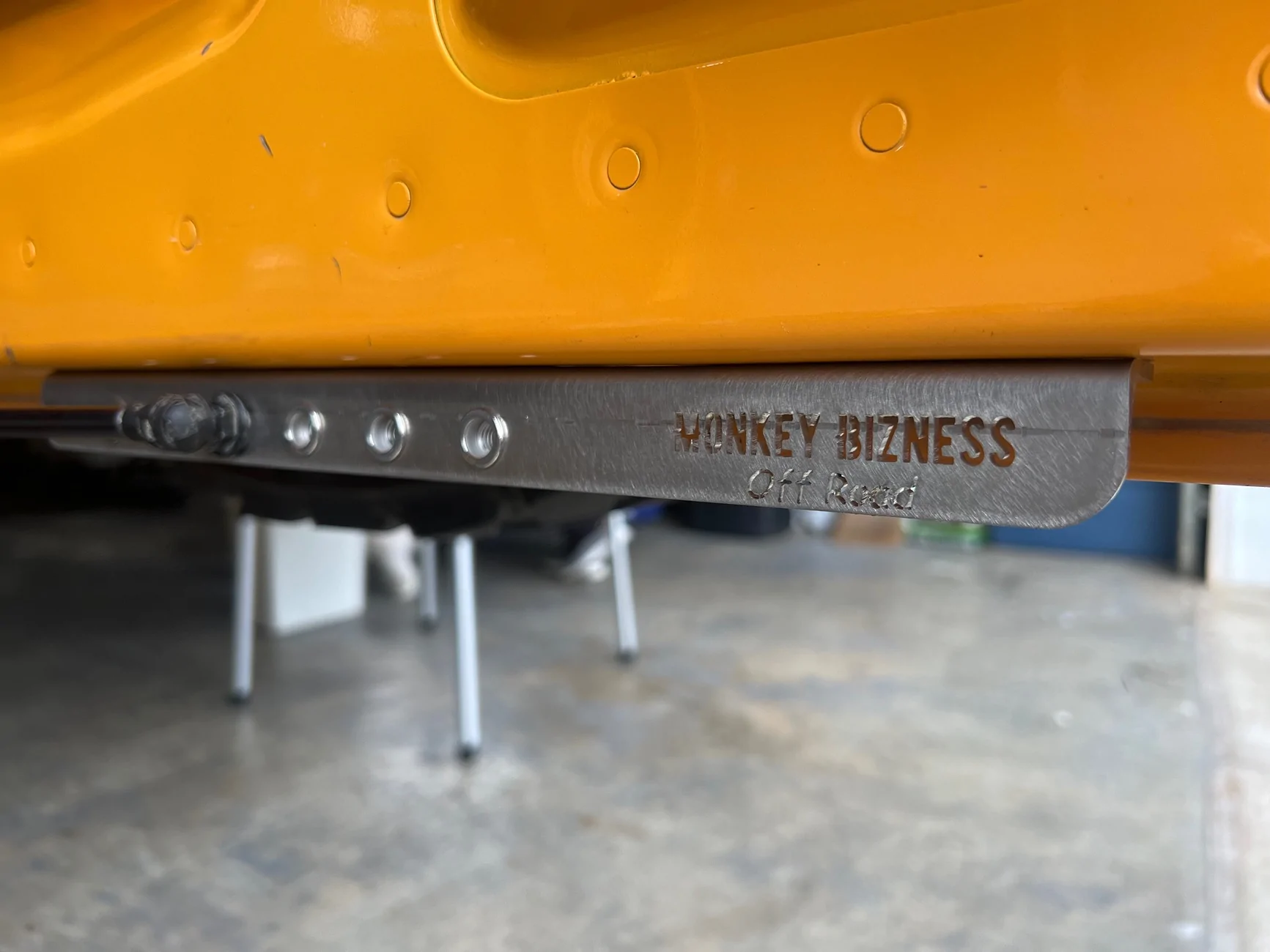

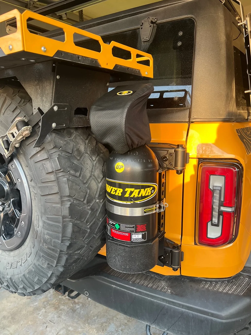

I’ve been trying to figure out a solution to mount my Powertank on the outside of my Bronco. I recently added the Turn Off Road Tailgate Reinforcement with the MOLLE Accessory. In order to mount it to the MOLLE I ordered the Power Plate from Powertank and it worked out great. To keep the Powertank from contacting the taillight I also added a tailgate limiter from Monkey Bizness Off Road. My tires are 35 inch and I don’t plan to go to 37’s so it works. For larger tires I think you could go to a flush mount taillight to make it work.

Which version of tailgate limiter from Monkey Bizness Off Road did you buy original or the updated one?

Thanks for the Monkey Bidness tip - just ordered the limiter and strut. I’ve blown off the plastic ends of the stock tailgate strut at least 1/2 a dozen times.
