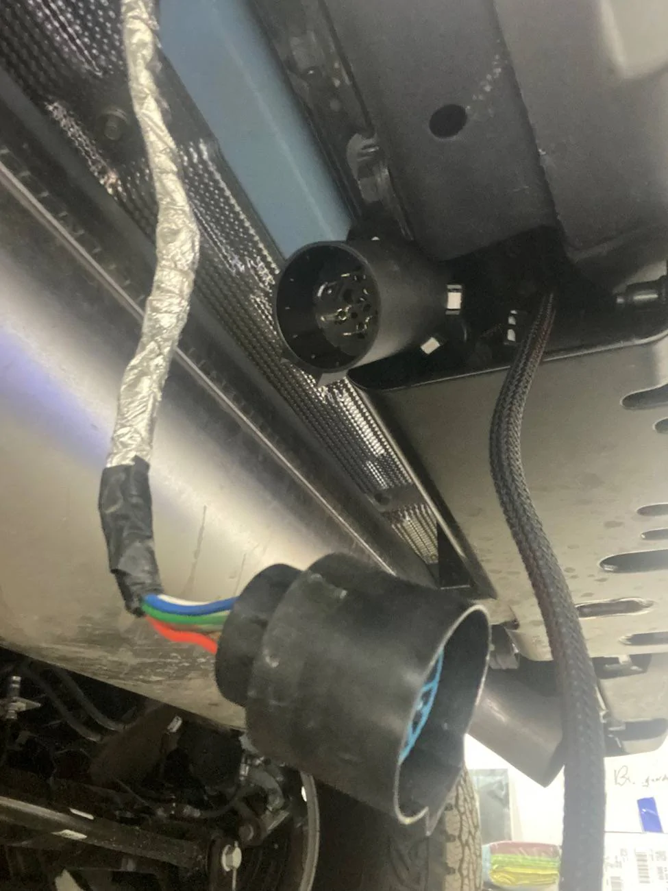

The light itself may be great, and I would love to be able to use it, but the harness on the previous version would not work on my ‘25 HE powder coated rear bumper with Ford tow receiver. There was nowhere to secure the harness where it wouldn’t rub a nut or hang exposed right behind the muffler. Had to return it.

So nowhere to tie it to, to secure it? That sucks. I have a Bronc Raptor and wonder if this would work with it. I love products/mods with plug and play designs that don't force me to head to community college to get a vocational degree in engineering....

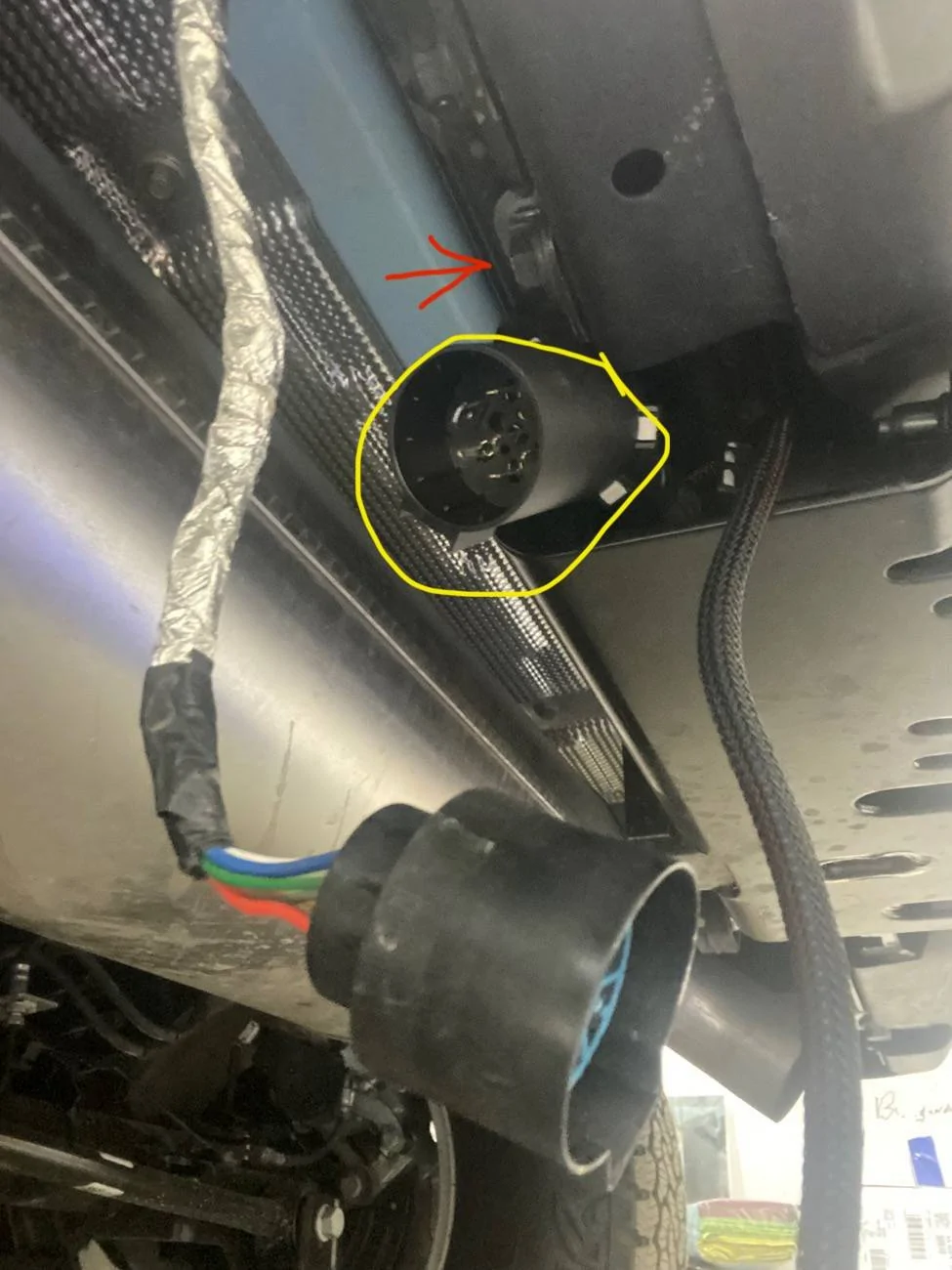

I was pretty excited about it and bummed it didn’t work. DD refunded me and I’m thinking of getting the spare tire mount reverse light kit and just painting it white to blend with the wheel better.
The problem is the part circled in yellow won’t fit inside the Ford receiver housing, and that’s as far as it will stick out with the wiring length. If I secured it upward as far as it will flex, it would rub the nut with the red arrow. Plus the original factory harness would be hanging behind the muffler and would be exposed to direct heat. I thought about wrapping it in heat tape but it would still be visible from behind and look cheesy.
Ford Bronco NEW HitchMount LED Pod | 68% Brighter + 2.5" Adaptor IMG_2627
Ford Bronco NEW HitchMount LED Pod | 68% Brighter + 2.5" Adaptor IMG_1787
Edit: I should add that if you have a different rear bumper or different kind of receiver, it’s possible this might not be a problem. It’s just this bumper and the Ford tow kit that didn’t work.

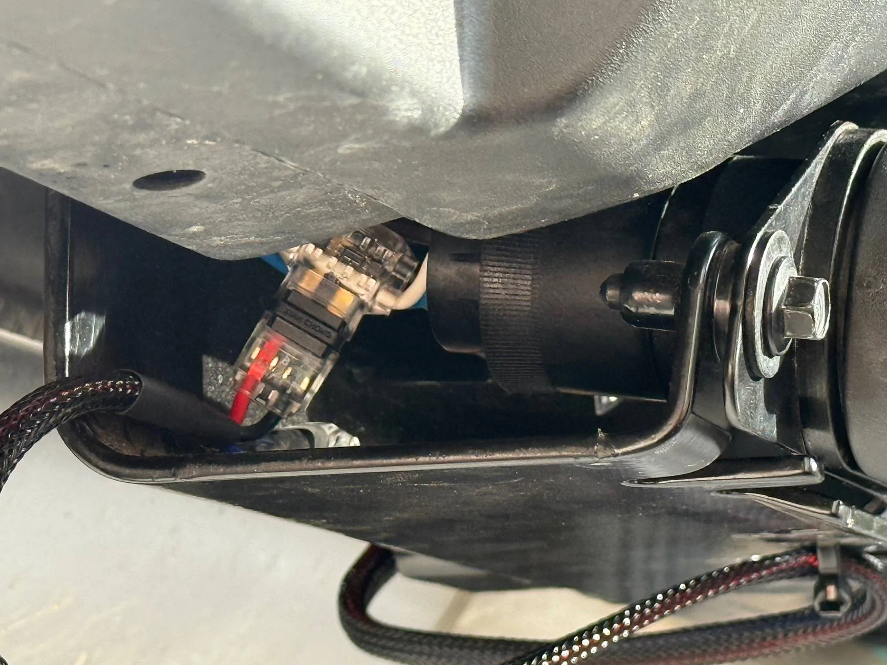

I just installed mine over the weekend. I ditched the harness it came with and used a t-tap on the stock hitch wire. It fits up in there much better than trying to shove all that stuff in.
I’ve got some magnetic zip tie holders on the way to secure the wire better up behind the hitch…

Thanks for sharing your experience—it’s definitely a tight space on some Bronco configurations. While the product remains safe and functional when installed properly, we understand fitment challenges can arise depending on bumper/tow setups. We're glad our customer service team was able to take care of your return.
