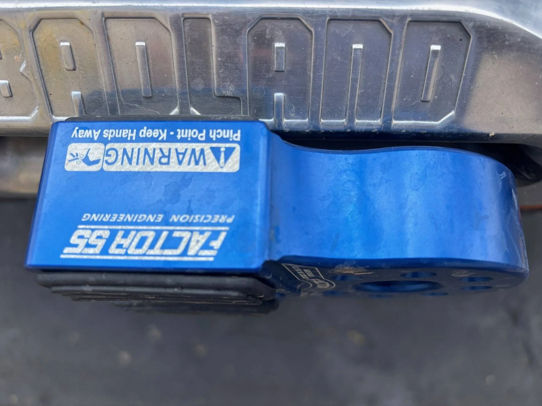

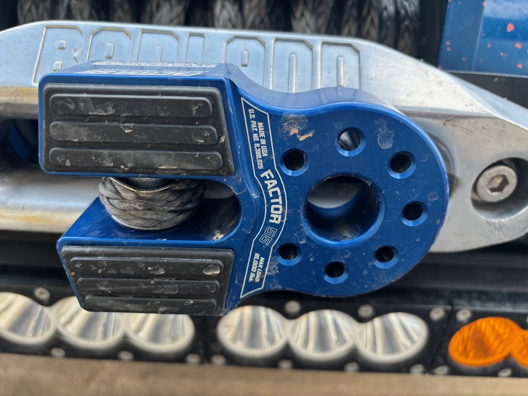

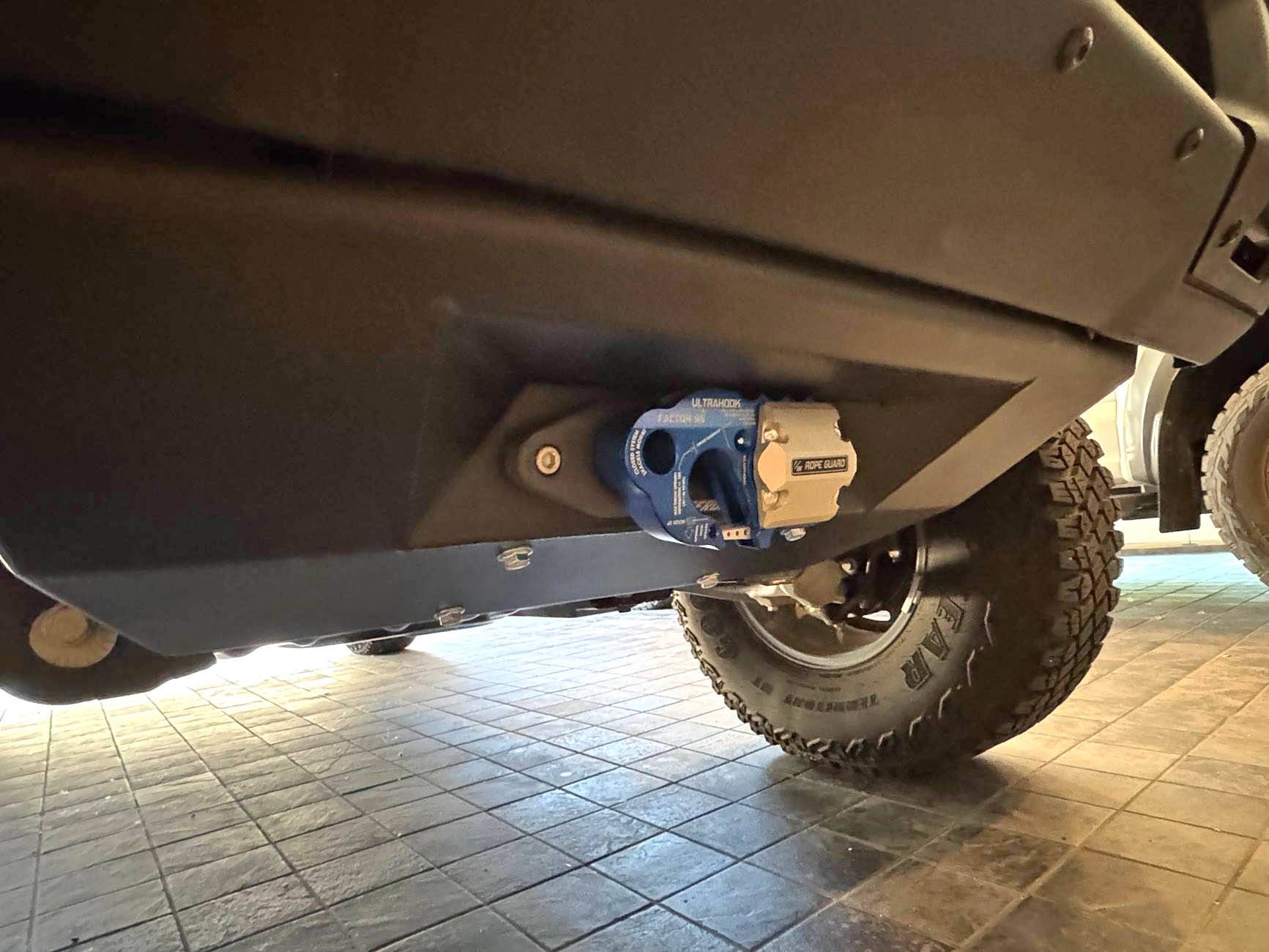

I installed Mishimotos high mount intercooler and all offroad brands should take note from them. The install went sooo smoothly, the parts were manufactured to perfection and I’ve never seen such detailed instructions before! After that I mounted a warn zeon xd winch to Lobo offroads hidden winch mount and factor 55 ultra hook with rope guard (it’s a bit too large).

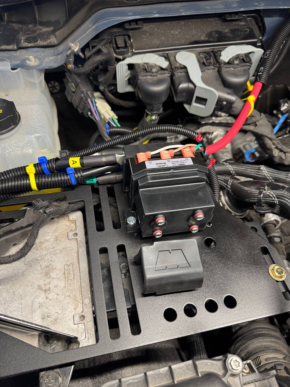

The solenoid needed to be relocated to the engine compartment. I used KR offroad air compressor bracket and drilled some holes to mount the solenoid instead.

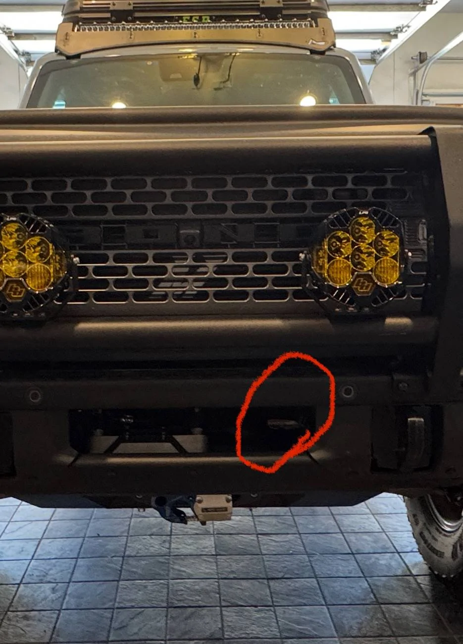

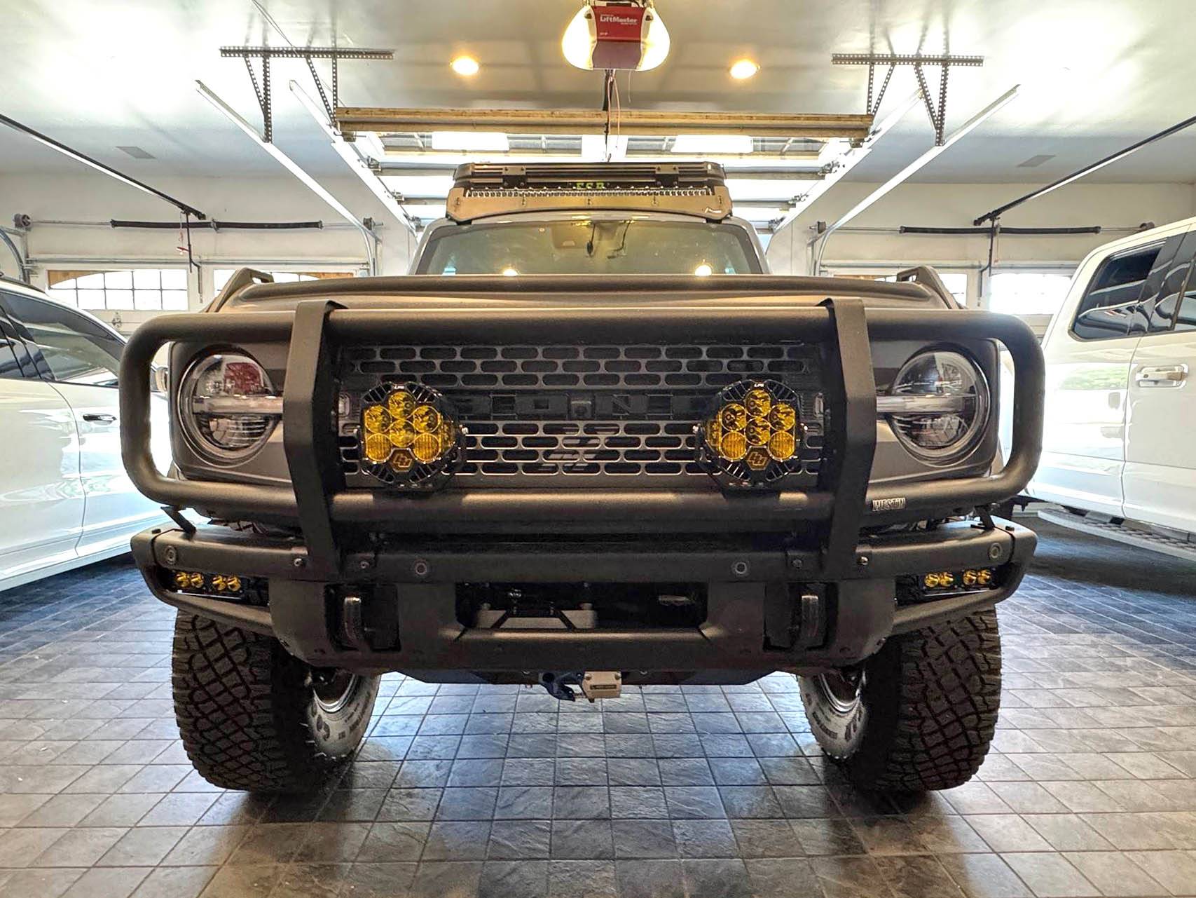

last was to mount the lights. For the bumper I went with 4 Baja S2 mounted to a KR offroad bracket (wish Baja sold just their brackets. I already had the lights from my last truck) I needed to cut part of the bracket to fit around a bumper reinforcement I have for the Westin brush guard, but it wasn’t too difficult. The brush guard has two amber Baja LP6 lights.
Ford Bronco 2.7 Bronco gets hidden winch, Mishimoto high mount intercooler, Baja lights IMG_6594

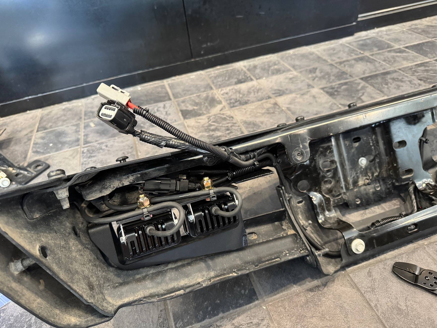

I put in quick disconnects for both the brush guard and bumper lights so they could be removed without having to take off any lights or yank any wires.
Ford Bronco 2.7 Bronco gets hidden winch, Mishimoto high mount intercooler, Baja lights IMG_6595
That's too bad..... I'll trade you out for a Factor 55 Flatlink 😇 :crackup:
Just messing wth you. Great build start!!

My issue though is the adaptive cruise control was relocated directly behind the support column of my brush guard so it doesn’t work right now. Need to figure out a new mount for it
Mine works but it is a bit "janky" as others have referred to it... Someone did point out some relearn procedures that I am going to have to try. They did not look to be a simple process though.

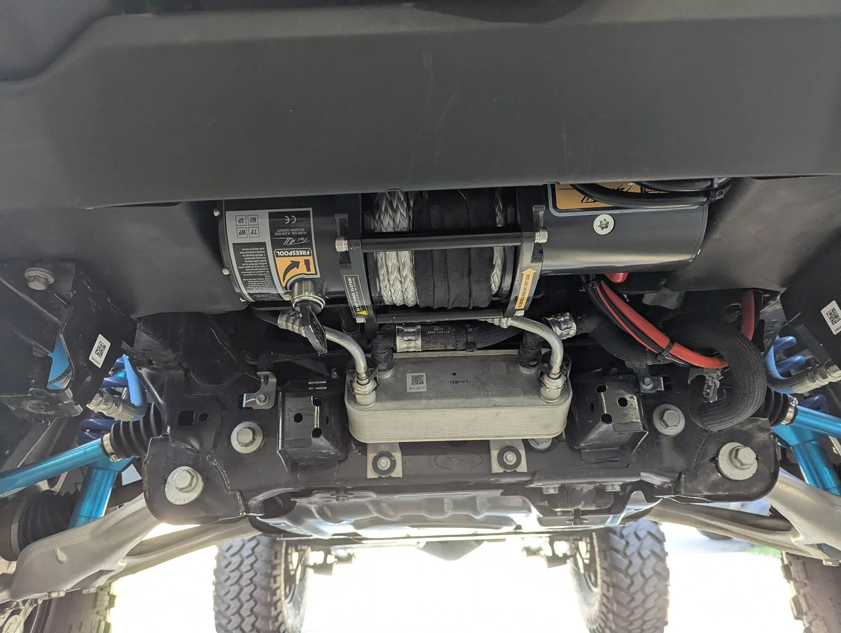

How do you access the free spool lever? I am interested in doing something similar, but can't picture how I would access the winch manually.
This pic with the skid plat off shows the lever on the passenger side.... you can easily reach it from the front side of the passenger tire since the winch is inverted.
Ford Bronco 2.7 Bronco gets hidden winch, Mishimoto high mount intercooler, Baja lights IMG_6599
that silver thing you can see right there is the free spool lever for the warn winch. Very easy to reach in and twist
Check out the dv8 acc mount. It may work. Send me a pm if you need some help getting one
I'm about to use the Barnes 4wd bracket to relocate mine. Not because of the intercooler, but because I keep getting my lower bumper full of mud running off road rally's & I'm trying to avoid breaking it lol.
