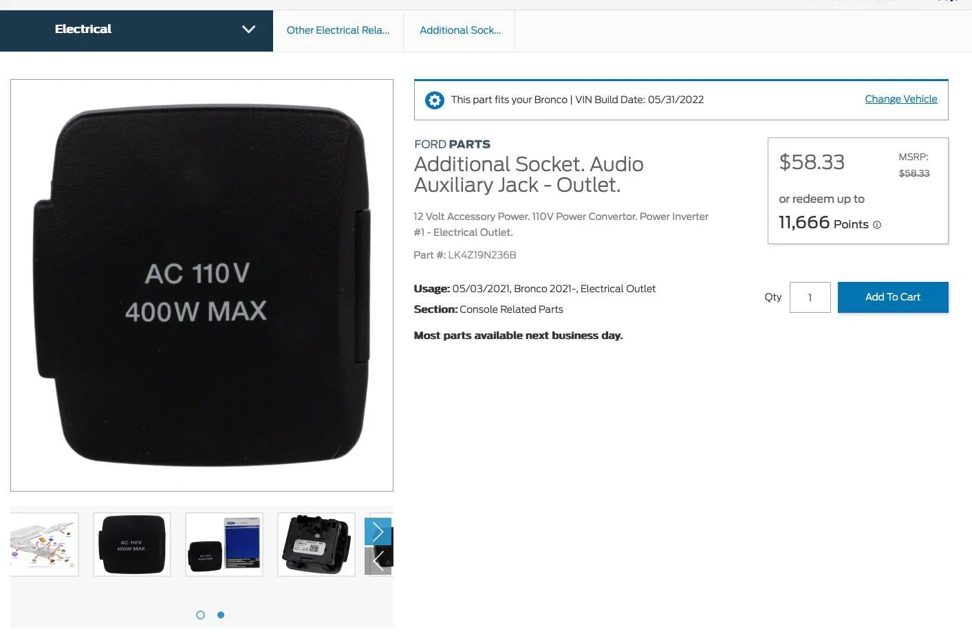

in case anyone here was curious for the latest outlet part info, here it is from the parts site. about to call Ford tomorrow as my outlet has mysteriously stopped working and there are no LED lights on at all.
Ford Bronco 110v Outlet Not Working (flashing amber light) Screenshot 2024-09-05 at 10.27.08 PM
