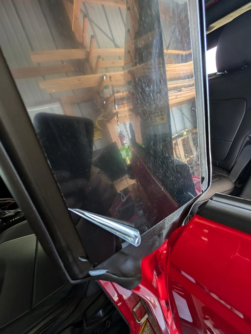

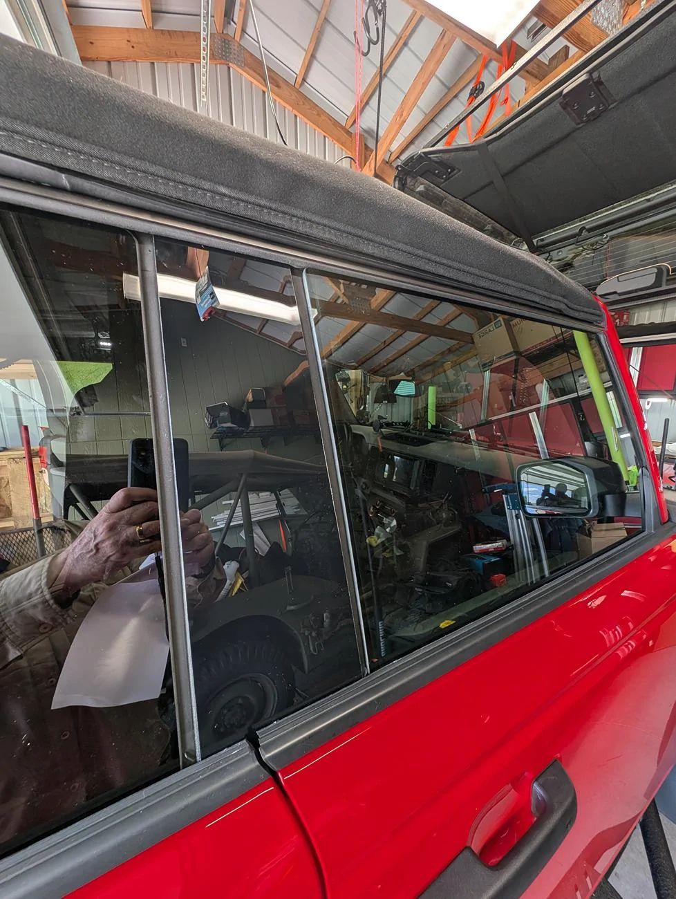

So here we are and another thing followed me home. I added the B Pillar Trim Cover for the 4 Door 6G. Very easy to install but no instructions are included with it. There is a video on the Amazon page that gives you an idea how to do it. Of course, I didn't really think about going to the product page at the time of install. But since it was glue, I figure use 99% isopropyl alcohol to clean it off. Figure out which piece goes on which side. Pull the backing off a bit and line it up and under the gasket at the top of the pillar. Remove the rest of the backing. Press into place. Remove the clear plastic film from the product.
