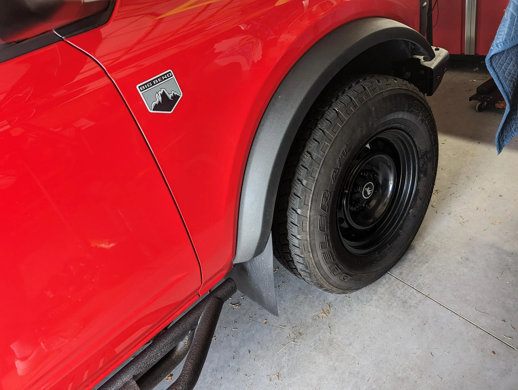

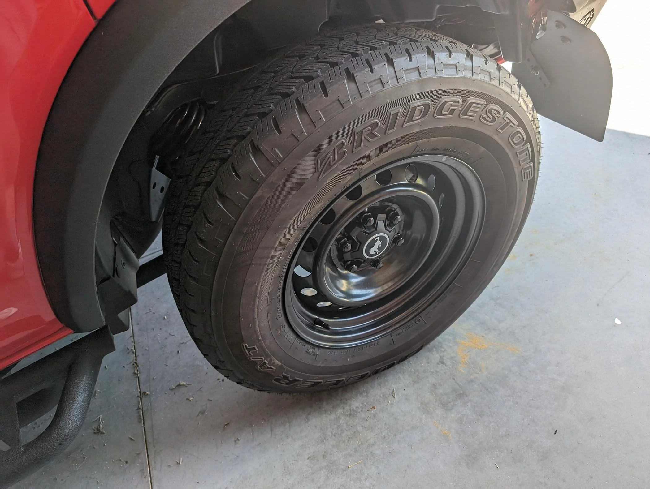

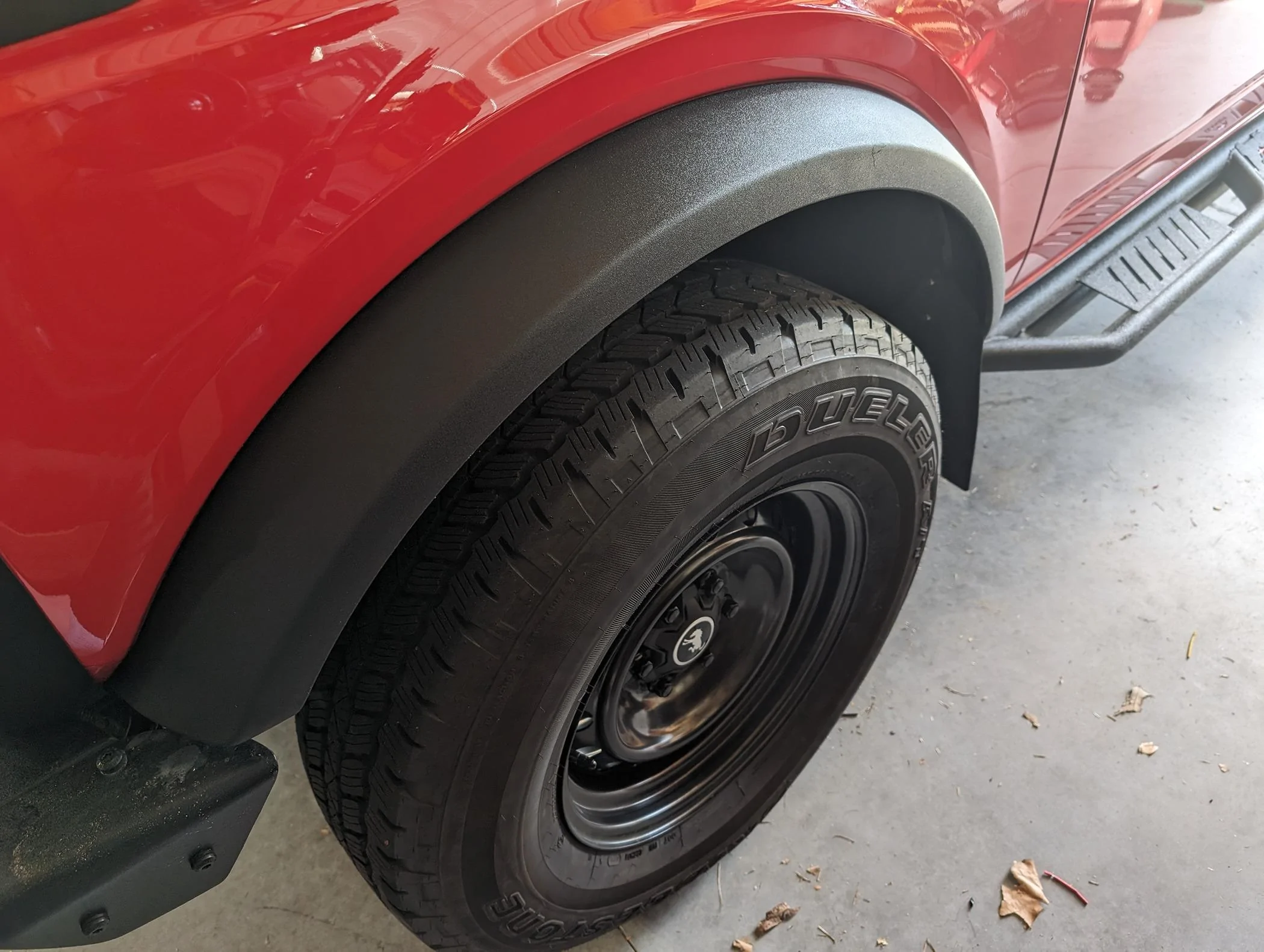

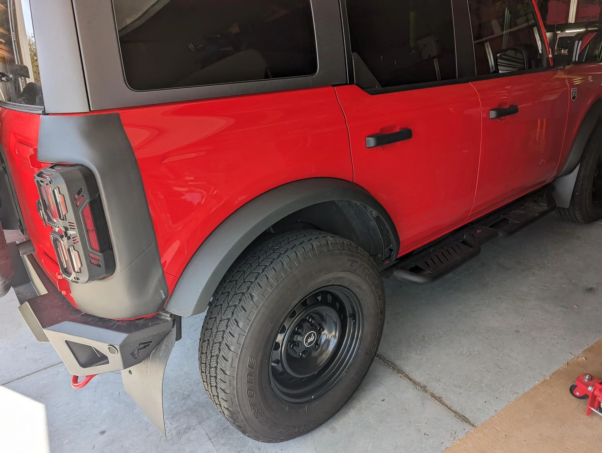

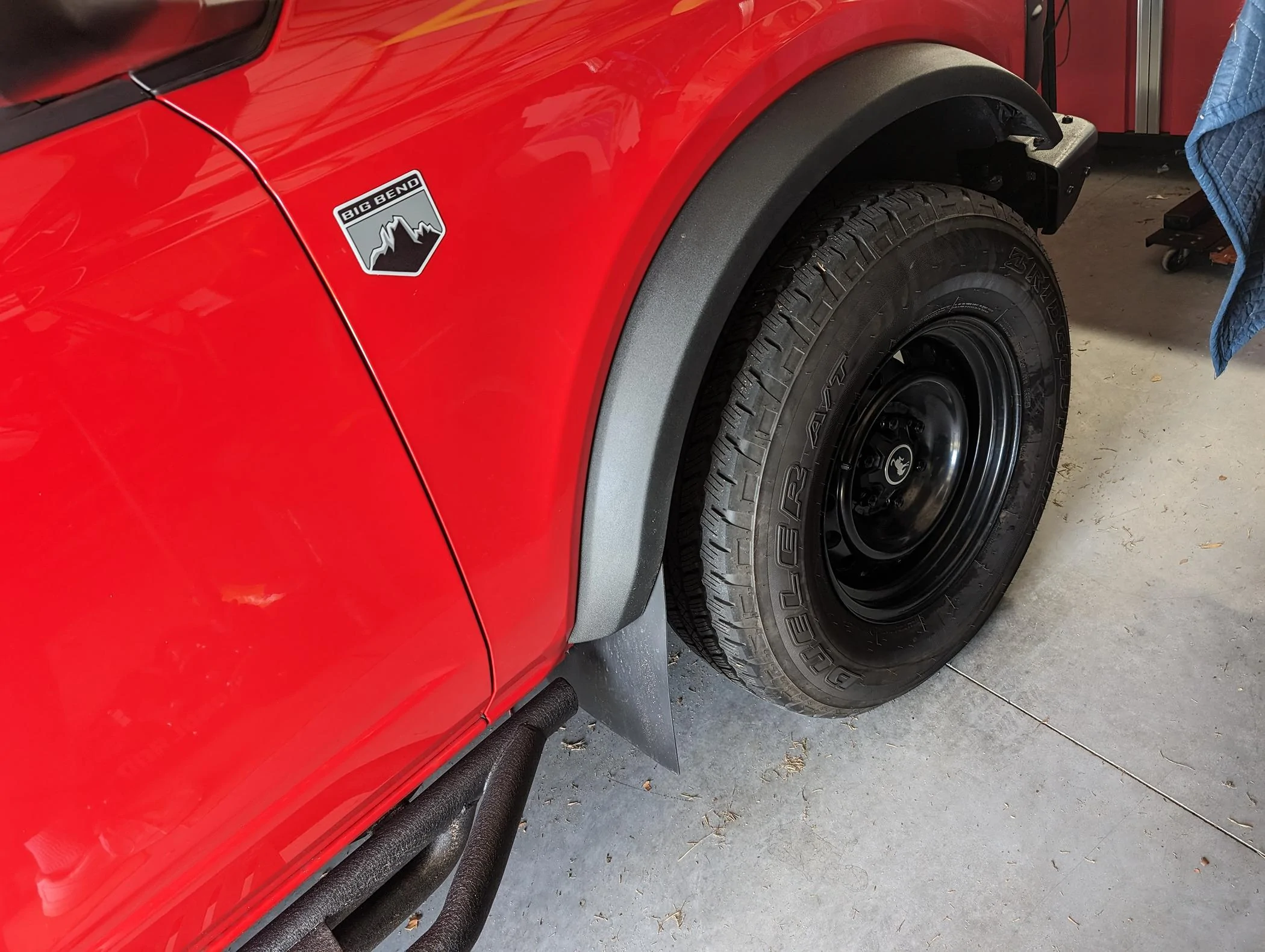

Well, I've had Black Diamond steel rims for several months for my 23 Big Bend. Finally made an appointment with Minco's who swapped out the tires and TPMS for me today. I love me some steel rims. Likely an infection from my WW2 jeep (and Olive Drab Disease).
Once I got home, I jacked up each wheel, took all of the lug nuts off and installed the center caps. Then I torqued the lugs to 100 lbs. I need to remember to check them in about 100 miles.
