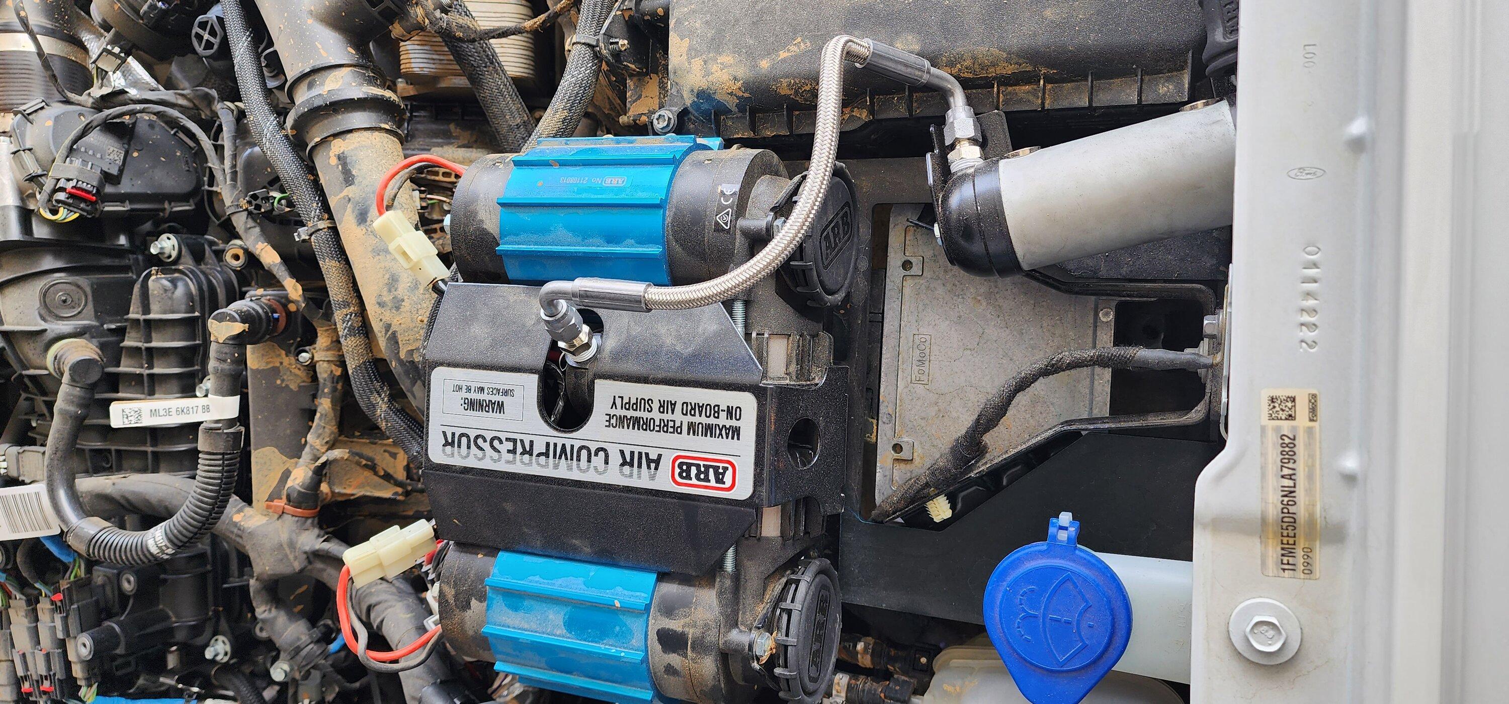

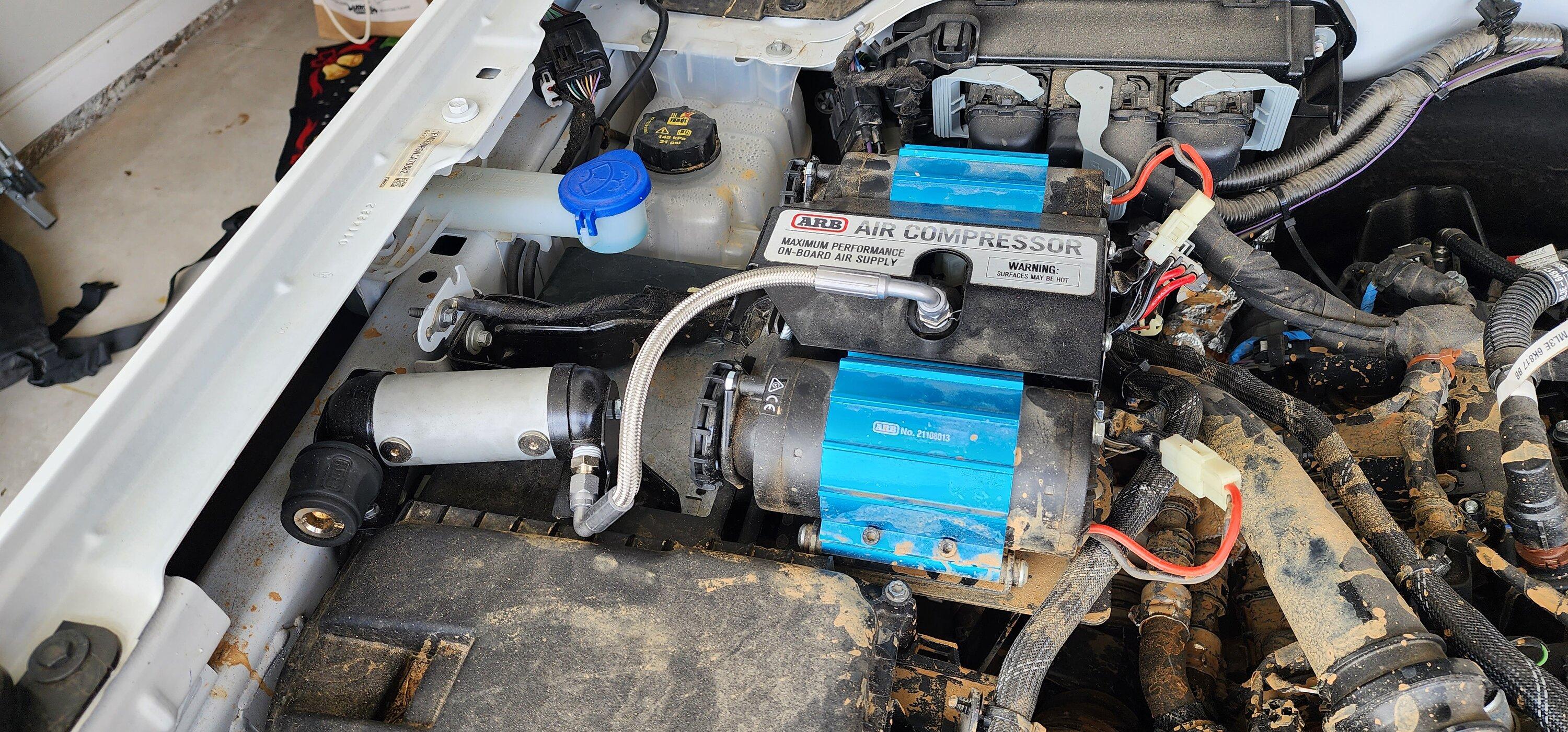

GABroncin
GABroncin
Clearance is tight but I've got my ARB dual setup mounted in the bay with a remote diaphragm as well to keep the hose from popping from the heat from the compressor. Definitely a requirement, not a suggestion.
ARB was kind enough to send me a new hose after I popped mine filling up after hitting Beasley Knob. Hose got too hot and pop! ARB said the instructions told me to use a diaphragm, but apparently I got older instructions cuz mine didn't say that anywhere... Anywho, I bought and installed the diaphragm and have had zero issues since. Total confidence in the system.
Excuse the mess lol
