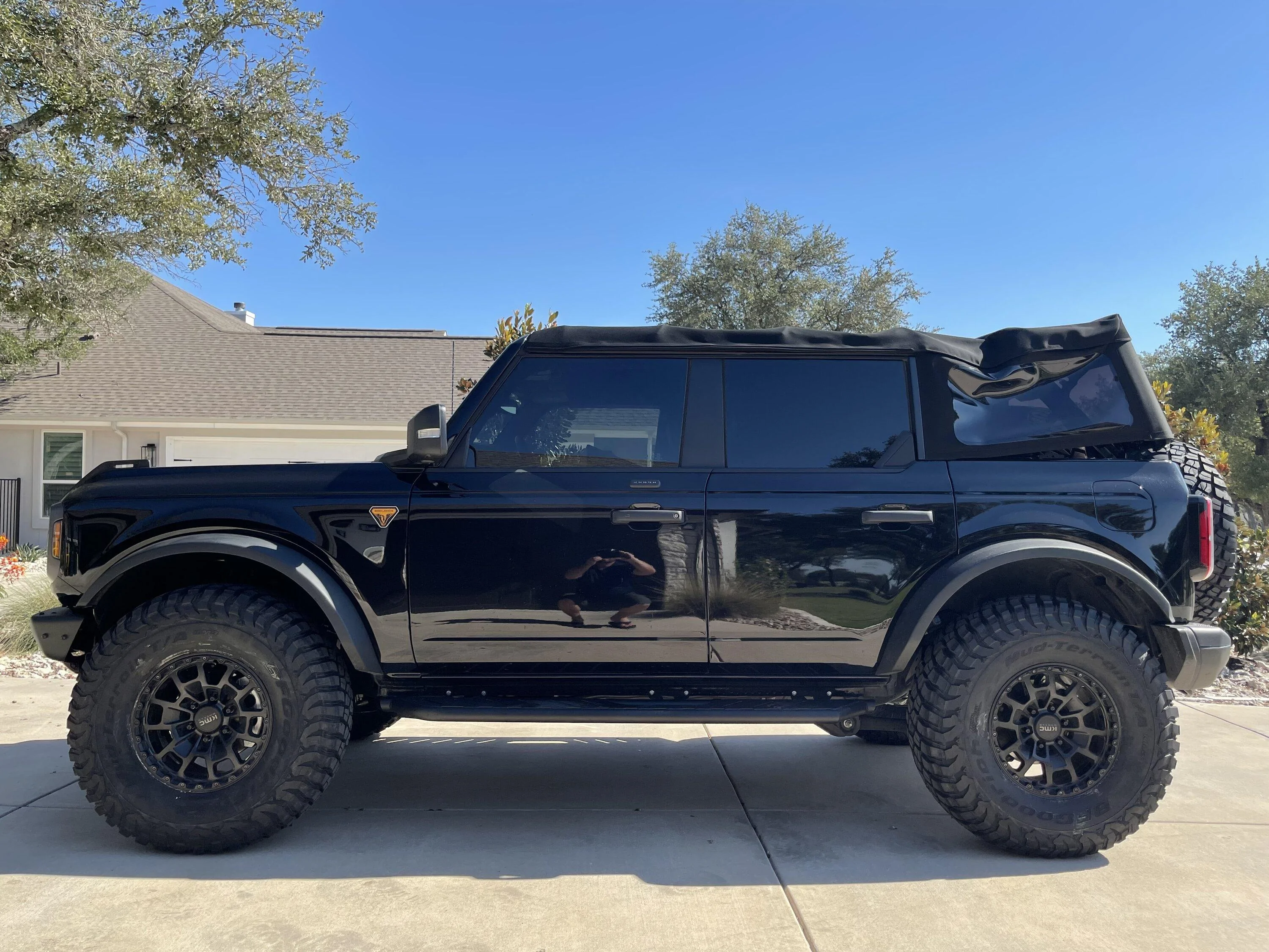

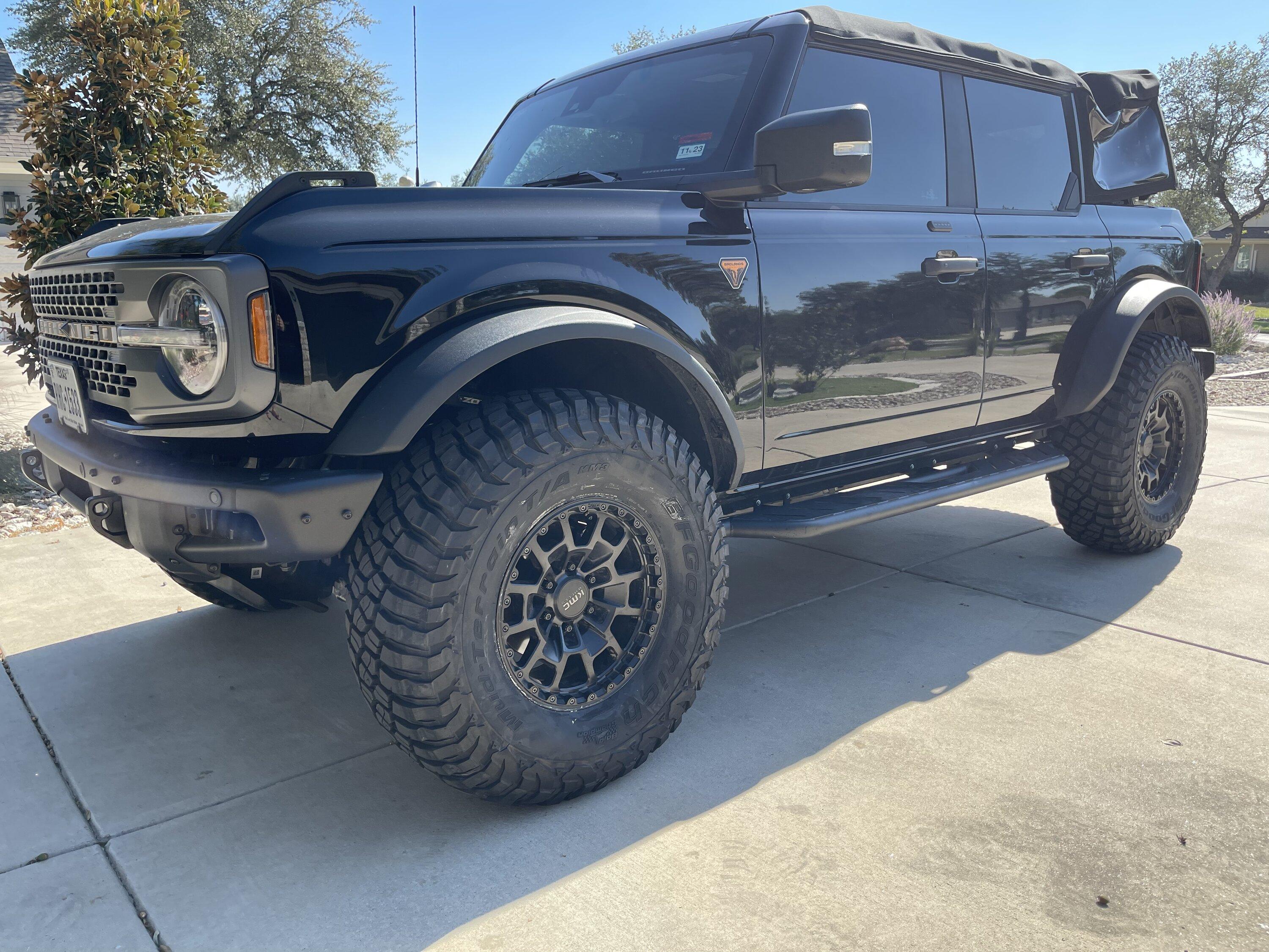

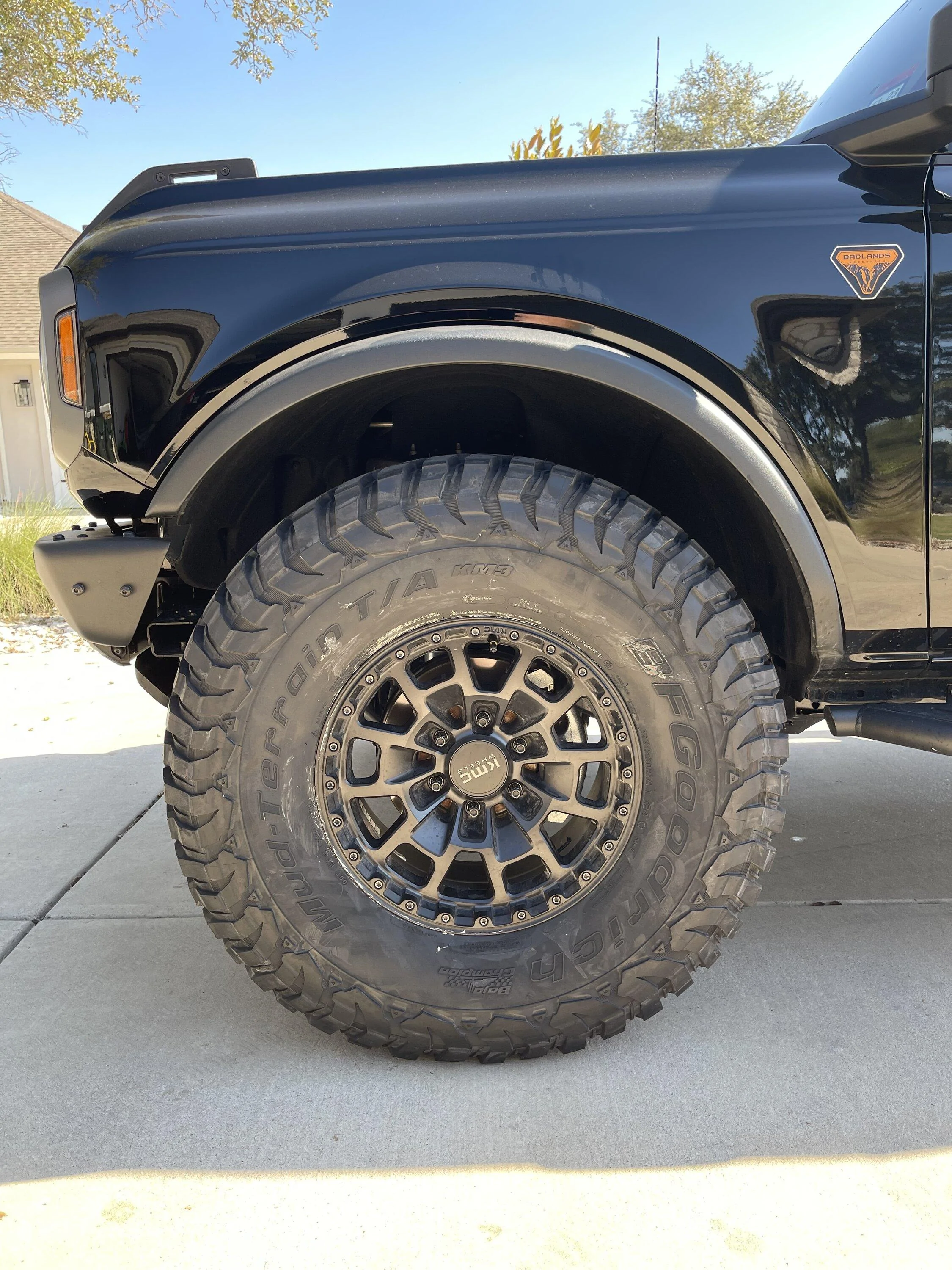

Hi yall, small favor to ask
can someone with a stock height 4 door Sasquatch measure their height from center hub/wheel to bottom of fender flare (front and back)?
just installed the Bilstein 6100s and completely forgot to get measurements of “before” to check level. I still have a rake so questioning how much the front end actually came up.
thank you in advance!

I installed all four (front and rear)
Used spring clip position #5 (2nd highest of the 6 total)
Was supposed to increase Sasquatch front 2.0” and rear 0.9” but I still have a 1.5” rake. Completely forgot to measure the before on the hub to fender to actually confirm lift.

I measure 23" front and about 22 7/8" rear. I do have the security drawer installed in the back, so that adds a little weight there.

After lift is only 23.25” in front so def confirms didn’t get the 2.0” it was supposed to. I’ll get with Ford dealer that installed and see what’s up.
