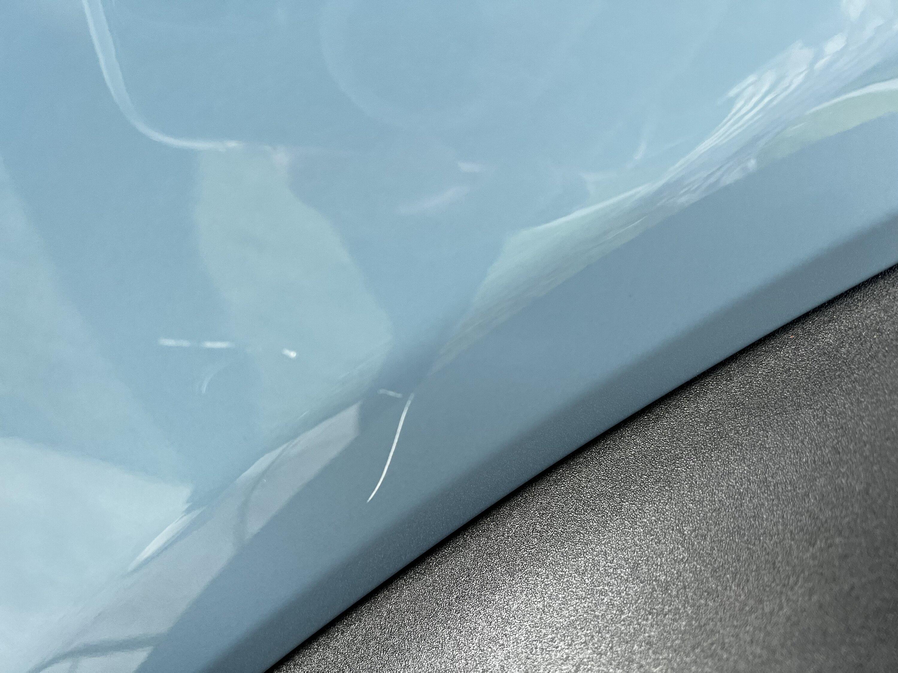

2. I don’t know what is going on, but this car attracts scratches (Area 51). Any suggestions on ways to patch them up?

On the scratch front, what type of scratches are we talking about, swirls, or what?

Here are the scratches. Attached to original post. Someone must have scratched it walking by or something. Super annoying. Would love to patch them up.

A good detail shop should be able to get that scratch out about 80-90%, it looks pretty deep.
