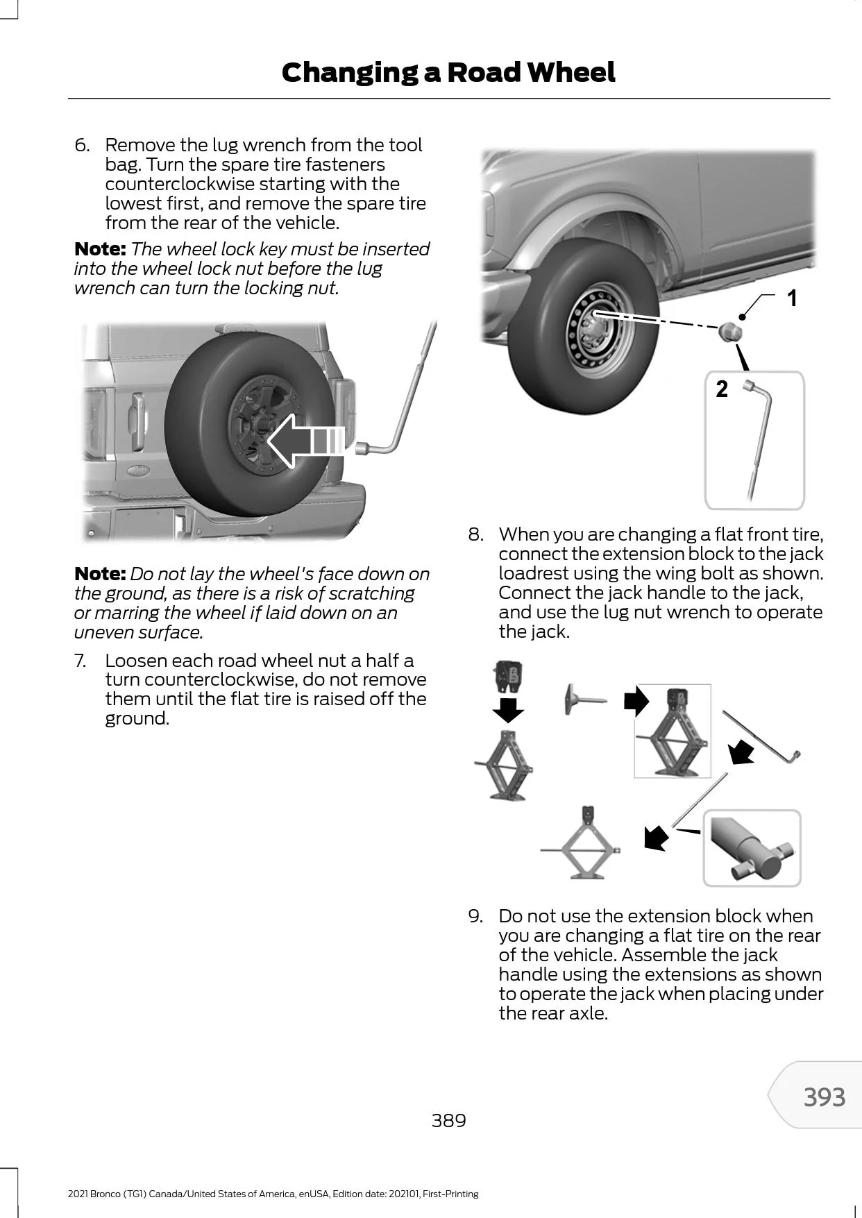

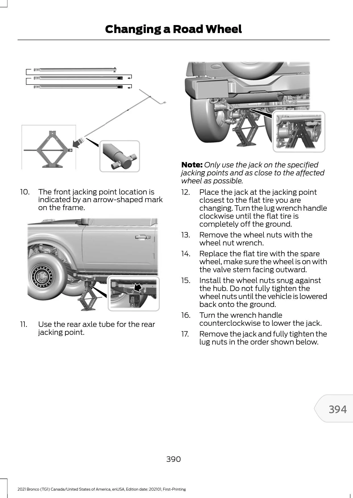

Other stupid question! I can easily see front jack points. WTF is the rear. I was hot/pissed -and tired at that point and didn’t really care. Second stupid ? Does having ‘Pepe’ in 4A help when that happens? Auto computer control of other 3 wheels. Not a gearhead but that just occurred to me. All is good - just out a new tire! PSS. Those Tires are Frickin heavy 🥸🏴‍☠️😎

Sorry to hear about your blowout.
The jacking point for the rear is the rear axle tube.

Thanks! Figured that was it. But just hate doing that. Something in my bones said no. But thats where it went😂. What the hell - it worked.

Yeah, most body on frame vehicles use the rear axle as the primary lift point, although some have good spots on the frame near the rear tire.
