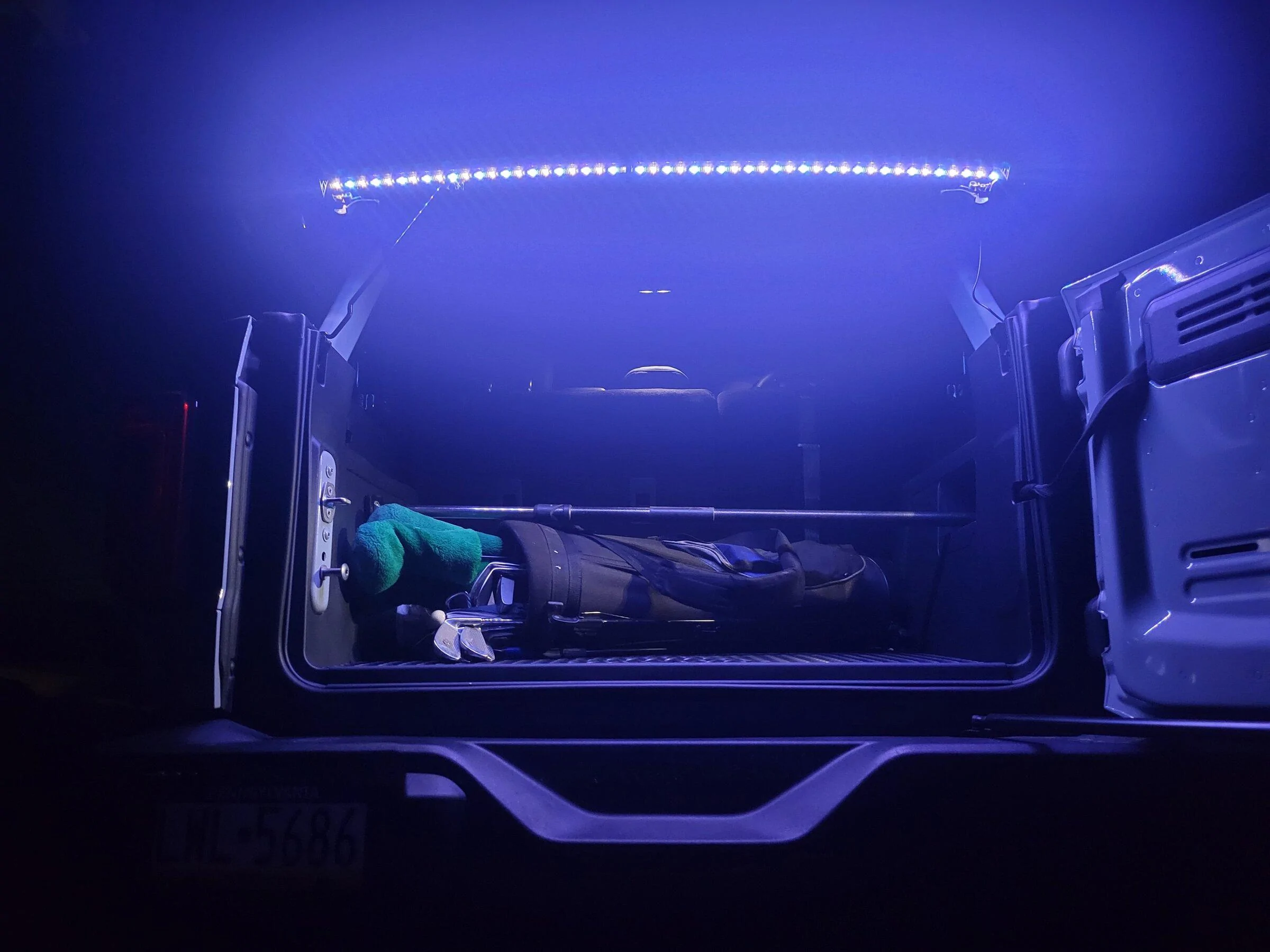

-cargo led lighting hardwired with a switch

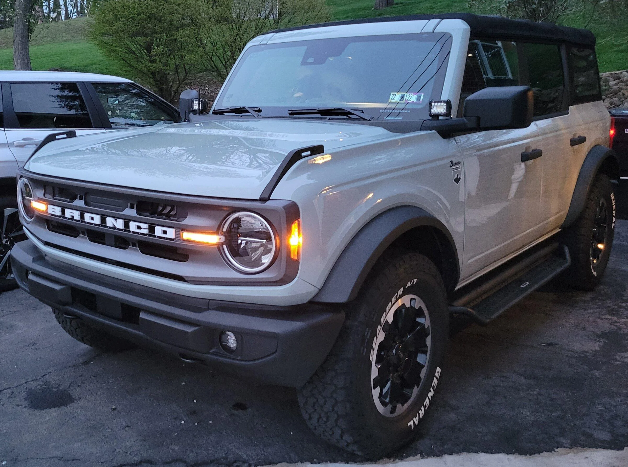

- tires and rims
- running boards

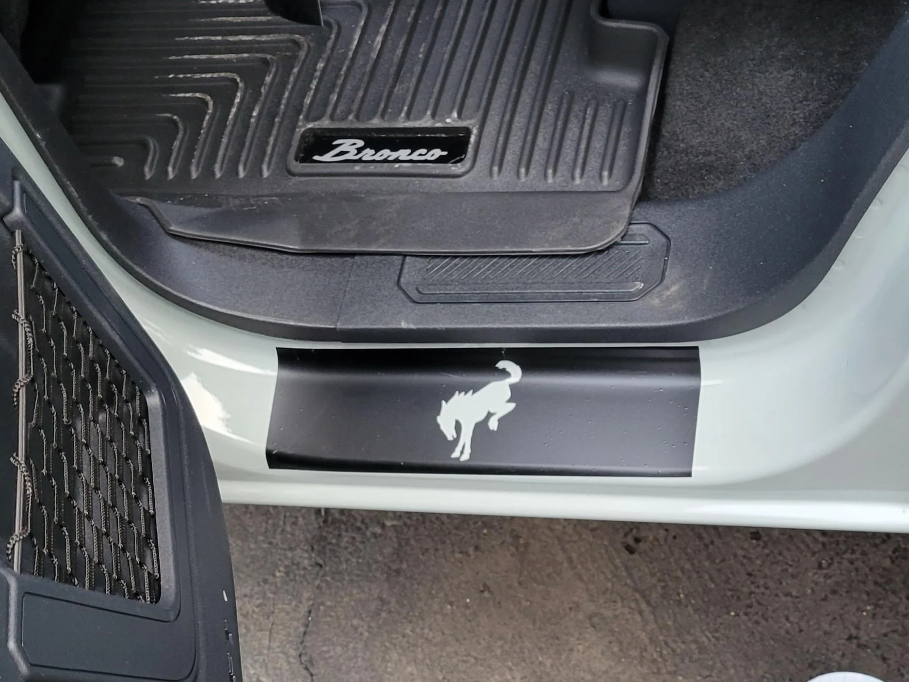

- custom door sill protectors
- custom floor liners

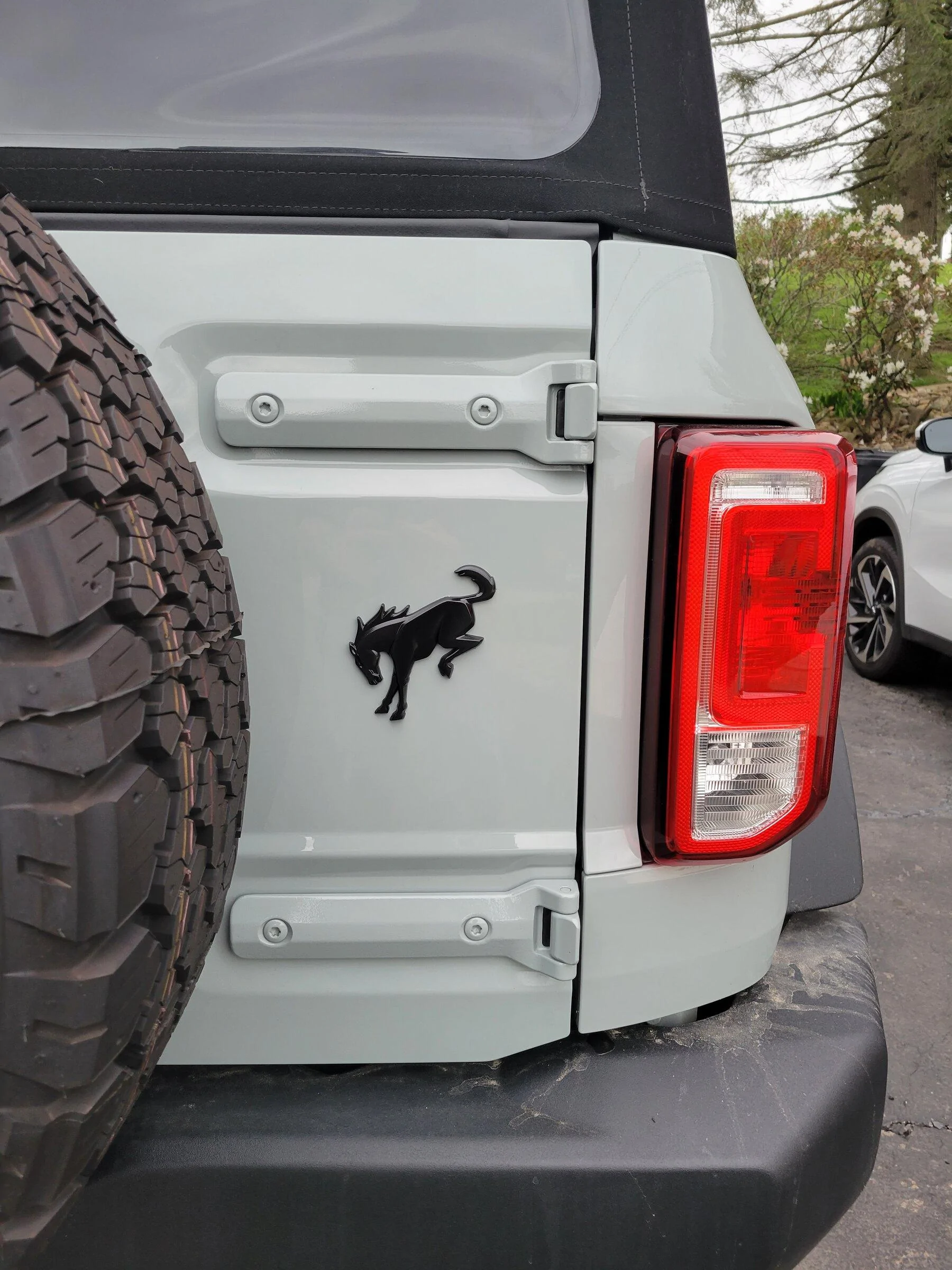

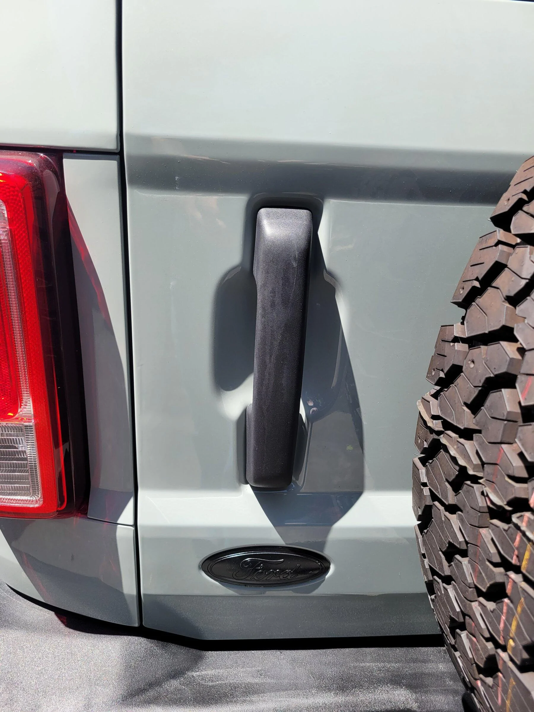

- blacked out ford and bronco emblems

Looks great! Where did you get the cargo LED lighting? That is a nice idea I never would've thought of. I really like the tires and rims, what did you go with?

@Tdub0527 I used a standard led light strip and hardwired it into the 12v outlet for power and added a switch. If the switch is left on it will automatically shut off I'm 1 hr. Then u will need to hit the ignition button again.

The tires are General Grabber A/T 275/70/18 and the rims are actually from Ford. I'm gonna add a 2" lift and replace these tires with 35s.

Nice mods. Tell me again how the rear door bronco emblem was blacked out?

@Jack D I removed both emblems carefully using an old plastic card and a plastic scraper. The bronco is only held on with black adhesive, but the ford emblem has the adhesive and 2 plastic clips, which u will need to be careful not to break when removing. I used 5 light coats of plastidip and then 1 final coat of black paint for a nicer finish. You can just paint them if you want but I wanted to make it so it could be returned to stock. I used 3M emblem clear adhesive for the install.
