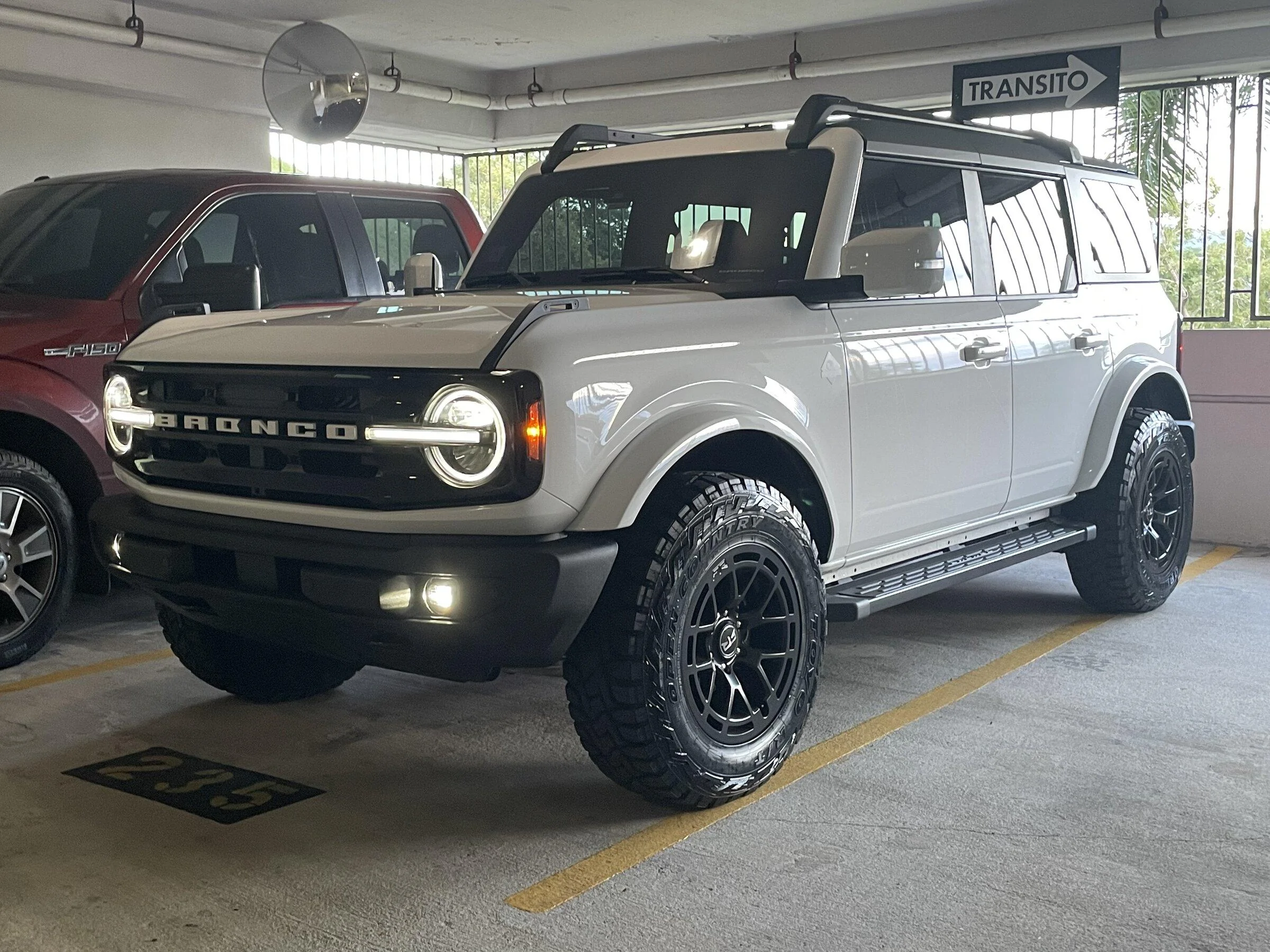

errejerre
Toyo RT 275/70 R18
RTR Wheels 18” +30 Offset

Do you have any more pics of this setup? From the side and is there any poke at all? Looking at almost the exact same setup. Looks really good in this pic!!

@errejerre I see lots of OBX owners going with that tire size. Any mods or is that stock height? Also, any impact on the speedometer?
