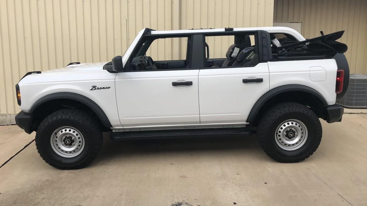

I just put on 33s without doing a leveling kit looks great and has plenty of clearance. Tires wise those are all good tires I would run with the one you like the best. Out of those brands they are all comparable.
