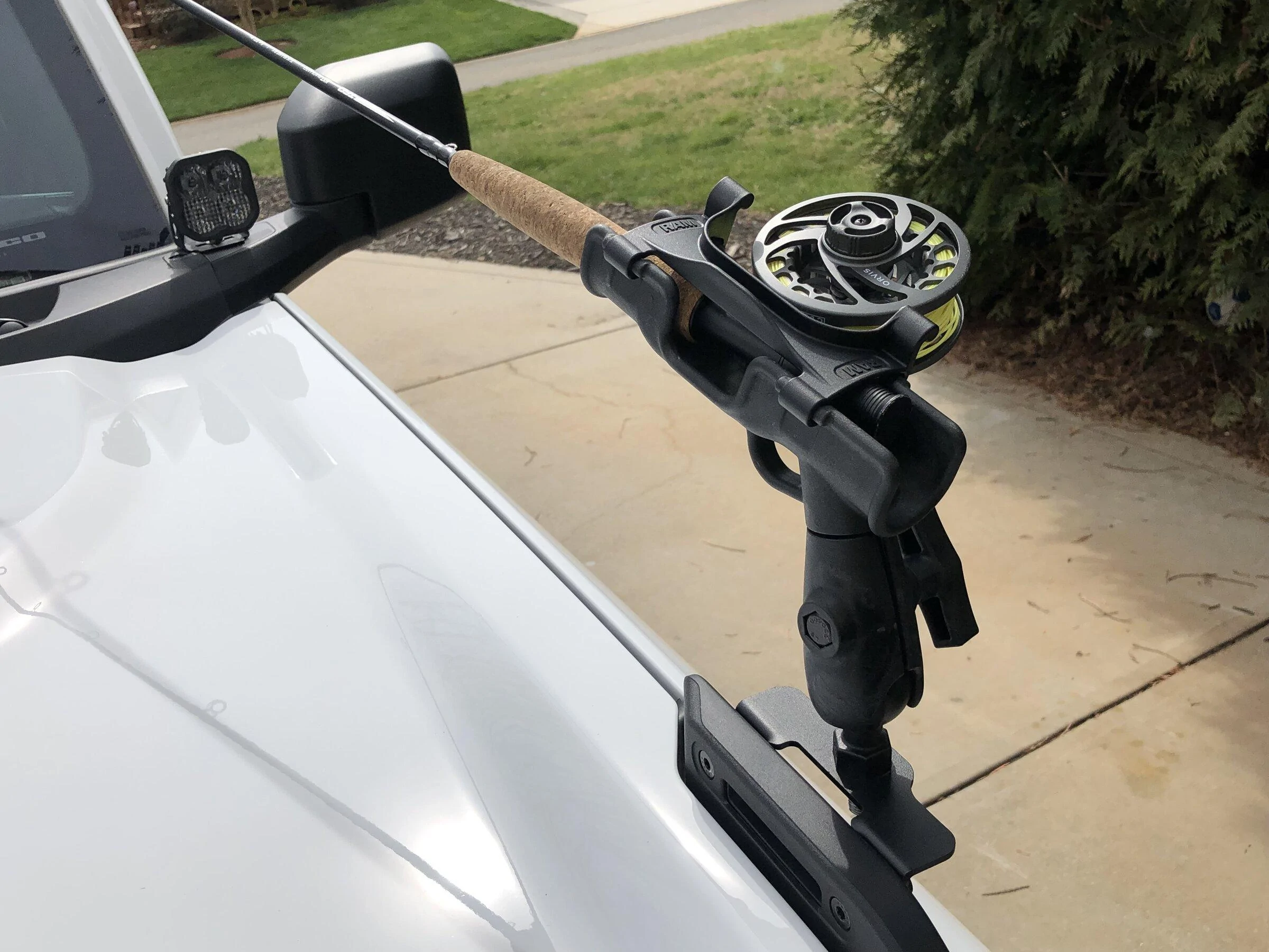

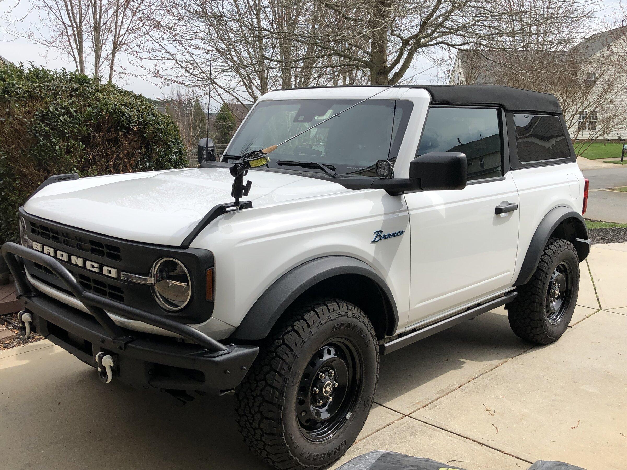

Hey all I thought I pass along my rod holder idea for any other anglers looking for cheap easy rod holder. This will work with a fly rod or a small to med sized spinning rod. Ever since I saw the Bronco OBX fishing rod holder concept I wanted to add this. There currently isn't one available so this is what I came up with on my own. Links below for all the parts I used. There are a bunch of other RAM mount rod holders I just happened to like this one the most for my needs and its a little lower profile.
Disclaimer: Its not a theft-proof solution more just a transport solution. Fishing in WNC sometimes you're in and out of your truck a few times a day moving from location to location. This is why I decided to add this to make it quick and easy to transport and so I didn't have to break my rod down each time I moved or worry about it getting broken accidently. After putting the rod in the holder I also added a couple mini-bungies around the rod and mount to keep it from moving up and down.. I have tested this at highway speeds.
It's solid AF, can be completely removed in less than 3 min, and doesn't affect the operation of opening the hood.
TrailRax Mount
https://www.trailrax.com/collection...ducts/ford-bronco-trail-sight-accessory-mount X 1 or 2 depending on if you wanted to mount one on each side
Price per $29.99
C Size 1.5” threaded ball 10MM
https://www.expressmounts.com/search/q=rap-379u-m101525
Price per $11.99
RAM Mount Plastic RAM ROD-2007 Jr Fly Fishing Rod Holder with 1.5”
C-Sized Socket
https://www.expressmounts.com/ram-mount-plastic-rod-2007-jr-fly-fishing-rod-holder-with-socket
Price per $16.99
SS Lock nuts
https://www.amazon.com/gp/product/B07LF1DN38/ref=ppx_yo_dt_b_asin_title_o04_s00?ie=UTF8&psc=1
X 1 package of (4) M10X1.5 thread locking nuts
Price for 4 $6.46
Total price for one rod holder mount $65.43 each.

That’s slick. I got a similar bracket from AC fab, gonna mount my GoPro to it

That’s awesome, thanks for sharing. I use the Tight Lines vacuum rack. It has gone up a lot in price since I bought mine but this is a neat solution.

Yea really like this.
