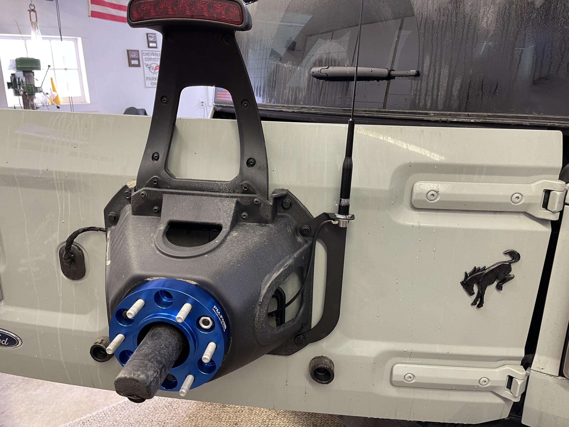

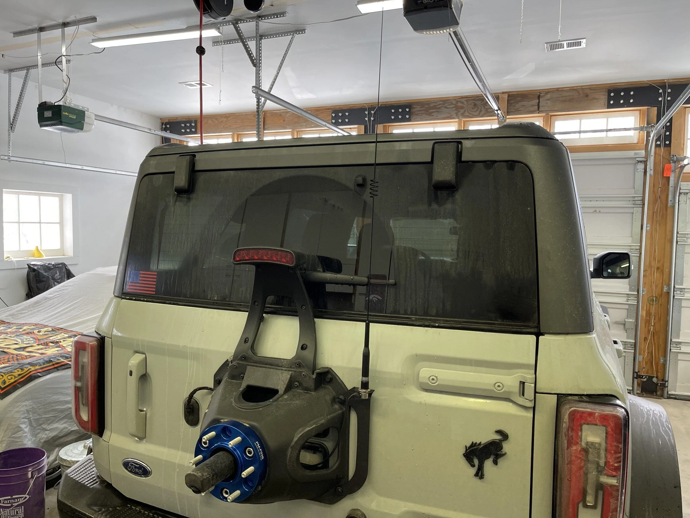

If anyone needs a 1.25” wheel spacer, I have three left over from a ham radio antenna install on the spare tire mount. Hit me up, free. I’m in northern CO.
If interested with what i did, used this mount: Here

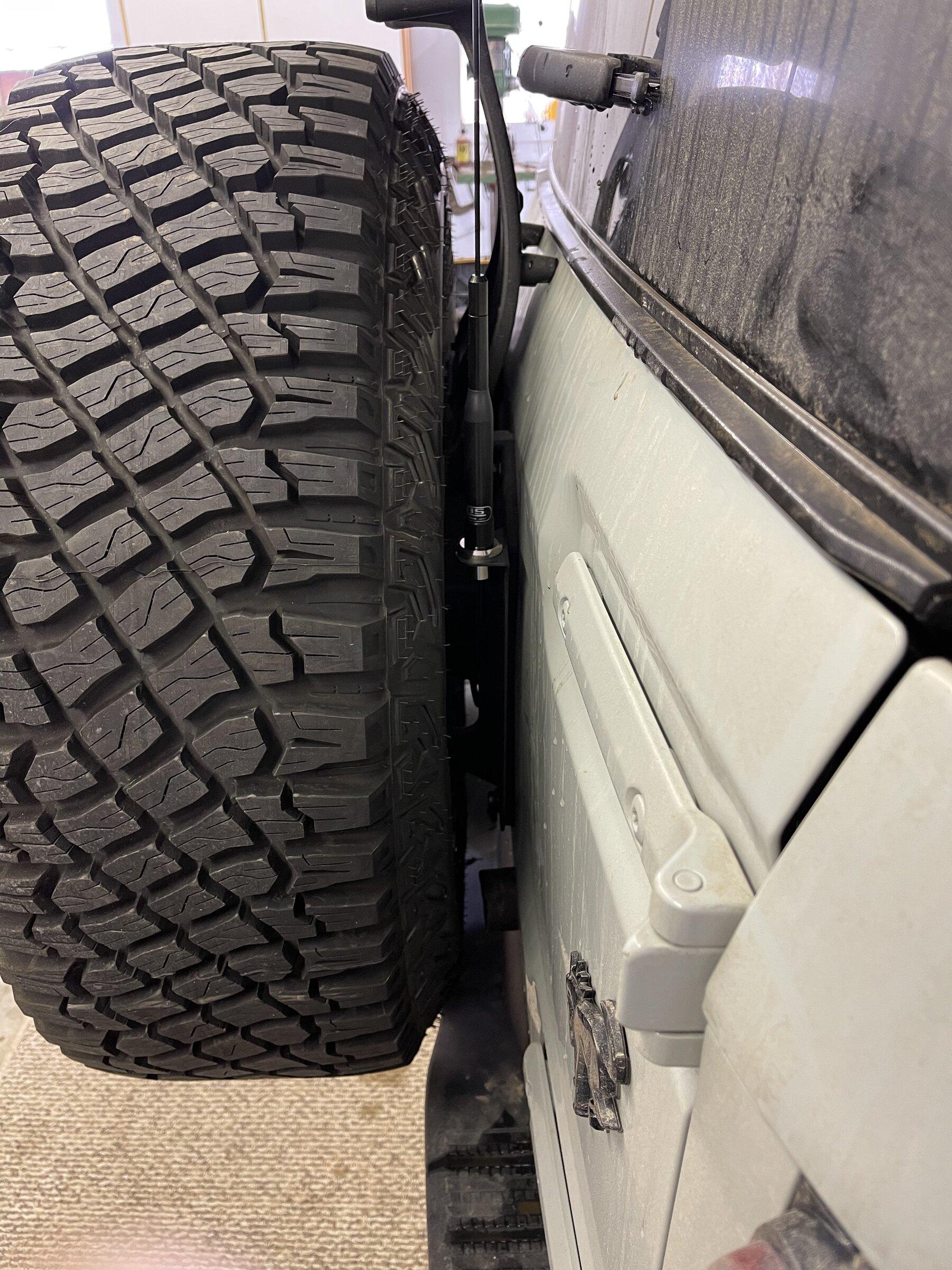

It’s a Jeep antenna mount that has the exact same bolt pattern as Bronco, then the wheel spacer moves the spare tire out to give room for the antenna.

@Raptor18 Clean install...thanks for sharing the idea!

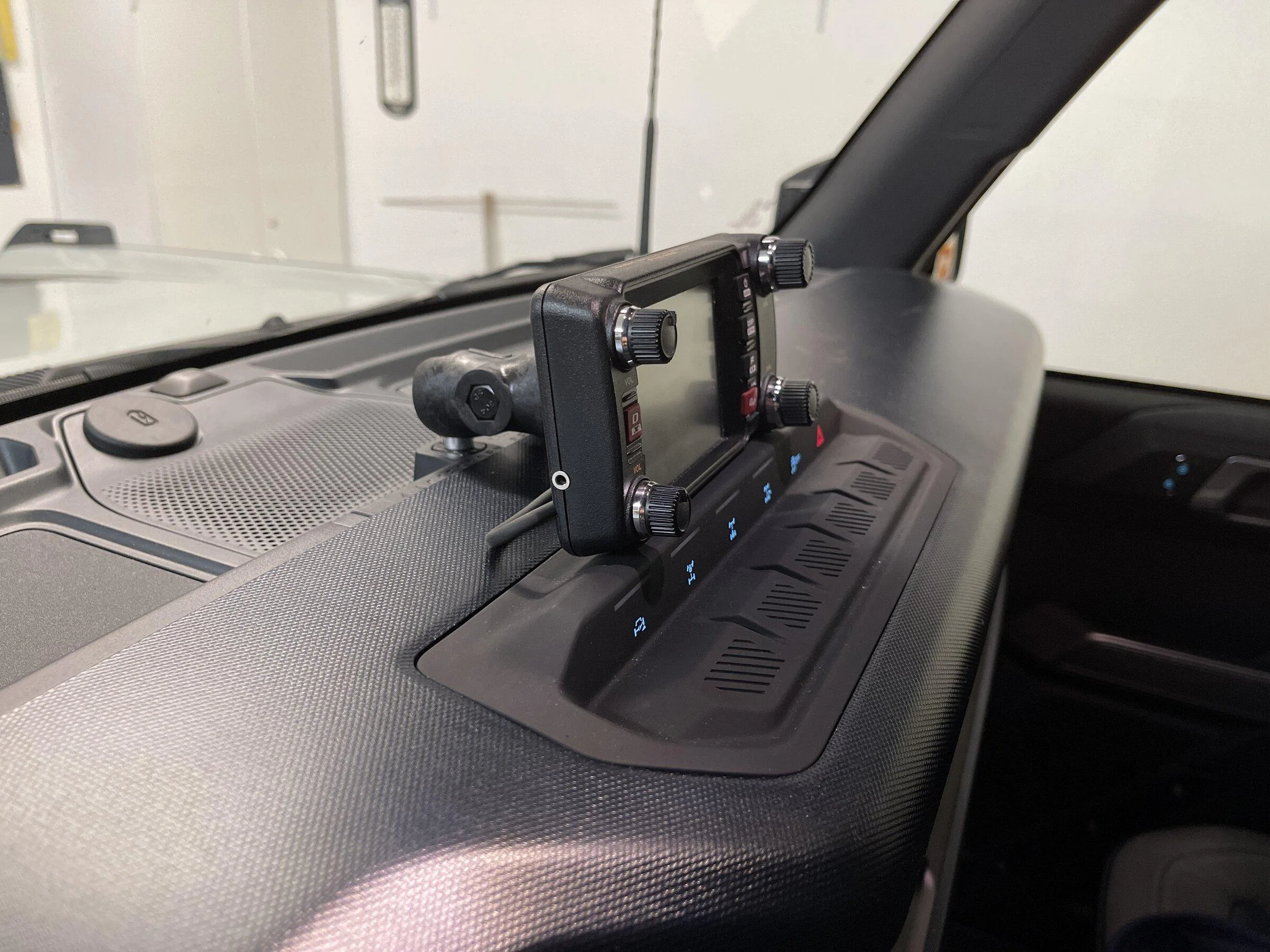

@Raptor18 I'll look at Rugged. Do handhelds work well enough? Not sure where I'd mount a radio. Grab handle mount at the center console might work.

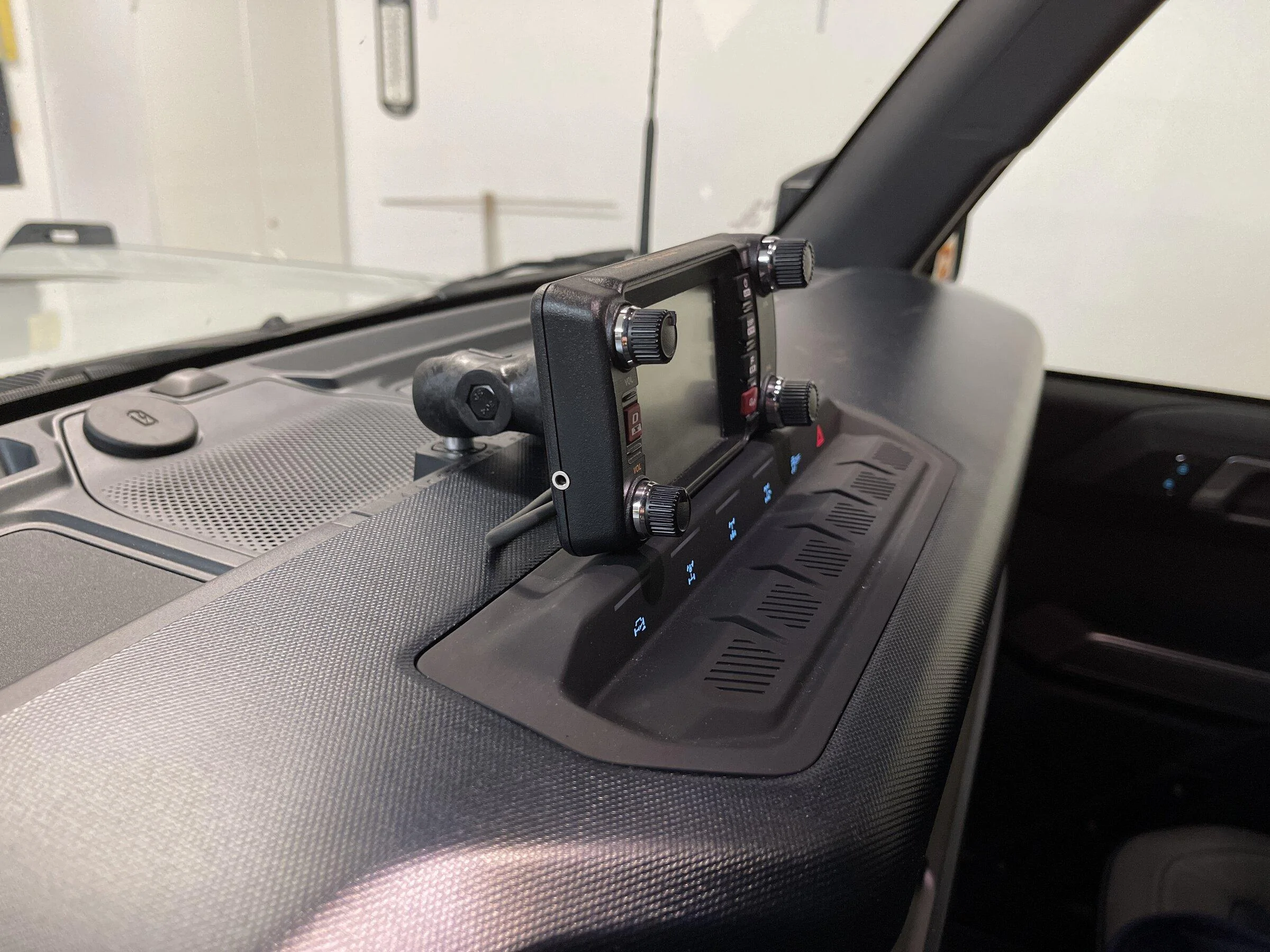

@Harumph I added a pic of the dash mount to the main post.

@Raptor18 Looks good! This makes me think I "need" a radio with a removable face.
Does the faceplate block much of your view? I considered mounting an Ipad Mini on the dash to run the on x app. The XY looks to block quite a lot of my forward view. Maybe not really a big deal after all.

@Harumph Not too bad, I’m 6’4” so anything blocked by the radio is mostly hood. The rear view mirror in these things are far worse.
An iPad mini is definitely bigger than the radio display, it might be a bit much.
