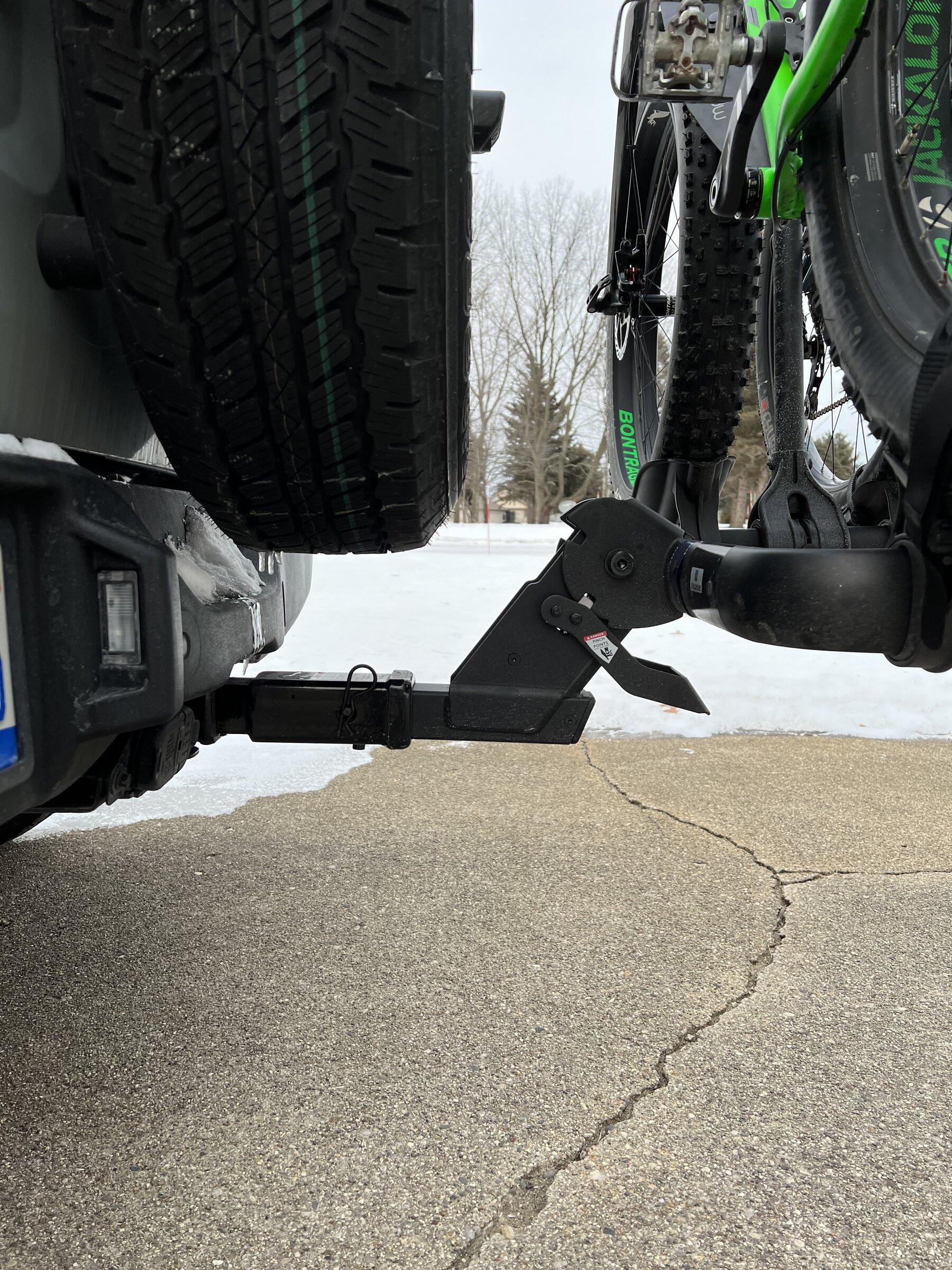

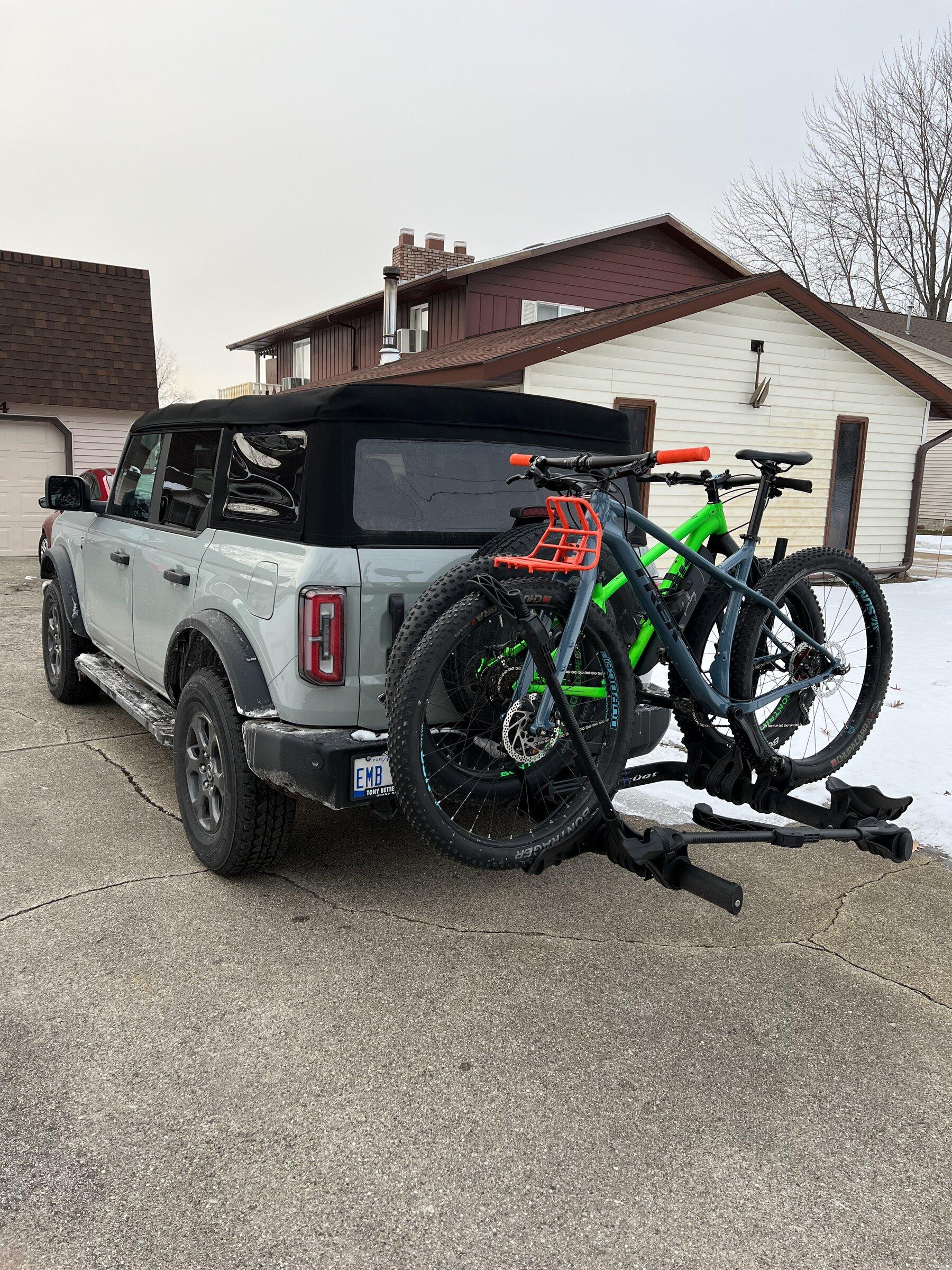

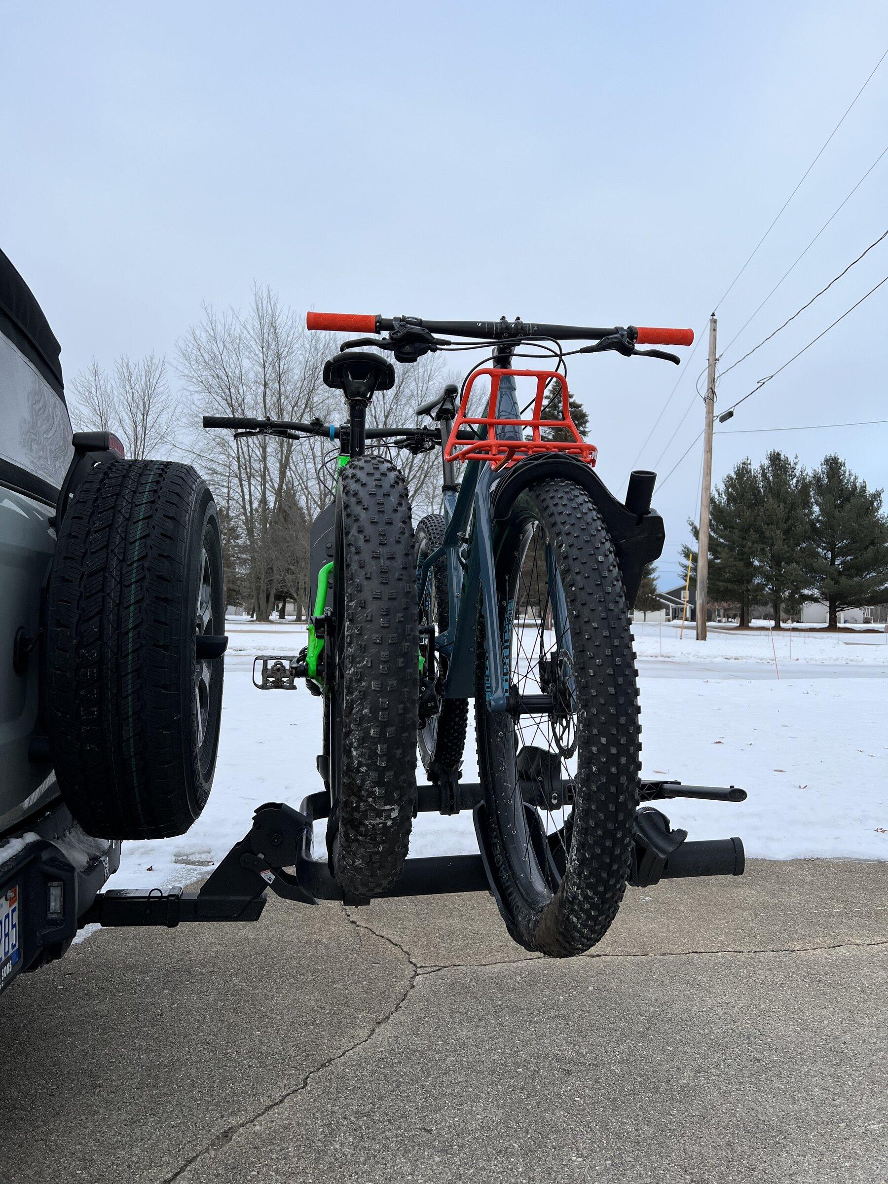

So funny that @ArrickSports just posted this below about the aftermarket hitch, I was literally writing this up. Here was the work around I did. If you are someone that likes to haul bikes around I needed an adapter to extend to clear the tire. This is a Kuat Transfer V3 hitch bike rack. Because it folds up and down it has a large piece that hits the tire. I needed 3 inches to clear the tire. A local trailer company sold a 7" extender. It does lower the weight capacity of the bikes you can put on the rack, so I would recommend a different solution but it works for me for the time being (unless the weight of your bikes are minimal or you just have one bike). I will probably move the tire eventually and will get the aftermarket hitch mentioned below for our second Bronco. We like to ride bikes so it was important to be able to fit a hitch rack on the back of ours.
