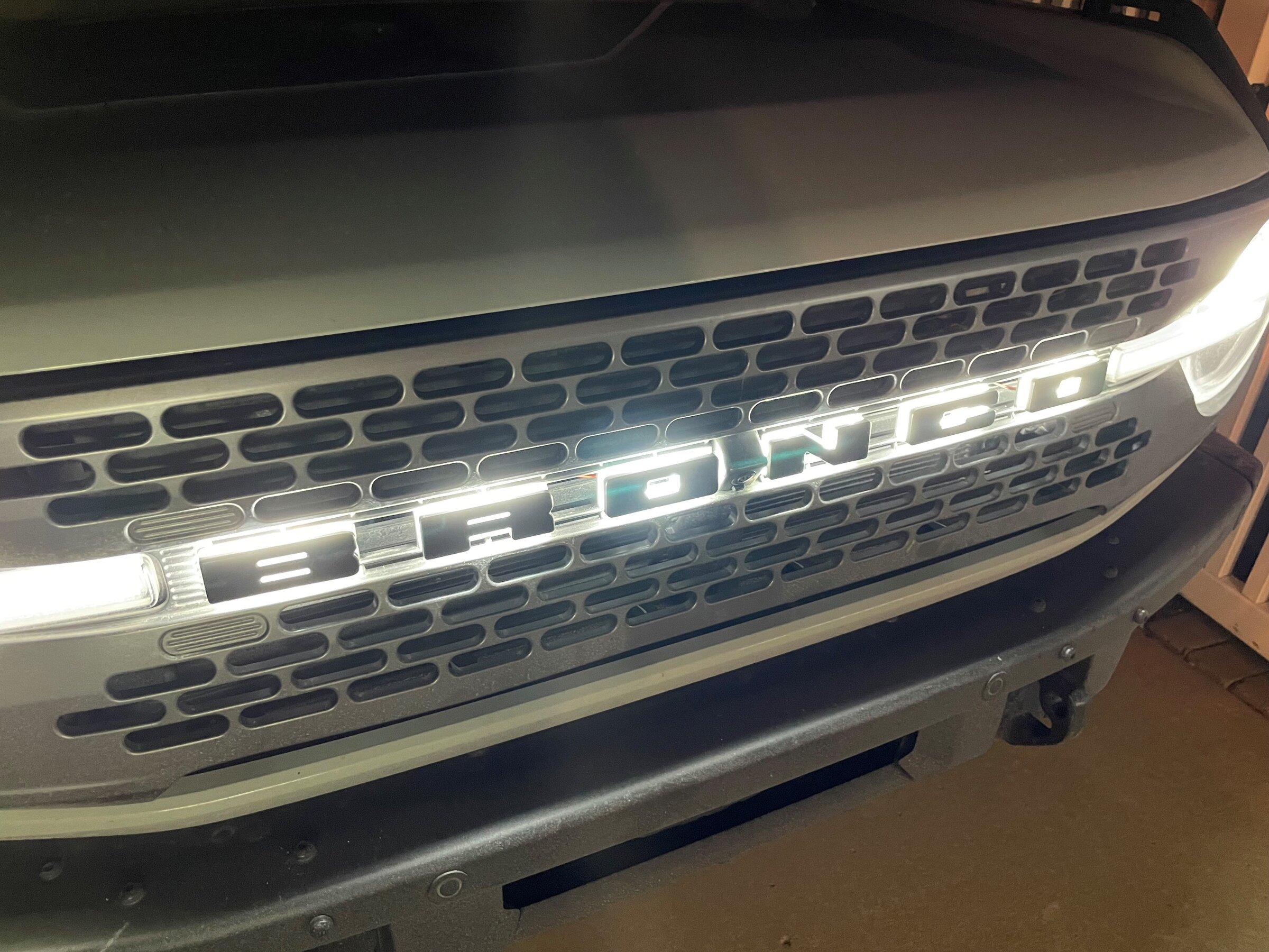

Installed these last night. I am really happy with how they came out. They are Oraclelights.com grill lights.

I like this... and I think I would like it more if the letters were translucent to really let the light inside. I'll probably have to make some molds and mess with epoxy now.

@DasQball I am actively trying to get rid of any trim that is not black on my vehicle. This is step one. They make these lights in white or black letters with white back light and white or black letters with amber back light.

Looks awesome! Currently on the fence about getting a set

Looks very cool. Hoping to get my Bronco in a few months and start to modify.

Not my cup of tea, but great job on the install - looks well done.

Very nice. Looks great!

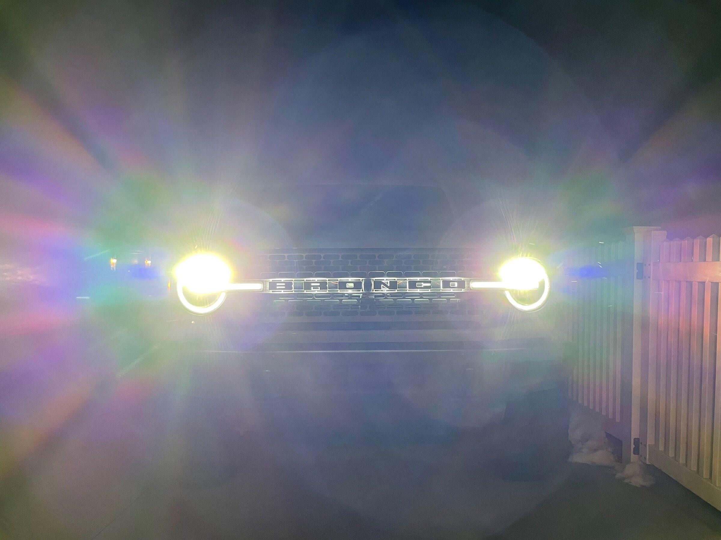

I read that whole 19 page thread on those lights. I went from very excited to meh to maybe to I-don't-know to I'll wait to see more photos of the finished product. You're picture on the right looks great. That would make me want to get back on board. How difficult was the wiring? Pretend I've never done any automotive wiring ever lol.
