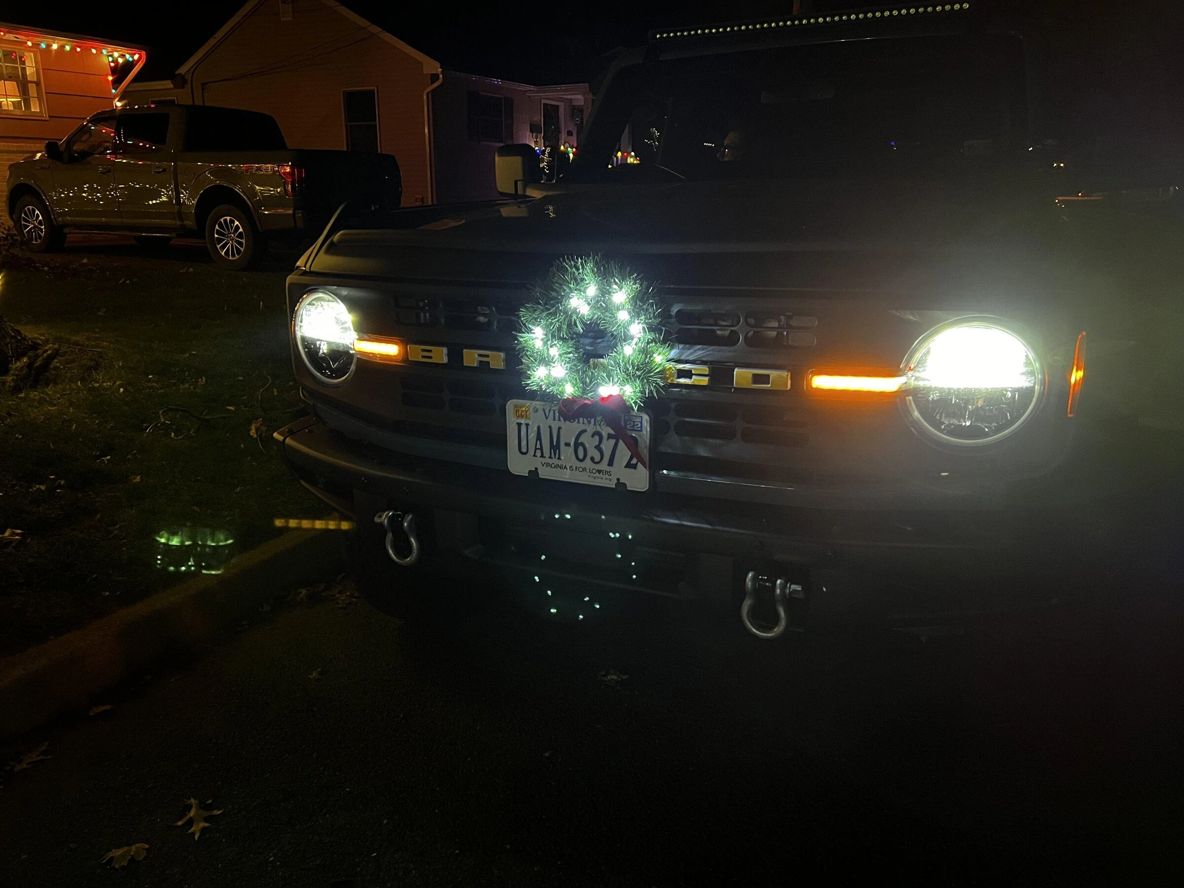

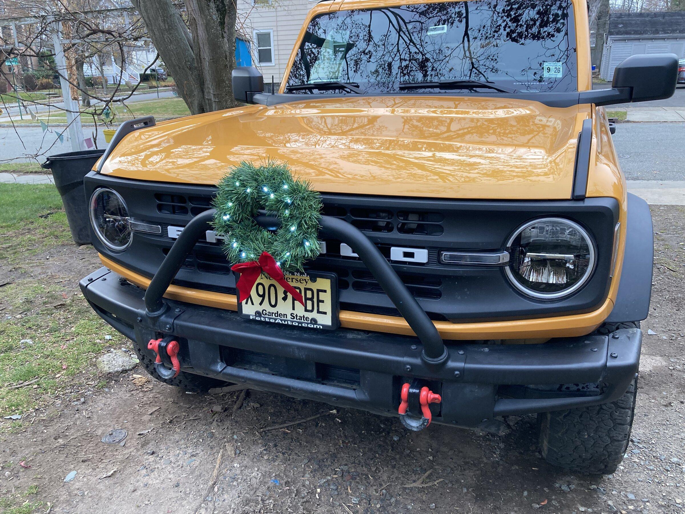

So I finally connected one of the upfitter switches today. I connected my Xmas wreath up as I originally had the wire going down the inside of the passenger side fender and into the cab to connect with the center consol cig lighter socket but that is always on and was having to disconnect manually. I opted to use weather proof connectors for easy disassembly and kept the lights original cig plug as it had a built in 3A fuse by getting a cig socket off Amazon.
Wire now runs from grill up to front engine bay, across to driver inner fender and down to the aux switch wires . I used aux 1 (yellow) but in future I can quickly swap to another - well once I crimp on connectors to the other wires that is as it’s cold and didn’t see the point in going all the way with that.
