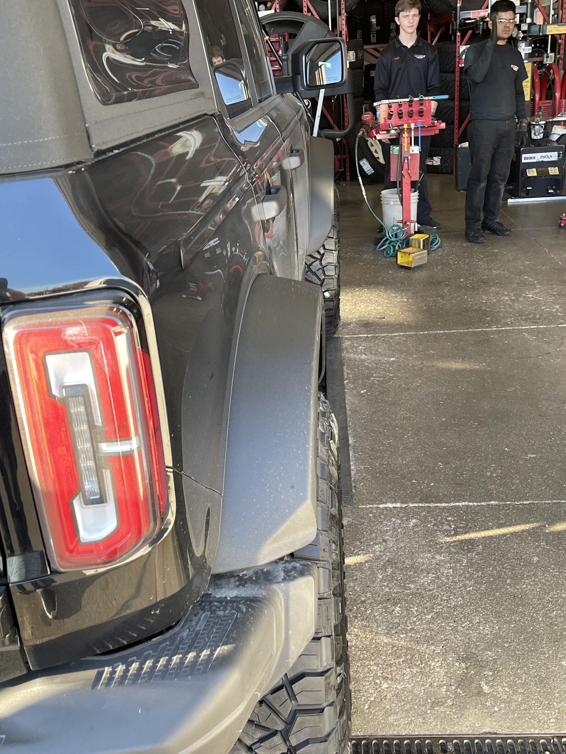

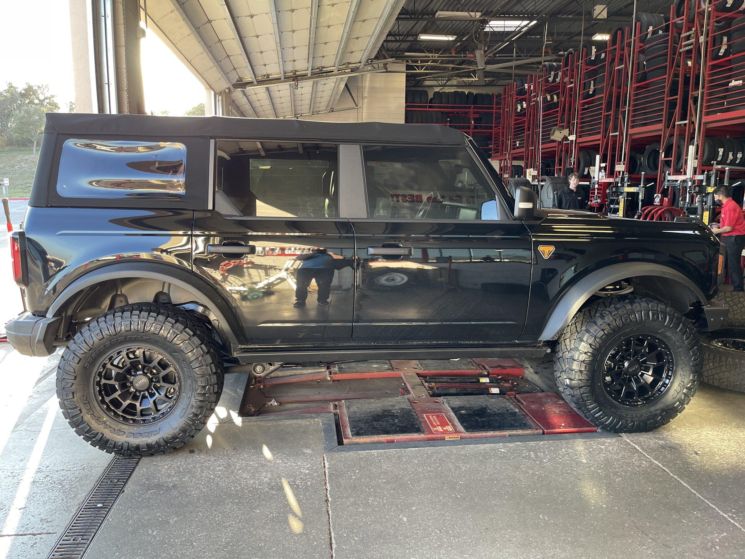

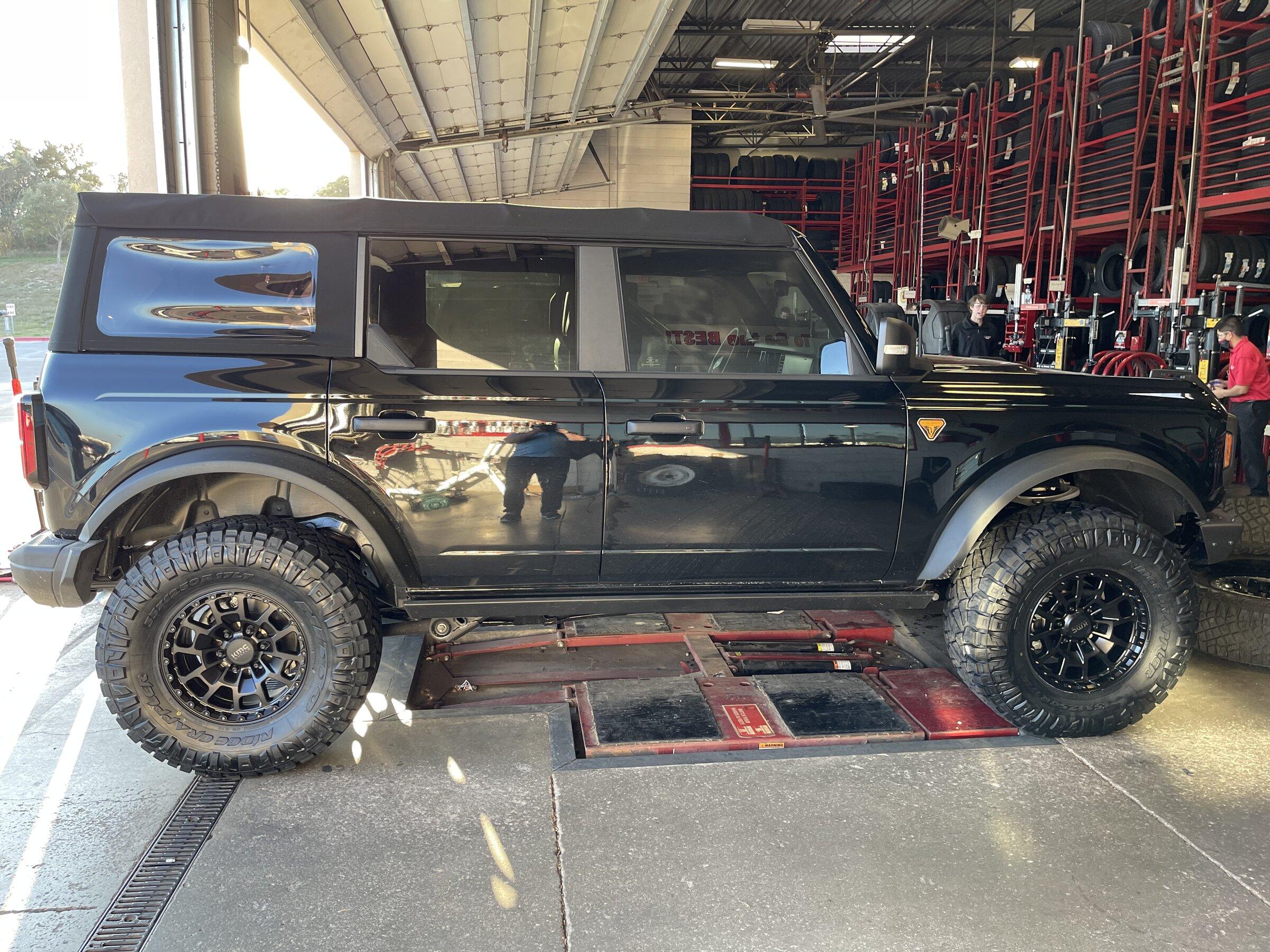

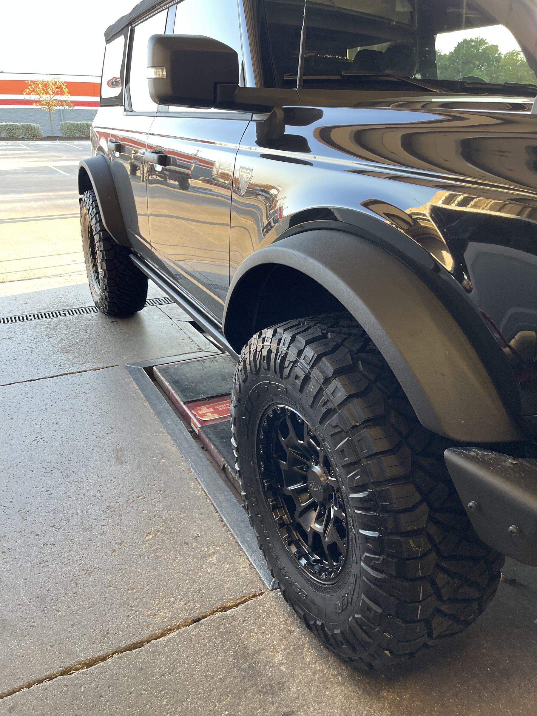

New kicks for the Badlands today. Pics after install at Discount Tire in Leander, TX.
tires - Nitto Ridge Grappler 35x12.50R17
Wheels - KMC “Summit” 17x8.5 +18 offset
Slight more offset than factory +30 Sasquatch wheels, but def like the treads on the Nitto. Just a hair of a “poke” outside fender without the concerns for throwing rocks against body.
The factory Goodyears are a little softer ride vs the E rated Nitto, but highway noise I think is identical.
love the blacked out look with the Shadow Black exterior! Thanks for checking out!

Did you need any type of lift to outfit that? Or because you had already had the Sas package, you were fine?
BroncoZ13
BroncoZ13
No additional lift, just the SAS and happy to report zero rub at full lock. The 35x12.50 is only 0.5 inches taller than the stock 315/70r17 so figured I would be fine. Very happy with the tire/wheel combo! Thanks
