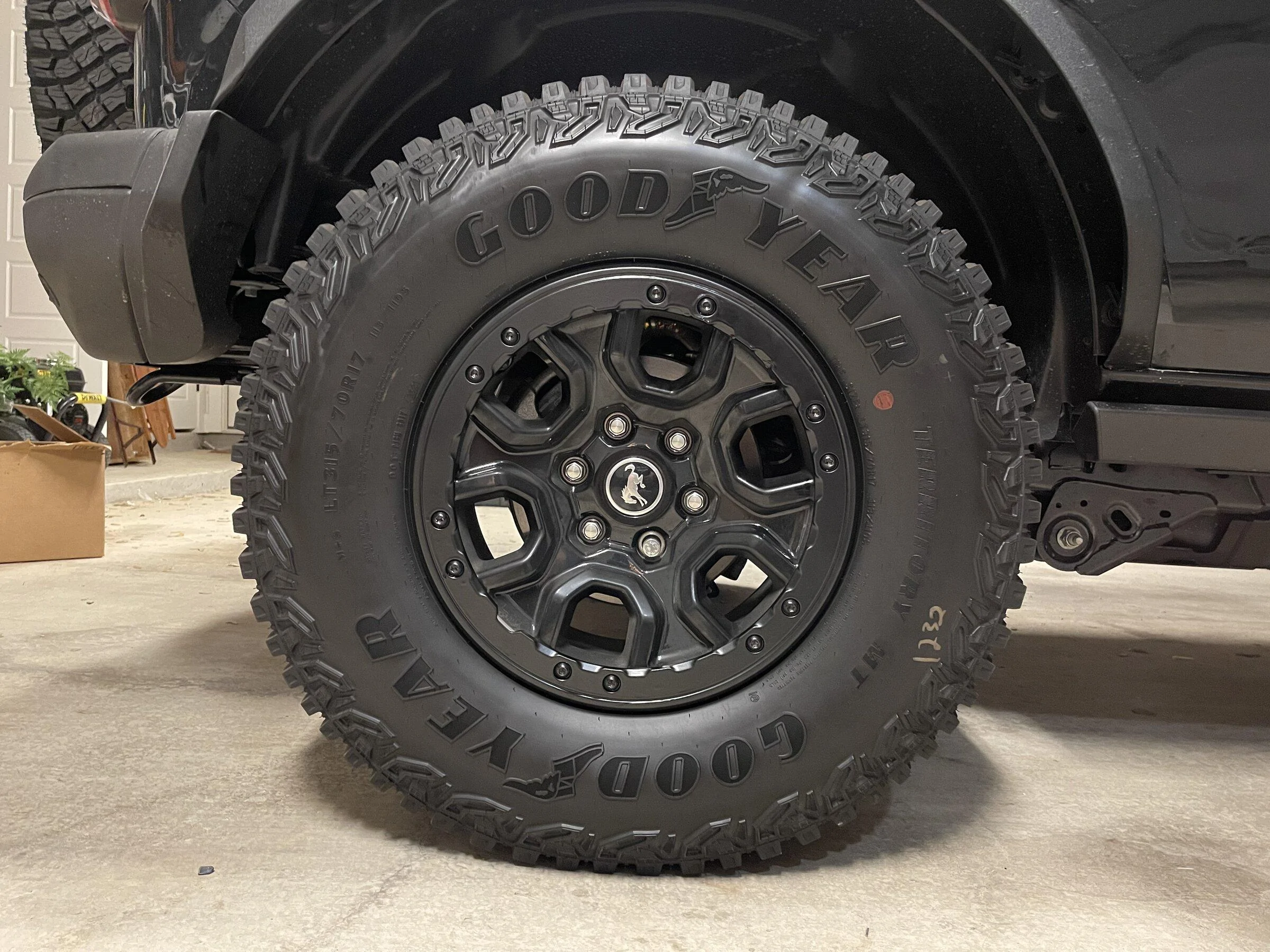

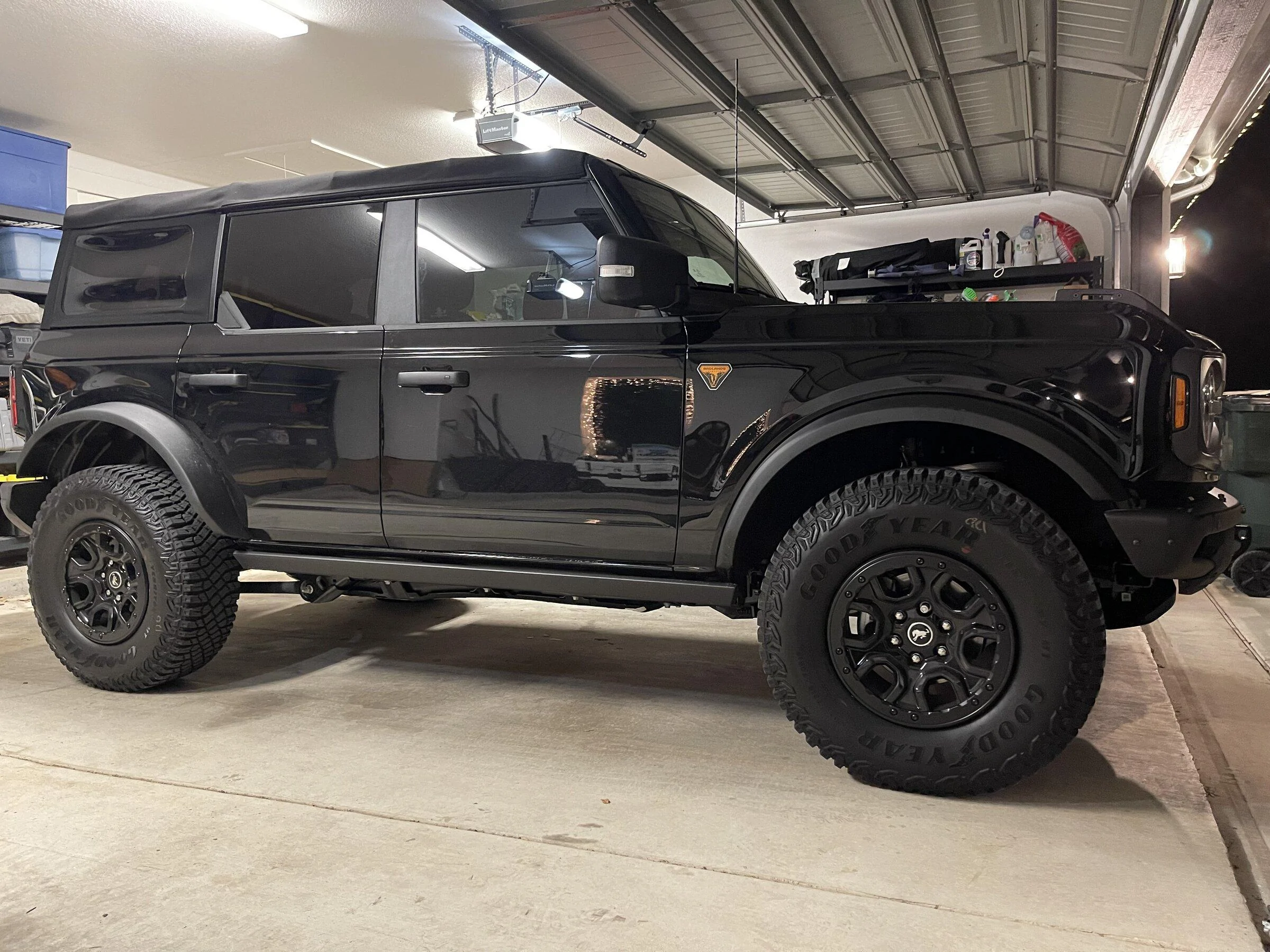

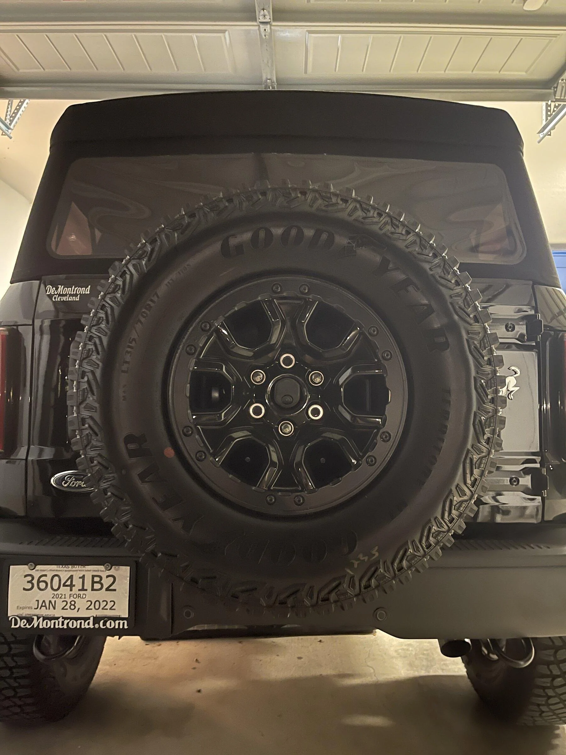

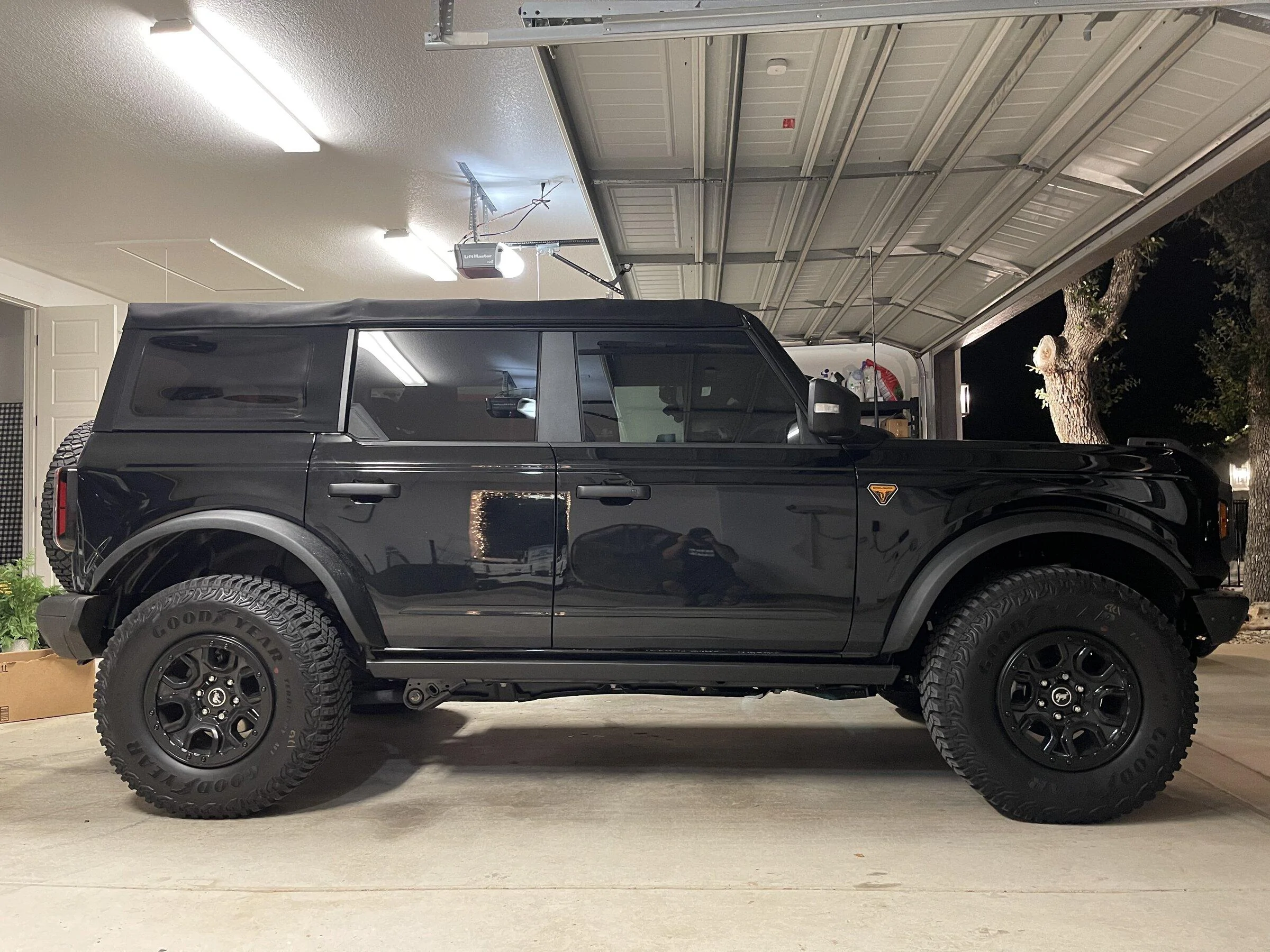

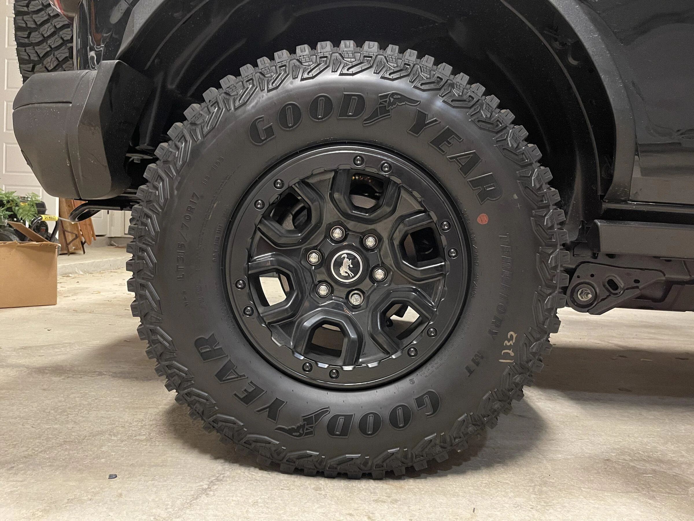

Decided to plastic dip my Sasquatch bright wheel rings. Happy with the decision to go matte black. Before/after of spare, I’ll get pics of the rest tomorrow when daylight
def achieves the blacked out look with 2 cans from O’Reilys for$25! 🤑

Superb. Definitely gonna do the same with my Base steelies (and then gonna put some beefier tires on there, obviously). Super helpful to see these close-ups of the end product, though...thanks!

Was this fairly easy to do?! Looks AMAZING. I want it for my carb gray

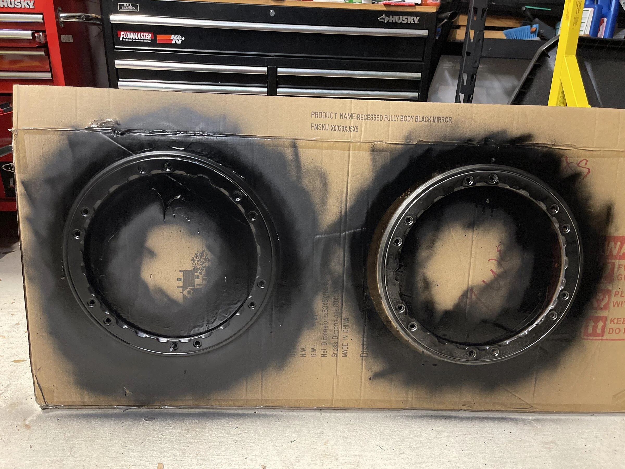

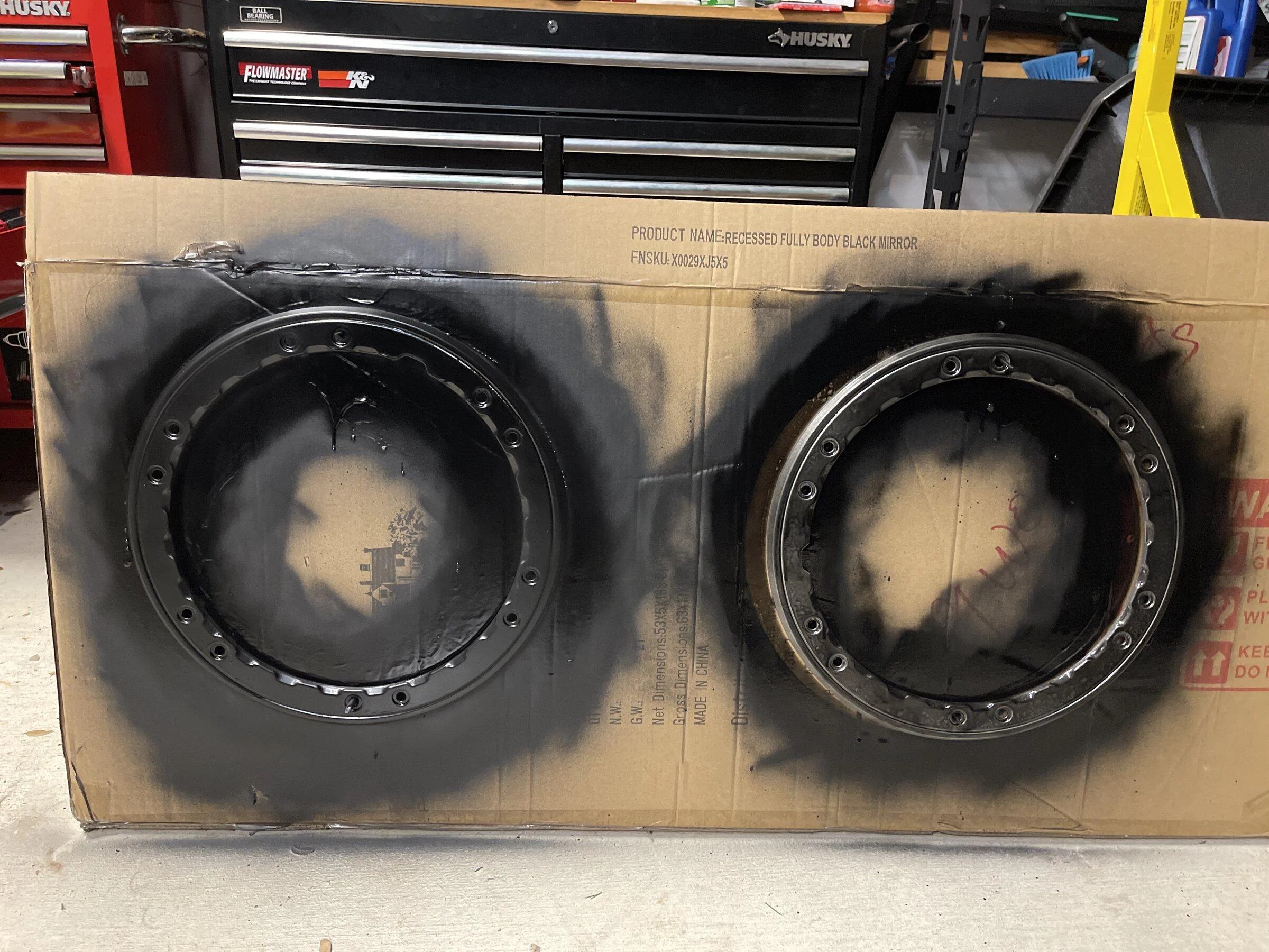

Super easy, 5 coats of spray and dry 5-7 mins between coats so you can do in 30-45 mins. Let dry final for 30-60 minutes before handling. It recommends spraying vertical so I did against a large box and stuck a large nail to hang two at a time. Pic below
