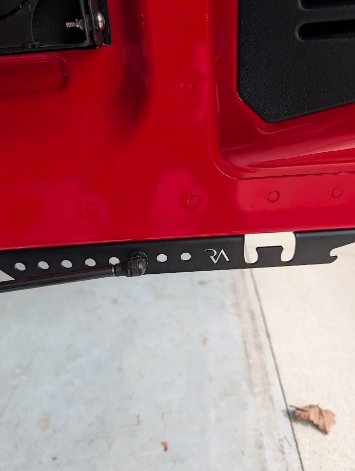

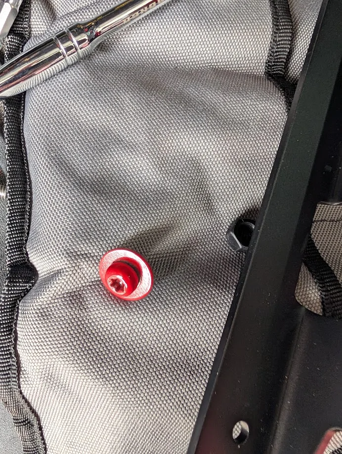

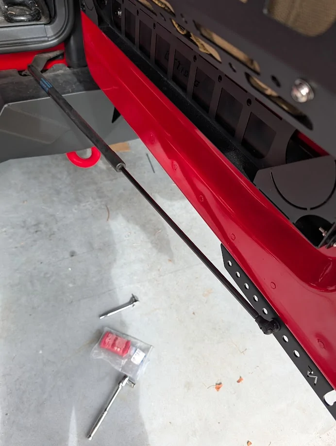

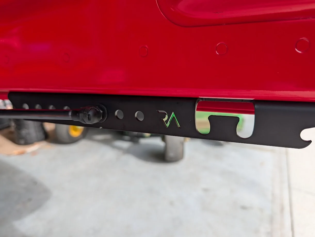

Now that leads me to the project yesterday. I wanted something besides a stick on rubber. I found this on Etsy made by a US entrepreneur, look for RackAdapters. It is very easy to install but didn't come with instructions. I used Gemini AI (new trick for an old dog) to help me sort out the install. Nothing really too it. Open up the retaining clip (which is on the BOTTOM of the ball as originally Ford installed). The AI told me to be careful as it would go flying thru my barn if I over did it. You just need to pry it up with a small screwdriver to get the fingers to move out of of the way. Pull the strut off the arm. Use a 13mm wrench or socket to remove the ball. Using a TP27 Torx bit socket, remove the red body screw (so lame) that you will find along the edge of the door. Attach the ball with the kit included nut in desired pre-drilled holes. The one with the notch is 90 degrees which was perfect for my needs. Now take the bolt that was included and after putting some blue loctite thread the bolt thru the bracket and into the hole formally occupied by the ball. On the other end, dab some blue loctite on the screw and then use it to screw the bracket to the tailgate. Place the strut on the ball after turning the head 90 degrees. The clip should just snap back into place but you might have to push it into place. Then carefully/slowly open the gate and confirm it hard stops before hitting the light. And it does! Using this mechanical set up with the rubber stops makes for a smooth stop.
