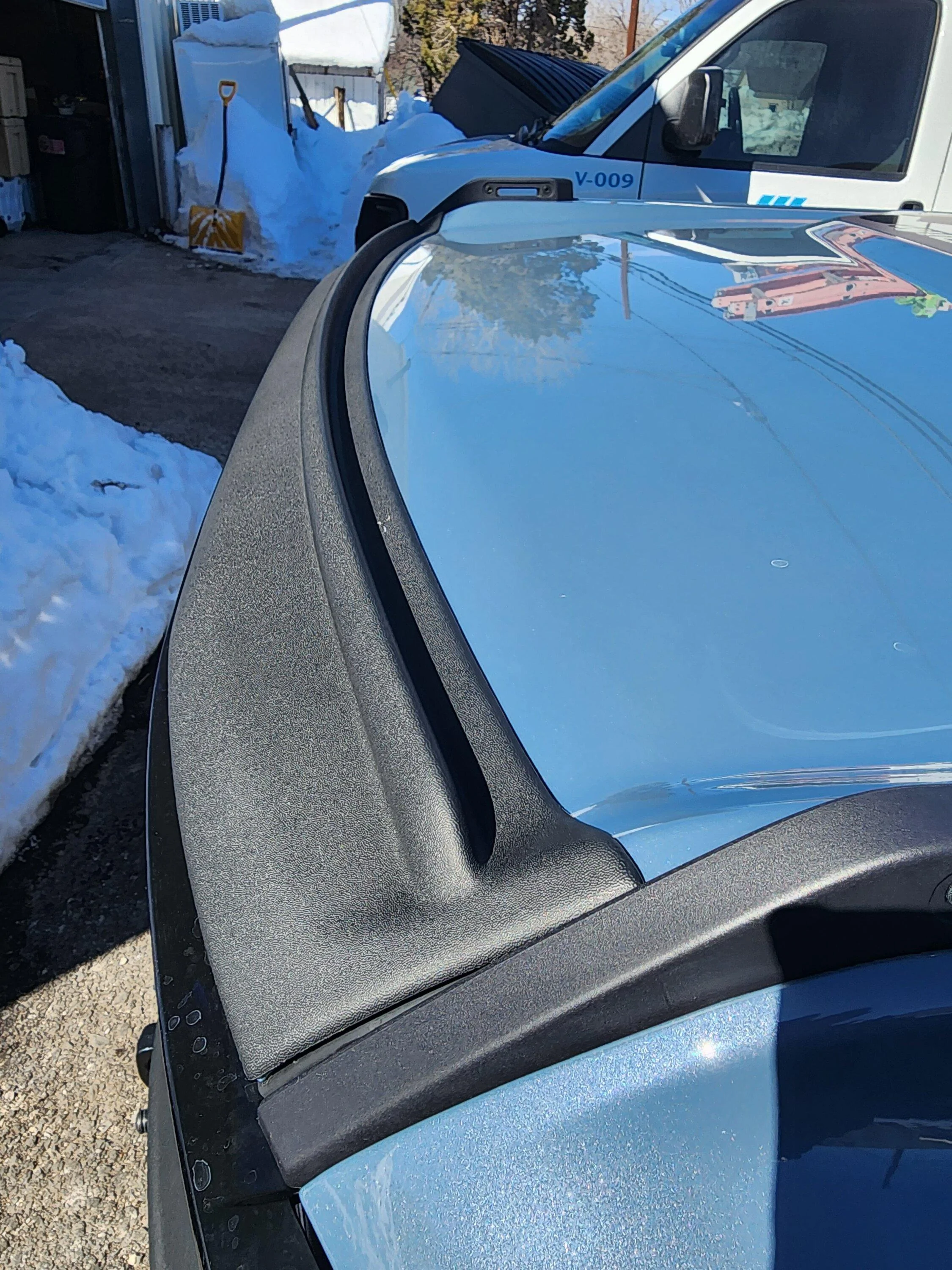

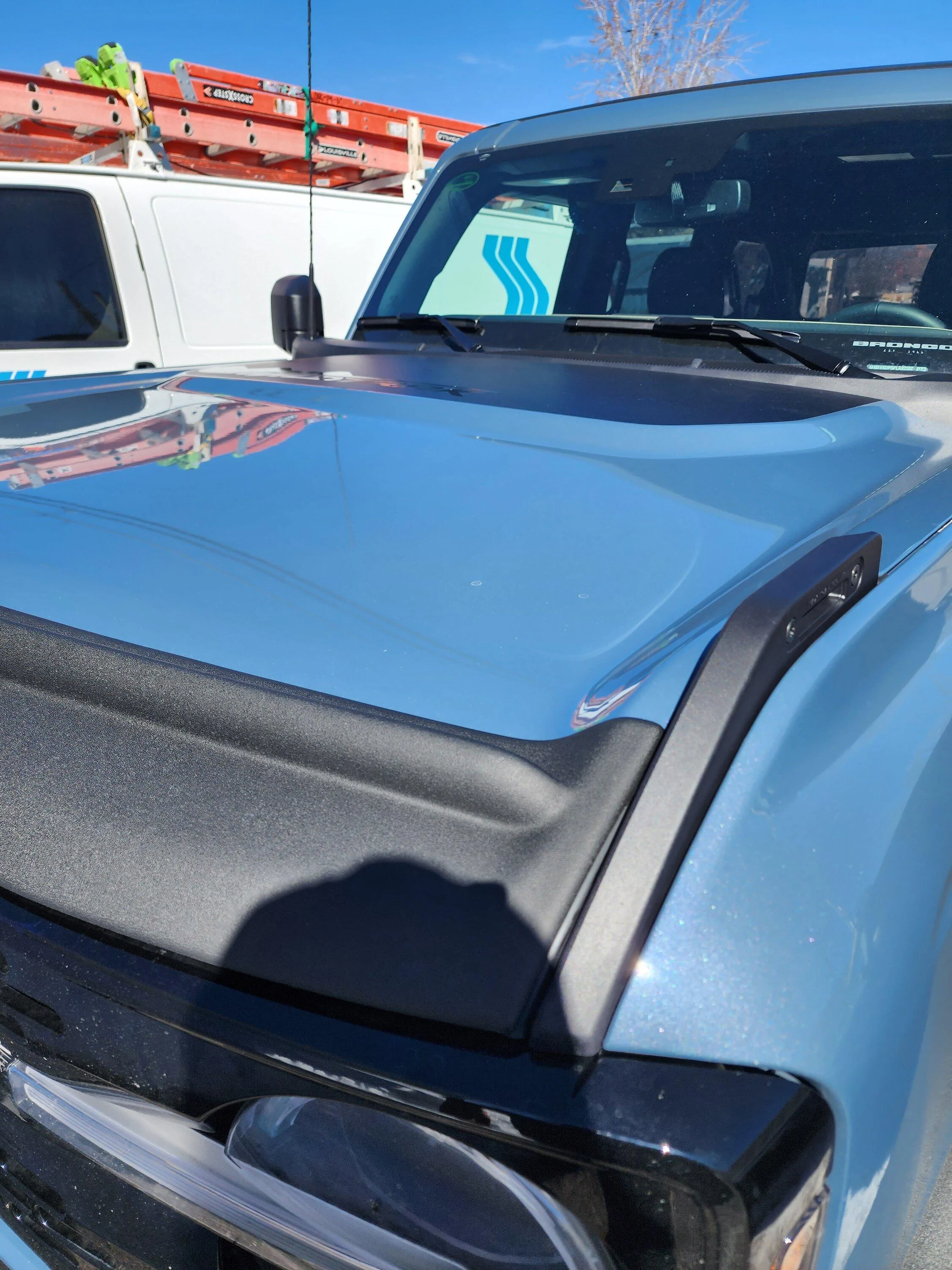

I recently installed the Ford hood deflector, to protect the wind$hield, on my 23 Wildtrak, soft top. I noticed the cab seemed allot quieter, and it wasn't all that bad before. Do those of you with the hood deflector have any noise complaints ?
I want to add a large light bar up top but was fearful of creating a ton of wind noise.
So the real question is who has both the hood deflector and a large light bar up top ? Any complaints.

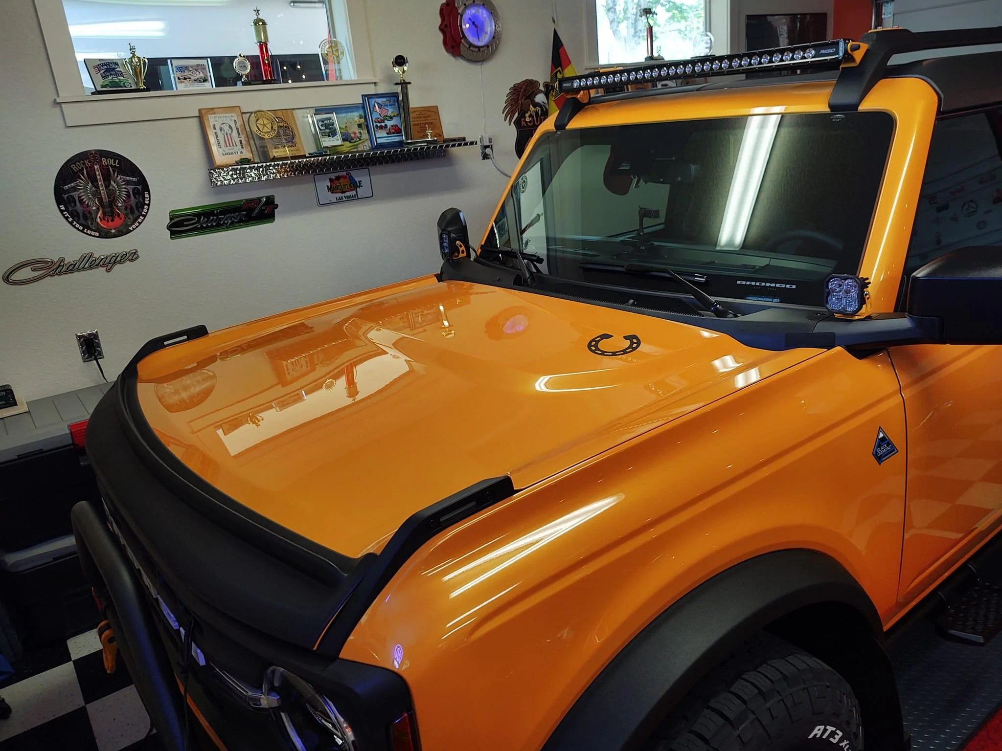

I have the same hood deflector and yes, it does a good job of tossing wind and debris up and over. I also have the Rigid OEM light bar. I have no noise caused by the light bar. I believe the first one's that came out did but with the fins on the back of the newer version....nothing (at least up to 70 mph).

The deflector IMO causes no wind noise. Some here have posted photos before and after...the difference in bug splatter and believe it has saved them rock chips too. I see no additional wind noise whatsoever. Also, if your hood flutters some, screw out the rubber bump stops for your hood.

Question about this light bar on the OEM roof rack as I'm considering doing something similar...
How do you go topless? 🤔

The light bar does not interfere with removing the two front roof panels. To go completely topless (the rear section of the top off also)...requires removal of the OEM roof rack.

The light bar and it's brackets are mounted to the roof rack. So if you remove the roof rack the light bar would come off with it. If this is your plan, then wire in a quick disconnect where the wires come out of the light bar before they go into the vehicle for wiring. In my case I have the overhead switch panel and their are detailed instructions in how to wire up this light bar. Note: the new instructions = you no longer need to drill a hole above the "A" pillar.
You can also remove the light bar with just 2 nuts and leave the brackets attached to the OEM roof rack.
The light bar attaches to the roof rack. In the photo you can see the brackets. I had them painted cyber orange.
If you decide to order the light bar through Ford, it's by Rigid, and you have the OEM roof rack, make sure your Dealer orders the right one so you get the correct brackets....brackets for roof rack mount. #M-15200K-BRRL The BRRL signifies roof rack mount (there is another # for brackets that mount when there is no roof rack.
Ford Bronco Wind Noise and the Light Bar RigidLTbarDone
Note you can see the bracket from the front and on the driver's side, you can see it from the inside of the roof rack...the bracket kind of wraps around the roof rack. (I do not have a quick disconnect on the wire...I probably should have but I never intend to remove the roof rack or light bar).

Which hood deflector is this. I see ford lists two of them on the site.
