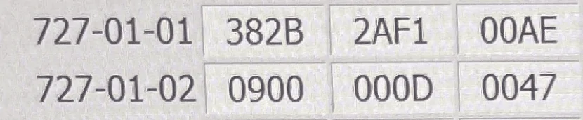

when you set the rear pods to speaker/tweeter did you also turn if the factory EQ in forscan? If not, trying turning that off is Forscan and see if that helps.
TexasHeritage
Jan 24, 2024
Austin
Fords and Lincolns
from @RagnarKon:
EQ Settings - ACM 727-01-02
  • xxYY-xxxx-xxxx
    • 00 = EQ Off
    • 01 = EQ On (High-pass filter on the rear pods)

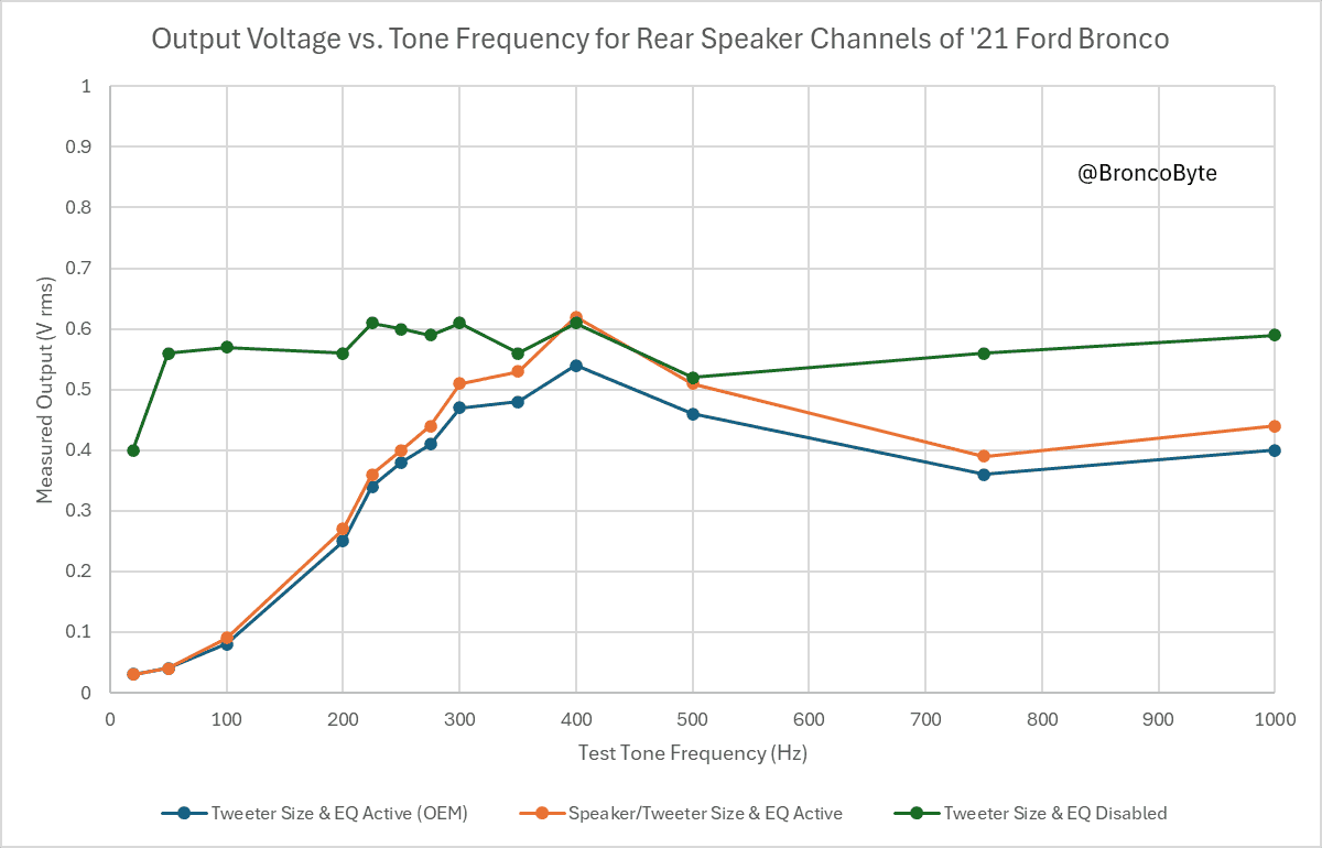

Hey, @ILoveToDrive
I see that you asked what a high-pass filter does. This relates to what both @TexasHeritage and @Dan-O mentioned about needing to make changes to the EQ (equalizer) using Forscan. Essentially, the stock rear speakers in the Bronco are very small, and not designed to play bass tones. In general, a bass tone would be frequencies below 250 Hz. This is why the stock audio system has the equalizer configured with a high-pass filter. I actually tested this the other day, and I found that the stock high-pass filter was set to somewhere between 300-400 Hz. The high-pass filter will attenuate the output of frequencies that fall below the frequency it is set to. This means that if you play a test tone at 100Hz when there is a high-pass filter applied at 300hz, the output would be weaker relative to the rest of the frequencies above 300Hz. If you are using the rear-channel signal to feed your subwoofer, but you have not disabled the EQ in the Bronco's audio system, then essentially your rear channels and the subwoofer are getting no bass frequencies. This is important because since you installed rear pods with bigger speakers, they are likely designed to play frequencies lower than the 300Hz that the stock speakers are limited to. Look up the frequency response range of your new speakers to figure out what frequencies your speakers ought to play.
Here are the results of the test I did the other day. As you can see, the blue and orange lines (which both have the EQ active) start falling rapidly when the test tone frequency is below 300-400 Hz, gradually muting the bass. The green line shows the output when the EQ is disabled (and the speaker size is "tweeter"). This is what we might call a "flat" output - the output at all frequencies is essentially the same, with no reduction in voltage for specific frequencies.
Ford Bronco Speaker Filters, Blockers 1713535021208-gv
As for gain on your amp, the manufacturer probably has instructions for how that ought to be configured. I would recommend following the manufacturer's advice to get the best sound, but if you think it might be set incorrectly, I would personally go back and do it again to make sure it's right. The point of the gain setting on an amp like this is to ensure that the output signal is "maximized" which means you get the strongest possible clean signal, with as little distortion as possible. If you wished, you could test if your amplifier is outputting roughly the appropriate voltage to your speakers, though you should follow the manufacturer's advice on how to dial in gain first. This method is just a way to check that your amplifier's output is not significantly low or high, which could be an indication that your gain is incorrectly set. Here's how you can test the gain of your amp with your multimeter:
  1. Disconnect your speakers from the amp.
  2. Set the Bronco's audio volume to whatever volume you used when the amp's gain was initially dialed in. That's probably 75% of the max volume.
  3. Play a test tone at 1000Hz (for midrange) or 50Hz (for subwoofer)
    1. you can use a test tone generator app and just connect through Bluetooth to the head unit
  4. With the meter set to AC Voltage, connect the probes (red to +, black to -) to the speaker output on the amplifier and measure the voltage.
  5. Compare the measured voltage to the expected voltage for your speaker.
    1. You can calculate your expected voltage using this formula Voltage(V) = √(Power (watts) × Resistance (ohms))
    2. For example, if your speakers have a resistance of 4 ohms, and rated to 60 watts RMS, then the expected maximized voltage is voltage = √(60 × 4) = √(240) = ~15.5 V
If the measured voltage is significantly off from the expected voltage for your speakers, then that could be an indicator that the gain on the amp is set incorrectly.
that's all I got, so best of luck trying to figure it out! Feel free to correct me if anyone thinks I've made a mistake. Thanks!

Hey, @ILoveToDrive
I see that you asked what a high-pass filter does. This related to what both @TexasHeritage and @Dan-O mentioned about needing to make changes to the EQ (equalizer) using Forscan. Essentially, the stock rear speakers in the Bronco are very small, and not designed to play bass tones. In general, a bass tone would be frequencies below 250 Hz. This is why the stock audio system has the equalizer configured with a high-pass filter. I actually tested this the other day, and I found that the stock high-pass filter was set to somewhere between 300-400 Hz. The high-pass filter will attenuate the output of frequencies that fall below the frequency it is set to. This means that if you play a test tone at 100Hz when there is a high-pass filter applied at 300hz, the output would be weaker relative to the rest of the frequencies above 300Hz. If you are using the rear-channel signal to feed your subwoofer, but you have not disabled the EQ in the Bronco's audio system, then essentially your rear channels and the subwoofer are getting no bass frequencies. This is important because since you installed rear pods with bigger speakers, they are likely designed to play frequencies lower than the 300Hz that the stock speakers are limited to. Look up the frequency response range of your new speakers to figure out what frequencies your speakers out to play.
When it comes to Gain on your amp, the manufacturer probably has some instructions when it comes to how that ought to be configured. I would recommend following the manufacturer's advice to get the best sound, but if you think it might be set incorrectly, I would personally go back and do it again to make sure it's set correctly. The point of the gain setting on an amp like this is to ensure that the output signal is "maximized" which means you get the most possible clean signal, with as little distortion as possible. If you wished, you could test if your amplifier is outputting roughly the appropriate voltage to your speakers, though you should follow the manufacturer's advice on how to dial in gain first. This method is just a way to check that your amplifier's output is not significantly low or high, which could be an indication that your gain is incorrectly set. Here's how you can test the gain of your amp with your multimeter:
    2. For example, if your speakers have a resistance of 4 Ohm, and rated to 60 watts RMS, then the expected maximized voltage is voltage = √(60 × 4) = √(240) = ~15.5 V
That’s a great very understandable description of what/how to set and adjust amp and speaker set up!!👍🏼👍🏼
