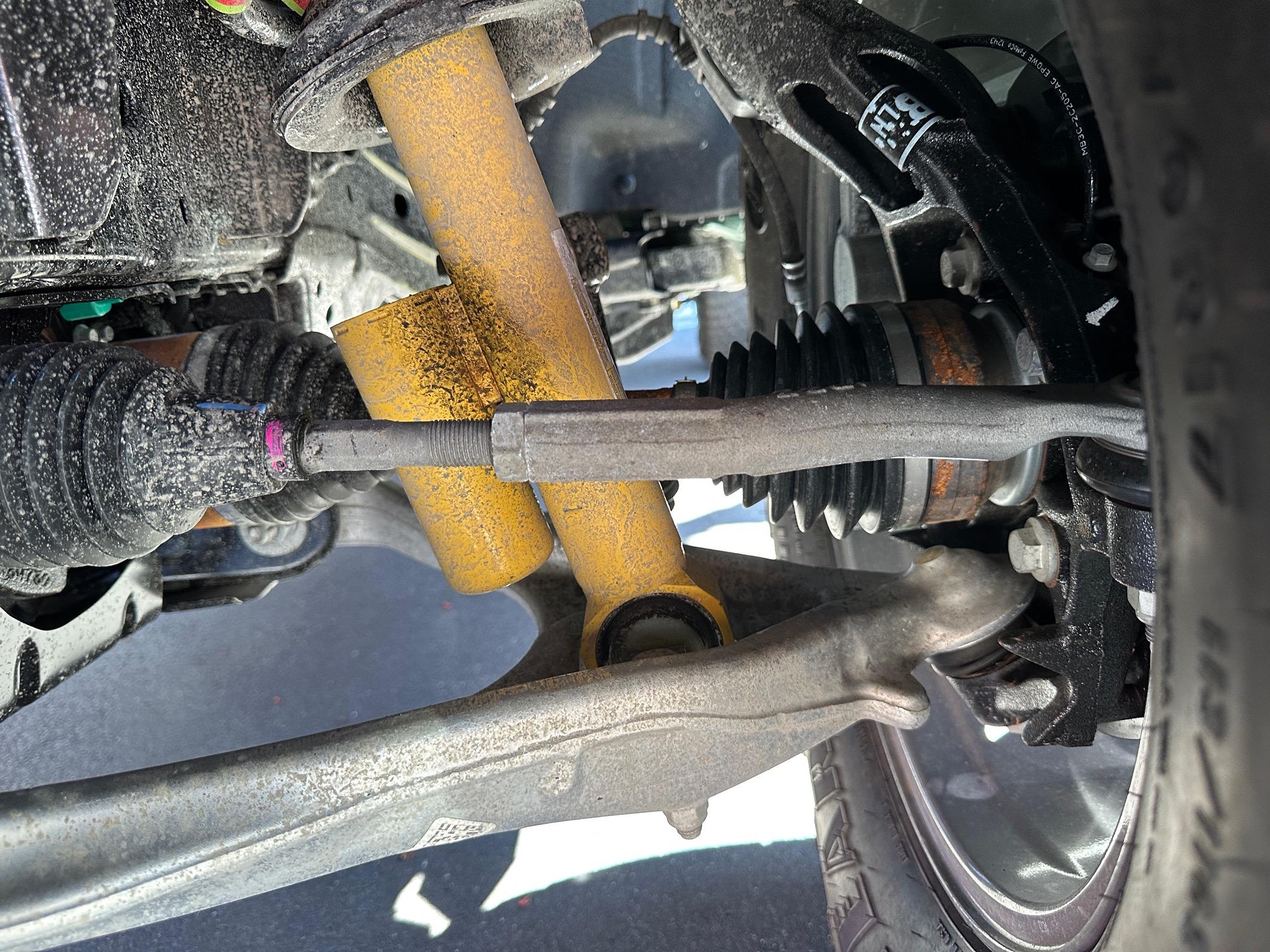

So not all 2024 Sasquatch get the upgrade. (This is my Everglades I picked up last night) ☹
They were never supposed to. Hoss 3.0 package is Wildtrak only.
24 badlands and Sasquatch only got the severe duty (hoss 3.0) steering rack

Everglades
The 24 Sasquatch gets the Hoss 3.0 steering, but still has 2.0 suspension.
Are those tie rods in the photo 2.0 or 3.0 size? The seem small in person.
The rods are my main concern.
