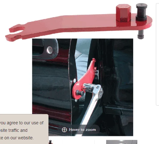

The plant has a tool to do this adjustment, kinda similar to this one but on a 4 foot bar. That said, adjusting these is not very difficult and sounds like dealer just doesn't want to mess with it.
