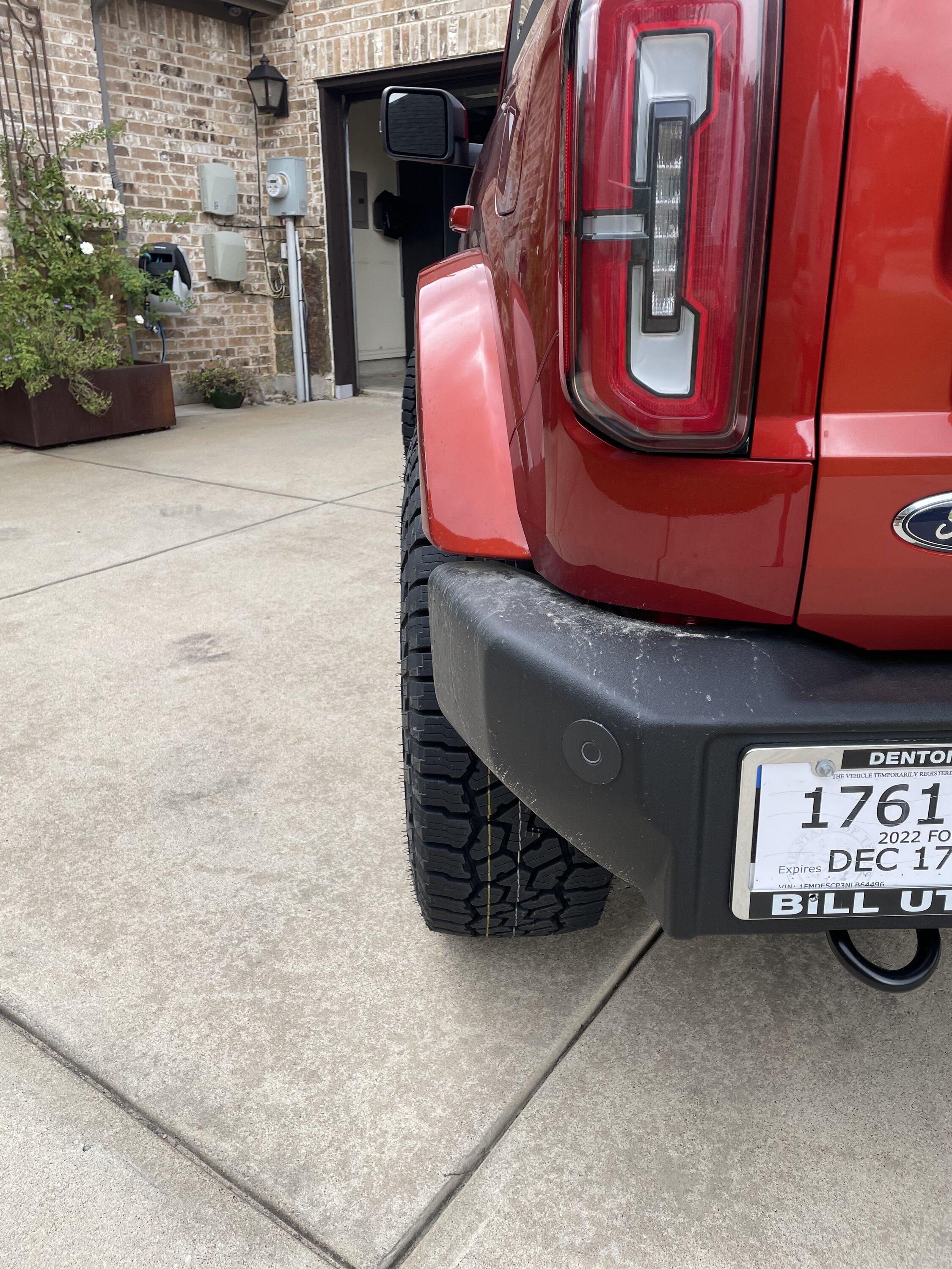

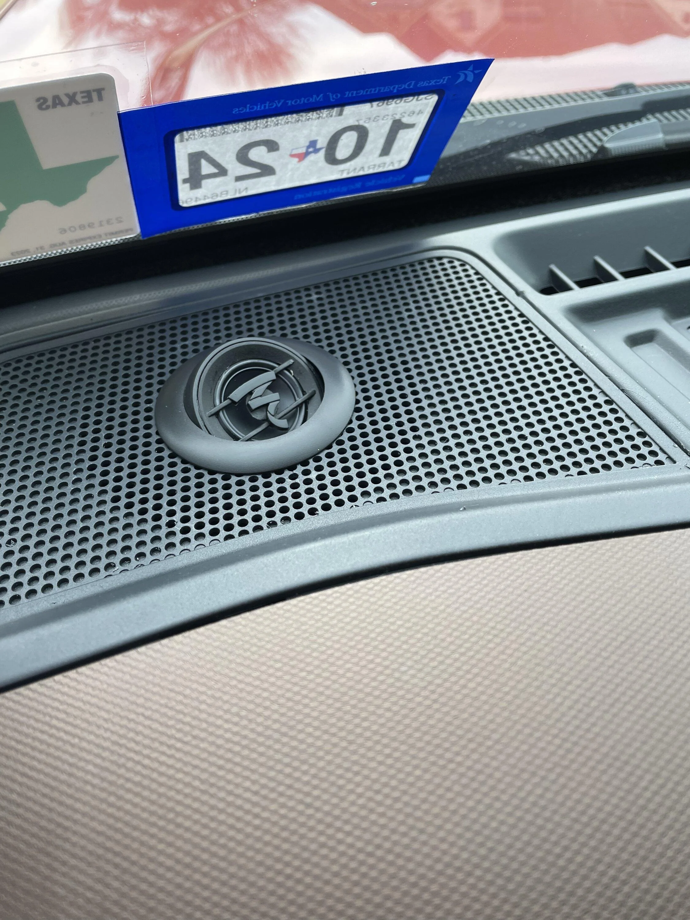

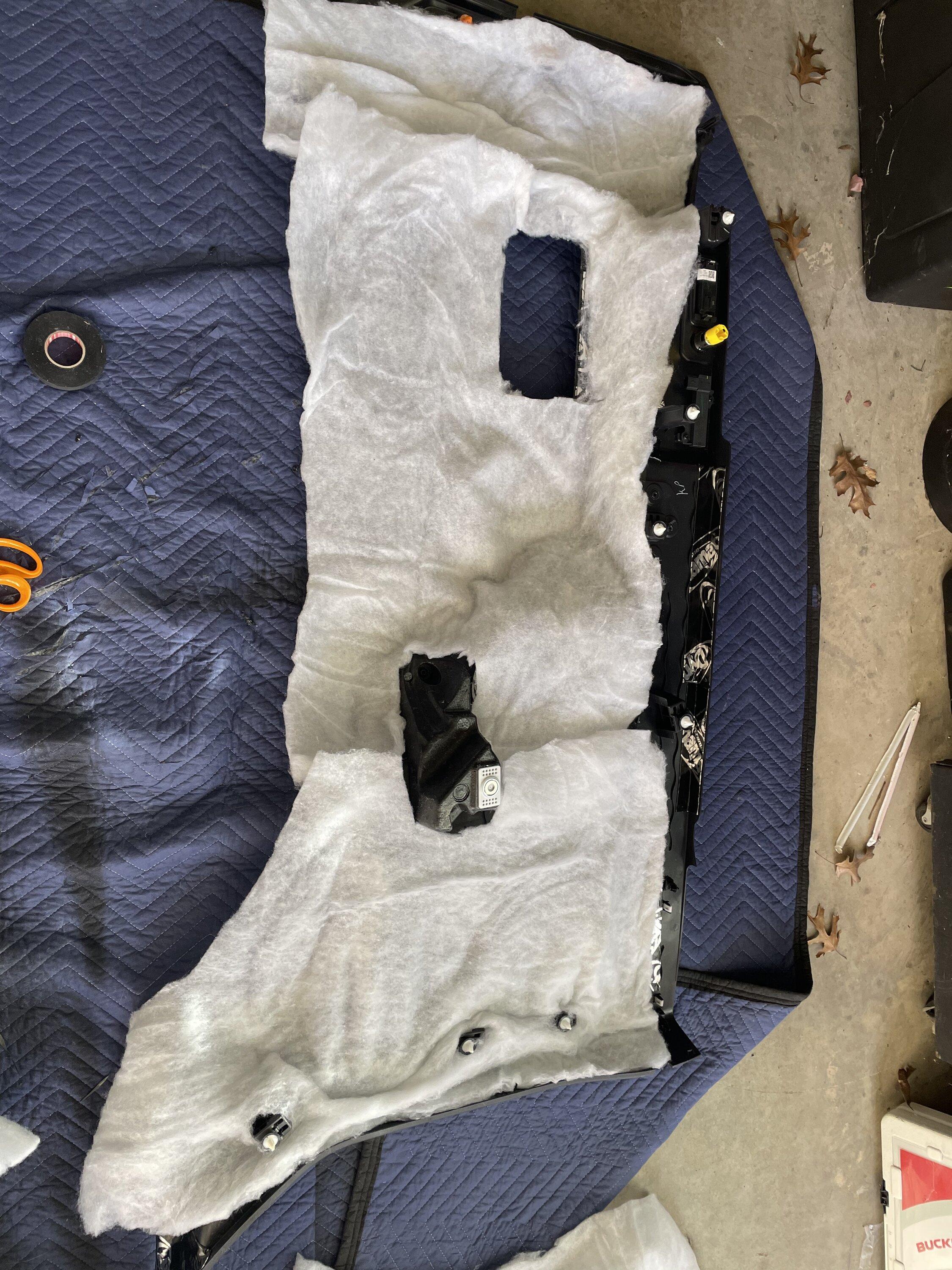

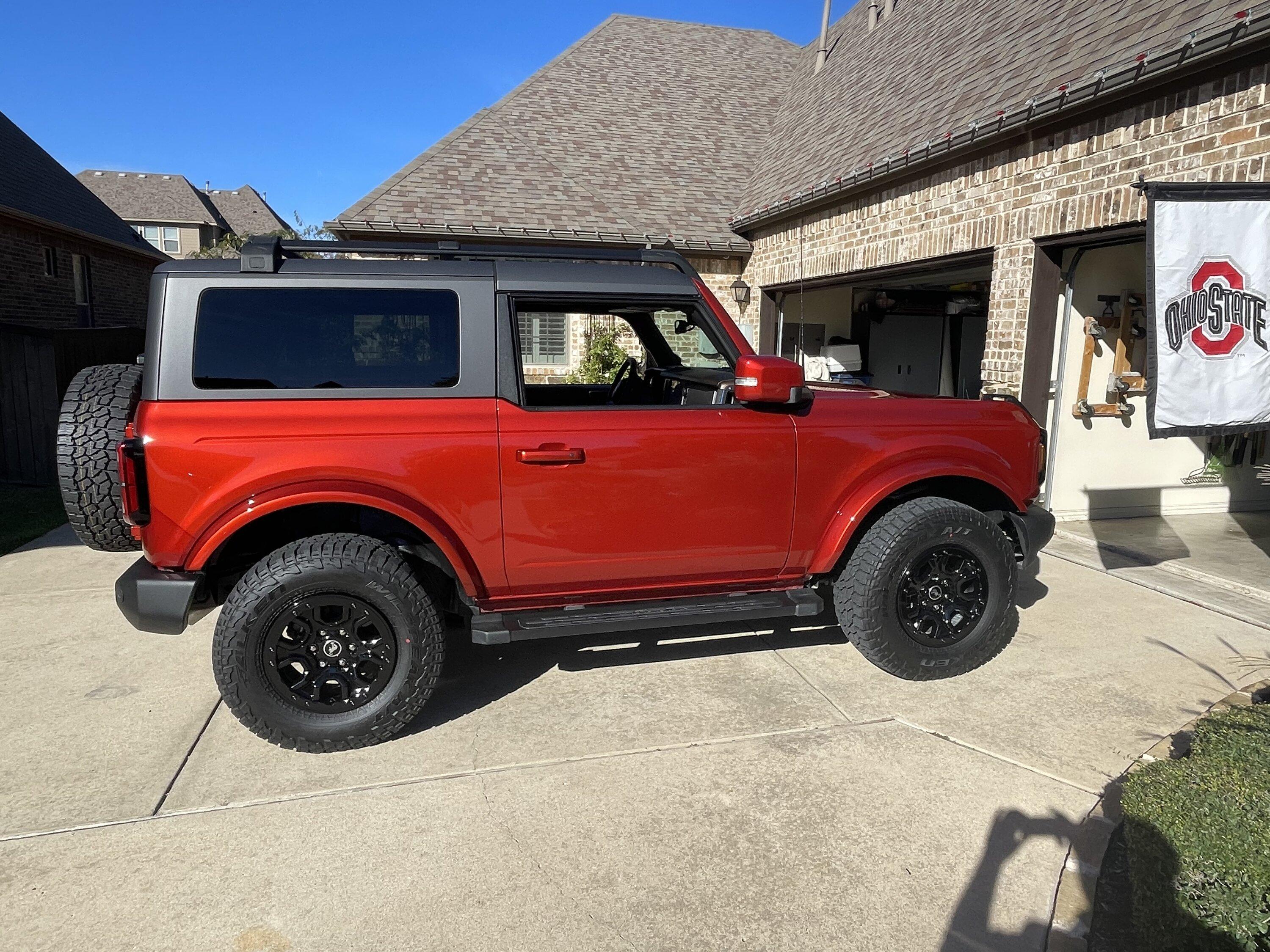

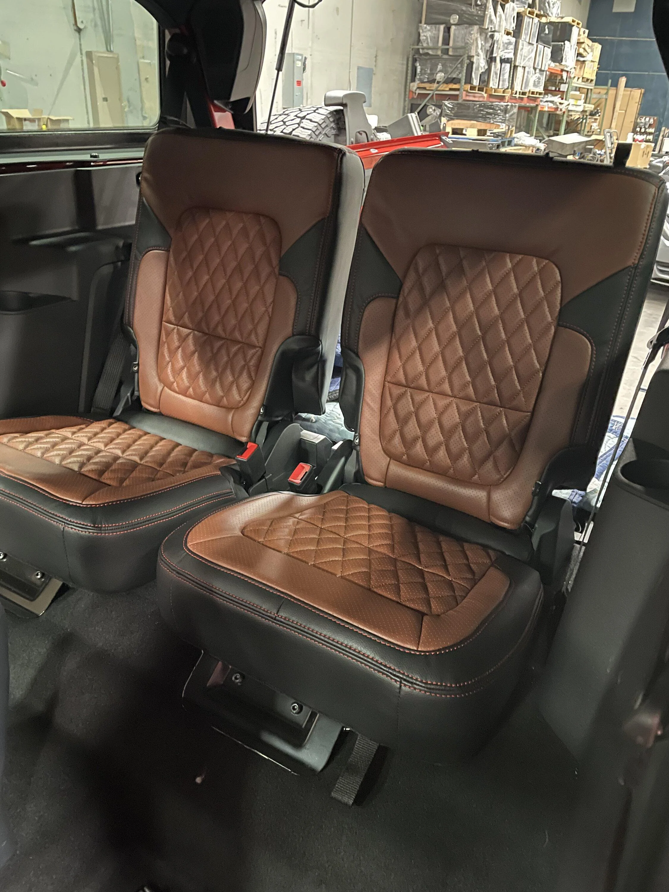

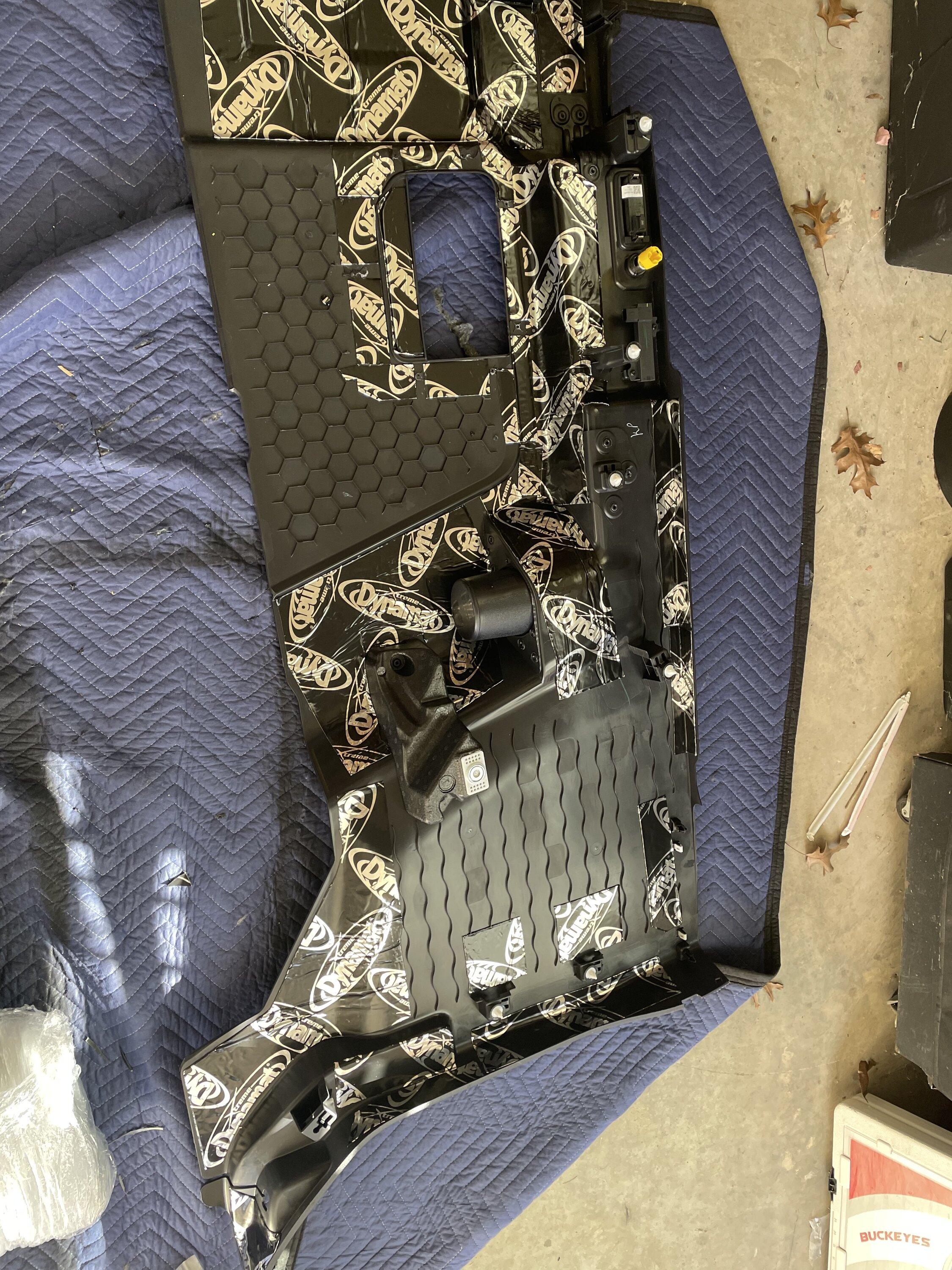

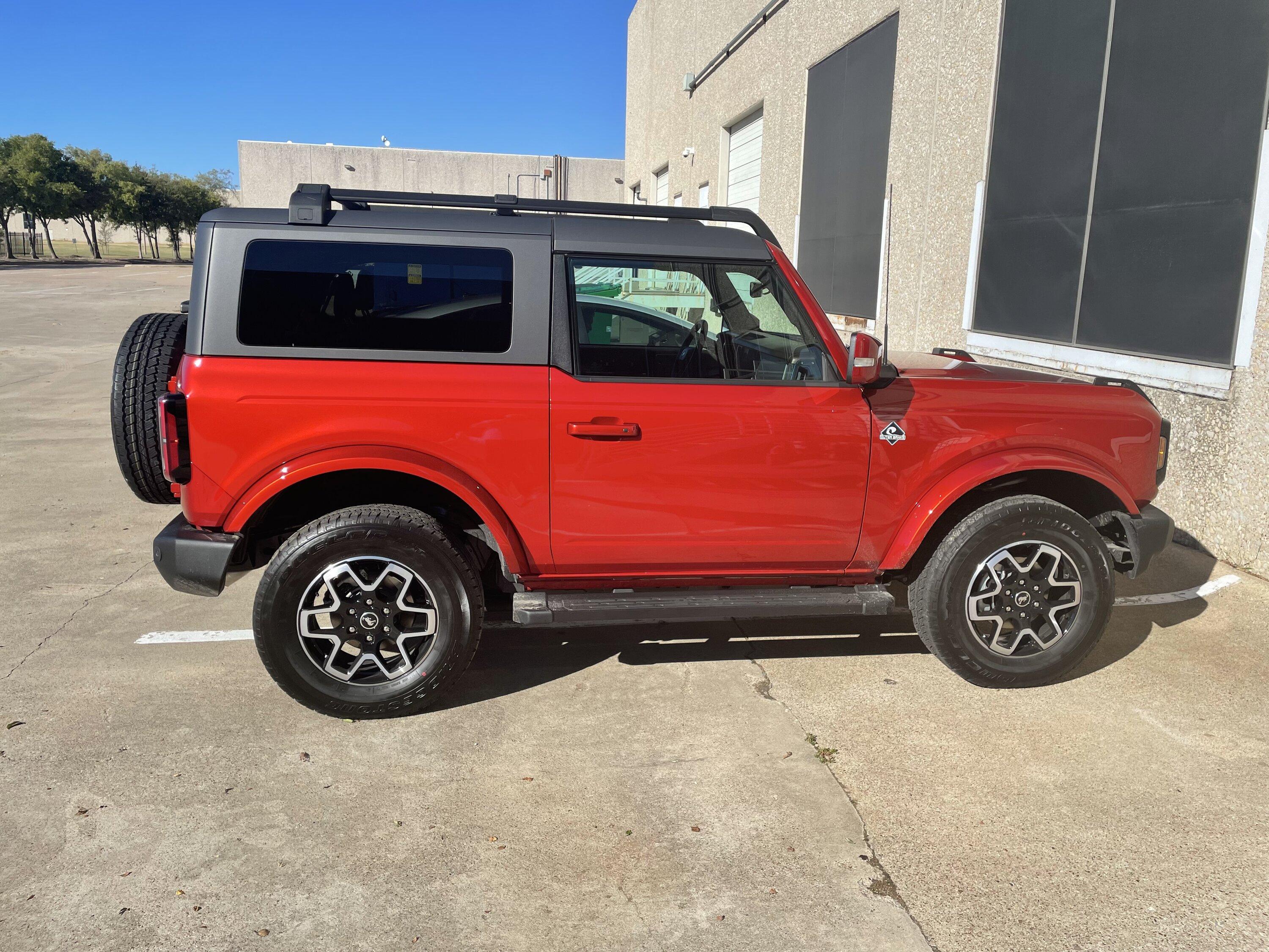

I figured I’d document the changes made to my build in hopes it helps others decide what to do with their Broncos. Feel free to respond/PM if you have questions on the installation of any of these items.
Build: 2.7L, Advanced 4x4, High, Tow, Hot Pepper Red, Roast Interior, Rear Locker
Exterior:
  • License plate mount - BuiltRight Industries
  • Steps/Rock Rails - Zroadz
  • Fender stickers removed
  • Wheels/Tires - Sasquatch wheels with powder coated trim rings and 285/70-17 Falken Wildpeak A/T’s (Oct 2023) replaced with 35x11.5x17 Falken Wildpeak R/T
  • Optimum Opti-Coat Pro ceramic coating
  • (Oct 2023) Eibach Stage 2 coilovers
  • (Aug 2023) Ridergraphix Heritage style upper body crease stripe style C charcoal metallic
Interior

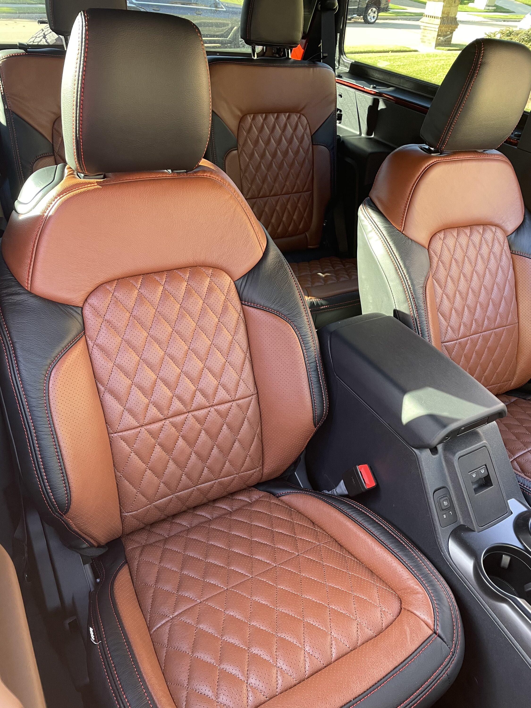

  • Upholstery - Katzkin Black/mahogany, diamond-stitched leather with salsa red stitching and heat/cool option
  • Tint - Xpel Prime XR Plus 70% on windshield, rear side windows, rear window and 30 on door windows

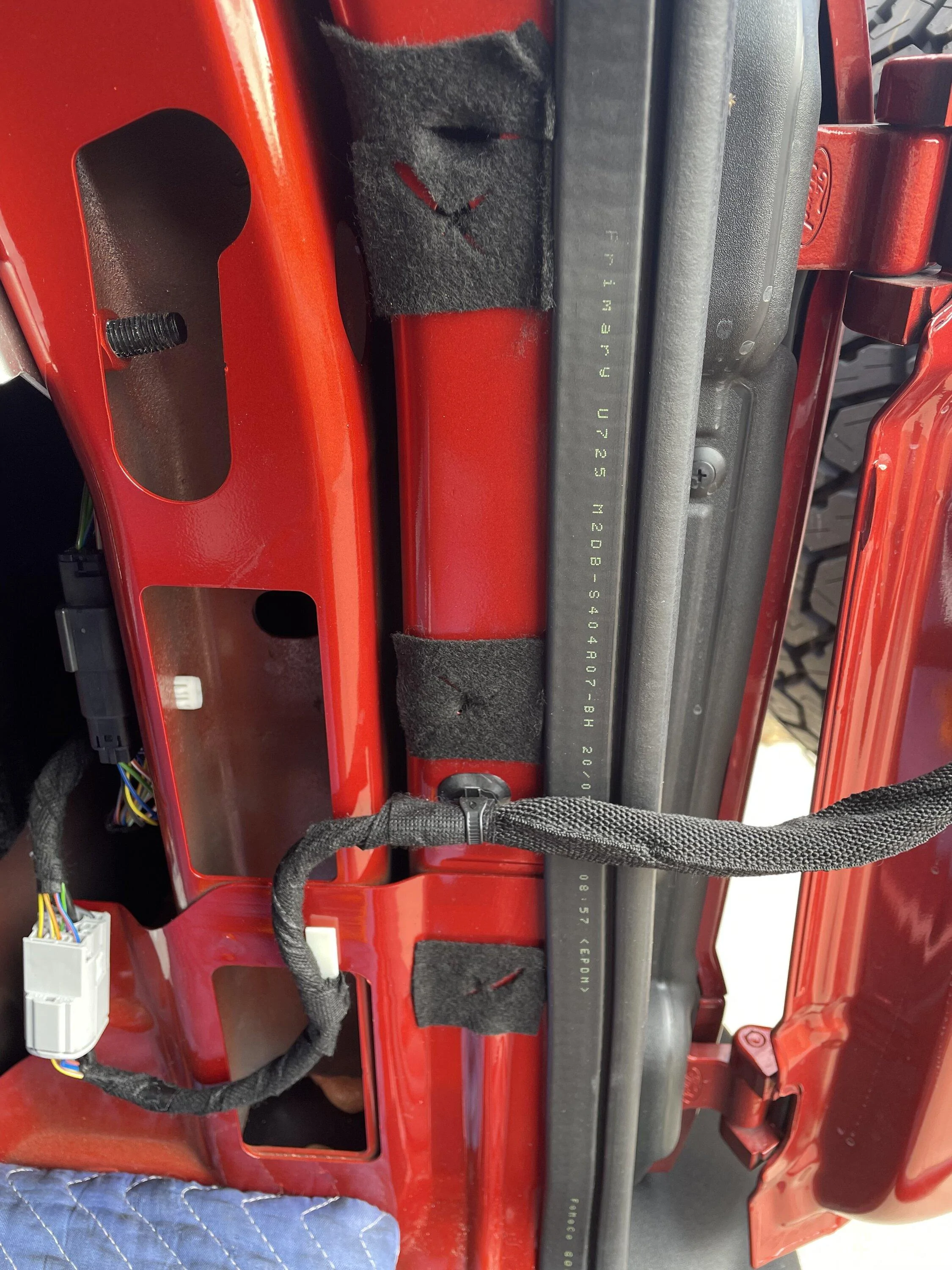

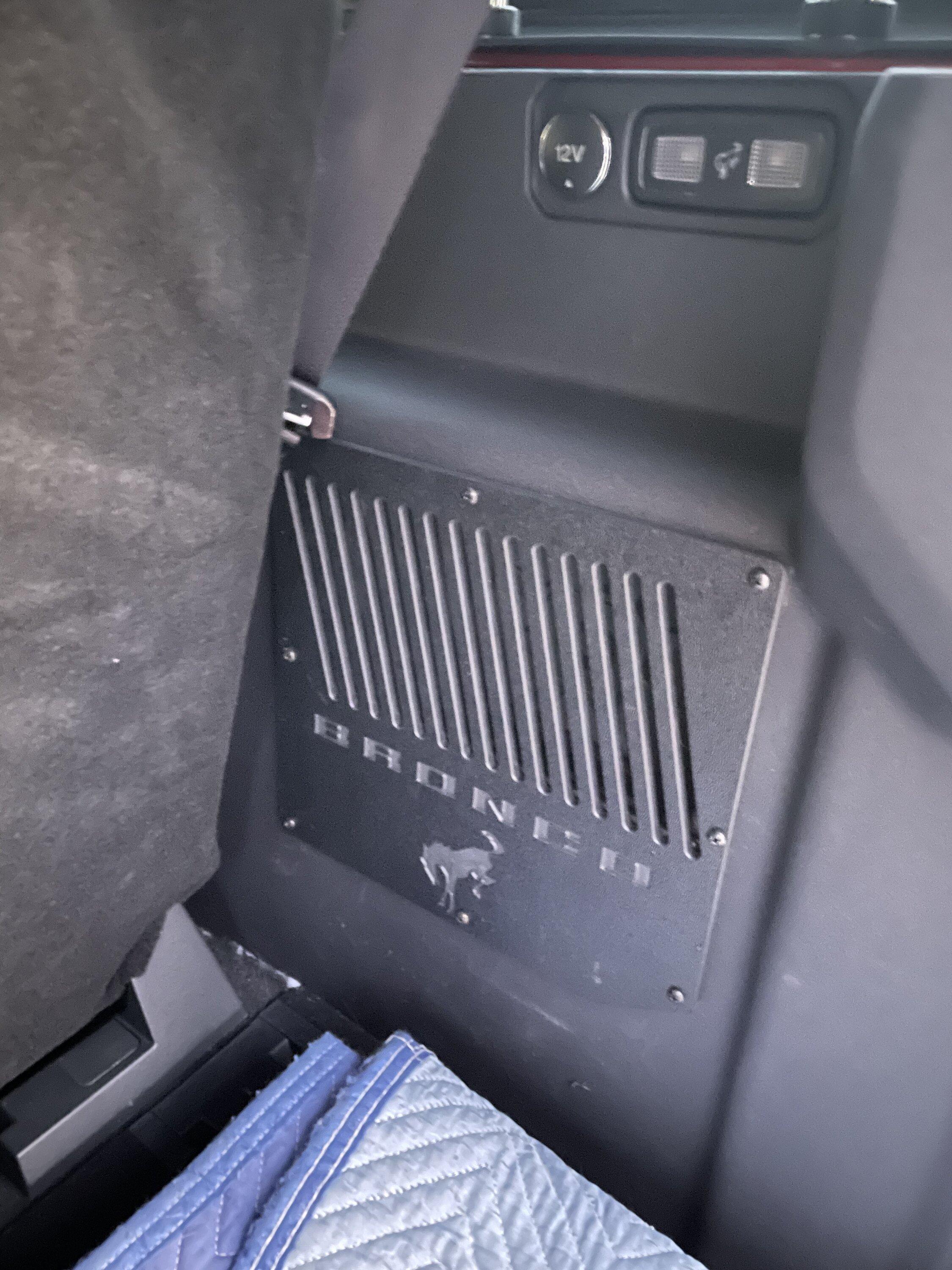

  • Audio - Kicker Key 200.4 powering Focal ASE165 components in front and Focal ACX100 4” in rear pods. Foam speaker baffles for kick panels and pods. Kicker 500.1 with CXARC remote control powering SRQ Customs box with Kicker 8” L7T 4ohm sub wired in parallel to 2 ohm. PlugNPlayKits.com kit 19 plus Kicker 200.4 power adapter plug (powered by battery with 20amp fuse).
  • Bartact paracord grab handles, grab handle storage pouch
  • Shift boot - Redline Goods black leather with red stitching
  • Mats - IAG molded trunk bottom mat, Luxmat front mats
  • Molle grate system rear tailgate - Ford VM2DZ54407B00A

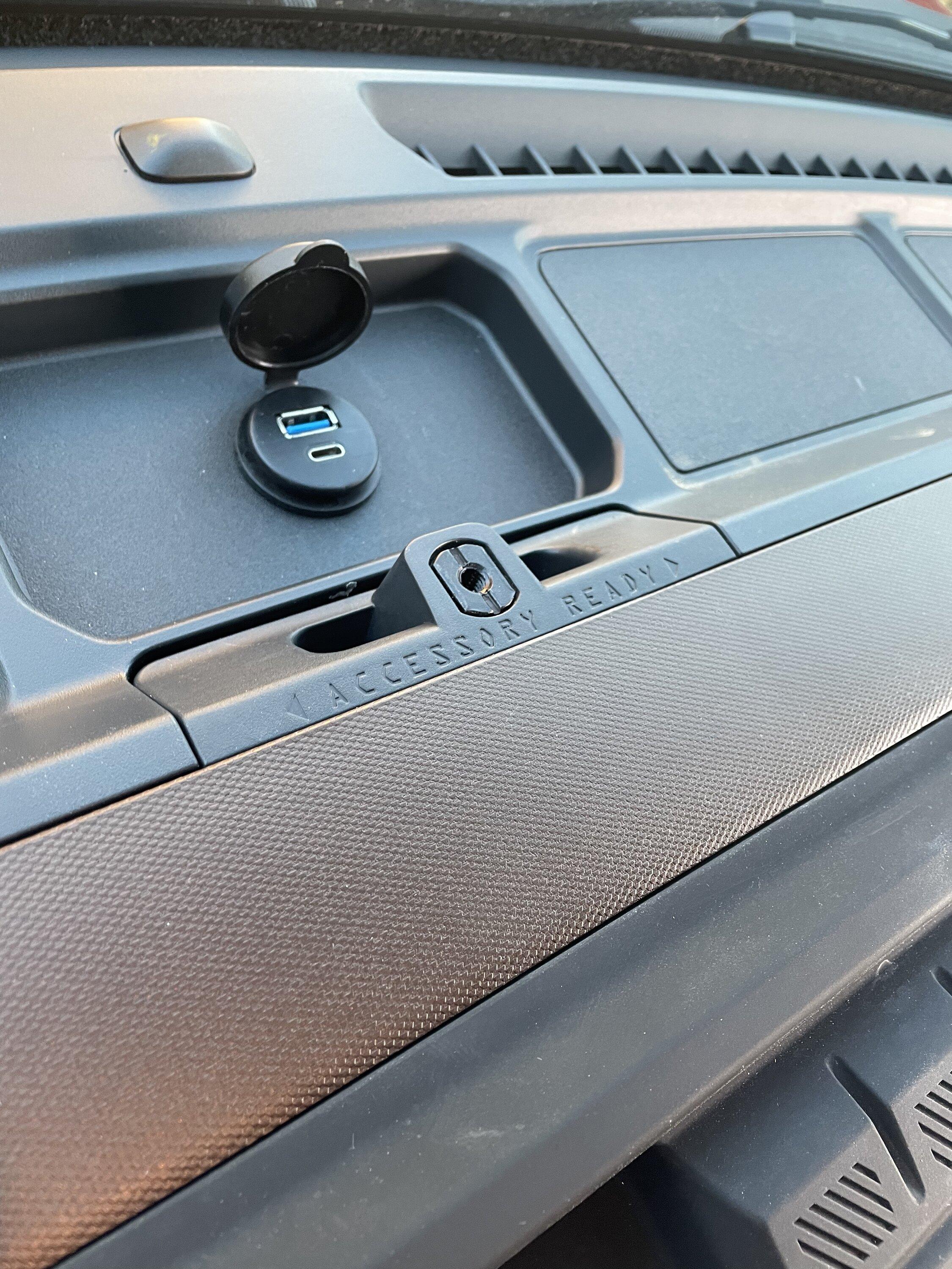

  • Charging - Coolgear Chargeit! Mini 75W Dual Port USB-A & USB-C PD Charger w/PPS & QC4.0 Support connected to battery with Crutchfield 12gauge amplifier wiring kit and 5A fuse with Obvis USB-C 3.0 & USB-A 3.0 male to female waterproof flush mount kit installed in top of dash
  • Device mount - Archetype Racing SLAP/BPM dash accessory mount, Archetype 1” black Mono B.A.L.L.S, RAM RAP-B201U-A composite double arm socket, Bulletpoint universal phone holder
  • Locker security enclosure - Diabolical Inc.
  • Console lock box - Ford VM2DZ-9906202-A
  • Top removal - Rockworkx red anodized thumb screws, TopLiftPros hardtop removal tool
  • Screenprotec matte 12” screen protector

Tastefully done! Does the SRQ sub require trimming the rear panel?

Since I didn’t have the B&O system, I had the cubby hole where the the SRQ grill sits. All I had to do was cut the cubby out from behind where the plastic “rivets” attach it to the back of the panel. No other trimming to the panel.

Great looking 2-Door!
Love the seats.

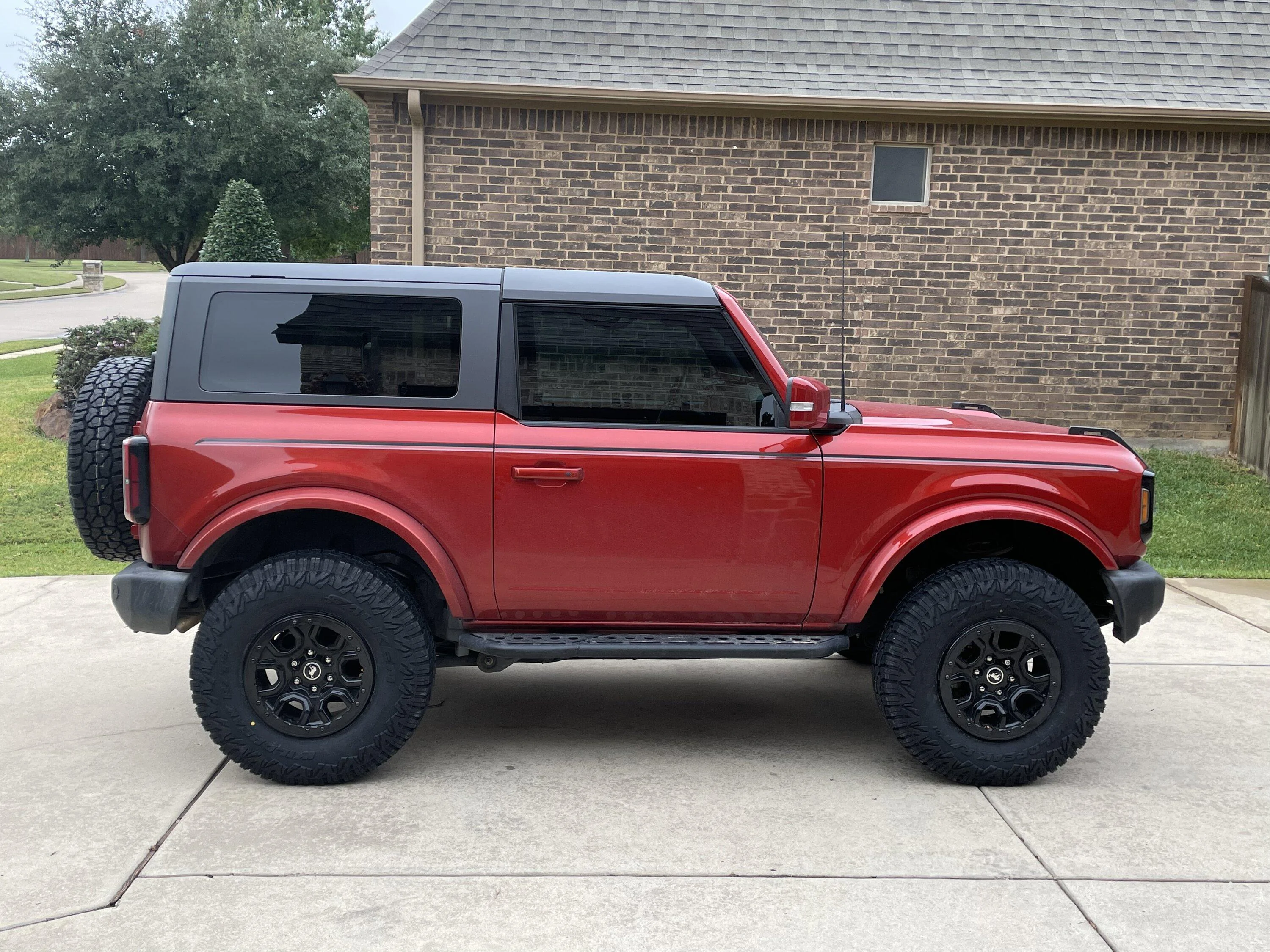

Added some Eibach Stage 2 coilovers and switched tires to 35x11.5x17 Falken Wildpeak R/T. Also added Ridergraphix Heritage style upper body crease stripe style C charcoal metallic
