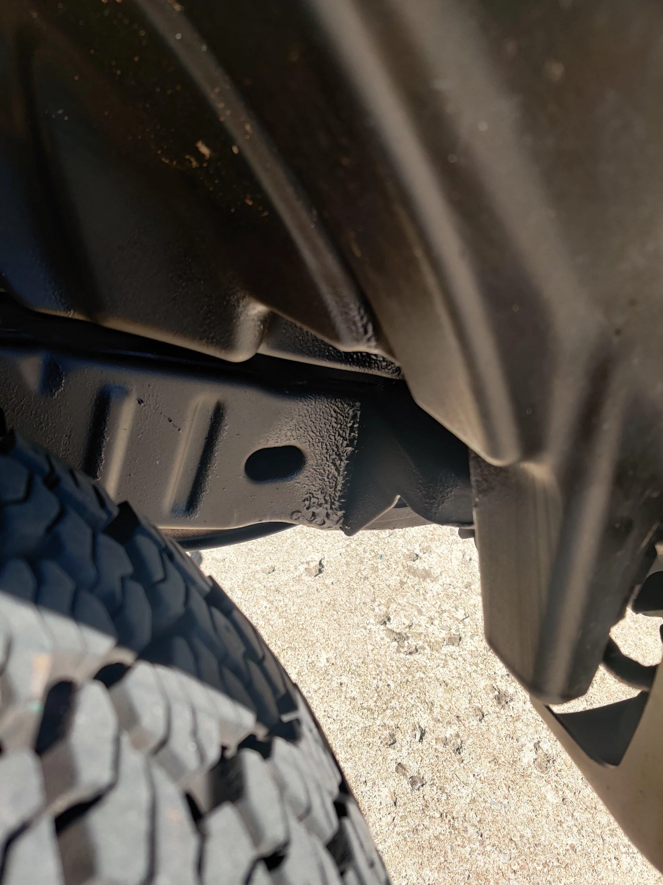

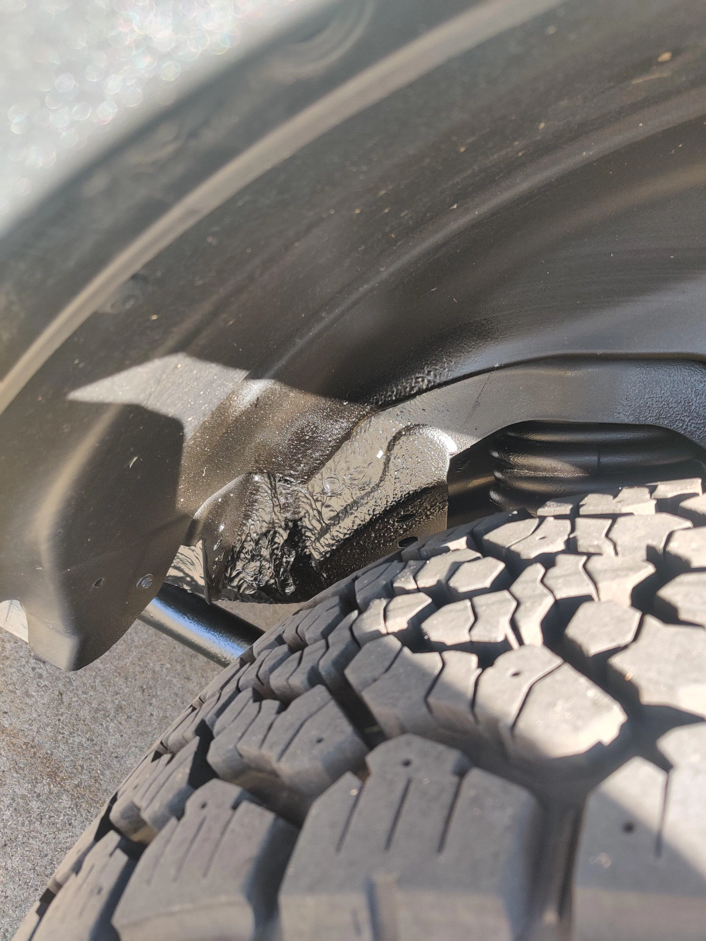

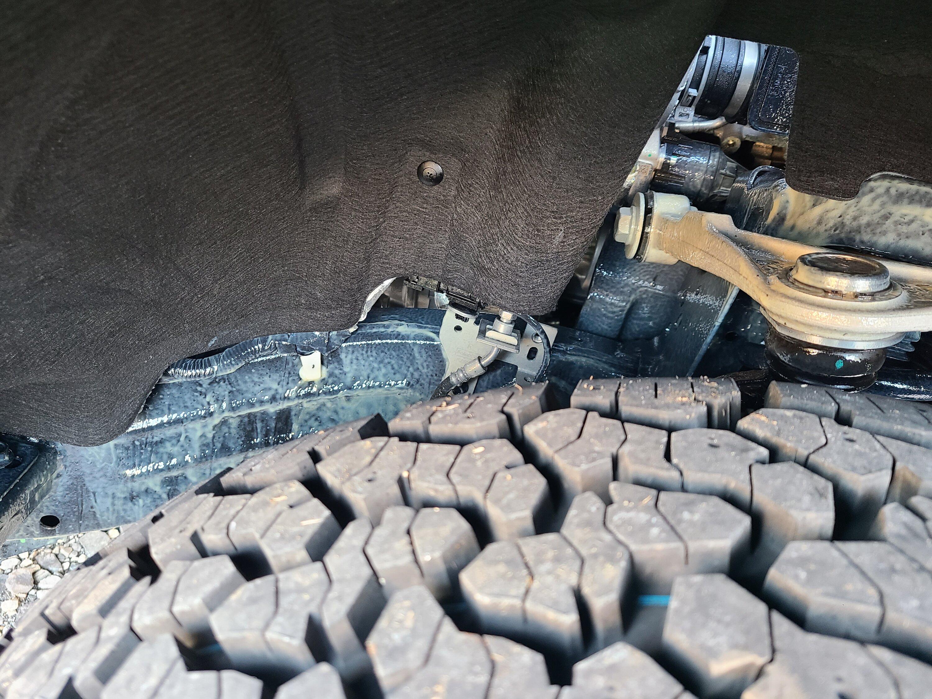

First time treating a car before winter but in the northeast it gets pretty nasty. I understand it's not necessary but seemed like it would be be worth the peace of mind. Anyways it's caked on and looks pretty rough. Wondering if I should call and have him clean it up. I've had bad look thus far taking my bronco anywhere. Did a few things myself but I guess I'm gonna have to do it all from now on. Over spray on the plastics in the wheel wells and stuff is what's most noticable.

I think it's fine. It's underneath. If it was on body paint then you can ask the guy to clean it. It will probably be off by spring anyway. Looks like an oil coat. It's not permanent.

Itā€™s just heavy in those spots. It wonā€™t hurt a thing. Not sure what product was used if itā€™s a type that doesnā€™t setup you could try to smooth it out but Iā€™ll warn you your only gonna make uglier.

It doesnā€™t look like shit, it looks like a standard wool wax or fluid film application. Itā€™s more important that they did inside all the places you canā€™t see then the ones you can. Your biggest concerns are inside the rockers, inside the door and inside any frame section especially anything boxed. Once those are done well, that coating will stay good for quite a while.

@robsafari Itā€™s not just you having bad luck with automotive service providers though I think your undercoating is probably what you ultimately will want with those heavy coverage areas located where metal is coming together with a joint/weld and being more susceptible to crud sneaking in. I think the only way you get good service and results from automotive service providers these days is if you have a personal relationship with them or they have a vested interest in your project. Everyone is about speed these days, not quality. I chose to pay a premium to have the delivering dealership install window tint and two tries later itā€™s still not great and they damaged the plastic dash during removal of the windshield tint. I got a replacement dash part out of them and decided that they were incapable of doing good work so Iā€™ve moved on.

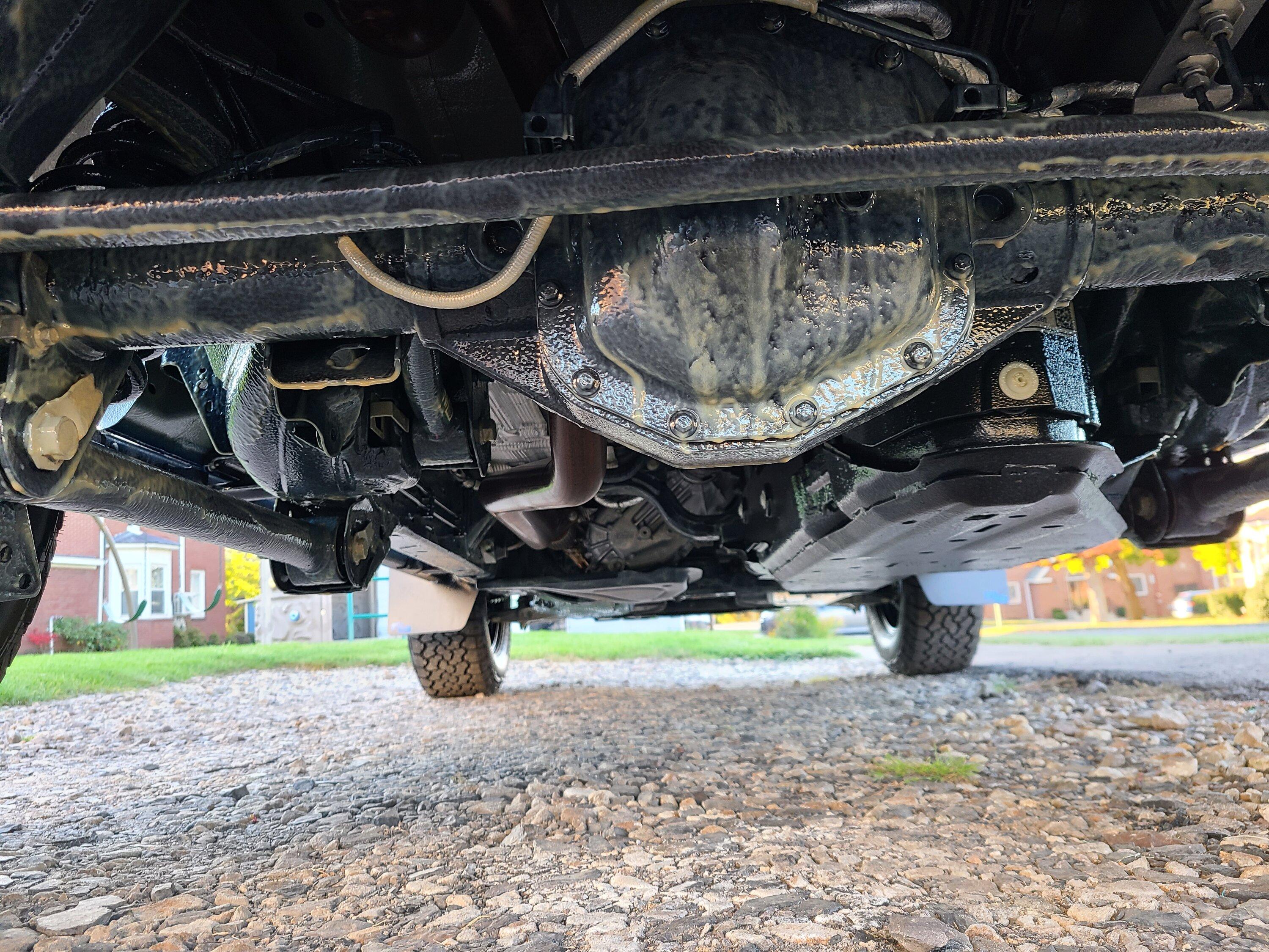

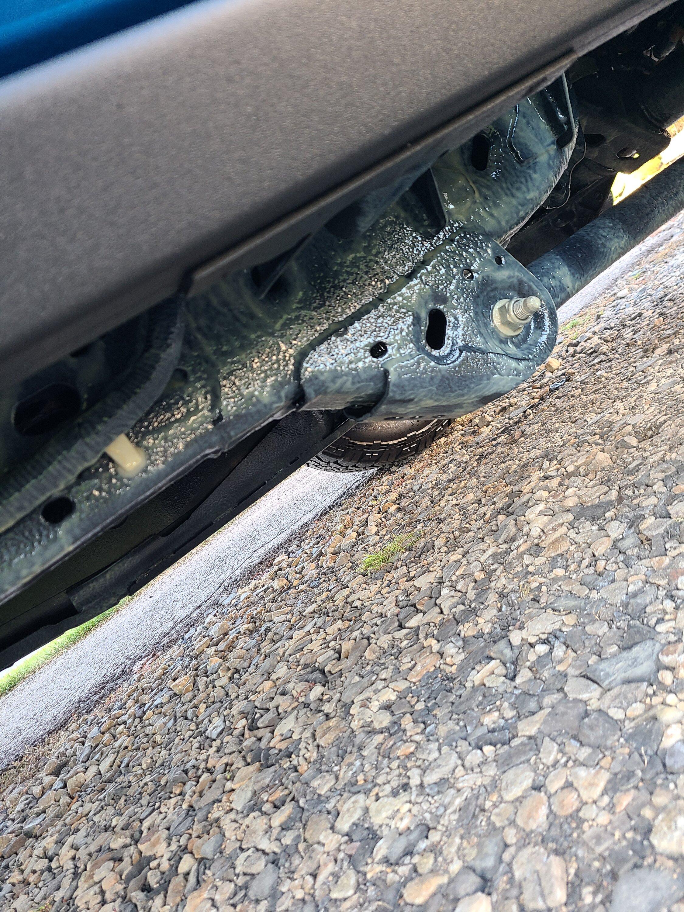

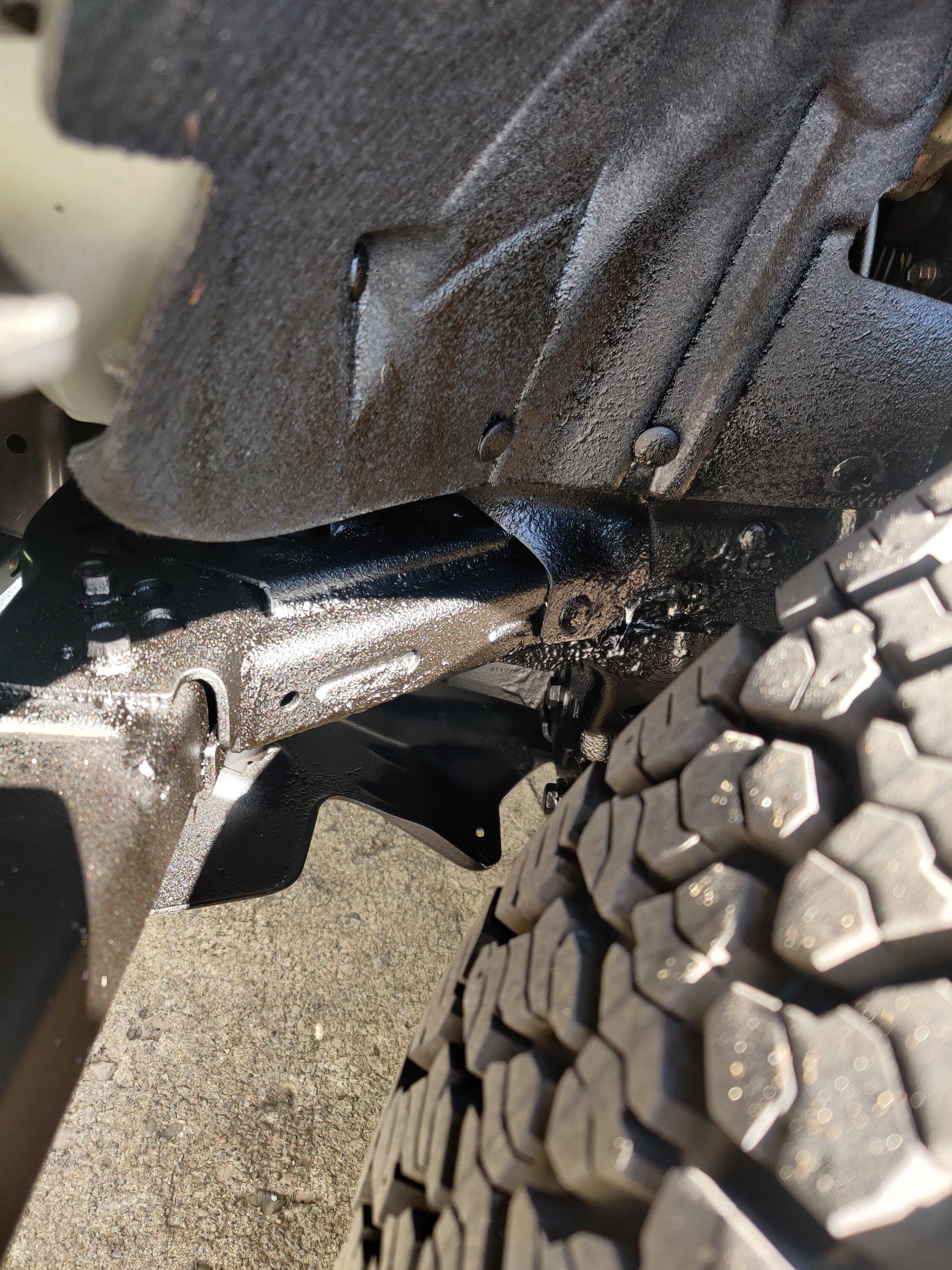

My wool wax installer did a far better job of not spraying it everywhere like OPs bronco, but Id be more concerned about the lack of coverage. The rear frame rail doesnt even look like it got sprayed behind the tire. Heres how mine looks. I opted for clear because i figured it would look better. Kinda looks like snot but i think it looks better than the black.

You should have gone with black. Or they should have sprayed lighter.

Nah the thicker the better. It will wear away over time and or become covered in dust. At the end of the day, it looks a lot better than rust either way.

Thinner would maybe look better. It truly looks awful, thankful not many people will notice.
