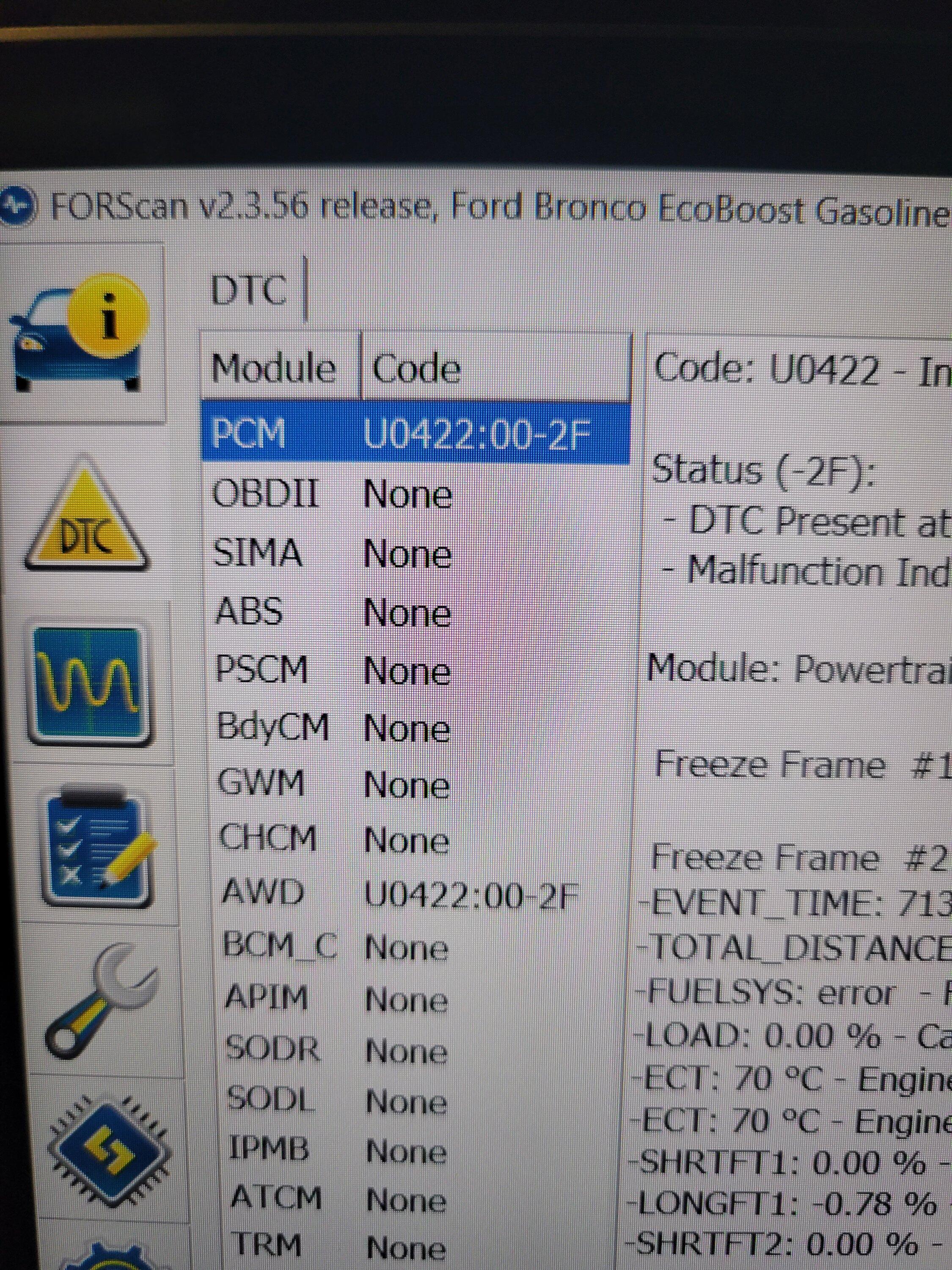

Just make sure after you change the tire size to force the TCM and PCM to relearn and do the reset of the DTC, then you should not have any error messages:
13. Now we have discrepancy between tire size values known by PCM and TCM and new value stored in BdyCM. So we have P160A DTC in TCM module and P0610 in PCM module:
14. In order to remove the discrepancy, we need to force PCM and TCM to ā€œlearnā€ the new value from the ECC. We can do it using Module Initialization/Relearn vehicle data functions for PCM and TCM module:
Note: some cars may have other modules that require this operation, for example AWD, SOBDMC.
15. After running the Relearn functions, we need to reset the DTCs:
What is the max tire size that can be entered?

I changed my tire size about 1.5 years ago when I put 37s on and didn't have any errors. I just changed my axle ratio to 4.88 (had Dana 60 installed a while ago) and changed my tire size back to 2800 and still getting errors
