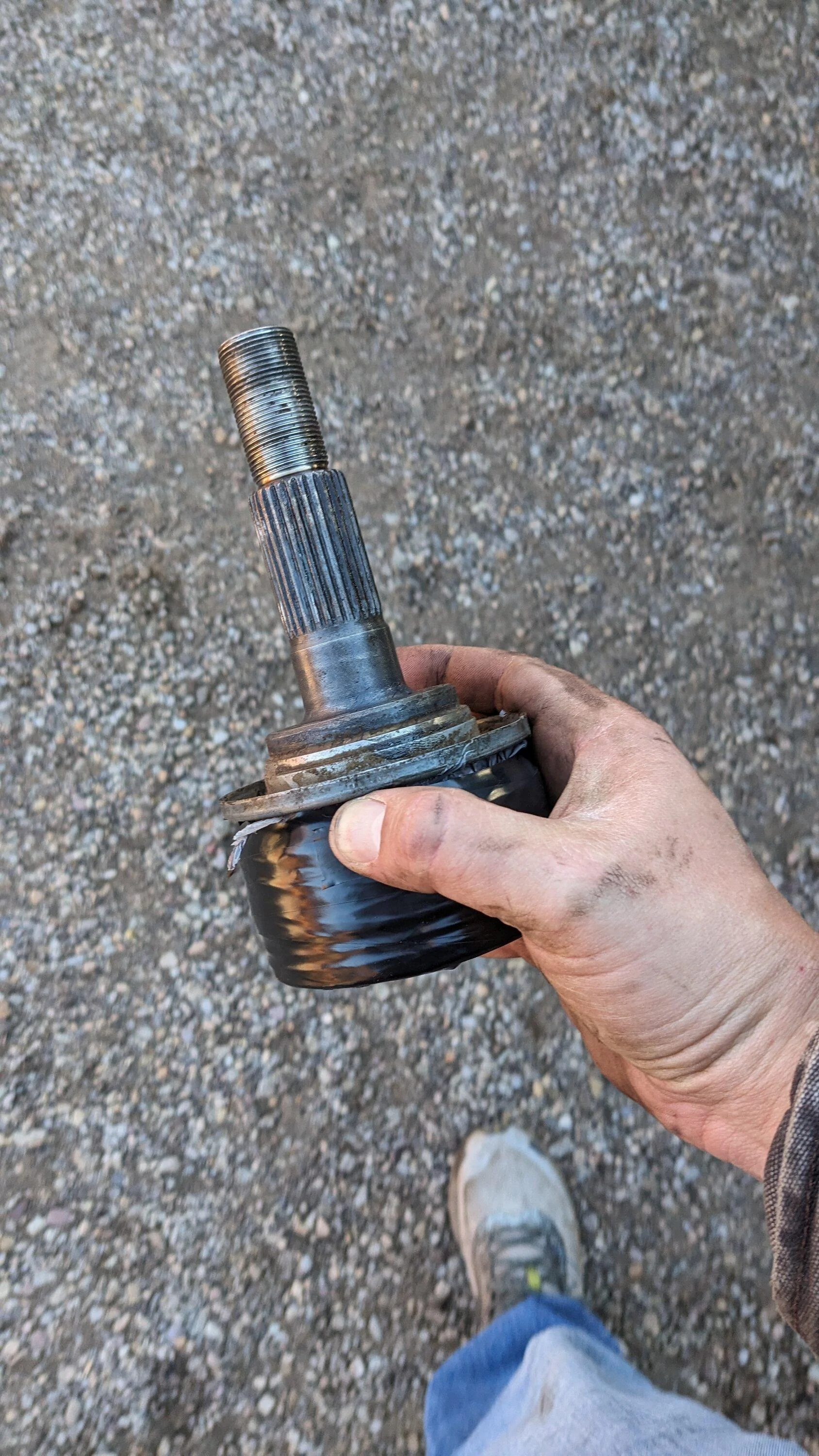

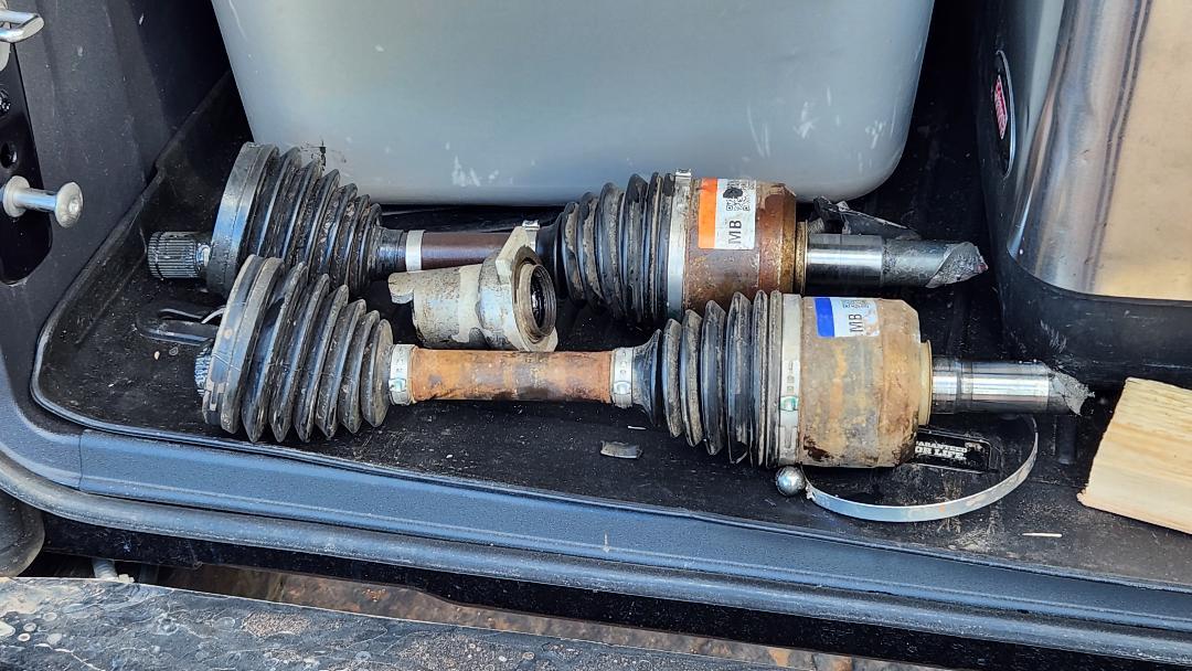

So this week the trail discussion was about running without the cv-shaft installed. After some back and forth we ultimately decided to run with a stub shaft. As we where looking at 1000+ mile drive home it was kind of not worth the risk.
The unit bearing looks like a solid center with no seams. Not sure if a stub shaft is required? Anyone got more incite into our factory unit bearing?

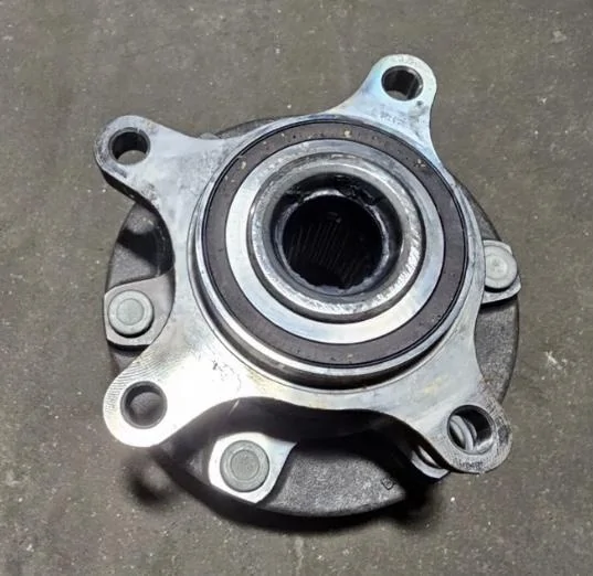

That is false. I have met the person that "invented" the modern hub bearing during my long career. Todays "Unit" bearings are now referred to as "hub bearings". All Ford truck products are all formed hub and have been that way for over 20 years. Some companies use a tradiational "unit" bearing (see the 1967 version in the brochure) pressed into the steering knuckle, which then has a hub that goes thru them that is retained with a nut (in 2WD case) or retained by the CV shaft (4wd vehicle). Toyota does this...they also use one where the "cup" bolts to the steering knuckle and still need a hub and nut or a CV shaft (see pic under 1999 on the timeline) ...but Ford does not. Ford 4wd has splines for the cv shaft...2wd does not....both are formed hub...both need nothing to hold them together.
at_the_center_of_the_hub_evolution.pdf (dtcomponents.com)

Excellent question, as you know I drove home from Moab 890 miles after breaking both CV's we put both stub shaft in just to be safe.

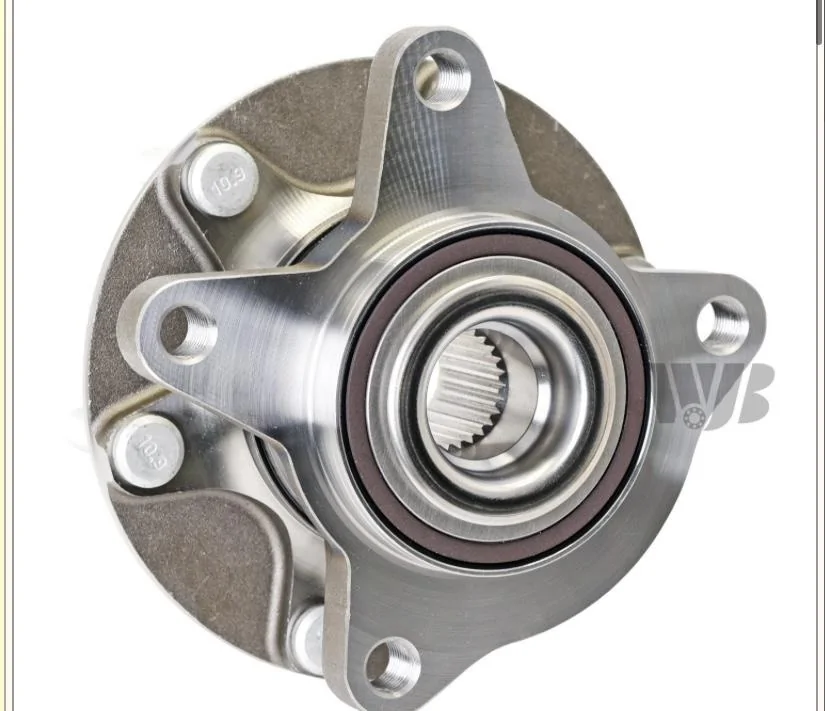

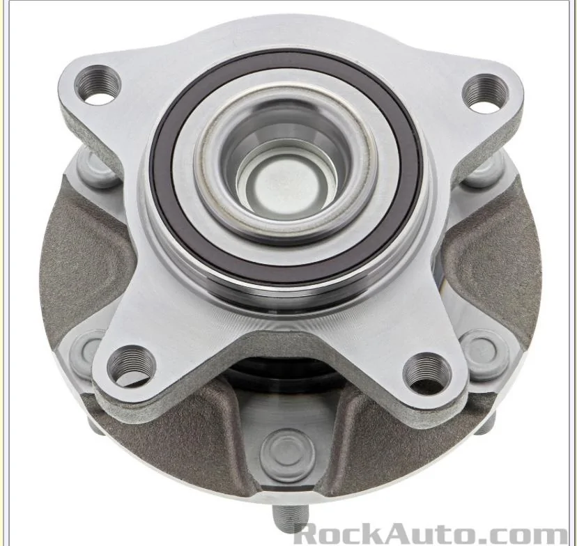

The used one is off a standard Bronco (The Raptor Bronco is larger and made by a different supplier, but is still a formed hub) …the new ones are off a 2wd and 4wd ranger. You can clearly see in all of them how the hub is formed over the seal trapping everything together as an assembly. The two wheel drive has no splines and a plug in place to keep crud out of the hollow interior of the hub where the splines would be in a 4wd version. I know this because I have held them in my hand.
